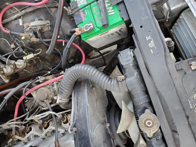

You have a few options for wiring... The gas and diesel have very different wiring harnesses. The gas has a wiring harness for all the lights and bells and whistles, and then a wiring harness that runs from the ECM and tells the carb what to do and does all the emission stuff. The diesel truck has everything combined into one harness.
Your options...
1. Completely remove both wiring harnesses from the gas pickup and put the diesel one in its place. It will only be a pain, in my opinion, when you start going towards the rear of the truck towards the taillights. Not a bad option though.
2. Remove the ECM wiring harness from the gas truck, leave the main harness, and then rewire the necessities for the diesel to run properly.
I went with number 2 and here's why. A lot of what is coming from the computer in the diesel truck has to do with the fuel sensors. Attached to the fuel filter is a probe in the top and one in the bottom and there's another one somewhere in the fuel system. Those never worked in the past so I just didn't worry about them. My diesel harness had also been molested by previous owners and so there were a few rats nests along the way, plus a poor job of wiring for trailer lights. I wanted to keep it clean.
I swapped over my dash cluster thing so that I could keep track of the mileage but also have a tachometer since the gas truck didn't have one. So I had to wire the tach, fuel cut off switch, glow plug switch, and I did a few others that I wasn't totally sure what they did. Some day in the near future I'll try cutting those questionable wires while the truck is running and then turn it off and back on again to see if they are even necessary. The unknown wires were accounted for in the wiring diagram but I didn't know if they were necessary for the truck to start and I didn't want to take a chance. I just wanted the truck to start. I'm planning to eliminate as much as I can to keep it very simple.

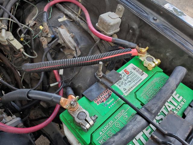

I did have some wiring for the starter, as the battery from my diesel was behind the cab. I just talked about that though a few posts ago on the thread.
