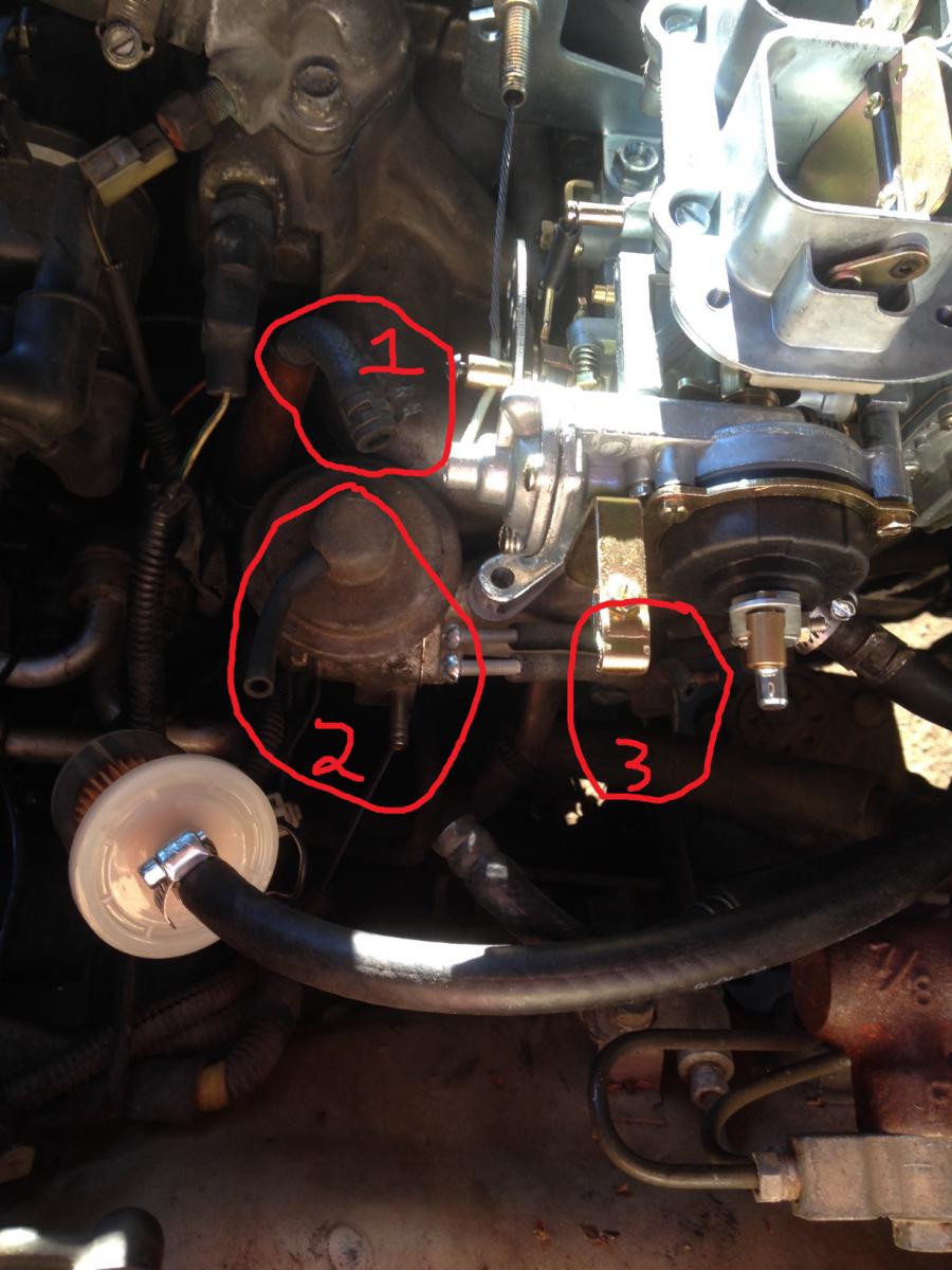

1. This is one of the three fuel lines coming off the mech pump....what am I to do with this? (mech pump will have to stay until I can afford a elect one.
Hook it up to the fuel return line back to the tank.
2. Is it okay for these two ports to be capped off?
You only need the vacuum line to the distributor - all other lines are superfluous.
3. This tree of vacuum ports, can it be removed and a bolt put it block this off?
Yep, unscrew it and install a grub screw or a bung of some sort.

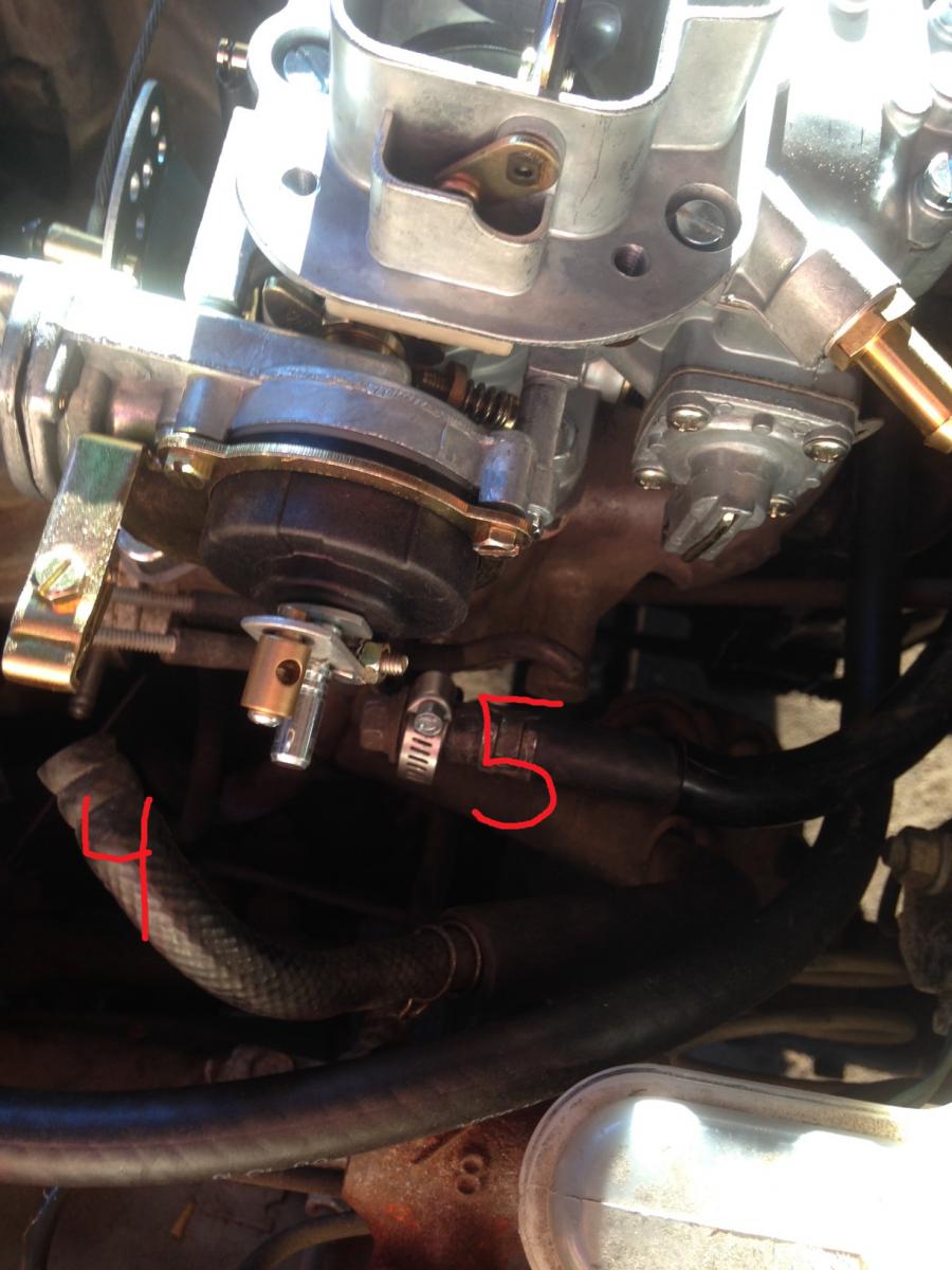

4. This is the other fuel line. I imagine one is a return line but what is the other? and can they both be capped?
On the Mikuni carb there is a secondary fuel line that goes to the accelerator pump on the side of the carb and another line that goes back out to the fuel return. This secondary line from the fuel pump is connected directly to the fuel return.
5. This line I capped off because I seen that done on another thread somewhere and it goes to a manifold that has something to do with cooling
Bingo. If you want to make your manifold dedicated to the Weber install you can remove the coolant barb on the manifold and use a single barb, then thread the coolant port with an M6 tap and seal a grub screw into the port to block it off.
