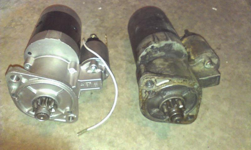

Attachment 11840Attachment 11839
Here is rockAuto version of the starter

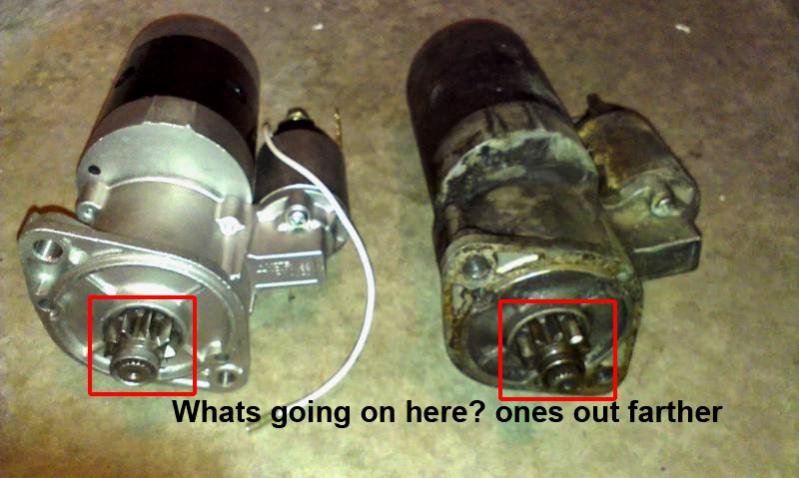

That's starter you have looks like a direct drive one to one starter
Should have 8 teeth also. I'm almost starting to think the starter is turning the wrong way possibly. Grinding like you say it does.

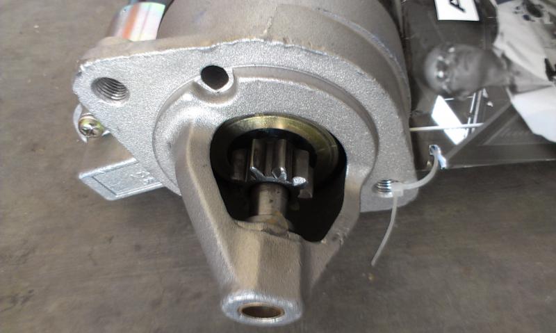

I had got this one from RockAuto, didn't work at all, no touching the flexplate, just spinning:
Attachment 11841
It's possible you have been given the wrong starter. I have one I picked up that is supposed to be for my rig but when it didn't work I laid it next to the existing and it was shorter. The throw of the shaft was less and well it was still designated for my rig. I ended up buying a rebuilt and it didn't occur to me until much later that I could have put the newer guts from the shorter starter into it and just used my existing shaft.
