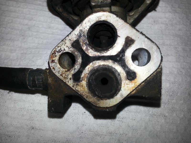

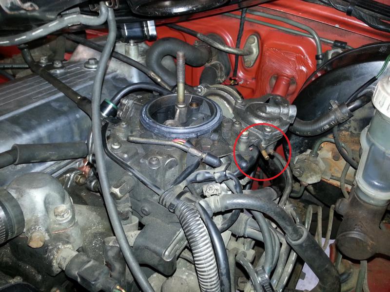

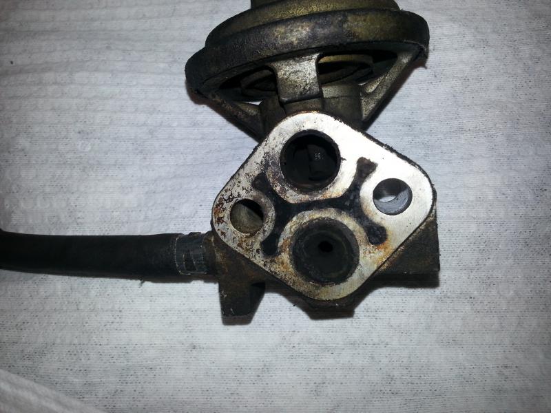

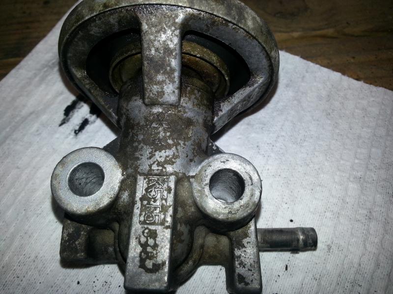

Alrighty, so i took the egr off and found that elusive vacuum hose leak:
Attachment 10186
While everything is off i replaced the vacuum hose, The EGR seems to be alright, its got some buildup but it seems to be functioning properly. I did the "depress and hold your finger over the hole" test and it passed that, but that's as much as i know about them. I also replaced the gasket. Still got some leaks, and i'm not 100% sure its running perfect yet, but that seemed to make a difference. I think my timing is off at the distributor which may be causing some of my other issues. I'm also going to run some fuel system cleaner through the second tank of gas and possibly a bottle or two over the next couple tanks. I'll post an update in a couple days to verify how it is running.

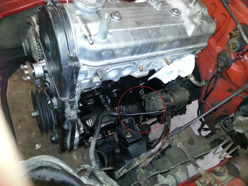

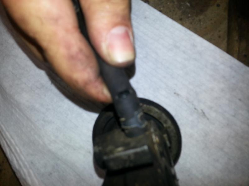

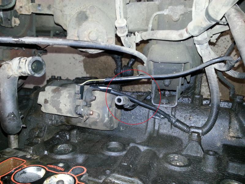

Ok. I need some kore expert help. The truck seems to run three times better. But there is still a leak under the hood. It may be normal bust i need advice. There is a hose coming off the fuel pump the spritizs when the truck is running. Im not exactly sure what this is.
There is a hose that is attached and gets routed under the oil pan and then is open. Im not sure how else to explain without pictures
It's spraying fuel? Don't drive it in that condition!
Well it some sort of overflow or something. Im just not sure if its supposed to be doing this or not.
ok, so i didn't get an updated picture. On the fuel pump the pictures of the thing below attaches to the pump, is this supposed to go under the truck like it does, is this supposed to be fed somewhere else? And is it supposed to spritz when running under the truck like it does? I may even have it rigged up wrong, dut this is the only cable i removed from the fuel pump that didn't go somewhere else within the truck, so if its supposed to that might be som eof my problems as well.
