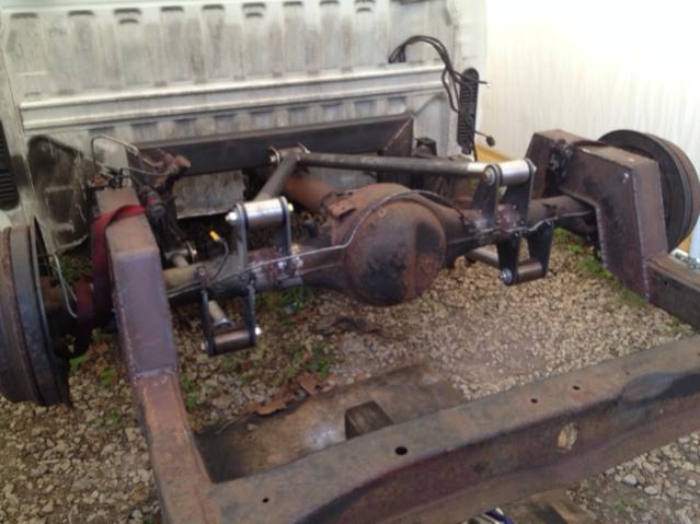

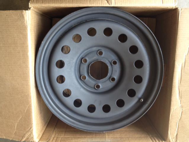

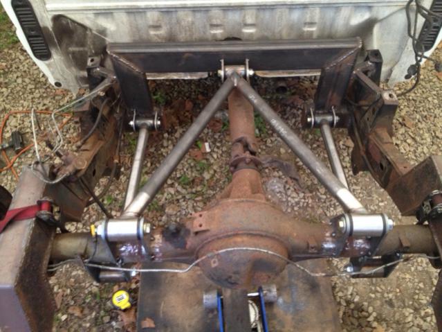

Today I got the crossmember done and tacked my wishbone in place. I still want to reinforce it with some gussets and tie it into my bed mounts for a little extra strength, but I ran out of time today. I also decided to not use my escalades and go with GM 17" steelies. So that's it for this week, next weekend I'm going to the truck nationals in Carlisle Pa. so their wont be any work getting done.

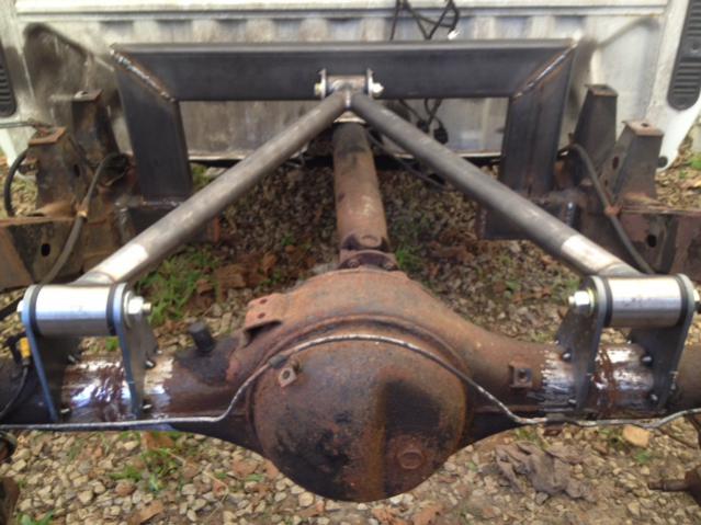

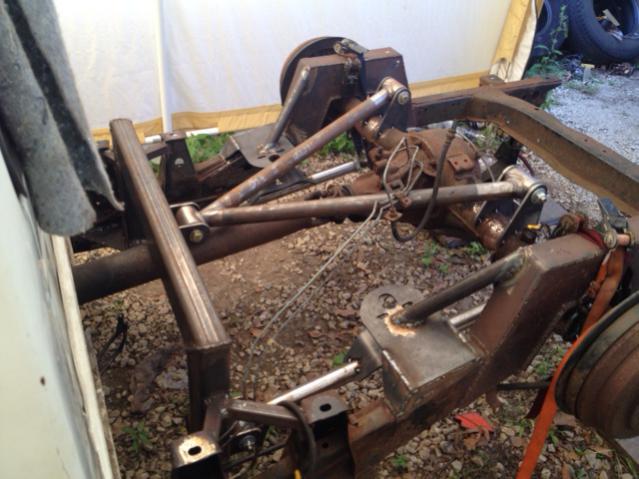

5 Attachment(s)

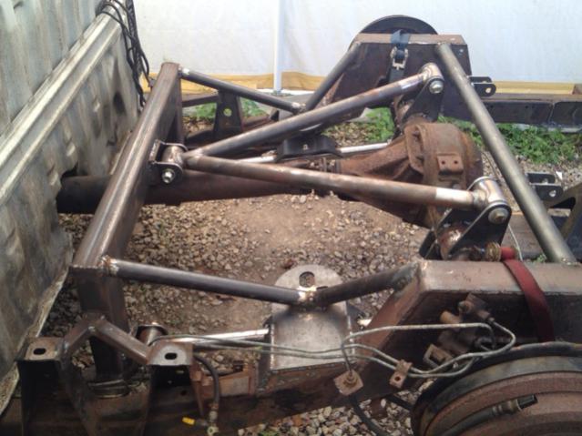

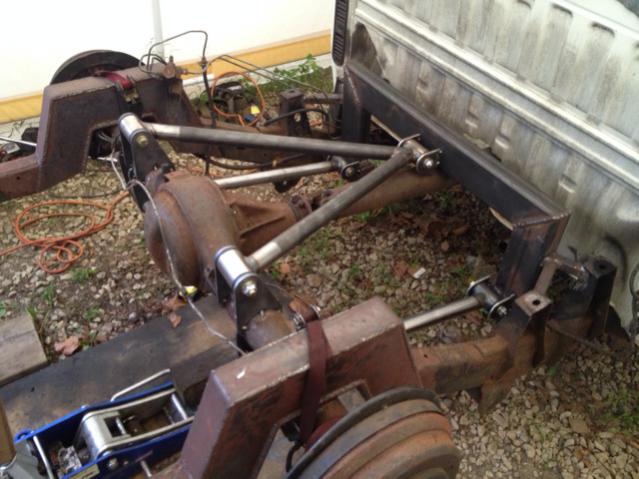

Today I got the braces and gussets in for the cross member and the lower bars in place for the 3 link. I also cut the tunnel out for the drive shaft, I can lay out the rear on a 27" tire. All of the tabs for the 3 link are still only tacked for now until I figure out the bag placement and shocks. So that'll be next.
Nice....Sure hope your universal joints never snap and sends that driveshaft into a spasm. Making progress Bobby.:)
Thanks Brad. I'm gonna make a new tunnel with probably 1/8" steel. But the driveshaft will only be that high if I'm layed out on a 27" tire. As of right now I'm only running a 24" tire but I just wanna plan for the future.

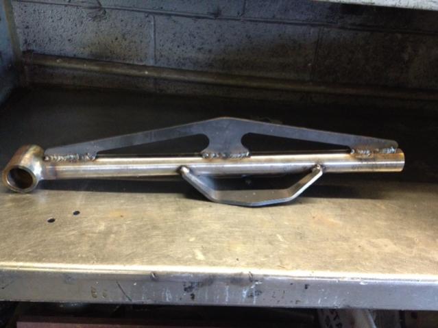

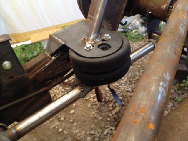

I made it over to the shop for a little while today. I got the bag brackets welded in for the 3-link.

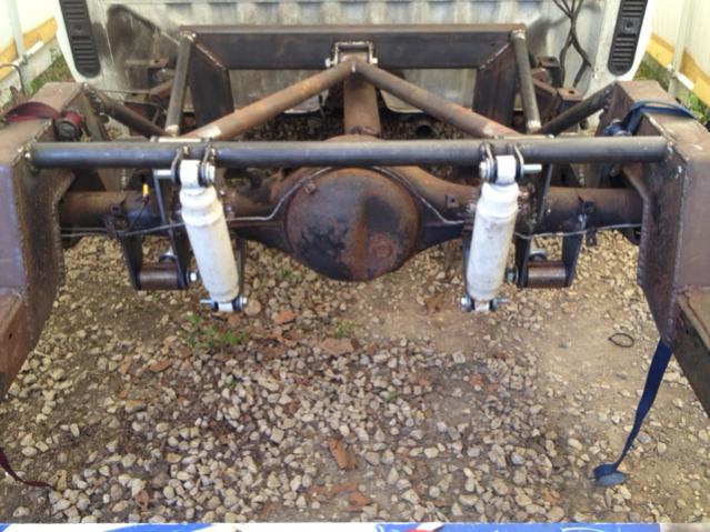

3 Attachment(s)

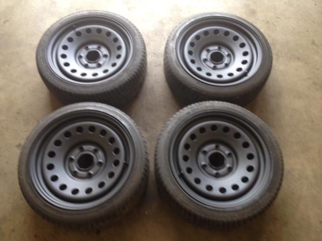

I put in another bar for the upper bag bracket for added support and mounted my rear shocks. While I had it all apart to weld the tabs I finished welding the bottom of the step notches since the diff was out of the way. I also painted the steelies and mount and balanced the tires.

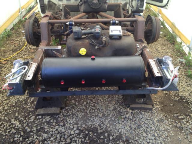

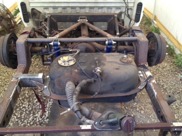

3 Attachment(s)

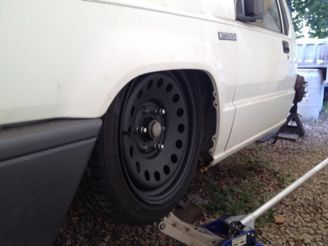

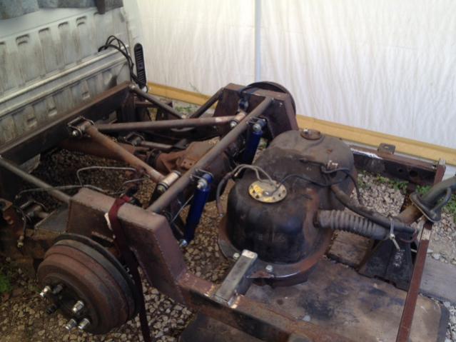

Mounted my gas tank yesterday. I need to run to the store next weekend to get some more steel for mounting my air tank and compressors. I also put my new wheels on to see how they'd look tucked.
Truck and work is looking great! The steelies look awesome too. You and my buddy are mking me jealous, I need to get to work on mine and stop slacking.
Steelies look tough dude! I'm seriously looking into getting a set when my cash flow improves. The 17" rims don't look over the top in basic black either...
Thanks guys. I got tired of seeing escalades on everything and I was looking for something basic. I think I'm gonna do a red pinstripe in the outer lip of the rim. It feels good though, it's like I see light at the end of the tunnel. So droppedmitsu what's your buddy building?

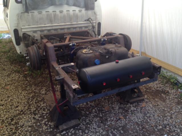

1 Attachment(s)
I didn't get a lot of time on the truck today but I did get the air tank mounted. Next will be the compressors.

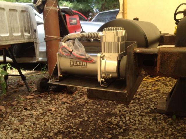

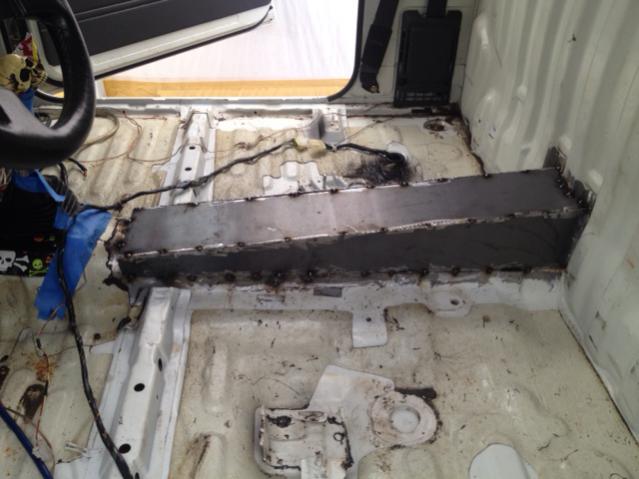

3 Attachment(s)

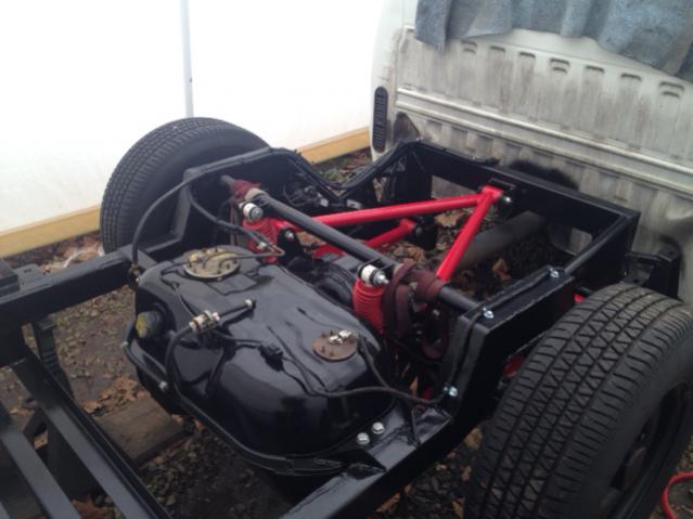

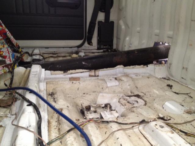

The back half is officially done! Now I have to take it all apart and prep it for paint but before I do that im gonna raise the bed floor to see how it all fits. Today I got the compressors mounted and also got started on the tunnel.

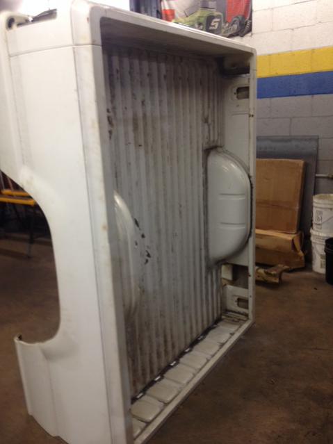

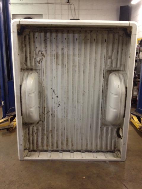

2 Attachment(s)
Started raising the bed floor today. It's taking longer than I expected so I'm gonna try to get on it tomorrow also.

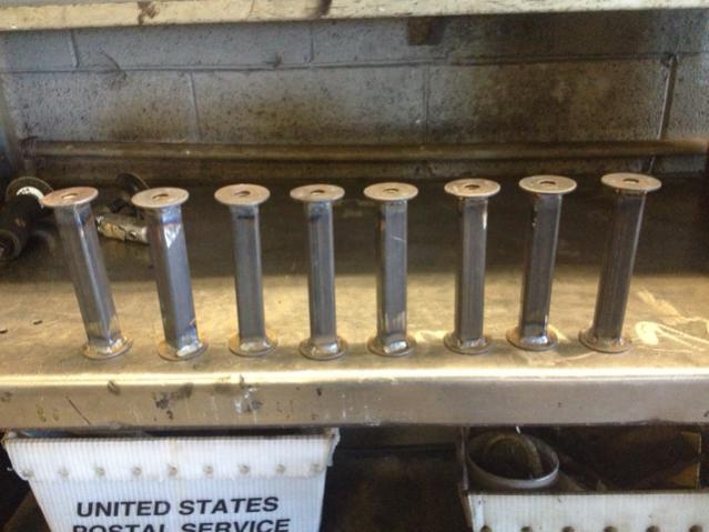

1 Attachment(s)
I made the bed mounts to compensate for the 6 1/2" raised bed floor. My plans are to put the bed on this week to check that everything clears and to figure out where I'm gonna mount my valves. I'm thinking about adding a bar across the frame behind the compressors, but I wont know for sure until I see my clearances. I started welding the tunnel today but ran out of gas so I guess that'll be next weekend. I was going over list of stuff left and I think I could maybe be done in a month if nothing else comes up.

1 Attachment(s)
Yea I thought it was gonna be done in a day... I was wrong. I got a lot done but I still have to brace the sides and make the filler panel for the back of the bed. This is the first one I did so I don't have anything to compare it to but I heard that others are easier. But I like a challenge otherwise I would have done a s10 like everyone else. I put the bed on the other day and everything fit nice and the body lines lined up. It felt good to see it look like a truck.

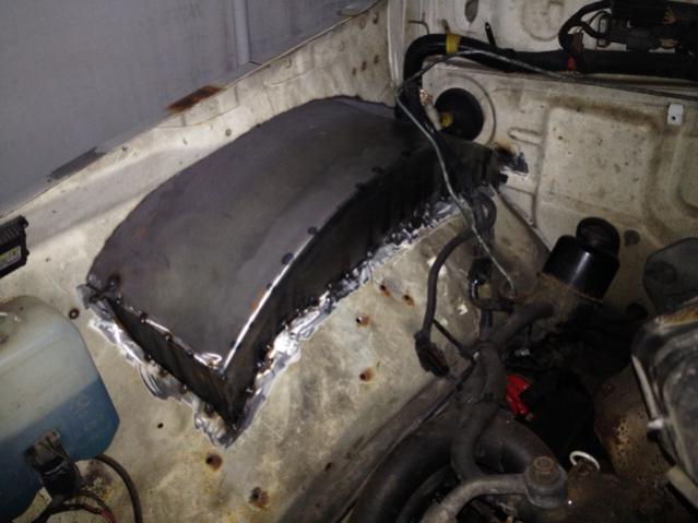

4 Attachment(s)

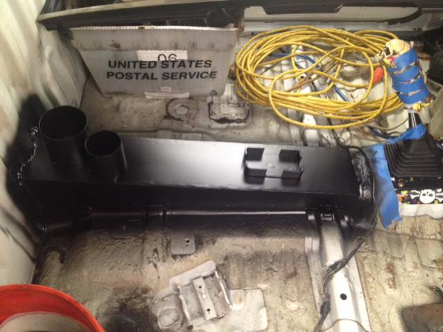

Man its been awhile since I updated. Life has been real busy lately but I still am chopping away at the mighty max. Since I last posted I got the back half all cleaned up and painted, plumbed and wired my fuel tank, installed my exhaust, finished the trans tunnel and I just got started on the front wheel wells. Right now I'm waiting on the rest of my fittings to come in. I ordered them from gaugestore and half of them came in and the rest were suppose to be drop shipped from smc.
