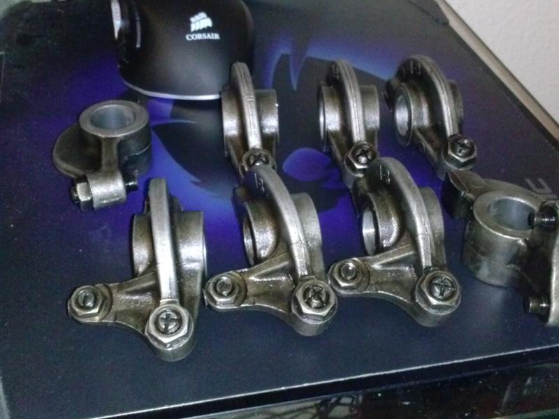

THANK YOU, DOPRIUS!!!
Full set of Mech rockers in-hand!
Attachment 5799
Now just remove the jet valve screws and you are set...
Gonna go a step further than that...dremel and my powder scale. Not only will that mass be gone, they will all be the same weight (not that is matters hugely).
I don't like cutting cast parts like that - I feel it causes a weak spot where the tab was originally. The loss in weight is not worth the possibility of broken rockers.
