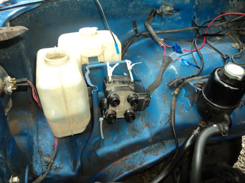

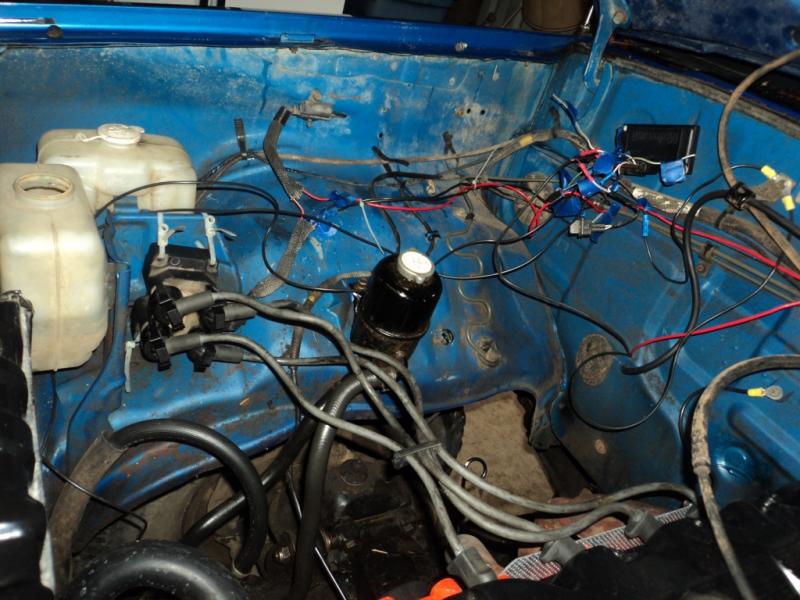

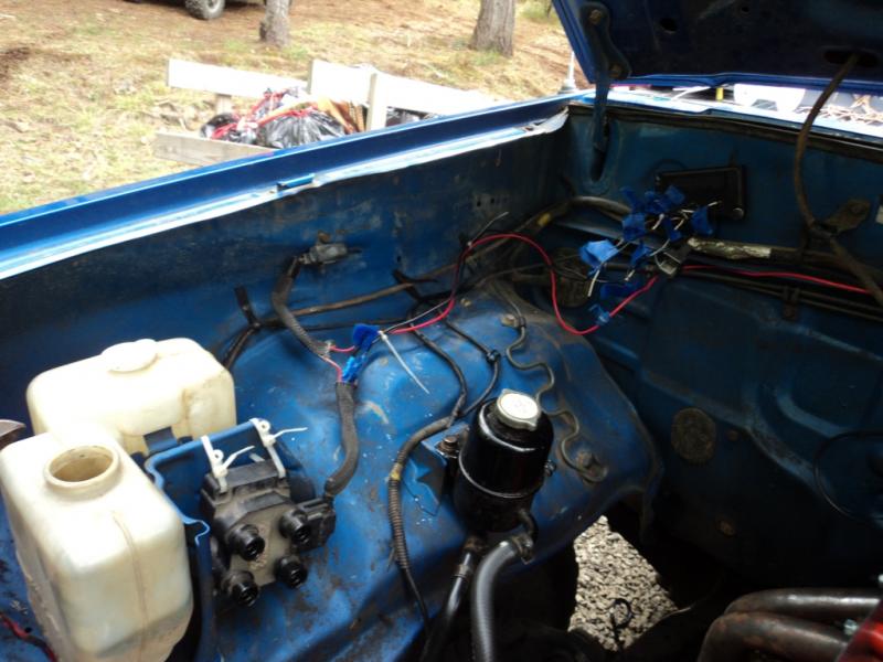

running my power for the fuel pump and the edis unit
Attachment 1497Attachment 1504Attachment 1498Attachment 1503Attachment 1499

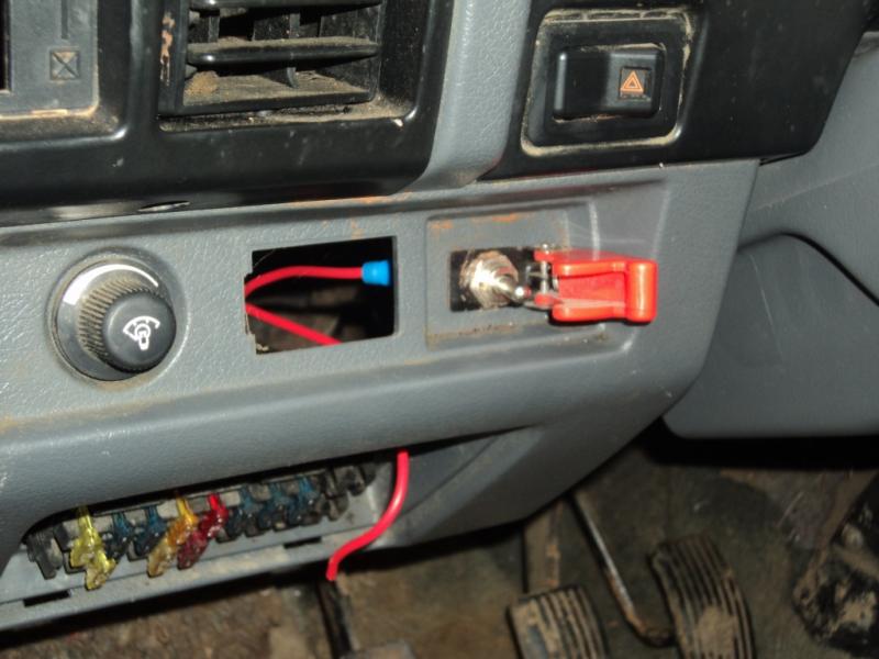

here is my switch that activates the edis module and coil
Attachment 1501
Attachment 1501

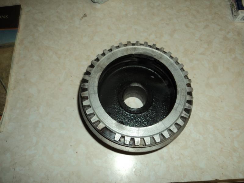

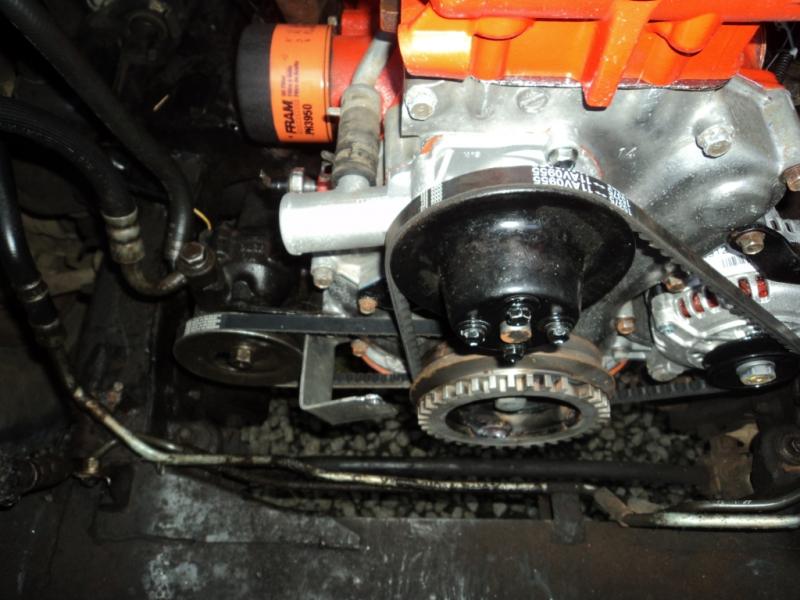

the old motor spun a bearing and i snagged a few parts off it for my new motor. anyway, the machine shop finished my crank pulley and trigger wheel. almost done. i will make a video of it starting for the first time. just another few days.

here's what $70 gets you from the machine shop
Attachment 1741

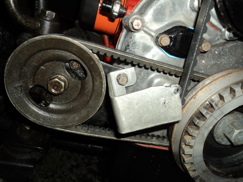

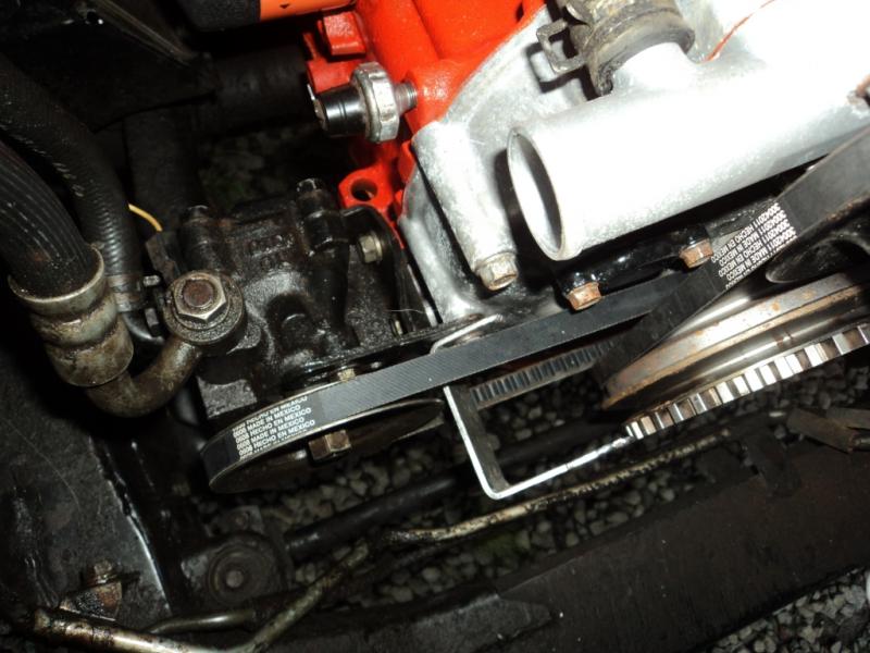

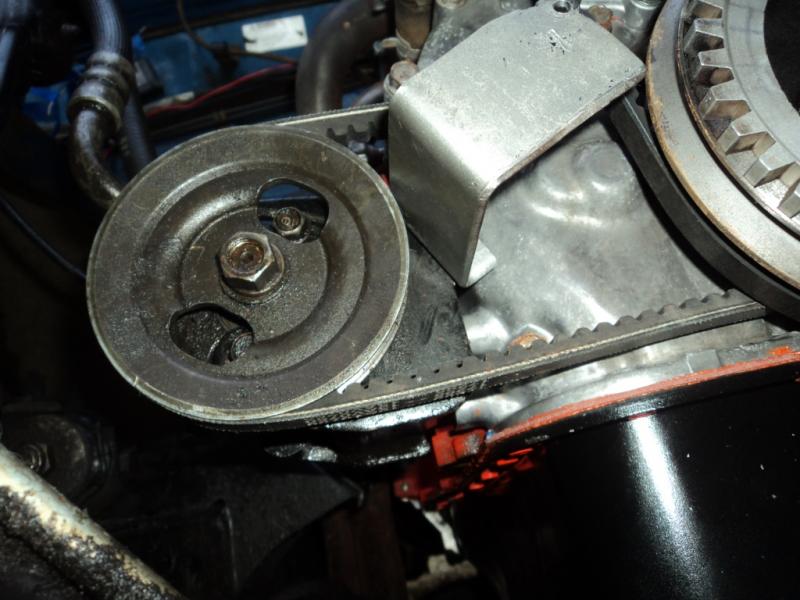

the only thing left is to bend the bracket for the VR sensor. then its time to fire it up. i'm hoping to start it this weekend... hopefully.
here is the bracket i made to mount the VR sensor to. getting closer
Attachment 1748Attachment 1749Attachment 1750Attachment 1751
every time i think i'm gonna get to finish this lately, something comes up and i can't work on it:bang:. its so frustrating.

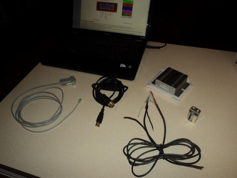

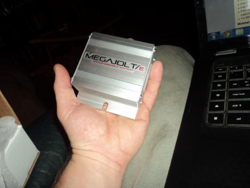

here is my megajolt unit
Attachment 1801

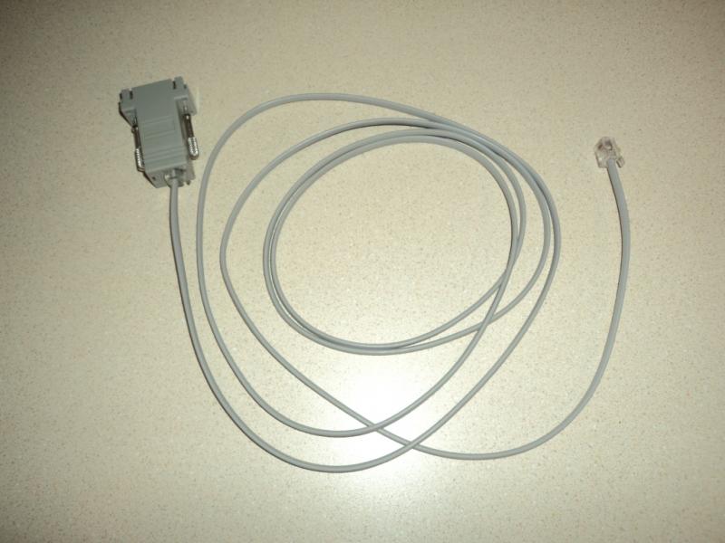

this is the serial tuning cable that comes with the megajolt unit
Attachment 1800

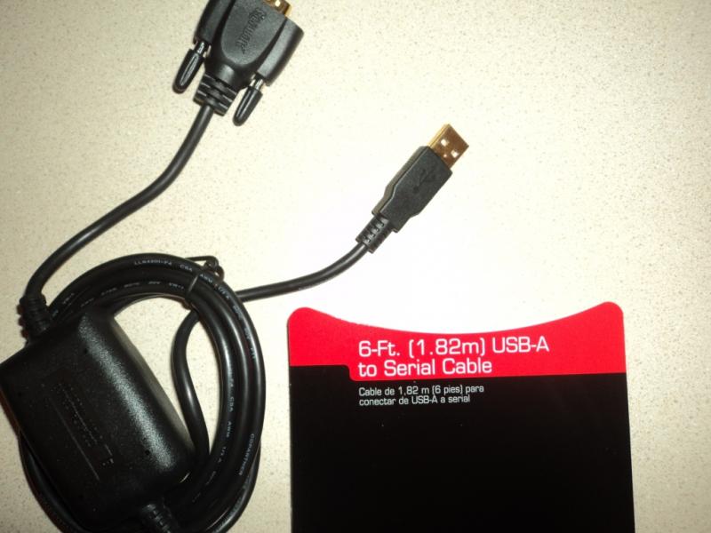

this is the $40 adapter cable that i needed to link my laptop to the serial tuning cable
Attachment 1803

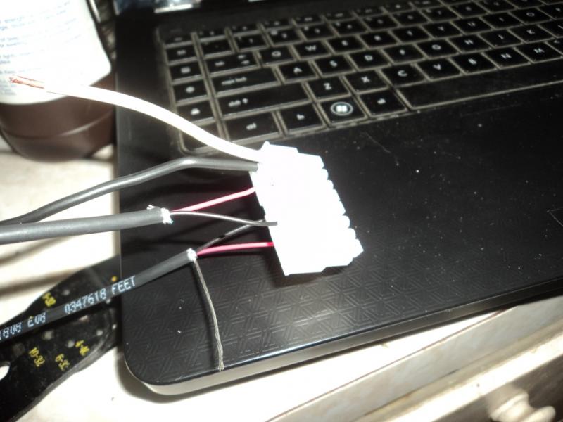

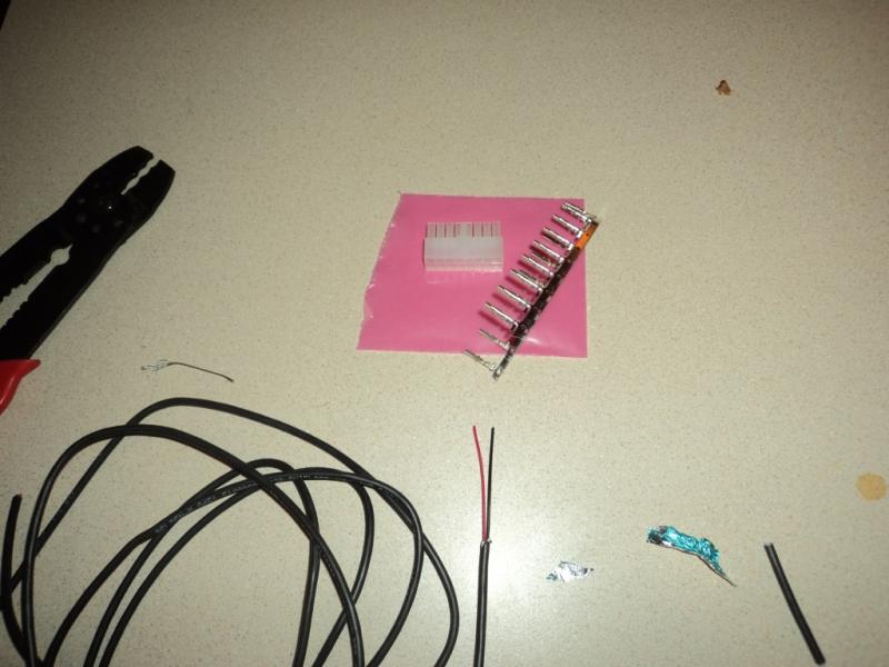

building the wiring harness that plugs into the megajolt unit
Attachment 1804
finished wiring harness
Attachment 1805
getting ready to bench test it. the megajolt unit can be powered by a 9 volt battery for this purpose
Attachment 1806
it works
Attachment 1802
Make sure the crank sensor bracket does not vibrate. That might cause timing issue later on.

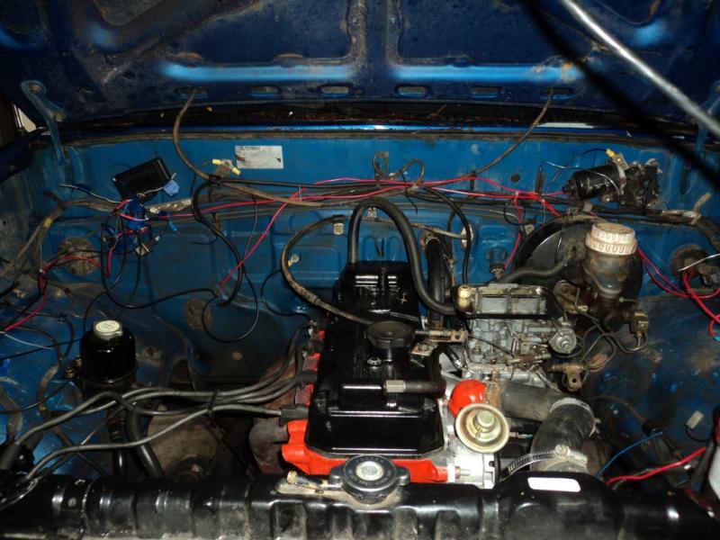

got the truck running today. it fired right up after i got the megajolt unit hooked up. i would upload a video of it starting but the video is 200 something megabytes so here are the rest of the pictures i took today

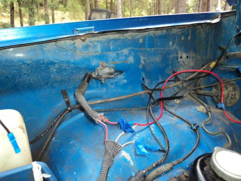

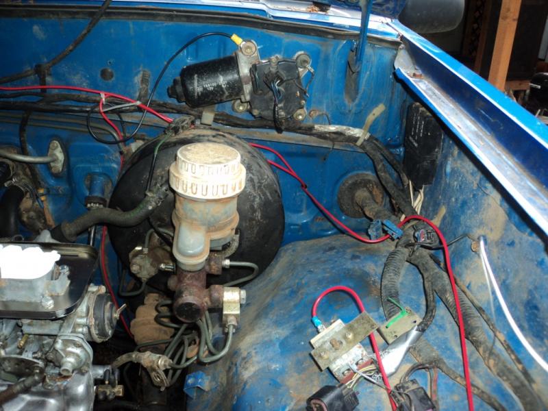

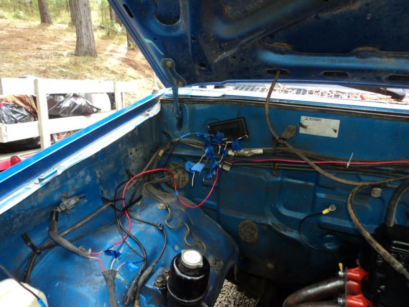

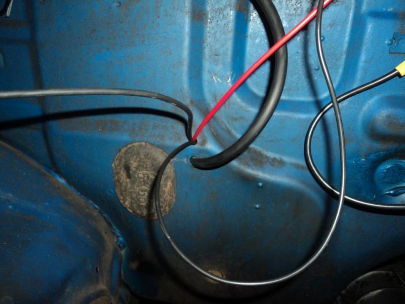

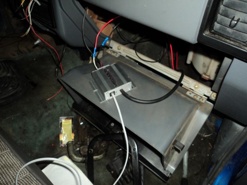

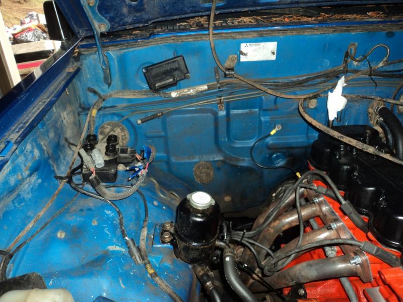

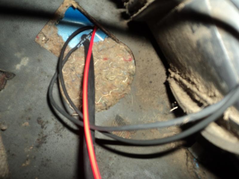

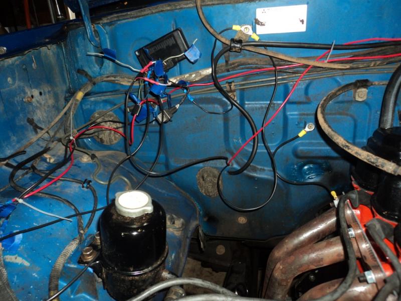

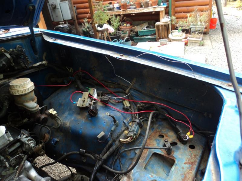

i put the megajolt unit in my glove box and ran the vacuum line, power, PIP and SAW, lines through the firewall
Attachment 1808Attachment 1809Attachment 1810Attachment 1813

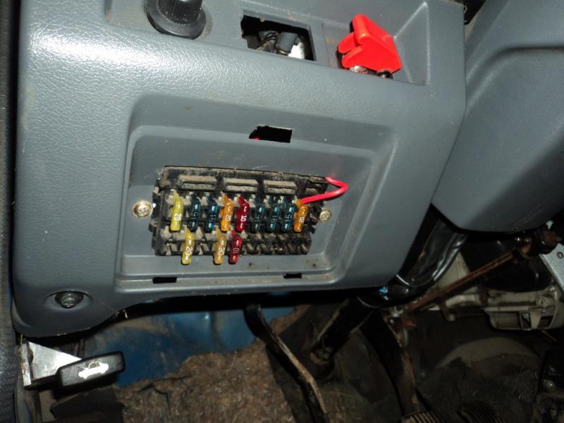

i used the heater fuse in the fuse panel to power the megajolt
Attachment 1811
Awesome, glad to hear it fired right up. So how did it run, pretty well?
it ran really well on the default timing map. revved up good and idled well. i took it for a drive and forgot that i hadn't tightened down my canopy and found it laying on the road when i came back to my house. the truck runs really well and the timing is dead on. now its time to get the exhaust installed and fine tune the carb.

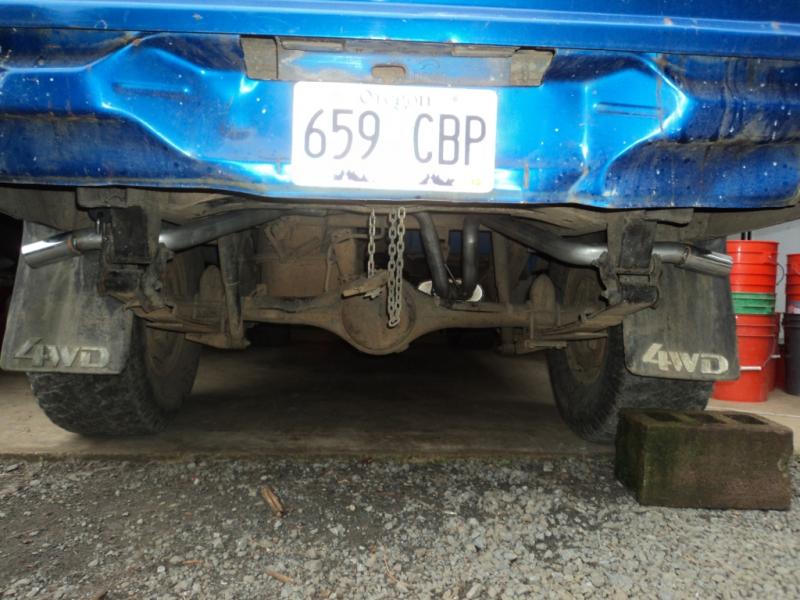

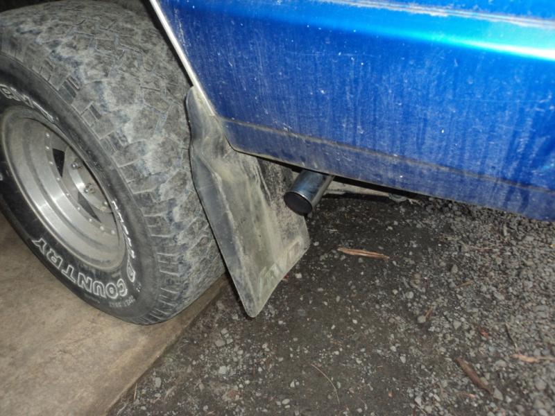

i got exhaust on the truck today. i'll take some pictures of the duel exhaust tomorrow and post them. i'm gonna take it out this weekend and start tuning the carb and timing. i'll tell you now that the distributorless ignition is amazing. the idle is as smooth as silk and even with the carb not adjusted properly yet it winds up nice. i can say with confidence that going distributorless is the way to go. i am working on an edis installation guide and an approximate cost to go distributorless. it cost me, using the megajolt ecu, $340.76 to go distributorless. i think that this is an acceptable price for an awesome upgrade to your ignition system. when i get done tuning my ignition map i will post it so that all you guys who aren't going turbo have a good place to start.
here's the pictures of my duel exhaust
Attachment 1920Attachment 1922Attachment 1924

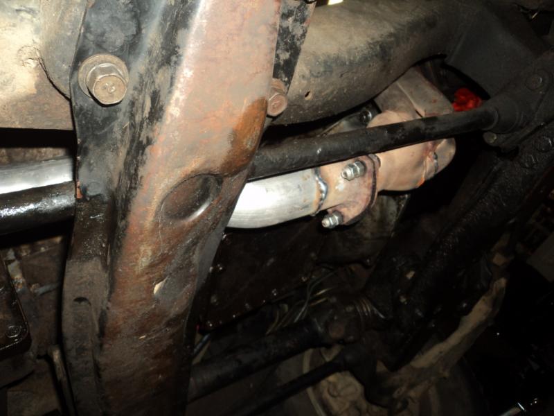

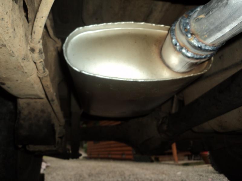

quite a few years ago i learned that the exhaust is really hot on these trucks and that, at least on my truck, they go through mufflers if there is no catalytic converter. it took my exhaust guy and me awhile to figure out a system that works really well. what we found was that if you put a glasspack after the header where the cat used to be it saves the muffler from the heat of the exhaust. that and the fact that i had my muffler custom made at the exhaust shop for my truck.
Attachment 1923Attachment 1921Attachment 1919
Is that glasspack glowing that color or is it painted that color (That looks BA if its painted like that), my cat on my truck looked like that when I first started to drive it, it was missing on one plug and running too rich, it got so hot that the passenger side of the truck started steaming from the water that was on the floor because I had had the door open when it was raining.
a few years ago i got that glasspack glowing red hot out at the dunes on the coast. thought my truck was gonna catch on fire. no, its just the paint burning off cause its new. it sounds a lot healthier than it ever did before and boy is there more acceleration. i think i need to upgrade my motor mounts. they are new but they are stock replacements. i was thinking of upgrading to polyureythane motor mounts.

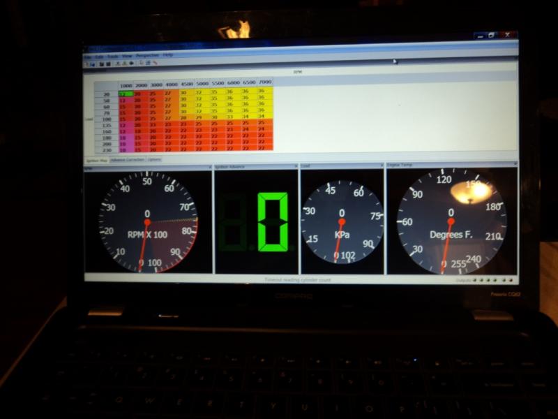

it seems that i can't upload the actual ignition table so i will have to give it to you in text form. this table, at least for my build, gives superb low end power, smooth idle, good fuel mileage, and no popcorn noise or backfiring out the exhaust. RPM's on the top from left to right, and Load going down the left side. low load on the top and high load on the bottom.
