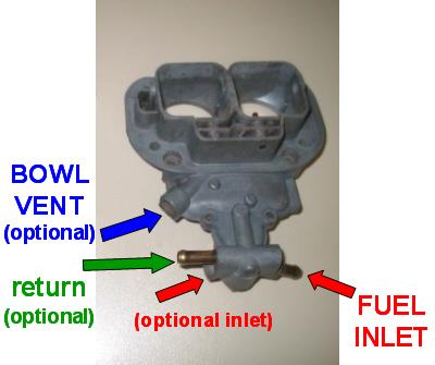

On the DGV series Weber the vacuum advance port is the one nearest the float bowl, 3/16" diameter hose. On the Sami, you'll need a 3/16"x1/8" adapter so the line fits properly at the distributor . Keep the 3/16" section of hose fairly short, this will keep the signal speed consistent .
If you have an emissions equipped Weber the EGR port will have a small screw plug in the end of the brass port . To use the EGR you will have to retain the oem EGR controller and wiring off the stock intake , just substitute the Weber in place of the Hitachi . Be aware that most of the EGR valves are not operational due to carbon buildup in the intake and head ports , they must be cleaned as well as the valve itself , not a fun job .
Electric pump installations work well with these carbs but pressure against the pump and excessive pressure at the carb is also a problem . If the carb has both inlet ports tapped it's pretty simple-
The stock lines on the frame rail are 8mm/ 5/16", put a good quality fuel filter (paper element only) a few inches away from the carb .
Remove the second inlet port plug on the carb and it's aluminum gasket washer . The hole is 1/8-28BSP but a 1/8" NPT fitting will work ok . Buy a 1/8"NPTx3/16" clamp style rigid male brass fitting at your local parts store , any store that supplies brass made by Edelmann will have them available . Route this 3/16" line back down to the frame rail to the return line , on most Sami's it's the middle one .
If the carb is not equipped with a second tapped inlet port then you must use the CJ/Fram filter with a built-in bypass .
Make sure to mount the fuel pump reasonably low in relation to the tank, this helps with priming and makes the pump last longer .
The use of a return line does two things-cool the pump and allow a much lower pressure at the carb .
The vapor return line from the canister plugs either into the port directly below the carb or one of the pair just ahead of the carb .
