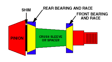

It's a crush sleeve. It is what sets the preload on the pinion bearing and is also for the heal and toe setting of it. They normally get replaced as there only good for 1 use. Once you squish it past the point of the correct setting there junk.
Attachment 5649
He said the Auburn lsd was a good quality unit. He wants to replace the pinion bearings and both carrier bearings as my truck has quite a few miles on it. He says they can reuse the sleeve if they are careful.The sleeve is no longer available from Dodge or Mitsu. I imagine they will use a torque spec to preload the bearings with the old sleeve as a spacer.

hey, mitsubishi does not use a crush sleeve.
they use a spacer with front and rear bearing shims.
check the factory service manual.
MB185336, MB241925 shim kits
That should make it easier for them to change the pinion bearings. They won't have to worry about collapsing a sleeve too much. I would think the shims and spacer should be reusable. The seals and bearings should be here in a week or so and then it'll take a week to get the truck in for the installation. If there are any issues at all I'll post here. I really trust the guys at Pioneer Transmission here, they rebuilt my 5 speed and they do the service on my automatic tranny and any other drive train work. They've been around a long time and are always busy.
