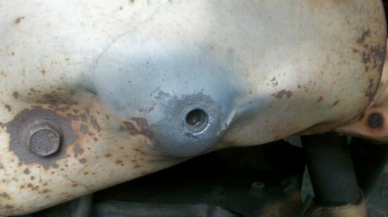

4 Attachment(s)
Trip to the Yard for the Oil Pan

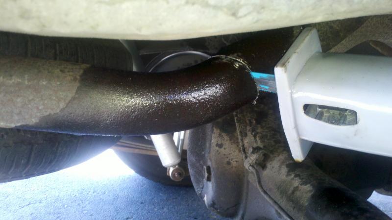

Ok, back to the build. We talked about the oil pan for the Laser. Never did find a reasonably priced aluminum replacement, so I had to sniff out a tried and true OE. Gratefully there was an AWD Talon with just what I needed. (hated to see an AWD like that, like it was an awesome horse left for dead in the open plain to get picked apart by vultures...) Well, it is what it is, so I had to be the vulture this time. Pan had a nice pickup baffle already in (not sure if the OE Laser pan had that too - long time since it's been off), but that will help when I'm on the road course. I've decided to campaign the RS-T in NASA Pro Racing's "Performance Touring" Class -(final mods determine who you actually run against on track, as long as there within that base class). But a stock '90 RS-T is classed PTE.
It was a milkshake that brought this Talon to the yard... Water/Oil mix in the pan when I pulled the plug. Good sign that it still held fluid. I pulled the pan, and the bolts, and kept the cut oil return line. All threads good, plug good, even filled it with water and let it sit for a while to ensure no cracks before I bought. #allgood :thumbup:
So hopefully, that will put the day the Laser is on the road, that much closer. Thanks for "tuning" in! :cheers:

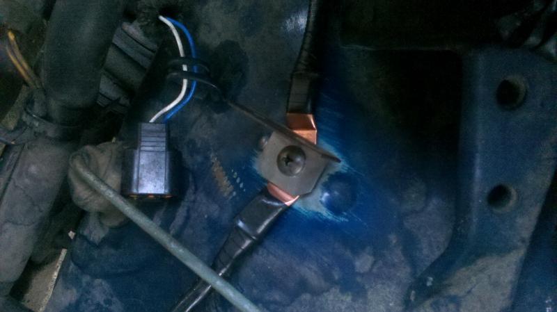

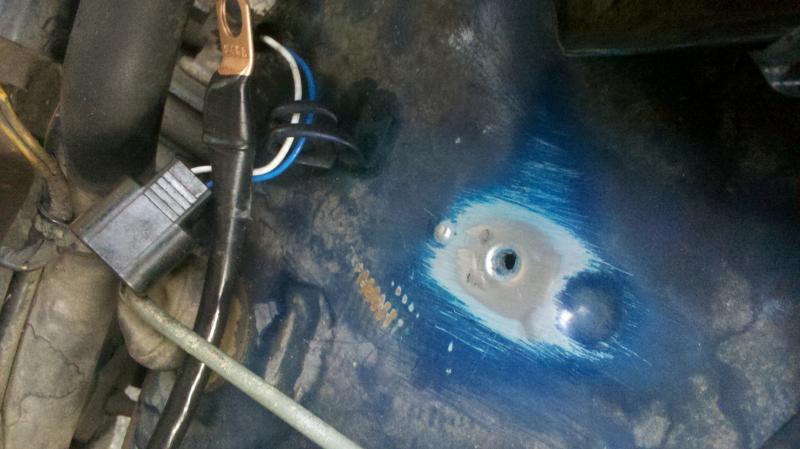

2 Attachment(s)

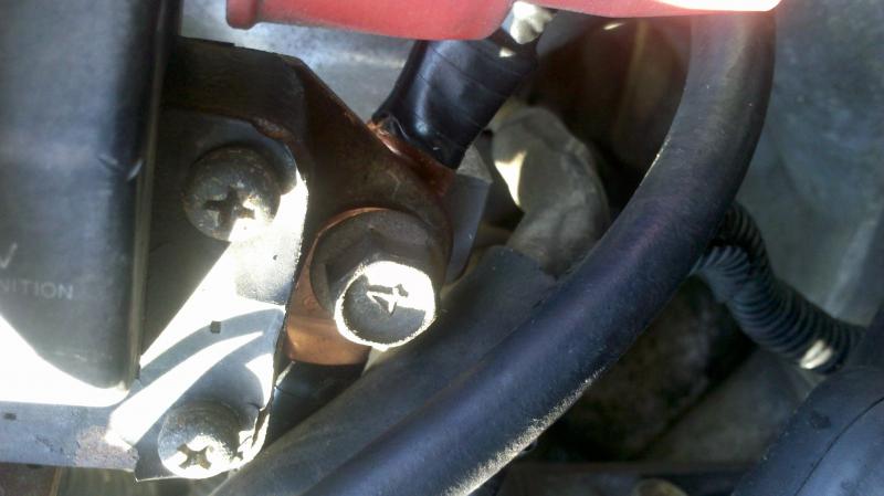

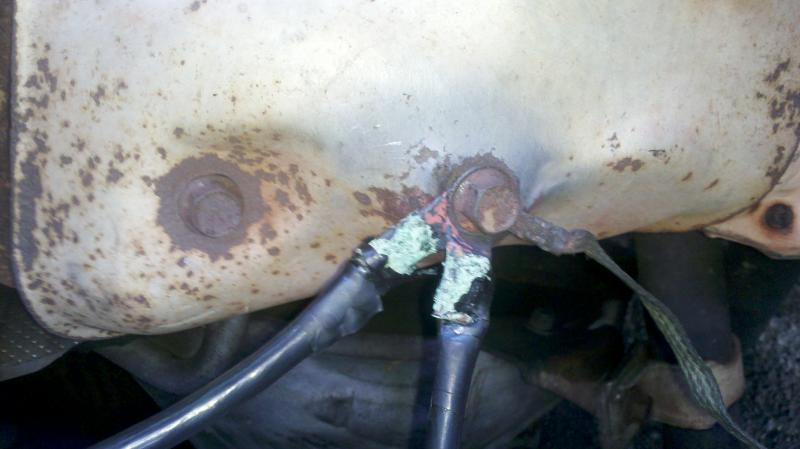

Update on the Homemade Ground Wires

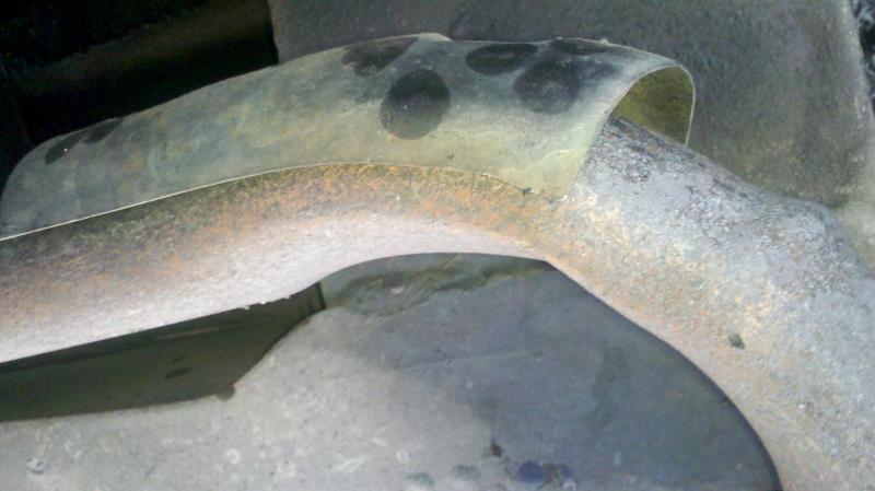

Soooo, the wire ends I hooked to the Exhaust Manifold Heat Shield started corroding - especially after the electrical tape at the very end of the connector started melting from the heat...
Attachment 3011

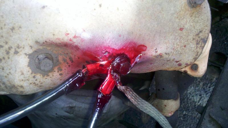

So I got a stiff wire brush and some battery terminal sealer from Wally World and cleaned it all up. Hopefully it holds, I'll let you know...
Attachment 3012
