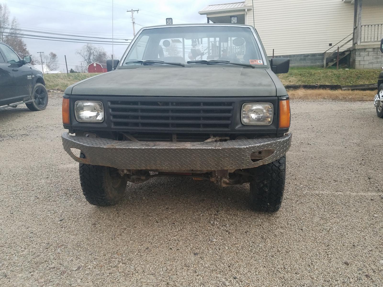

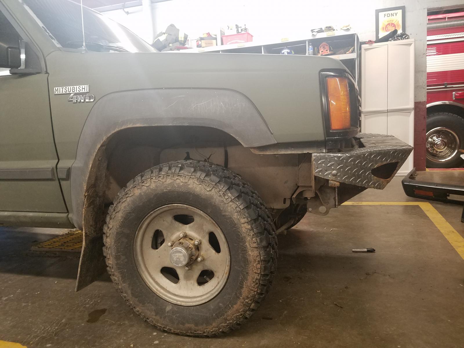

I welded up some brackets to day and got it mounted. Still need to figure out how to mount my turn signals. It's not ready for any winching yet I need to add a few gussets for strength. I think with a little bit of tweaking I can straighten it up. It definitely wasn't built straight but I'll make it work.
Attachment 21328
Attachment 21329
Attachment 21330
A tweak or 2 and a couple of hits with a mallet with bring it into shape. Have mercy on any fool that ends up on the receiving end of that bumper. Jeez this thing is lethal...
It looked the the po hit something with it on the drivers side. The center section is solid but the outside is kinda flimsy.
Haven't been driving it much lately since I've got a company truck I figured I'd better start it up an clear the snow off. It started right up it was a little cold natured til the choke opened but ran fine after that.

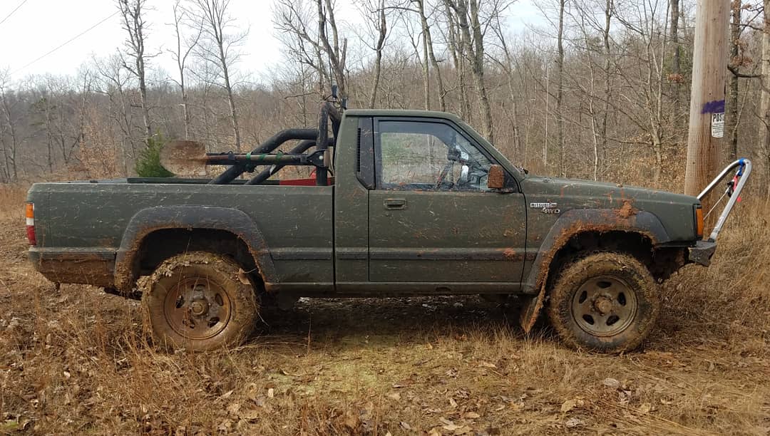

Bought a winch and some lights for turn signals and hopefully I'll have it all on and and my stinger hoop welded on this weekend.
Attachment 21418

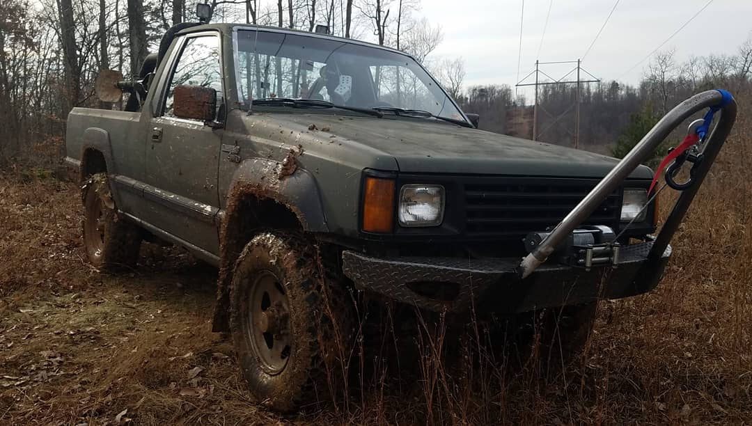

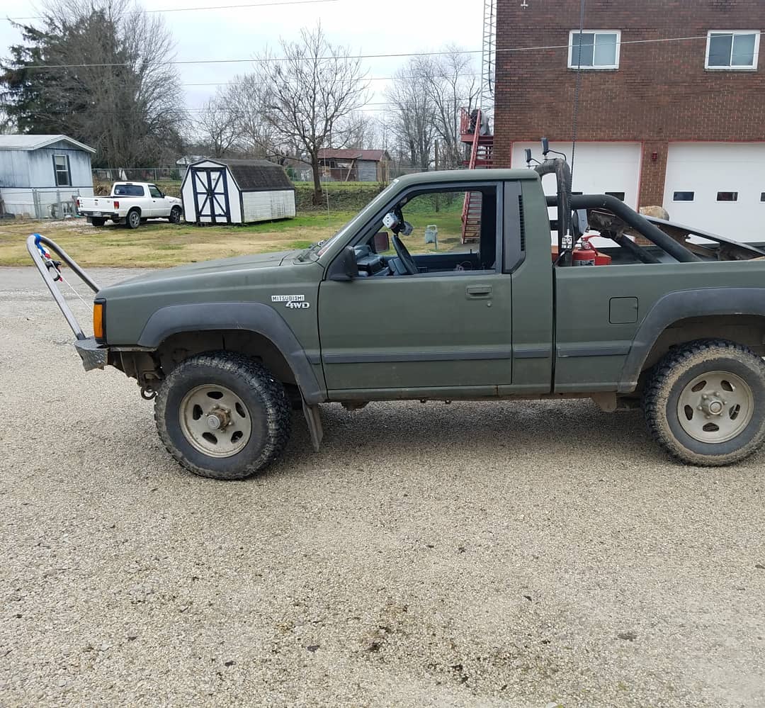

Got my winch and stinger installed.
You plan on using your truck for rescue retrievals? That is some serious gear :thumbup:
I just plan on tinkering around the farm clearing old logging roads and not getting stuck.
Very cool dude. Makes the dealer option bull bars we had over here look like match sticks
You could give discount prostate exams with that thing too, you know, to help pay for new parts and stuff :lmao:
Oh, and it looks bad ass! :thumbup:
My wife says it looks obnoxious and I said I know I love it.
Some jackass in an SUV is going to back into it and take out their rear window :lmao:I'd opt for function over form any day of the week...

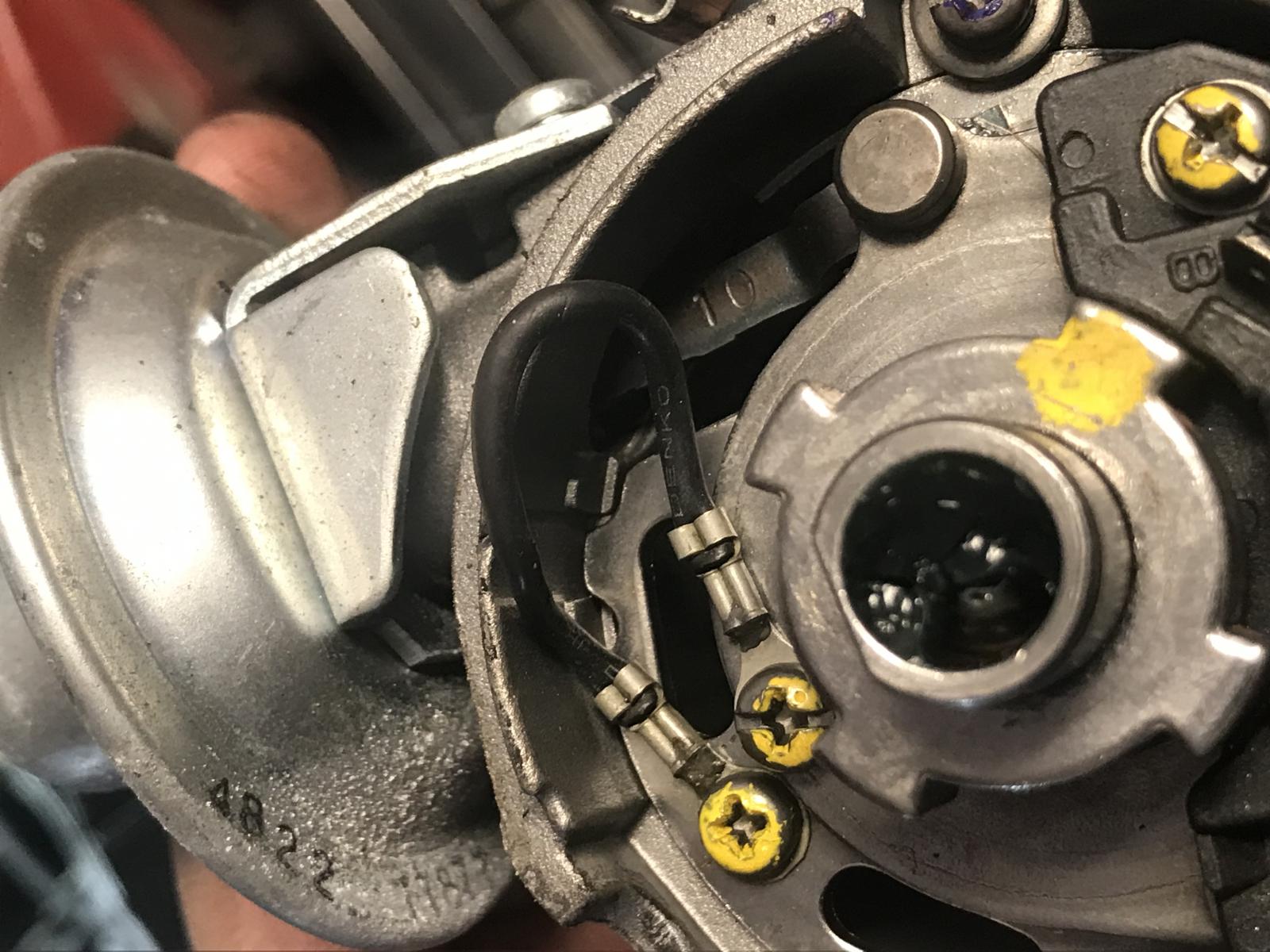

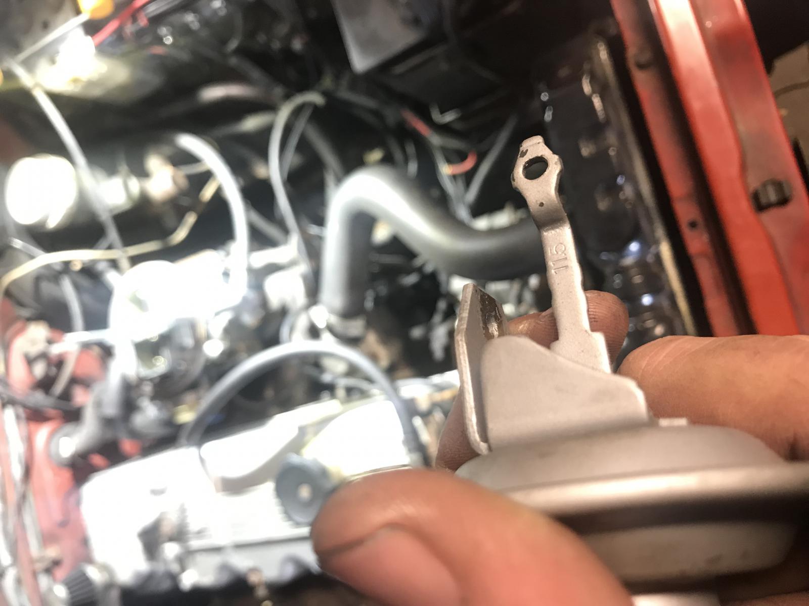

I suspect it runs best at 5 degrees because the vacuum is over advancing it. The arm on the one that did not work was stamped 11.5 I measured the travel at 5mm, so i'm not sure what the 11.5 means. Maybe corresponds to a vacuum level to make it actuate? I may pull my distributor tomorrow to replace the distributor drive gear on the cam. I have been meaning to put it in for a little while now. If I do I'll pop off the vacuum unit and see what the numbers are that are stamped on the one that works well.

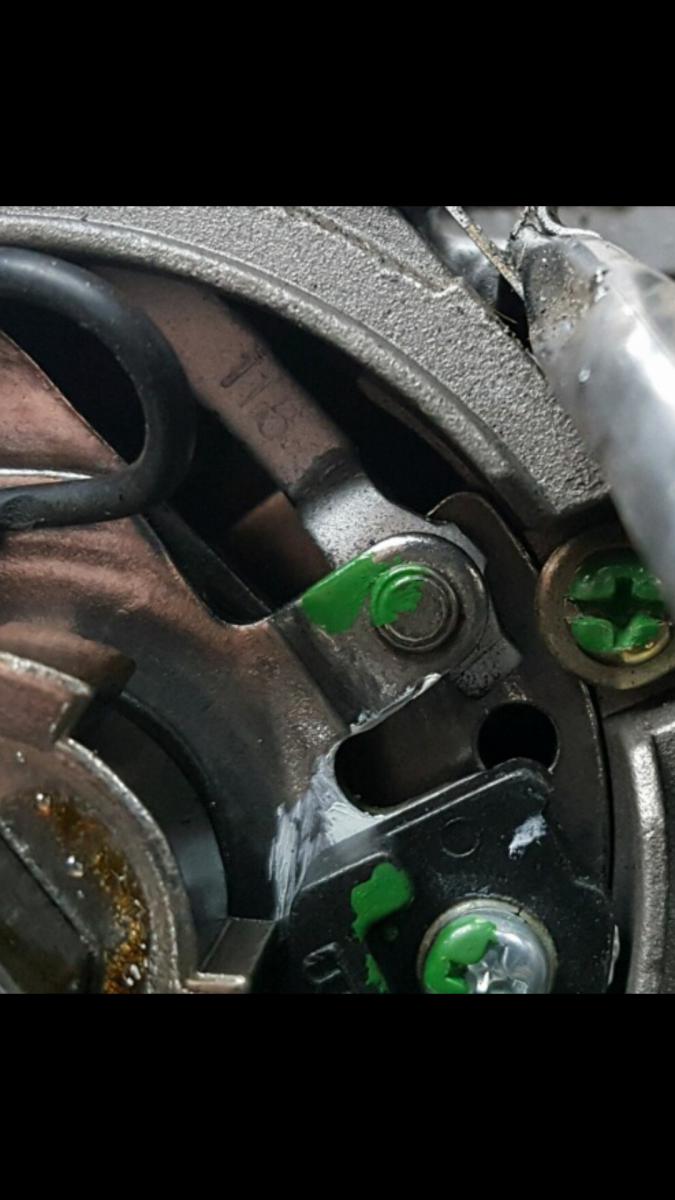

Attachment 21509Attachment 21510
Not the best shots, but you can see the numbers stamped on the arm. When I installed my new distributor it ran like crap. Check to see if you have any numbers stamped on yours. 11.5 was no good. 10 runs great. Luckily I had the new advance unit sitting on the shelf. I had planned on overhauling the original dizzy, but I had a ton of wear in the mechanical advance that was more trouble than the cost of a new one.
Ah, ok. It's not what I thought - it's the servo linkage. Nup, doesn't help. Still haven't got a clue what it translates to...
I will definitely pop mine open to check it.
Attachment 21529
Looks like 11.5 to me. Any suggestions where to find a 10?
Mine was from rock auto. Standard Motor Products VC268. About 15 bucks.

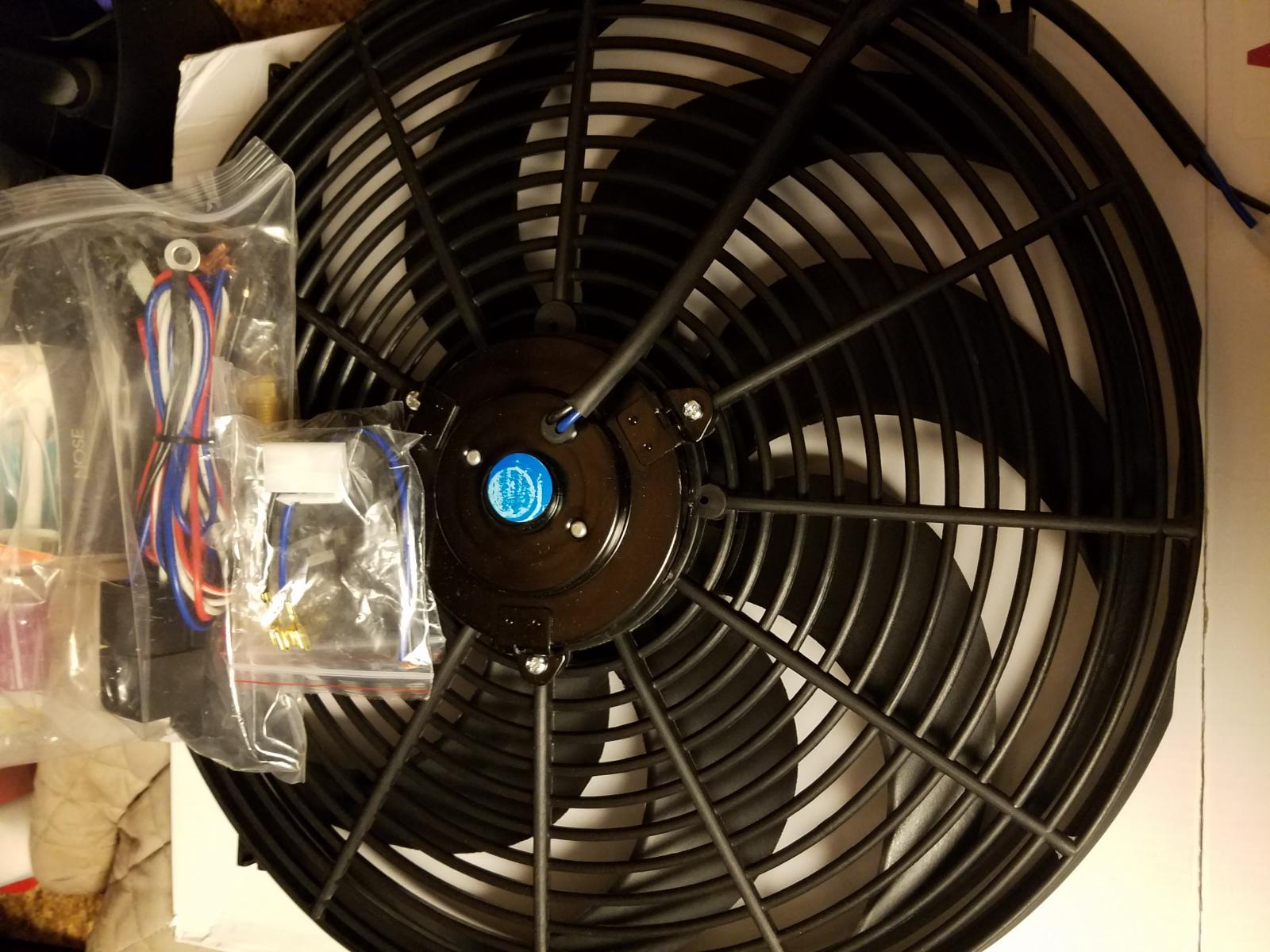

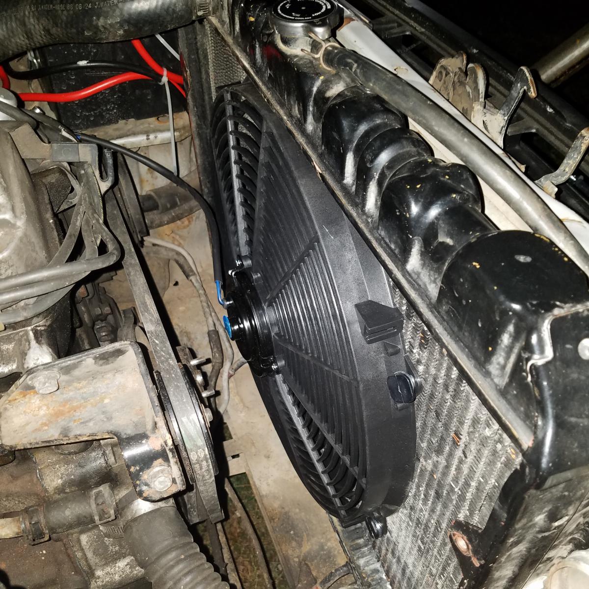

Finished wiring up the new electric fan. Everything seems to be working good. Gonna test drive it tomorrow to make sure. Seems to be moving some good air.
The old junker did great today. Usually by time I get to the farm (45 min drive) and go to climb the hill it's always running hot when i get to the top. Today it was still normal temp and stayed normal while pulled my brothers jeep Cherokee out of the mud. All without shutting it off to let it cool down. But I did find I'm in need of some rear tow or anchor points for sure.
