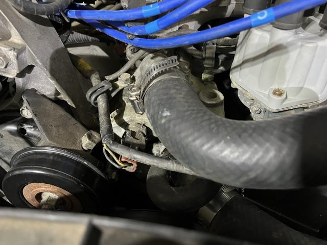

I've tested or replaced everything except the coolant temp sensor, there appears to be 2 separate sensors, not sure what the rearward sensor is. http://www.mightyram50.net/vbulletin...id=27275&stc=1
