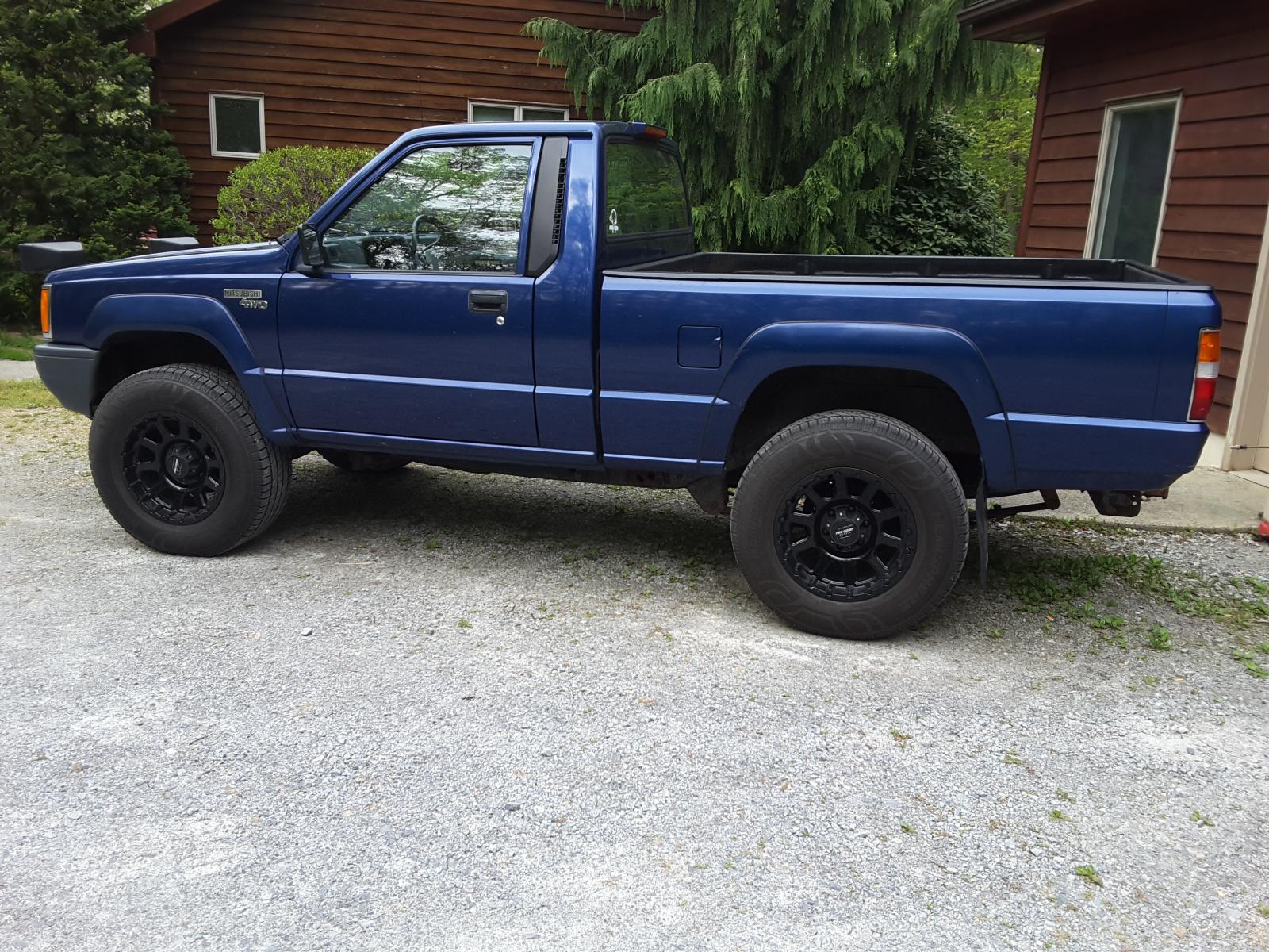

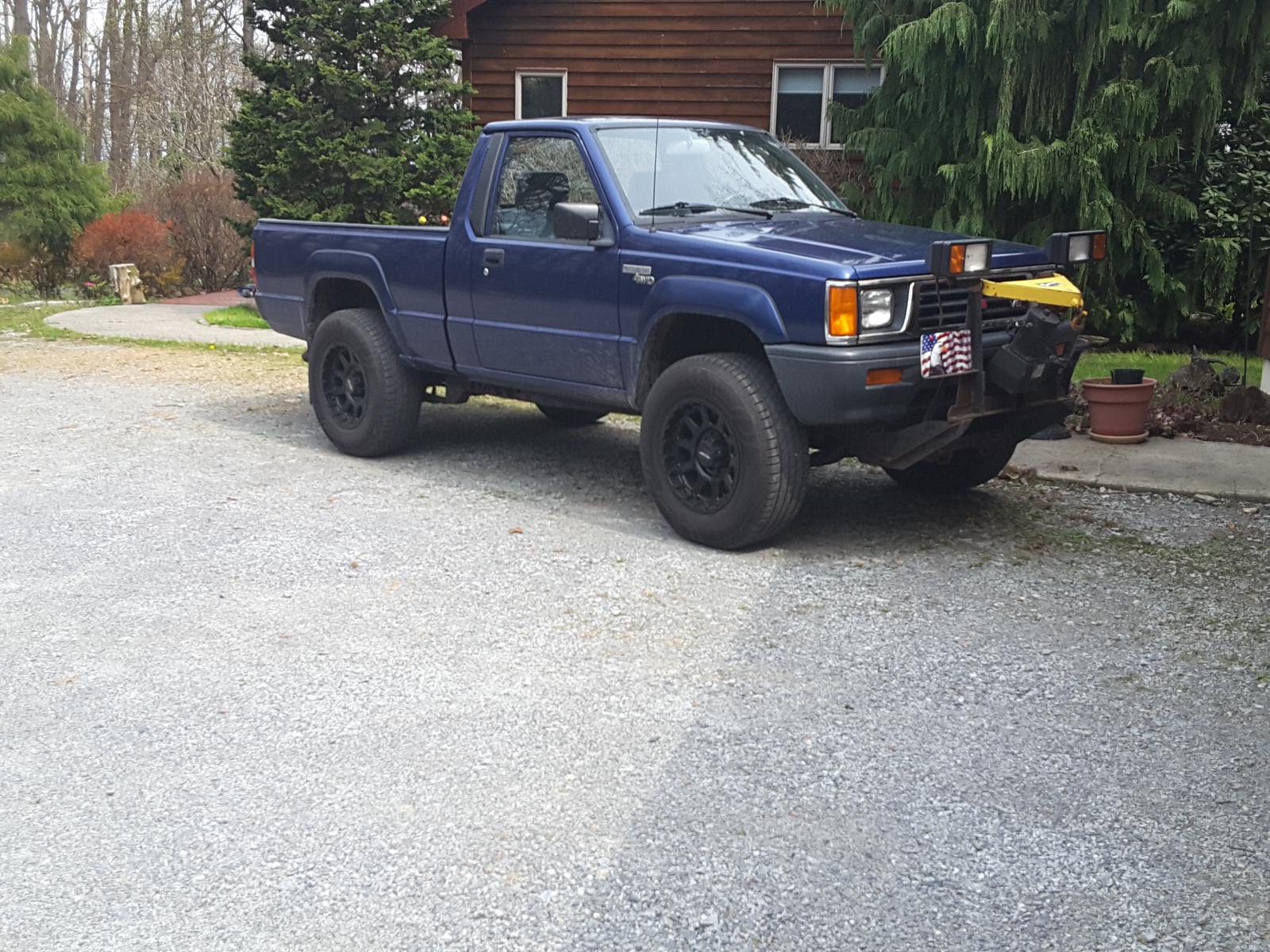

Cranked the torsion bars up, replaced the shocks all around, bought some new but not able to be used pro comp rims and loaded so e 265/70R17 tires on her because i had the tires already in the barn. Po said he thought the ac needed a charge but it was overcharged and vac'd it out, loaded thAttachment 25396Attachment 25397e right amount back in and cold ac, low milage Mad Max lives on and still turns some heads. I did trim the bumpstops in 1/2 to get a bit more lift and did mild trimming at front wheelhouses for better tire clearance.

Niiiice. Thanks...i'll probably pull the fuses and plug module back in to see how that works. There is alot of wires on that plug and would think antilock rear brakes wouldnt take that much electronic controls to work or not. Thanks for the parts numbers too but im not going to get them working correctly. Take care and shiny side up.Attachment 25400
Nice. The mystery module was a distraction, but it's always good to get to know your ride. Having everything working is better than everything not working. Blue Max - Geezer approves :thumbup:
