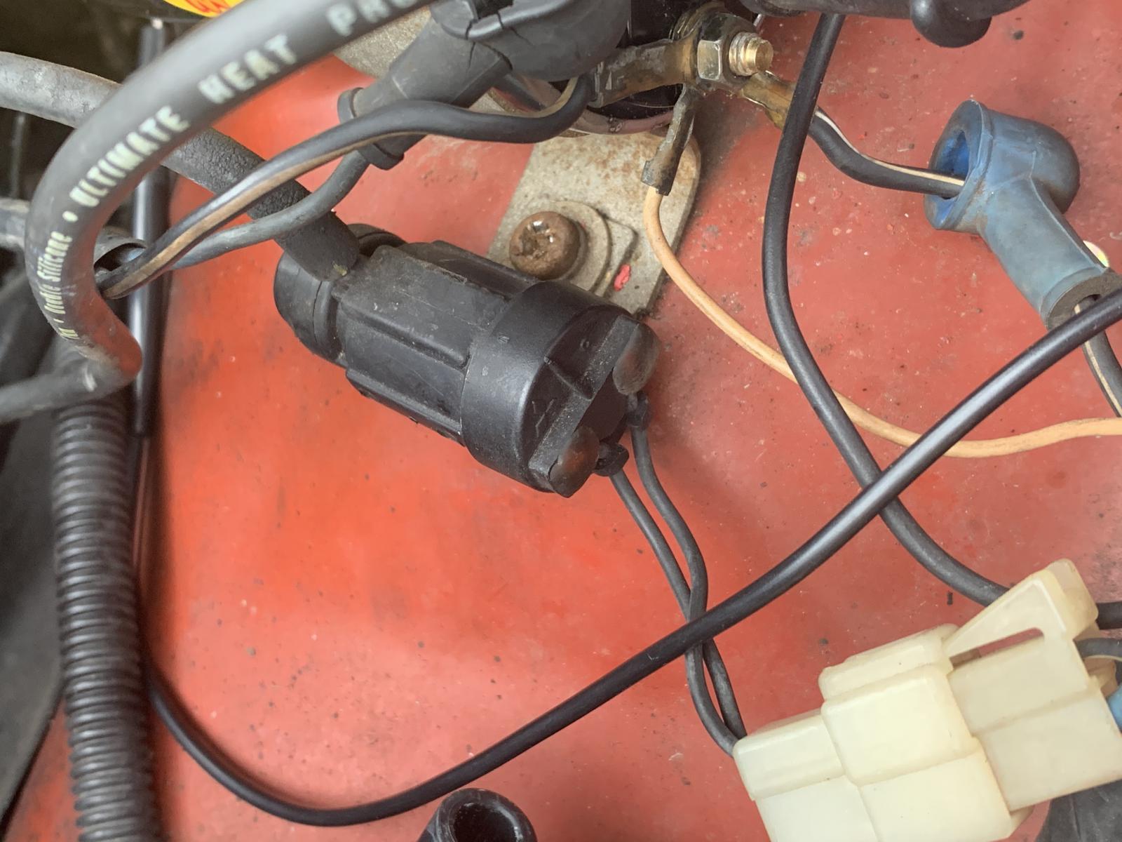

Well, this little black switch mounted on the same bracket as the ignition coil with a vacuum line to it is getting hot...not sure what exactly it does. Electrical harness with two wires on one side and a vacuum line on the other? Attachment 23825
ANNNND I UNPLUGGED IT AND IT STARTS what is this LOL
Well ladies and gentlemen, that... is a new one. I personally have no freakin' idea why the ignition system would need a vacuum triggered cut off/activation switch but that's what it looks like. The fact that it is getting hot means to me that it is causing a dead short across the coil (there must be a load being put on it for it to generate heat...:shrug:) Where does the other end of the vacuum line go to? It would be a little tricky to test it as you'd need to be cranking the engine while applying a vacuum to the... 'thingy' to get it to break the circuit and allow the engine to fire.

OK another theory from Geezer - the vacuum switch disables the ignition coil when there is zero vacuum available so it might be (for some bizarre reason...) there to kill the coil to prevent the run on issue after the ignition is killed (still don't know why it would even need it). The ignition advance servo is on the distributor so that is a different control peripheral. If it's running on afterwards, check your ignition timing and check your plugs to see if it's running rich. The run-on is not good for the engine. Gen 1's came in 2 load ratings - 500kgs and 1000kgs. The 500kg rated trucks are easy enough to identify - just look at the tail/drive shaft. If it looks like the diameter of the shaft is on the thin side, it'll be a 500kg truck. AFAIK the differences between the 2 rated load capacities are the drive shaft, the front stabiliser bar and the upper control arm pivots. Not sure of the spring ratings but it would be logical that there would be an uprated spring on the 1000kg trucks.
Hmm this thread is interesting! Similarly to what geezer mentioned that vacuum switch could be for if someone turns the key on but doesn't start the truck and the rotor happens to be sitting on one of the firing positions it could maybe turn the coil on for too long thus burning something out? I believe this sort of thing happens with points ignition and now im thinking this may be possible with early style electronic ignition. maybe thats why they went to the later style ICM around 84' or so. Now i'm super curios what thats for and how its wired lol. maybe my generic chilton manual covers this setup, ill have to dig it out.

One other thought, make sure that the vacuum solenoid you unplugged isn't connected to the vacuum advance in any way.
Good Luck!
Sorry it took me so long to find my Chilton book, but better late than never i guess. Here is a picture of 82-84 ignition wiring. I see a device labeled "solenoid valve" that is most likely that black vacuum device near the coil. it is controlled by a relay labeled "ESS relay". Ill study this diagram later tonight when I have some time and see if I can come up with any scenarios that would cause issues with anything shorting something out. Giovanni has great points on the coil compatibility and the vacuum advance sticking etc.
