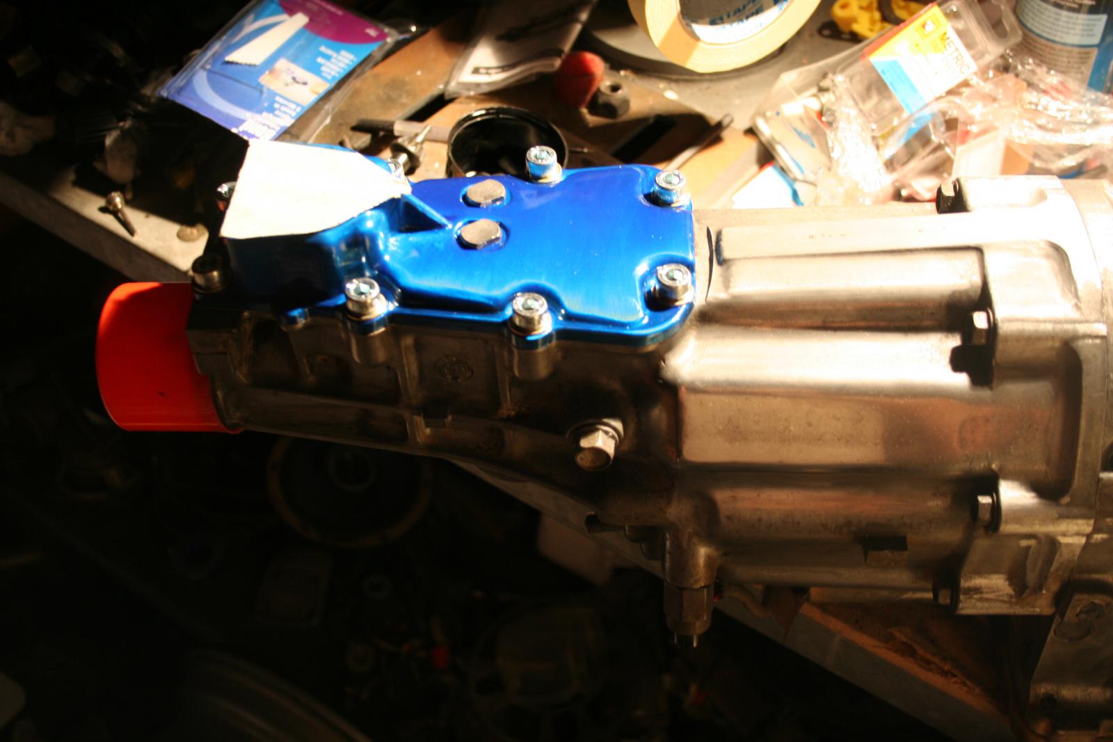

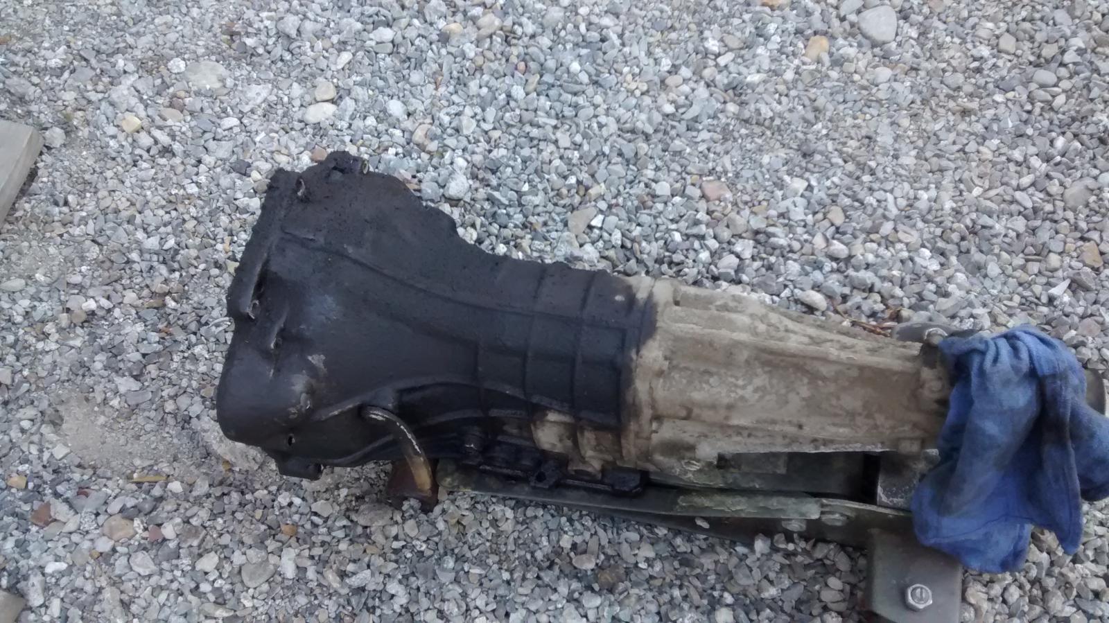

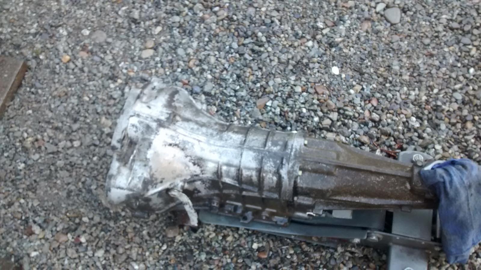

I had to take the flywheel in for a resurface. It was only 50 bucks and the guy that did said it looks like the original one and that he didn't have to take hardly any off. I got the tranny cleaned off today and figure the mess was caused by the valve cover gasket or the half circle rubber gaskets things. It'll take a while to get a new set but that's to be expected. I have to do the rear seal of the trans and might as well do the rear main while I'm in there.Attachment 22631Attachment 22632
