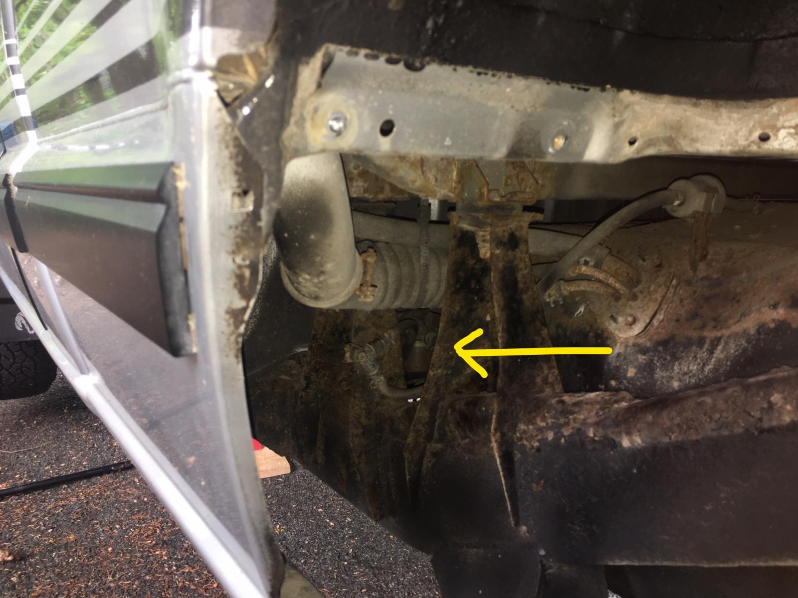

Any luck with accessing the fuel filter? I recently bought an '88 MM, 2WD with the standard cab and 6ft bed. I can see the fuel filter in the same location that MrPaco has been describing. If I really work at it, I can fit my arm in there to reach it, but actually removing the fuel lines from the filter, and getting it out of the mounting clip would be a minor miracle. Some sort of access panel would be great...

As you can see from this thread, the particular configuration that you have (2nd gen, carbureted, reg cab, short bed) has the filter in a very hard to access place. Most likely because the space where it goes on macro cabs and long beds is too tight on the regular shorts.
I figured out a way to access the filter, it's still pretty tight, but doable. You have to lift the truck and remove a panel in the rear wheel well, and then you get a semi straight shot to the filter location. It's still tight, but at least you don't need to bend your arm in unnatural ways.
Lift the driver's side from the frame (not the rear axle, you want to the wheel and the well to go on opposite directions. I actually had the truck lifted from the front when I did this and it worked fine.
Then take off this panel by removing the 10mm bolts
http://www.mightyram50.net/vbulletin...id=22609&stc=1
You will have a straight shot to the filter from there
http://www.mightyram50.net/vbulletin...id=22610&stc=1http://www.mightyram50.net/vbulletin...id=22611&stc=1
Like I said, still tight, but you can get to it. First get your hand on the filter, unclip it from the mounting clip, and gently pull it out to towards you, there's enough slack on the hoses to do this.
I didn't actually change the filter when I did this, didn't have a replacement on hand, just wanted to see if I could get to it. Unclipping the hoses and replacing the filter will be hard to do one-handed, and to get both hands in there you will probably need to remove the wheel to give you more room to work.
Let us know how it goes once you attempt this. And you might want to have some extra nuts and bolts on hand for that panel, I broke two of them trying to get them out. Luckily they didn't really create much trouble, the panel still came off and I was able to drill out the remaining stems and replace with new ones like these

Coming to this post in 2022. My 88' Mighty Max appears to have a fuel filter located above the tank (inside the frame) like the photo above. What was the best method for reaching it? I have a few small access panels in the wall of the bed that I could look at removing (screws currently stripped) and a panel in the wheel well.
Thanks for putting all of this info together, and thanks for your advice.
I figured it out. Was able to squeeze my hand in behind the frame to lift it out of the factory mount. Then, reaching in from the wheel well (had to remove the panel), I was able to snake it out like mentioned above and change it out. This method worked well and only took a few minutes once I figured out how to pull it out of there.
