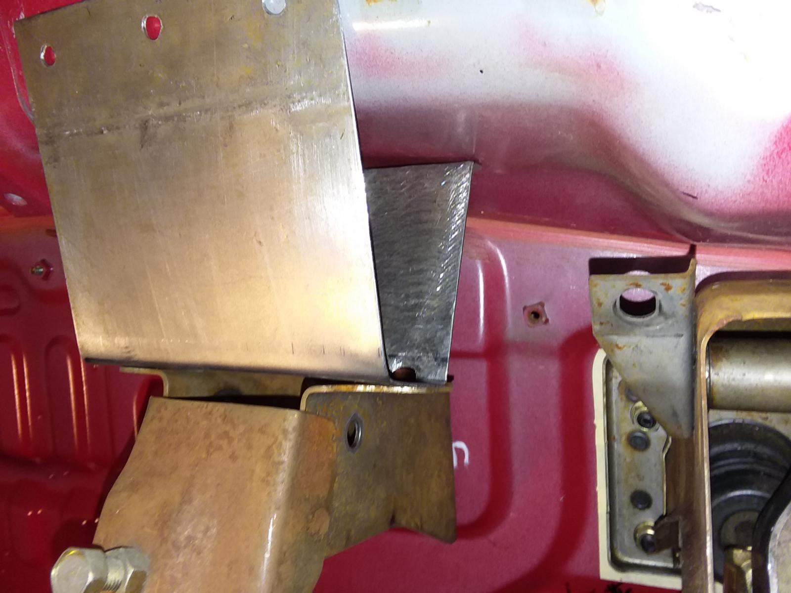

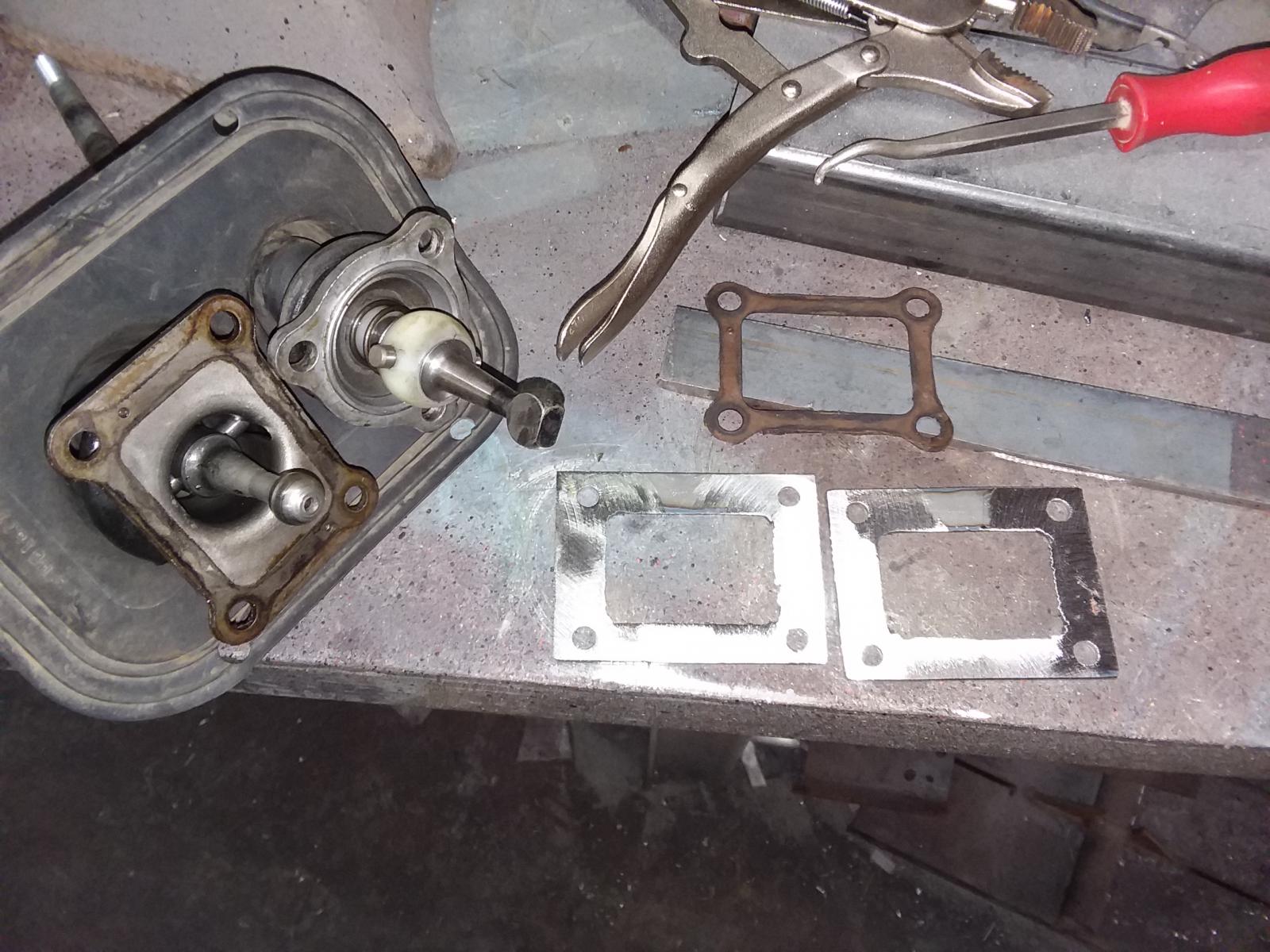

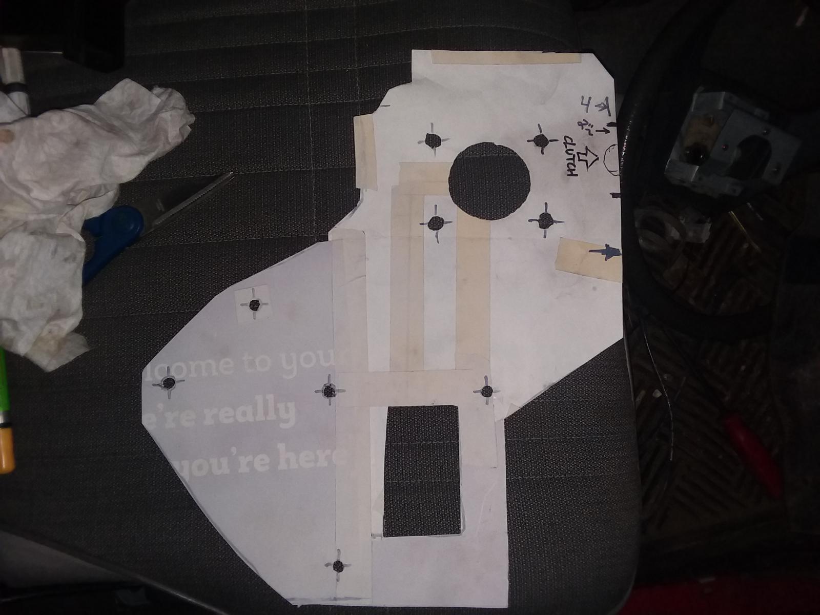

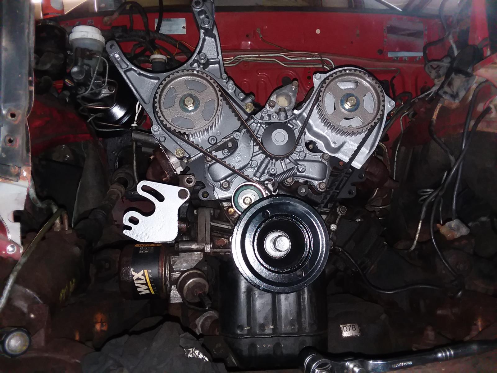

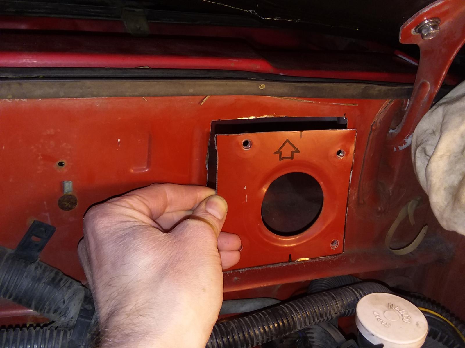

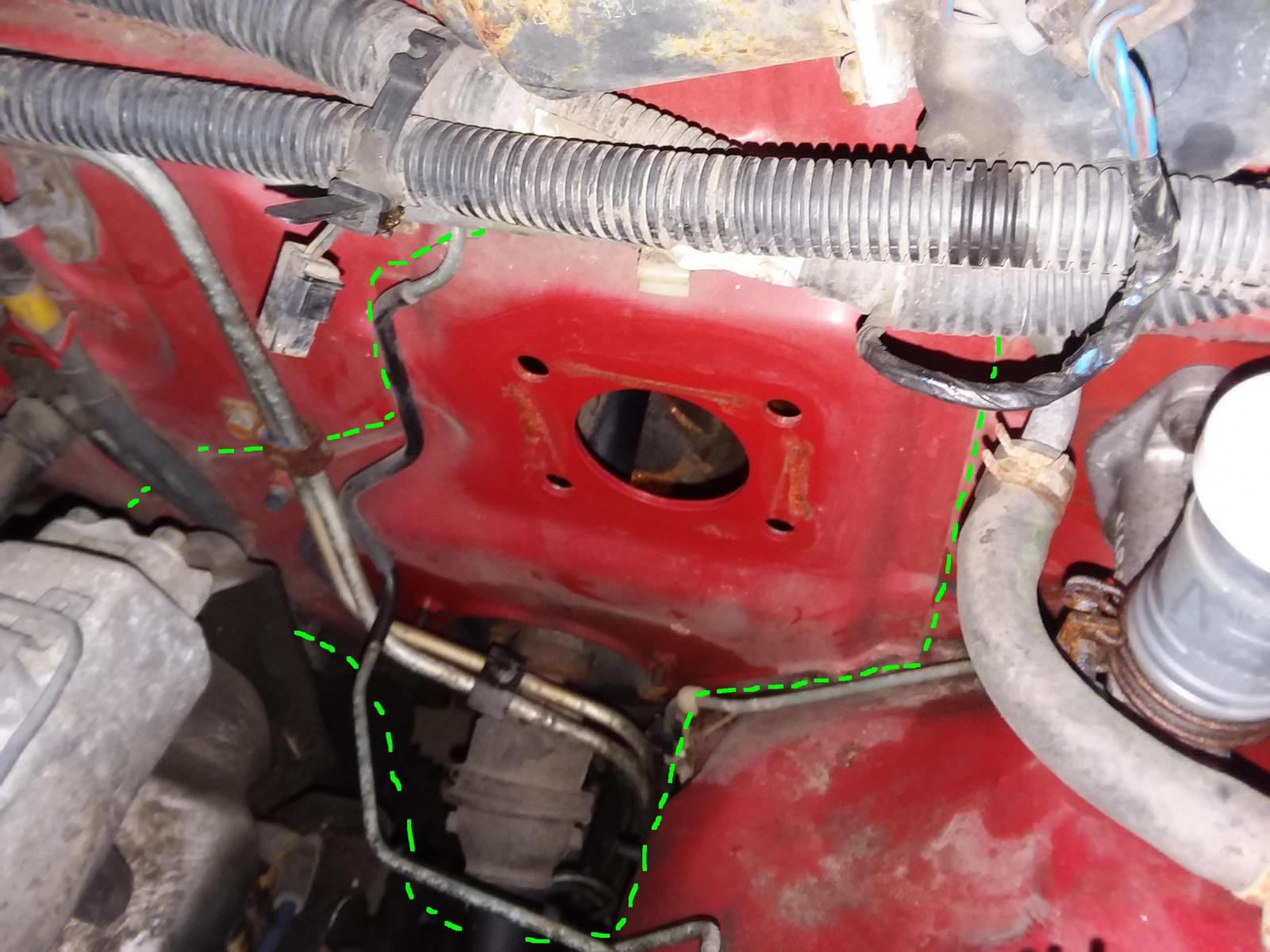

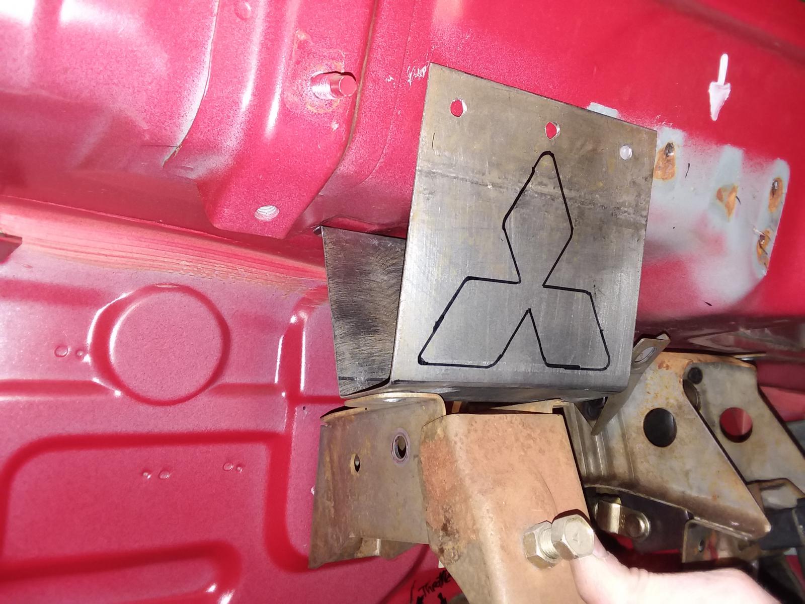

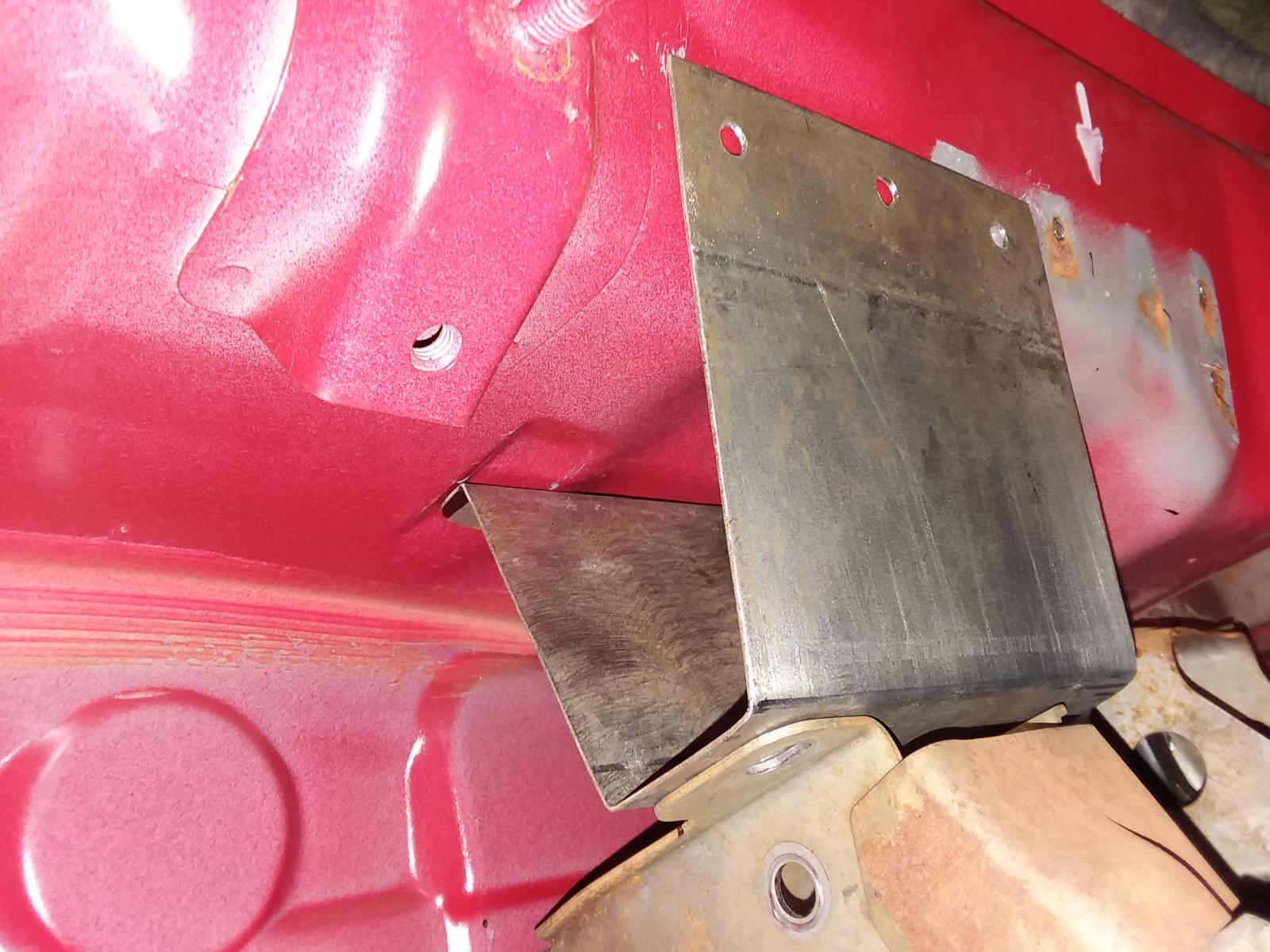

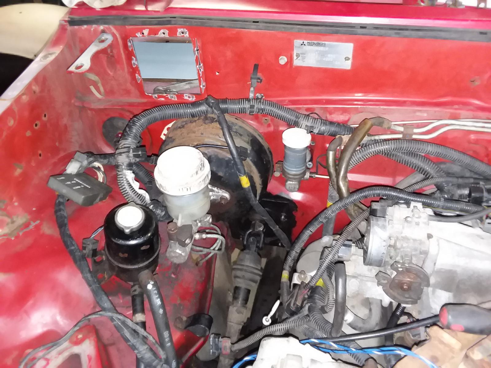

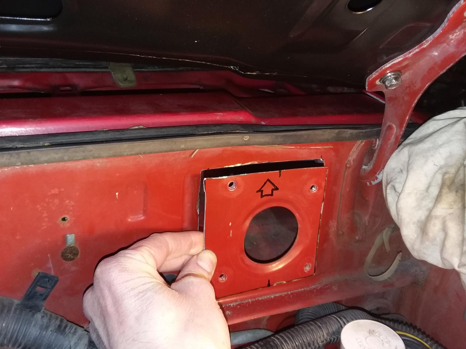

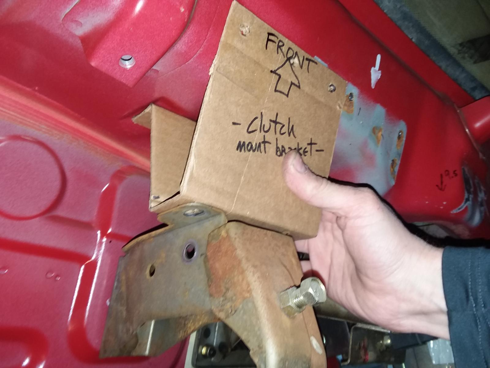

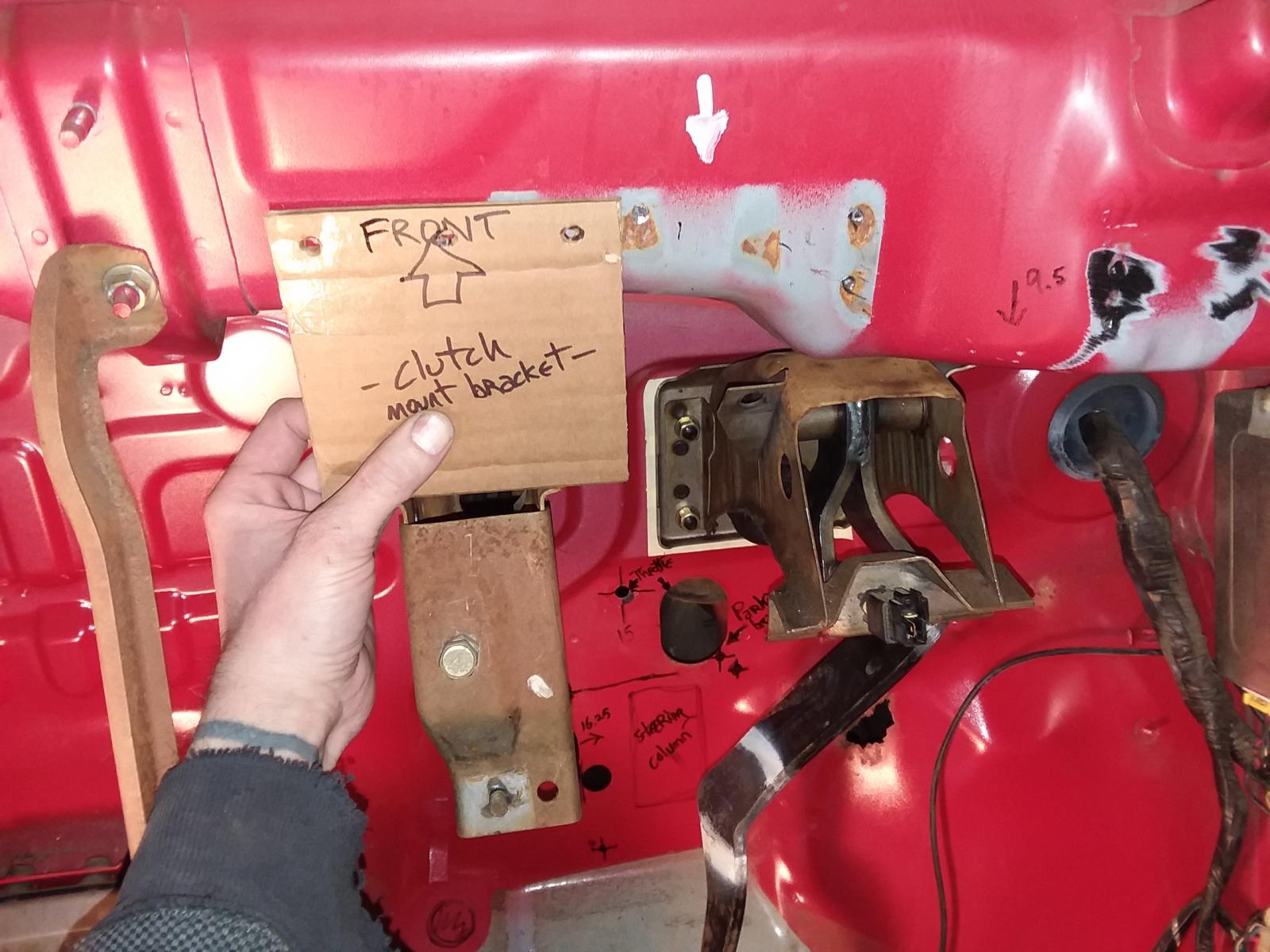

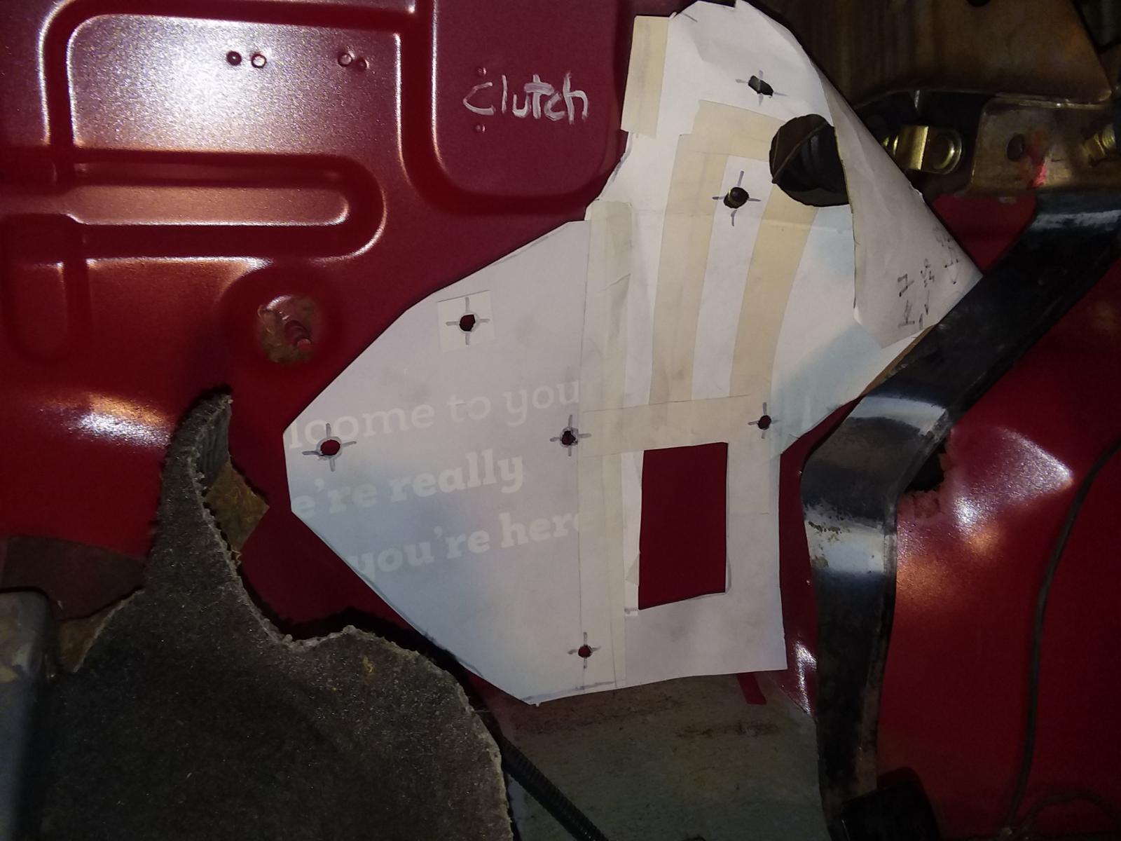

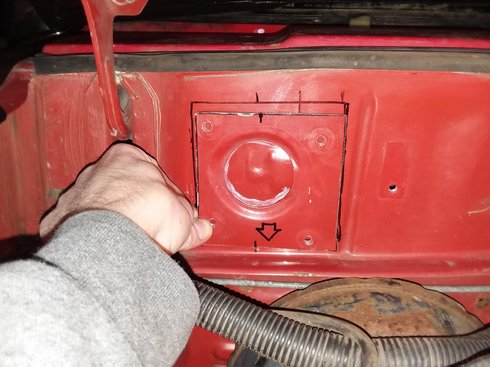

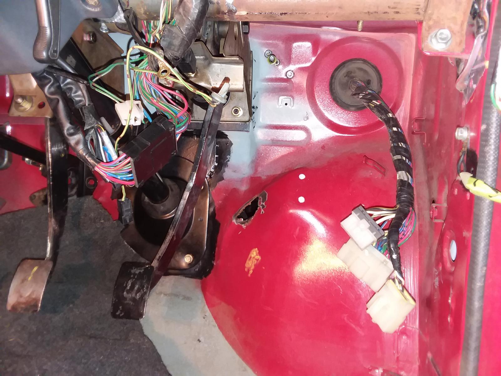

so i made a template of the OEM firewall re-enforcement plate for whatever stupid reason
as afterward i realized that its a totally different layout on the right side of the firewall...
whatever.
Attachment 21999

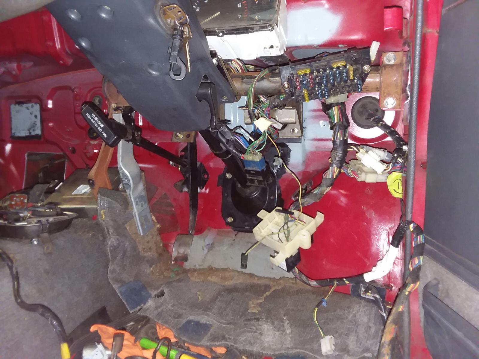

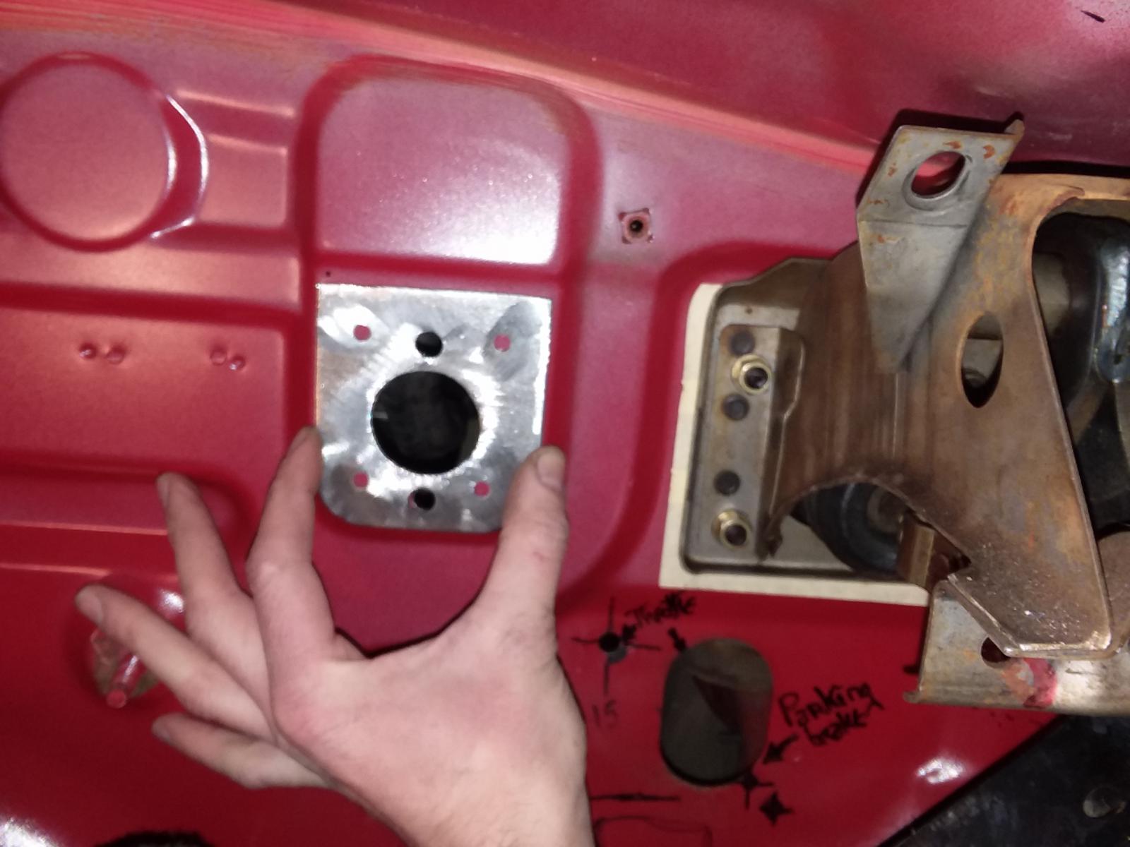

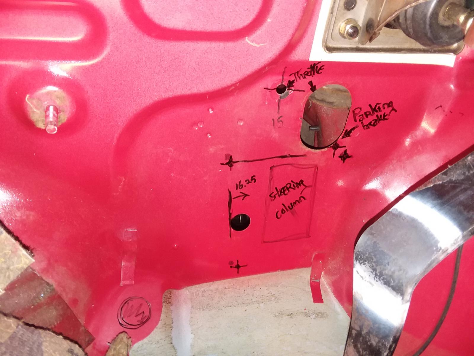

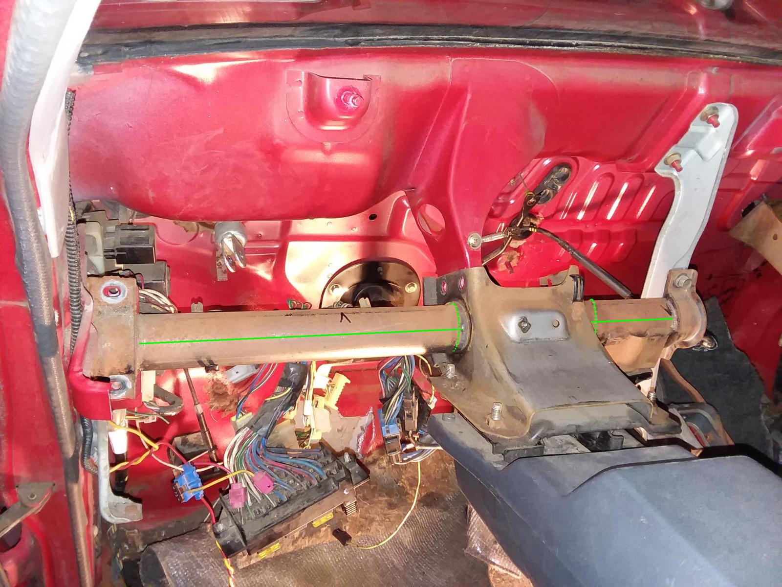

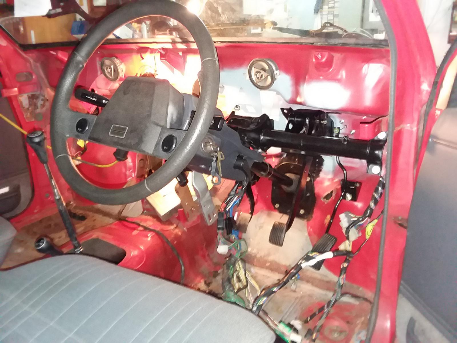

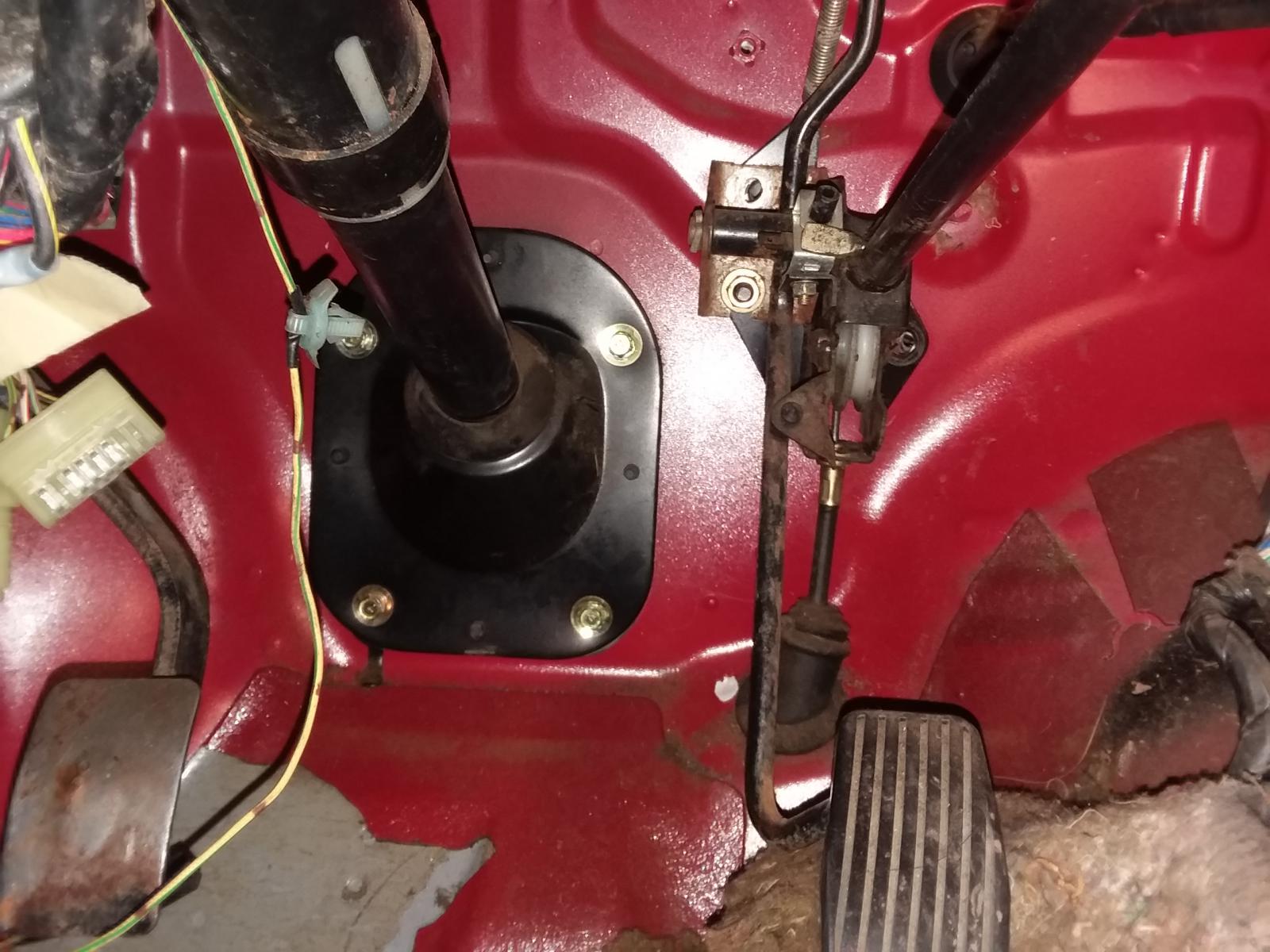

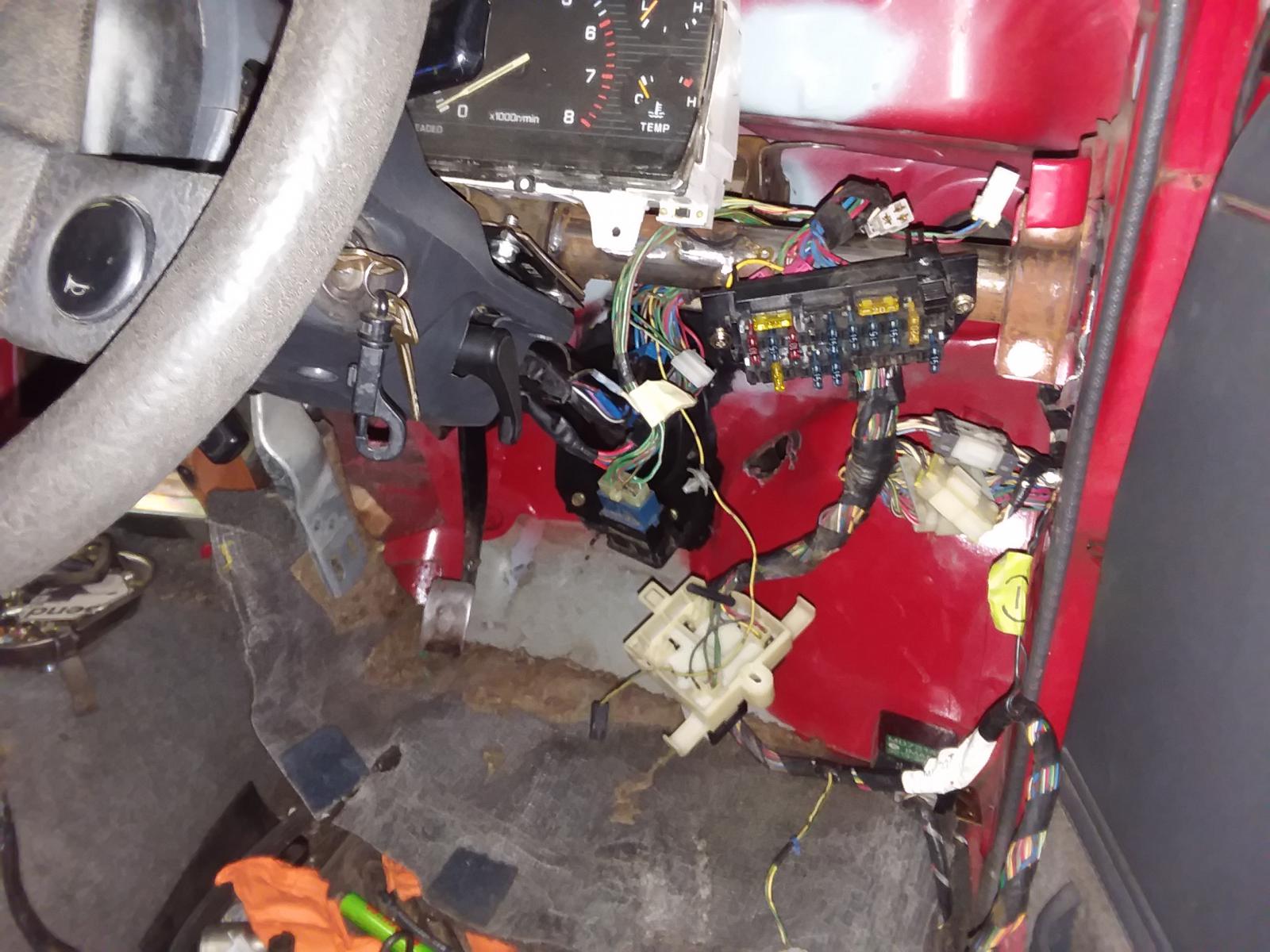

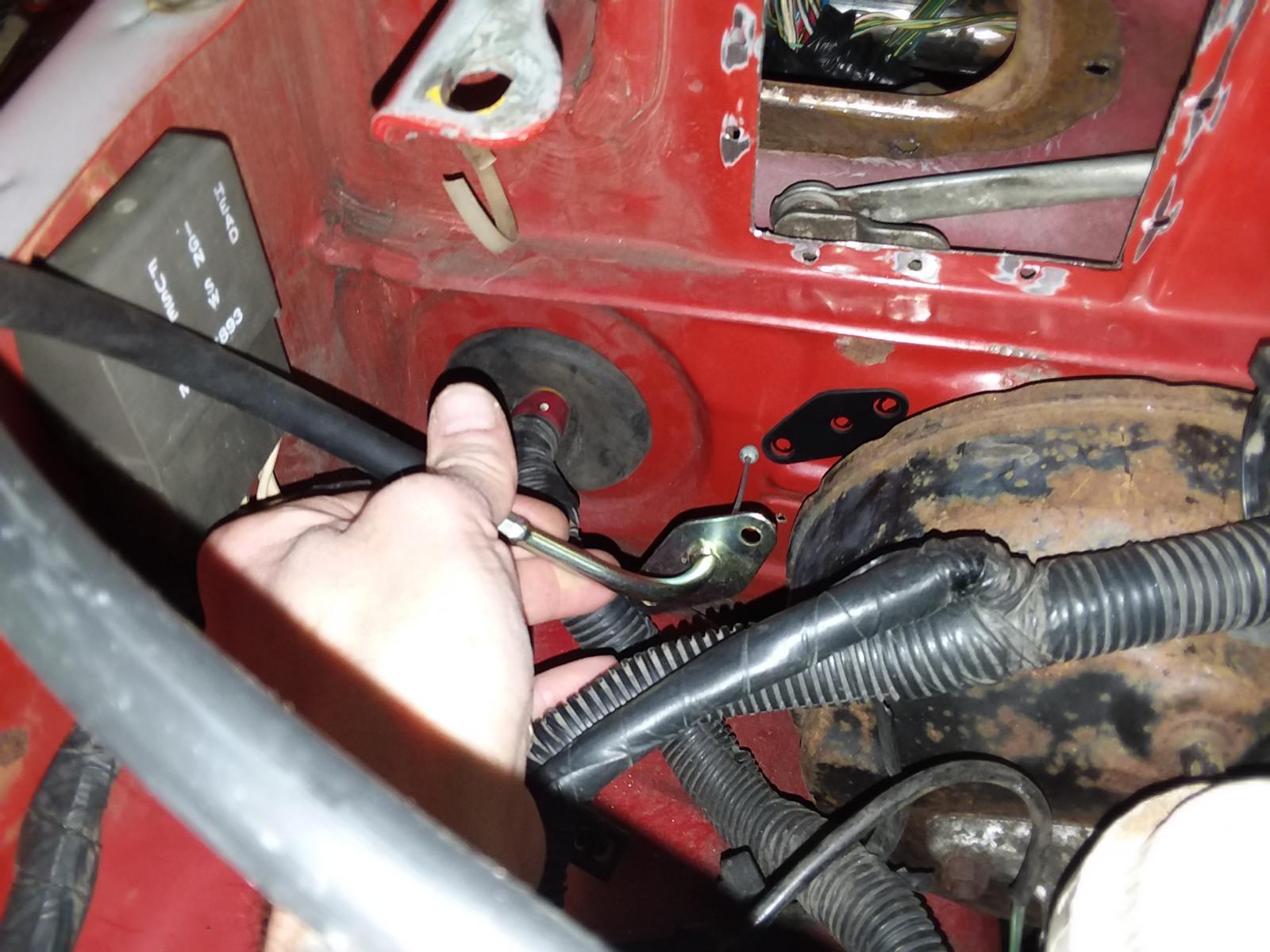

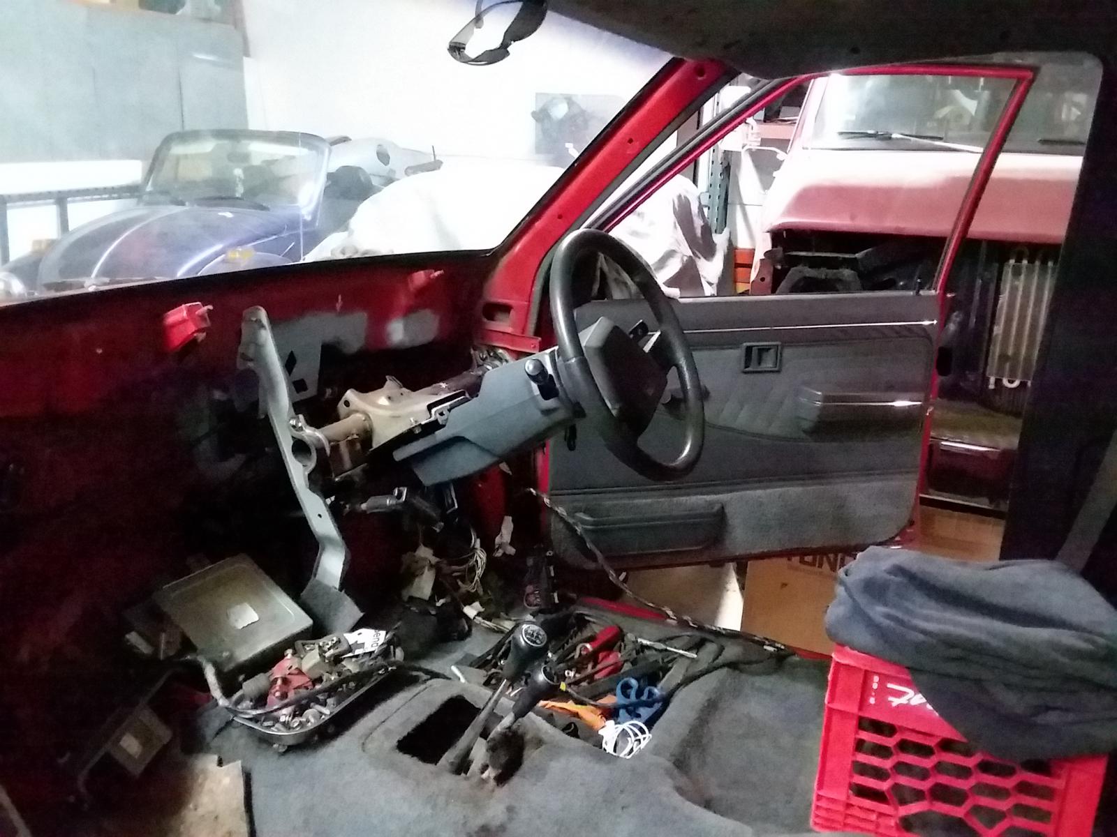

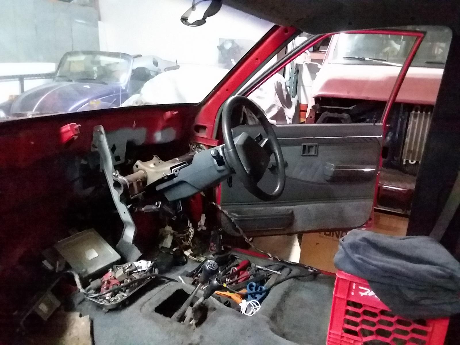

and i started to lay out the steering column port, its actually kinda in a similar spot as the
LHD template, im not going to drill/cut anything until the box arrives and i can move the
steering wheel permanently on the RHD-side. then i can see where the hole needs to go.

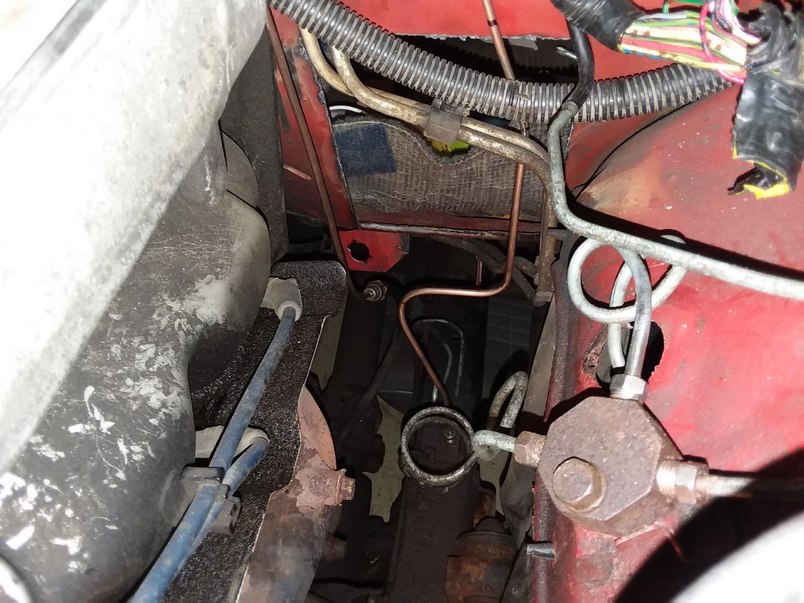

i dont think there is ANY kind of flex or u-joint INSIDE the firewall, the 1st on the column is
just past the firewall in the engine bay, the 2nd is down at the box. so the firewall hole/port needs
to be in the correct spot, then the shafts bushing/seal unit can get bolted to the firewall round it.

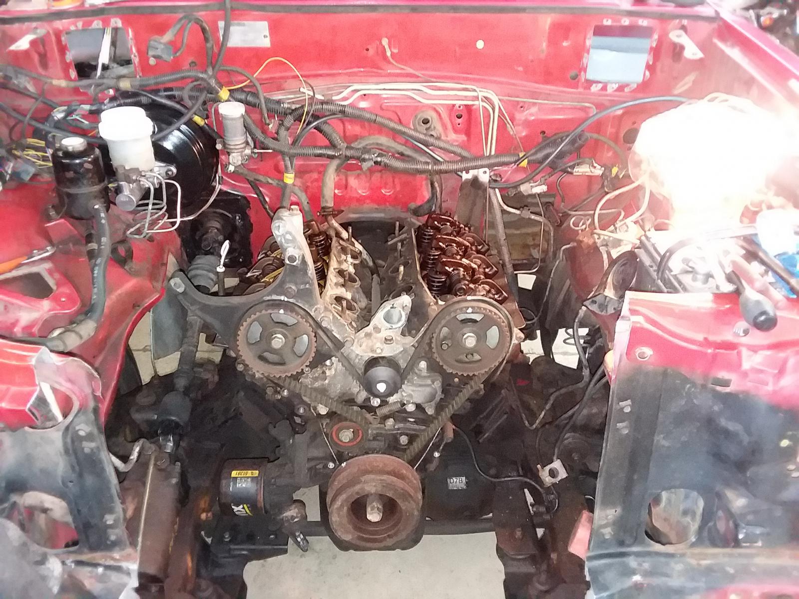

Attachment 22000Attachment 22001Attachment 22002Attachment 22003Attachment 22004

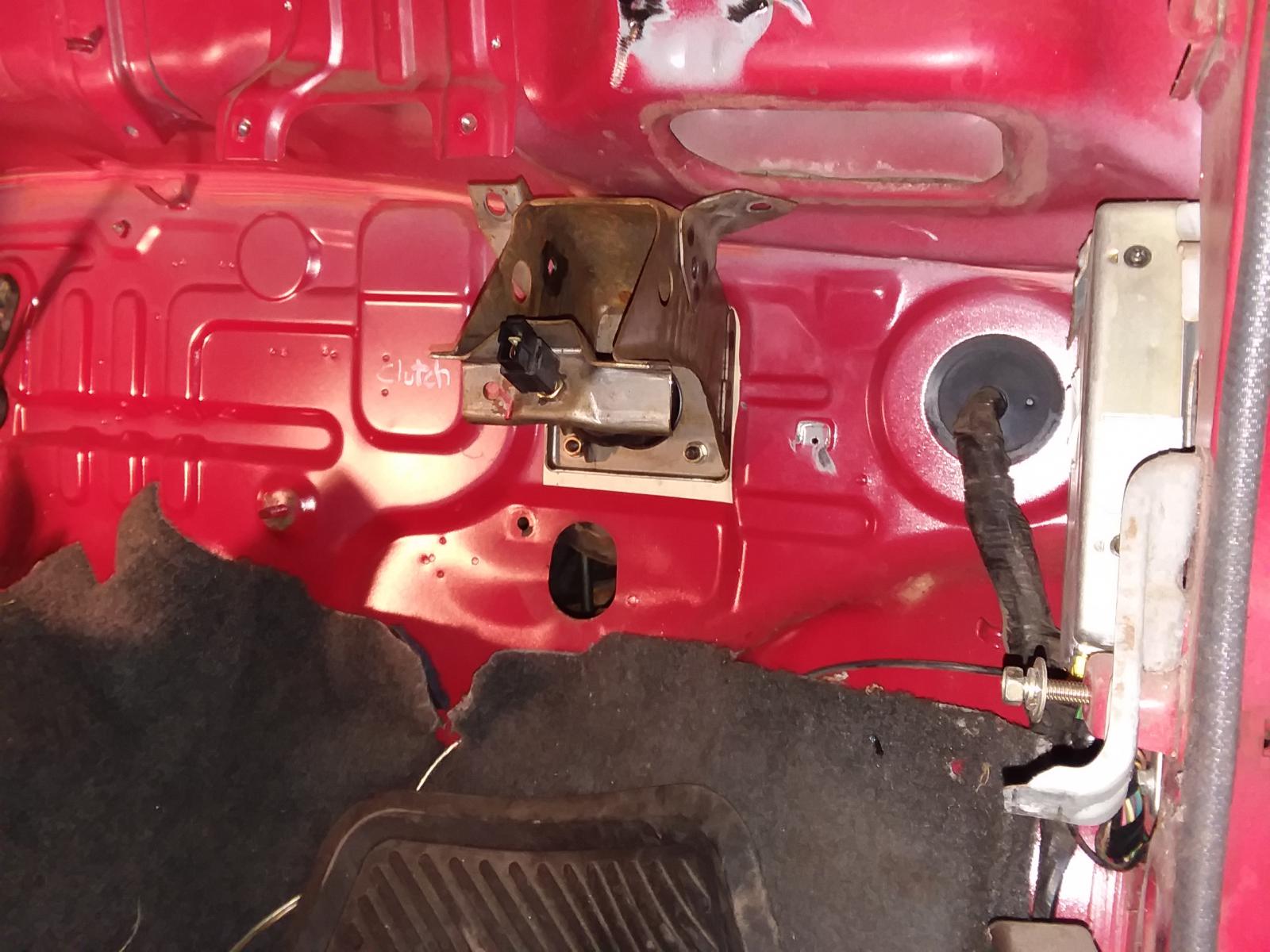

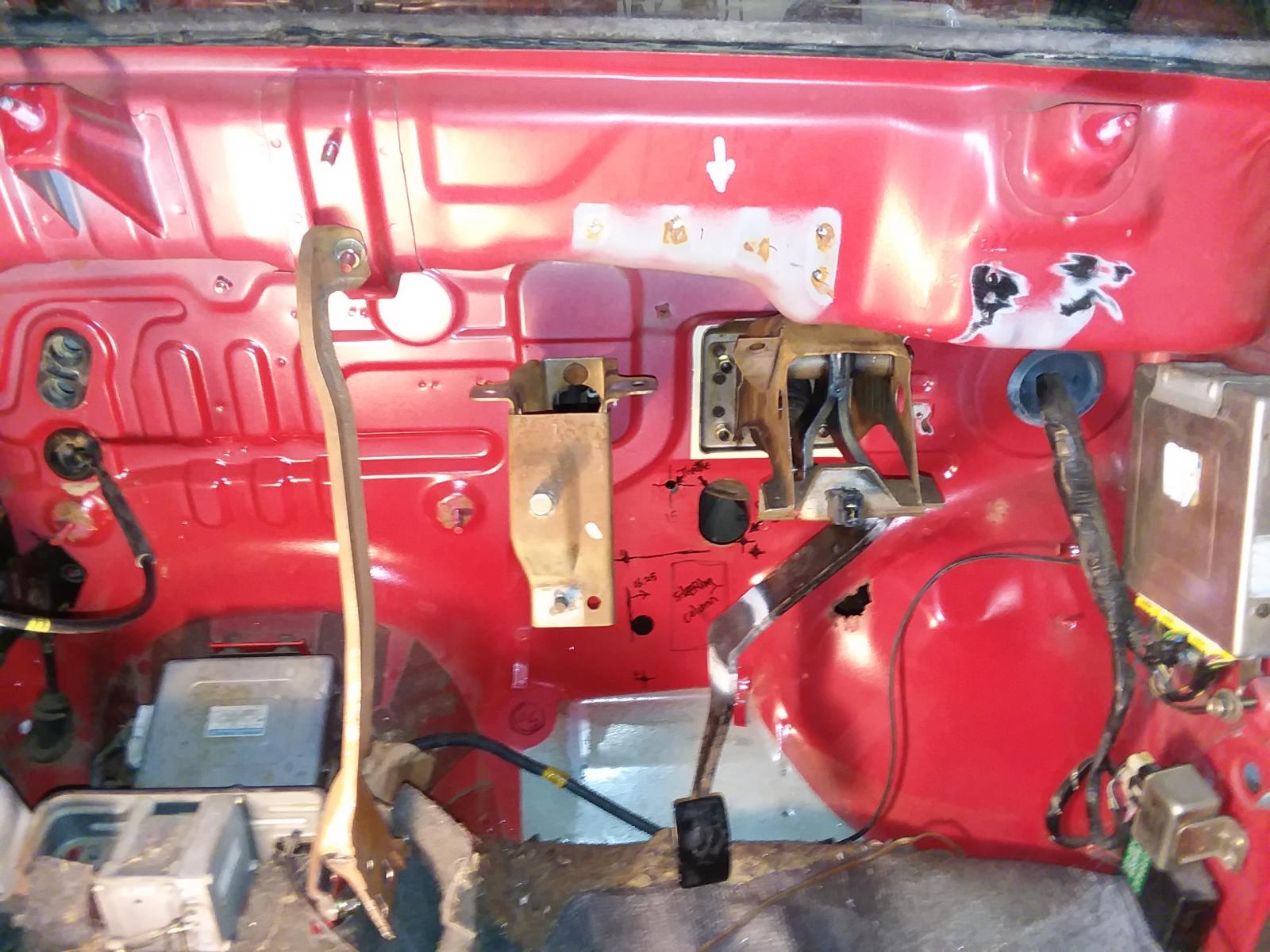

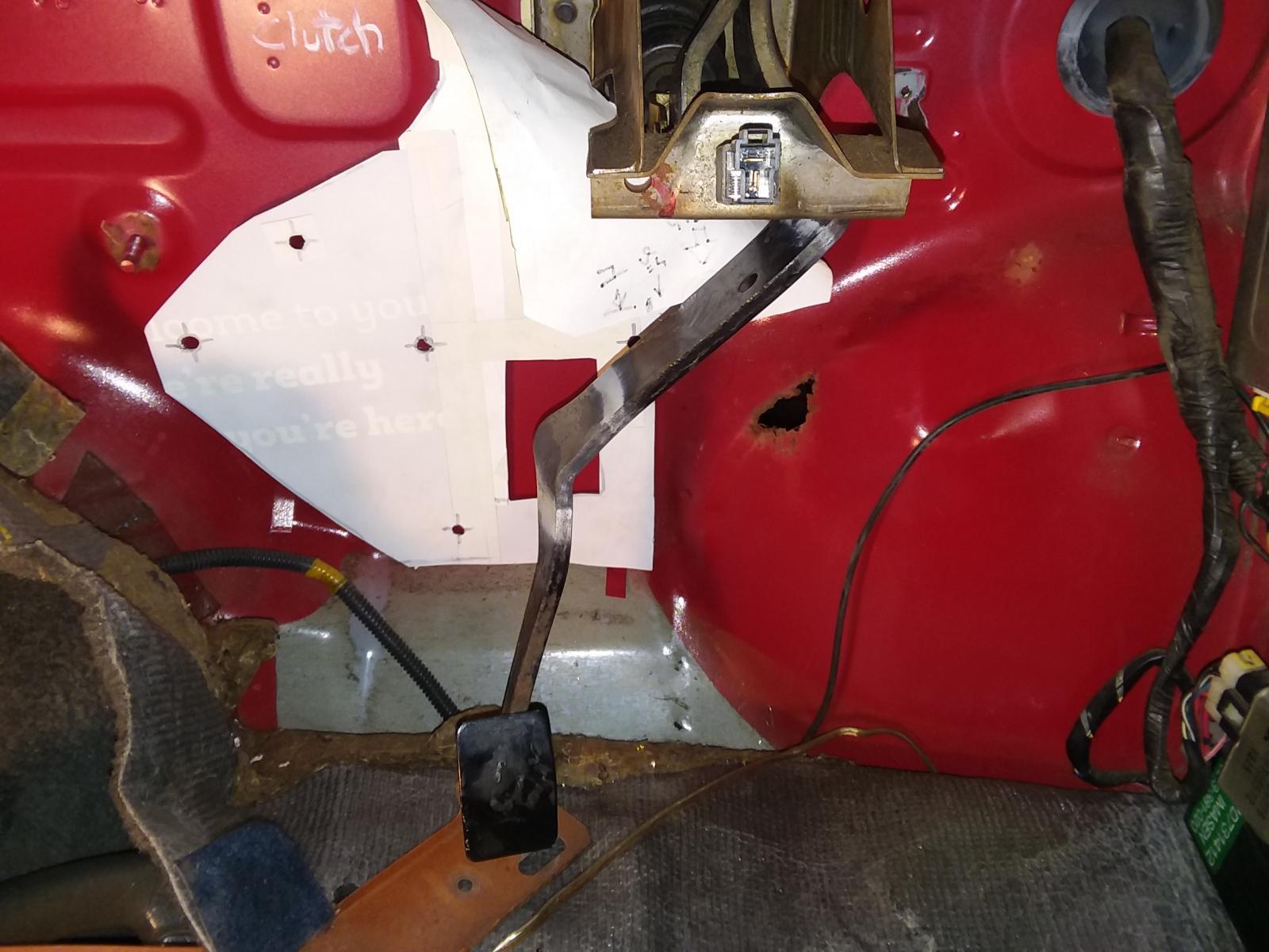

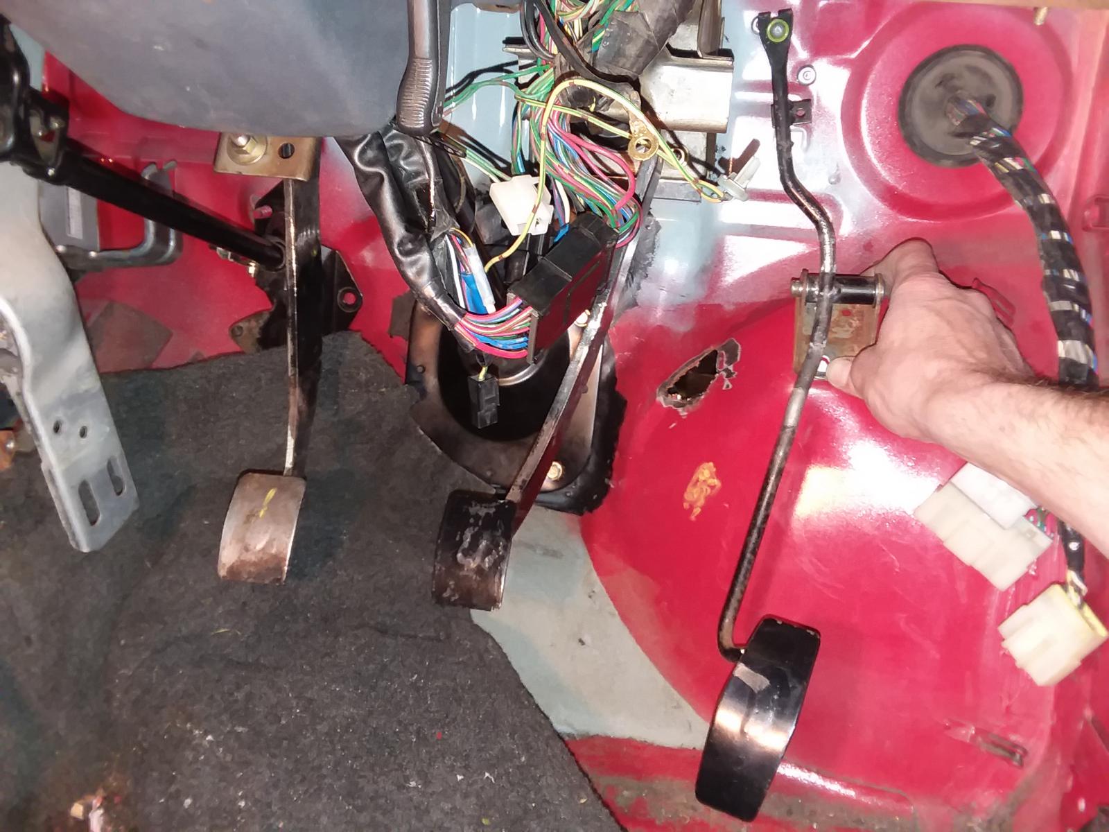

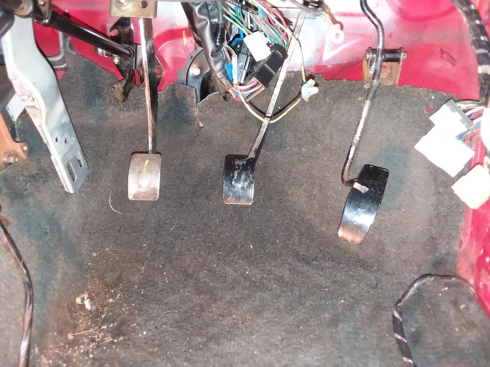

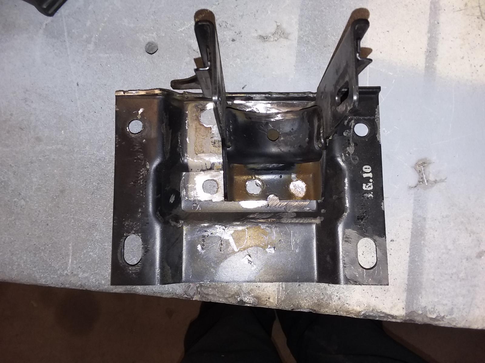

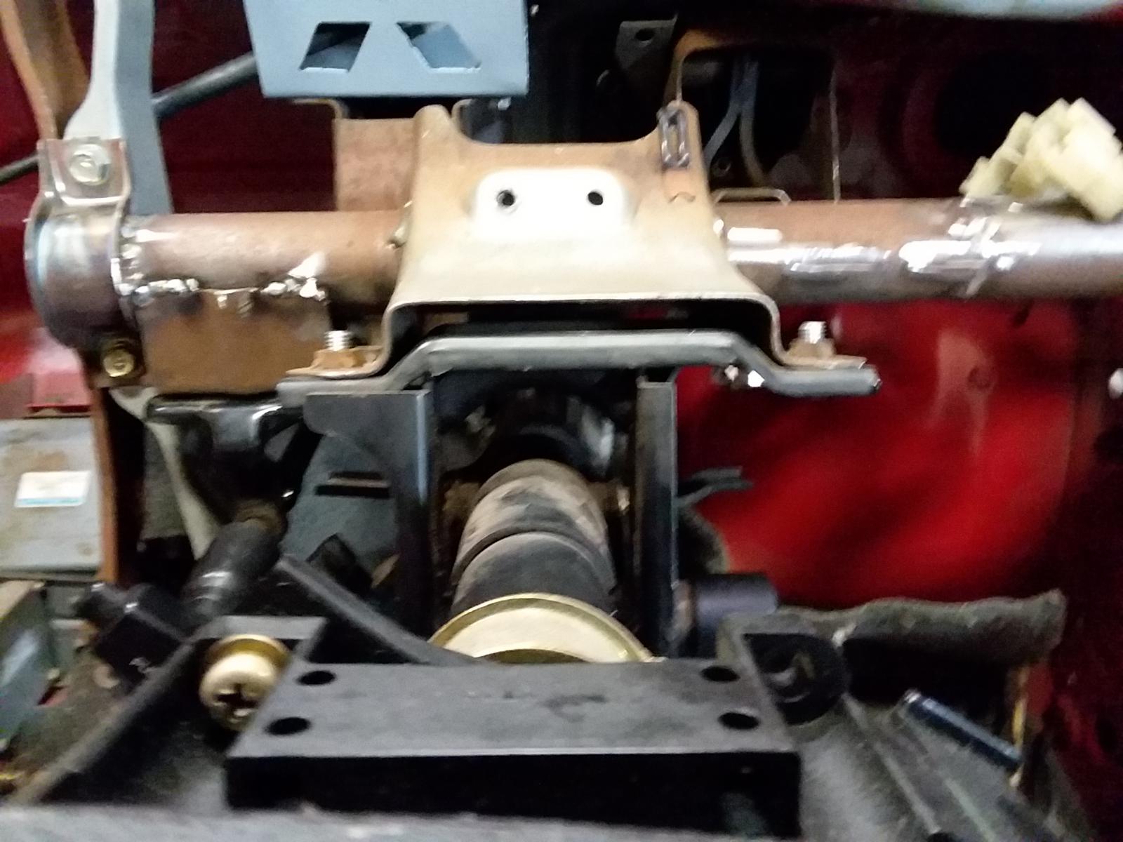

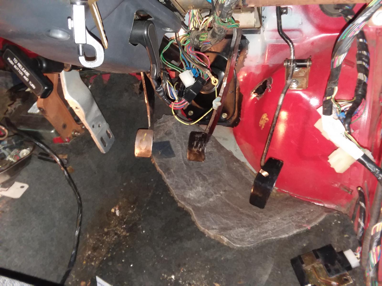

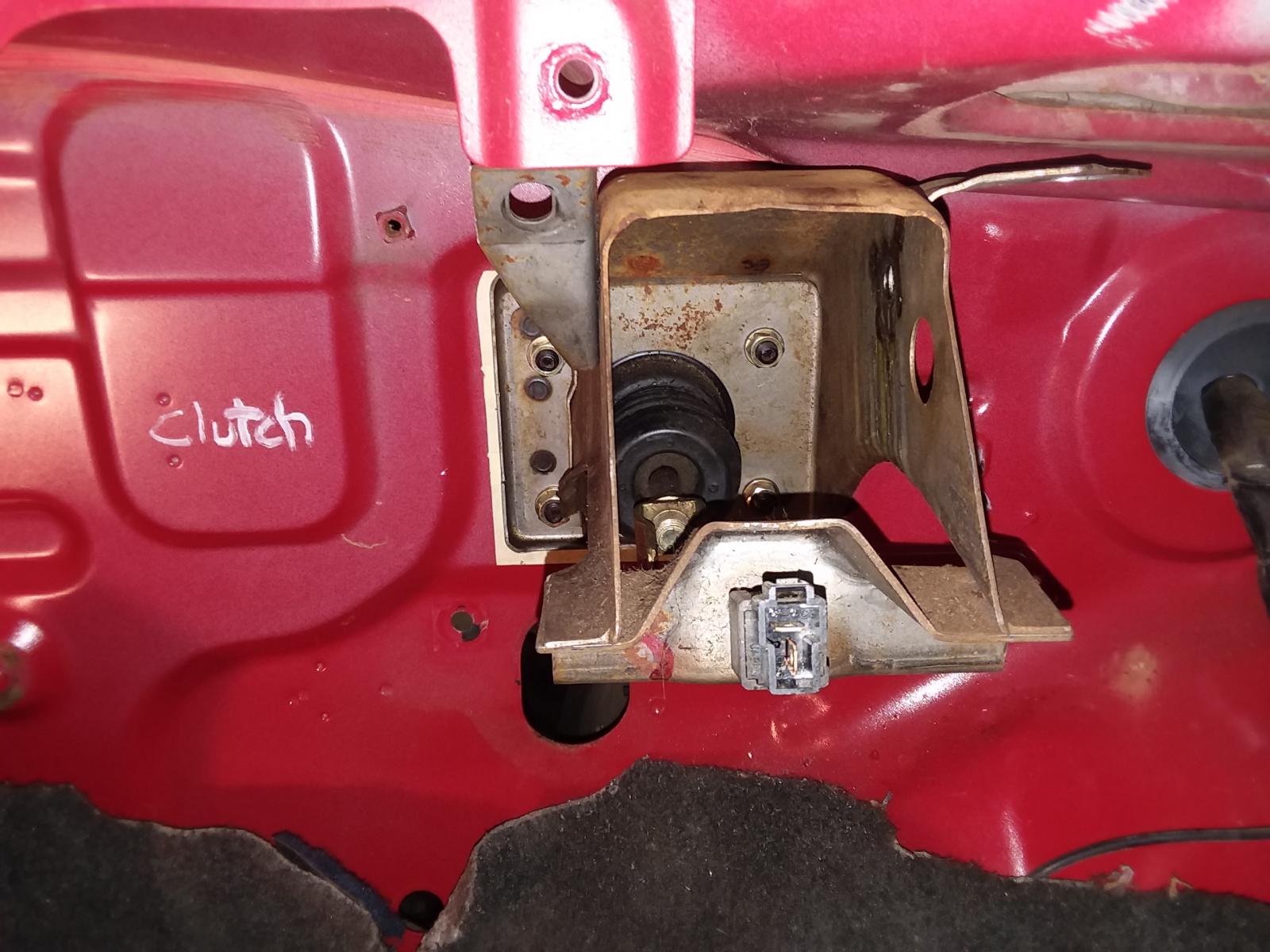

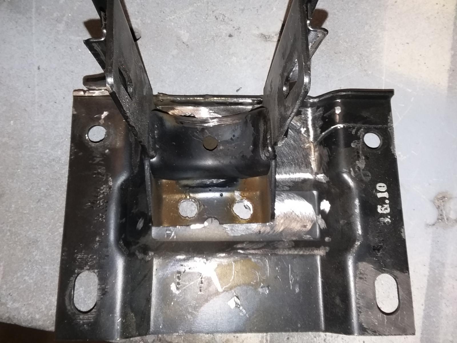

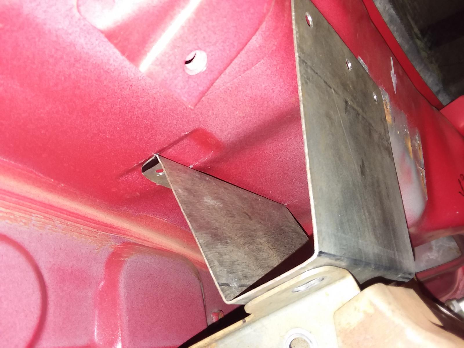

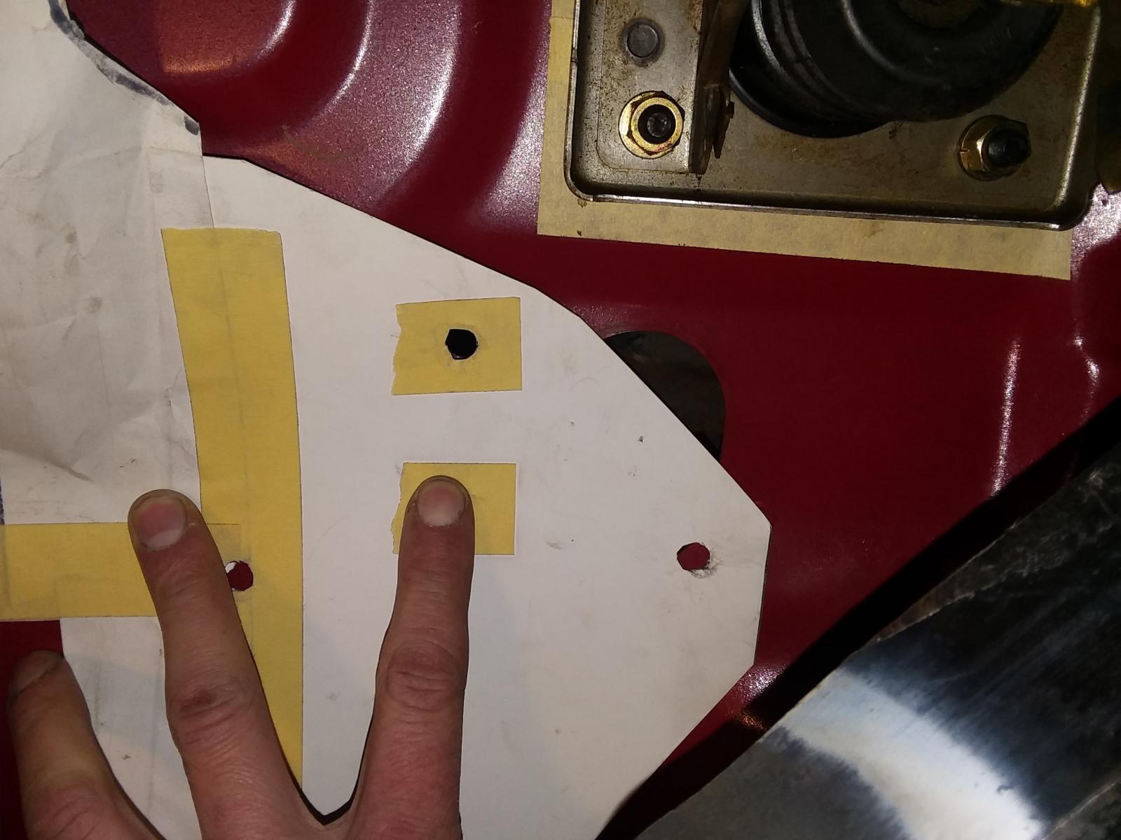

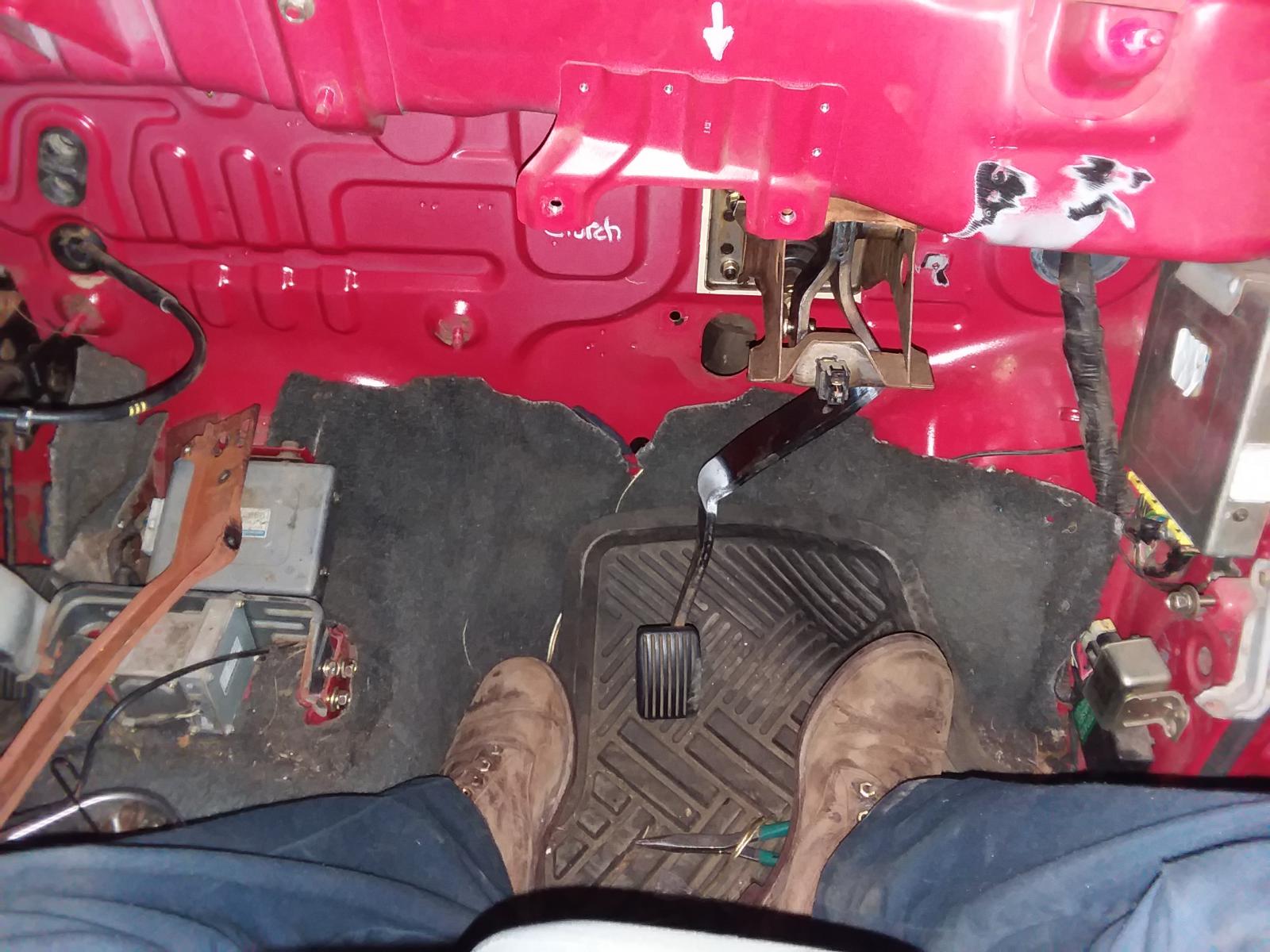

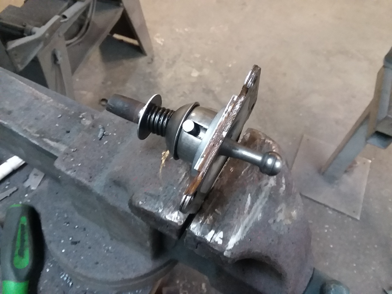

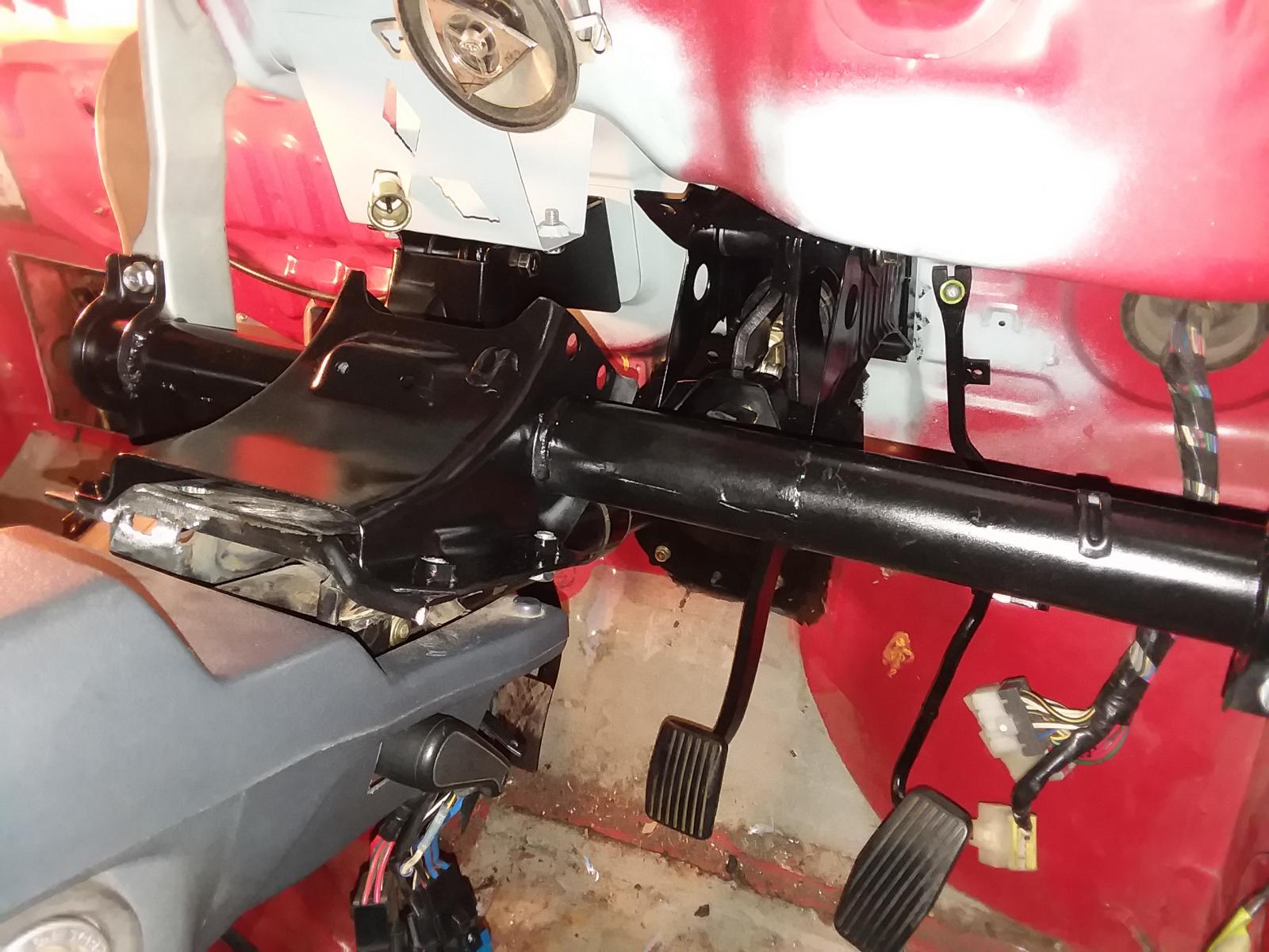

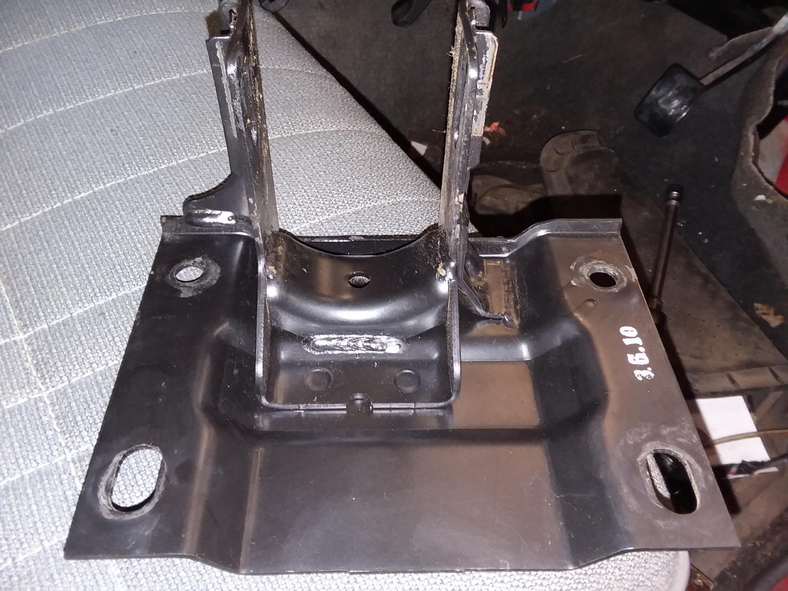

But i got the clutch located, hole cut and stud holes drilled, the support plate cut out, ready to spot-weld onto the wall.
mounted the pedal unit and started fabbing the support bracket that gets welded to the firewall under the windshield:
Attachment 22005Attachment 22006Attachment 22007Attachment 22008

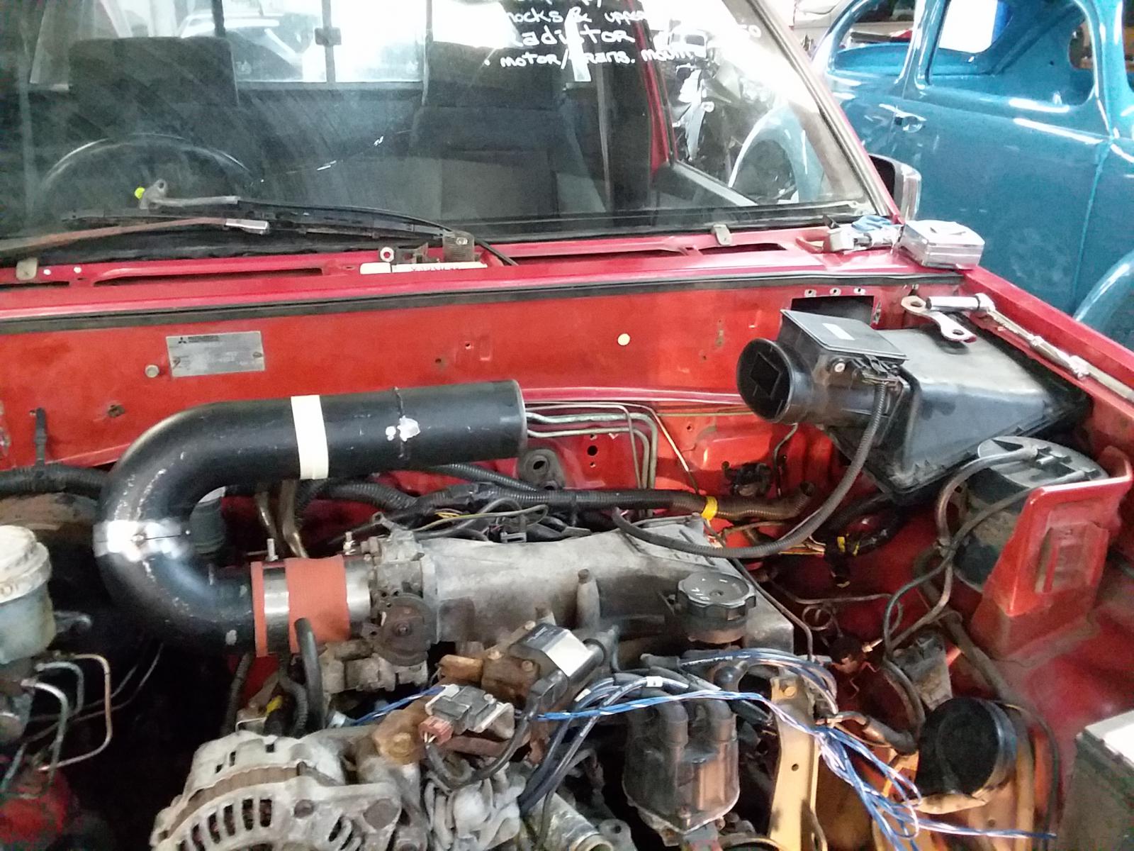

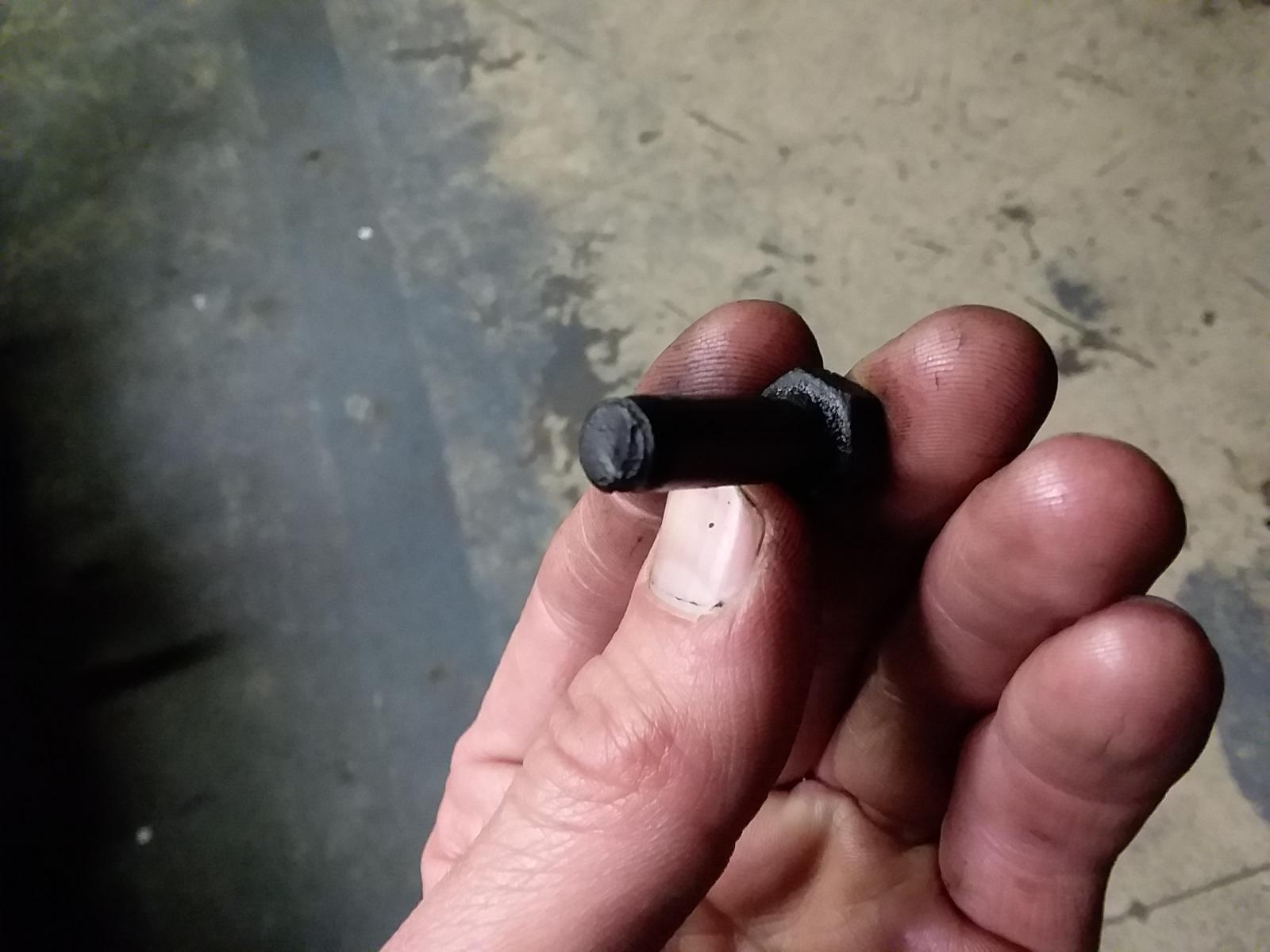

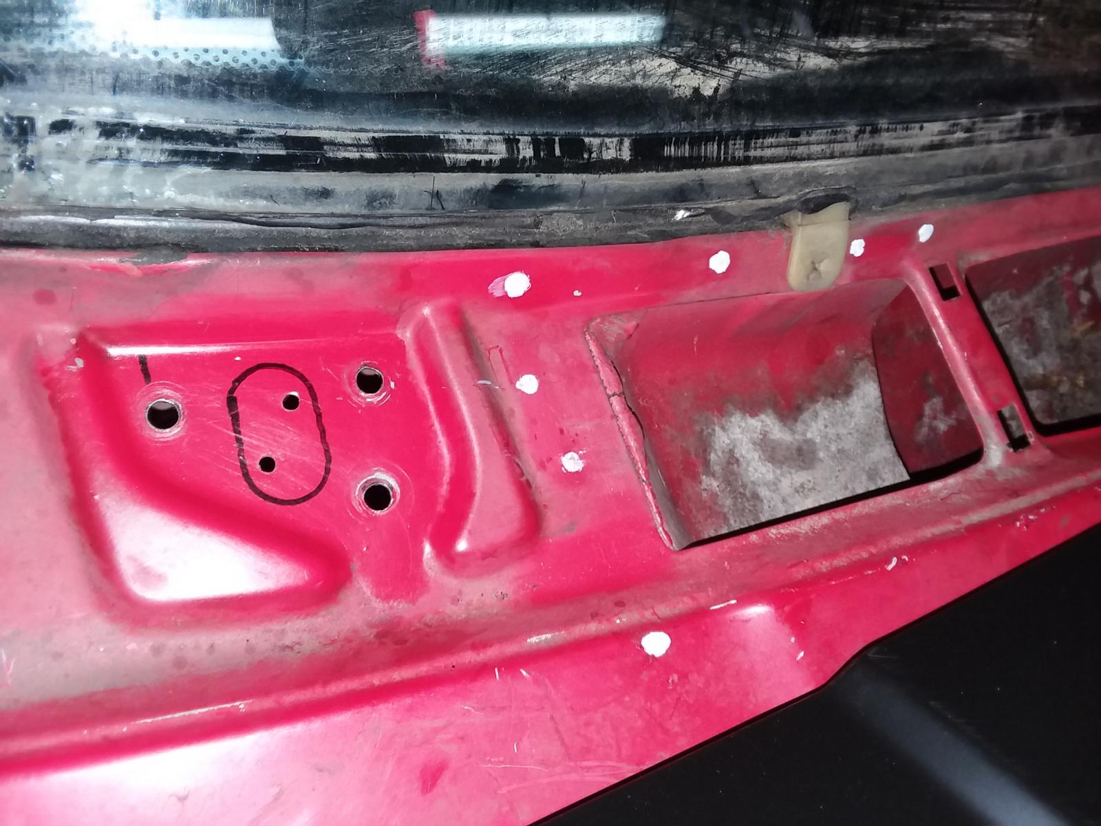

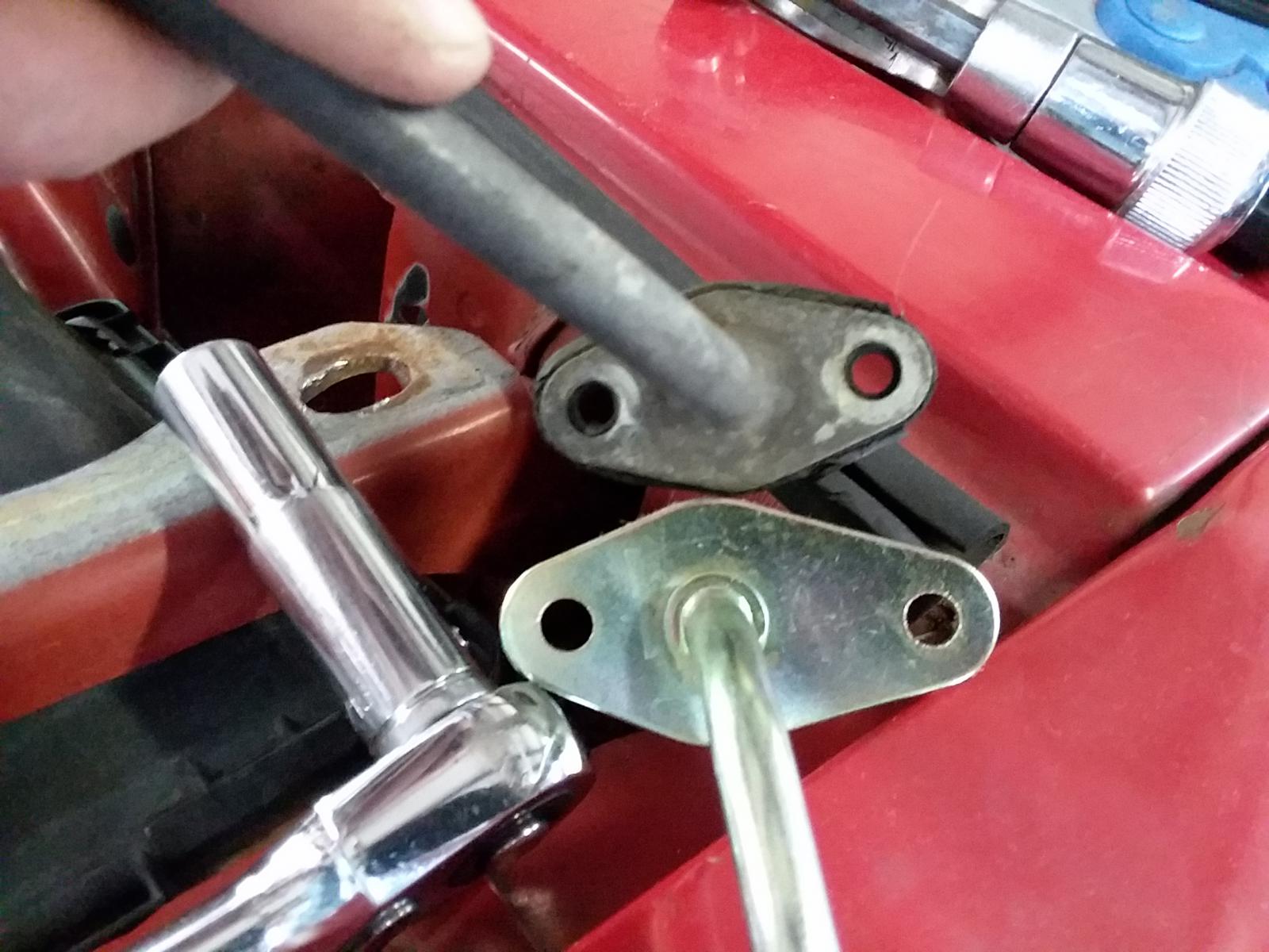

and got my wiper linkage pulled out to move over. what a bitch. only x2 of the x6 nuts were NOT rott-welded onto the studs
managed to get a small set of needle nose vicegrips into the raintray and grabbed onto the bases, after i ground off the tip
of the studs flush with the nuts, so as to ease removal and not have to spin the nut over crusty blown up rotted metal,
but still saving enuff of the stud to re-use the linkage assm.
the factory punched out the 1st hole pattern for the wiper-stem & studs of the RHD set, but the furthest set is not theref
or whatever reason. so i transferred the pattern over and drilled out the stud holes, ive yet to cut the big slot for the stem.
Attachment 22009Attachment 22010

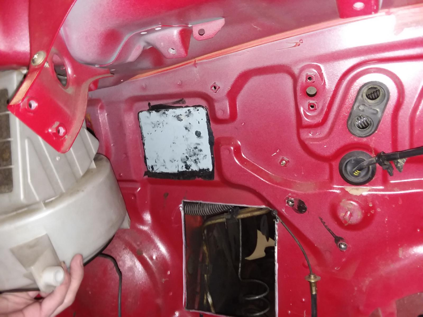

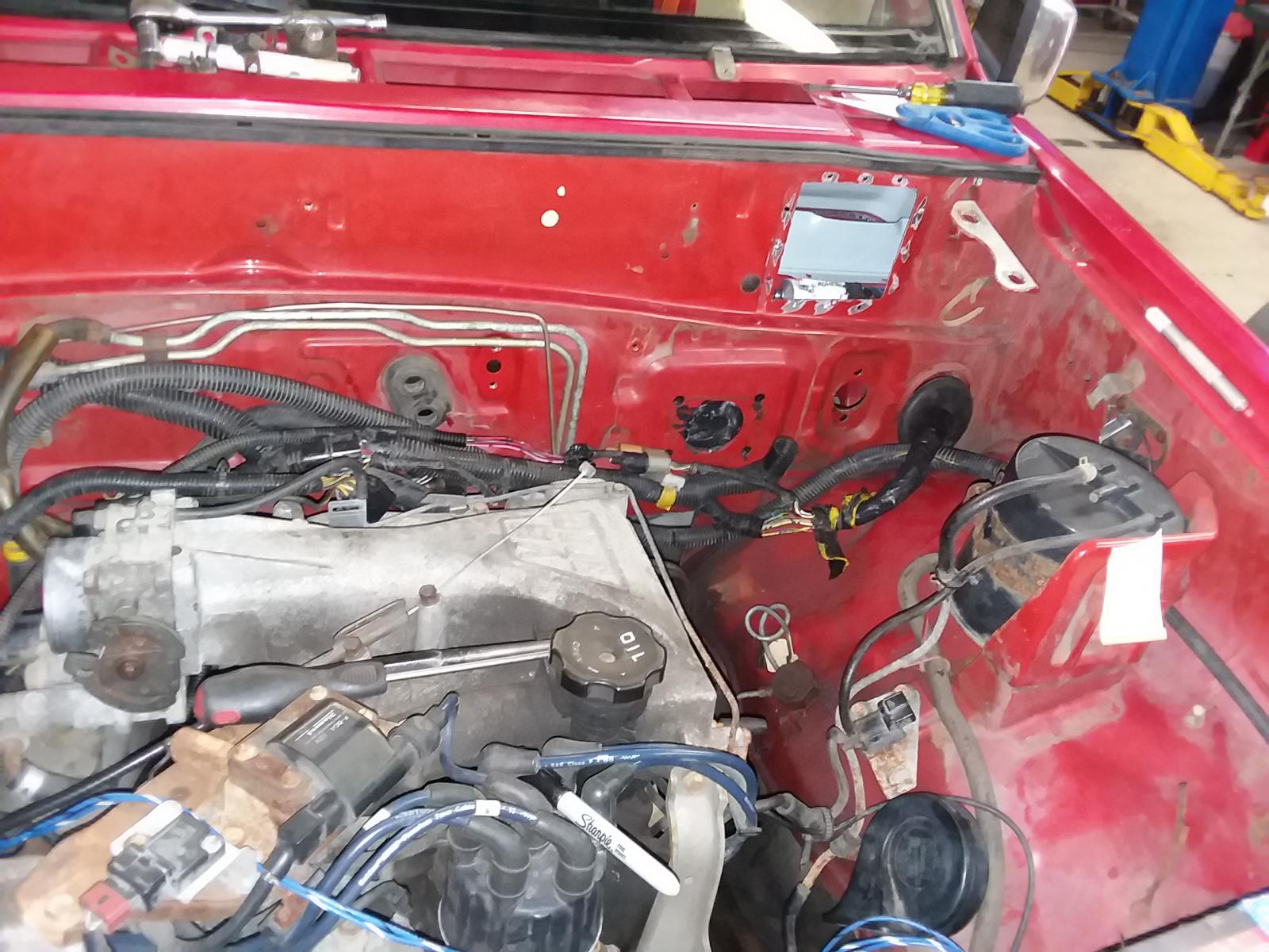

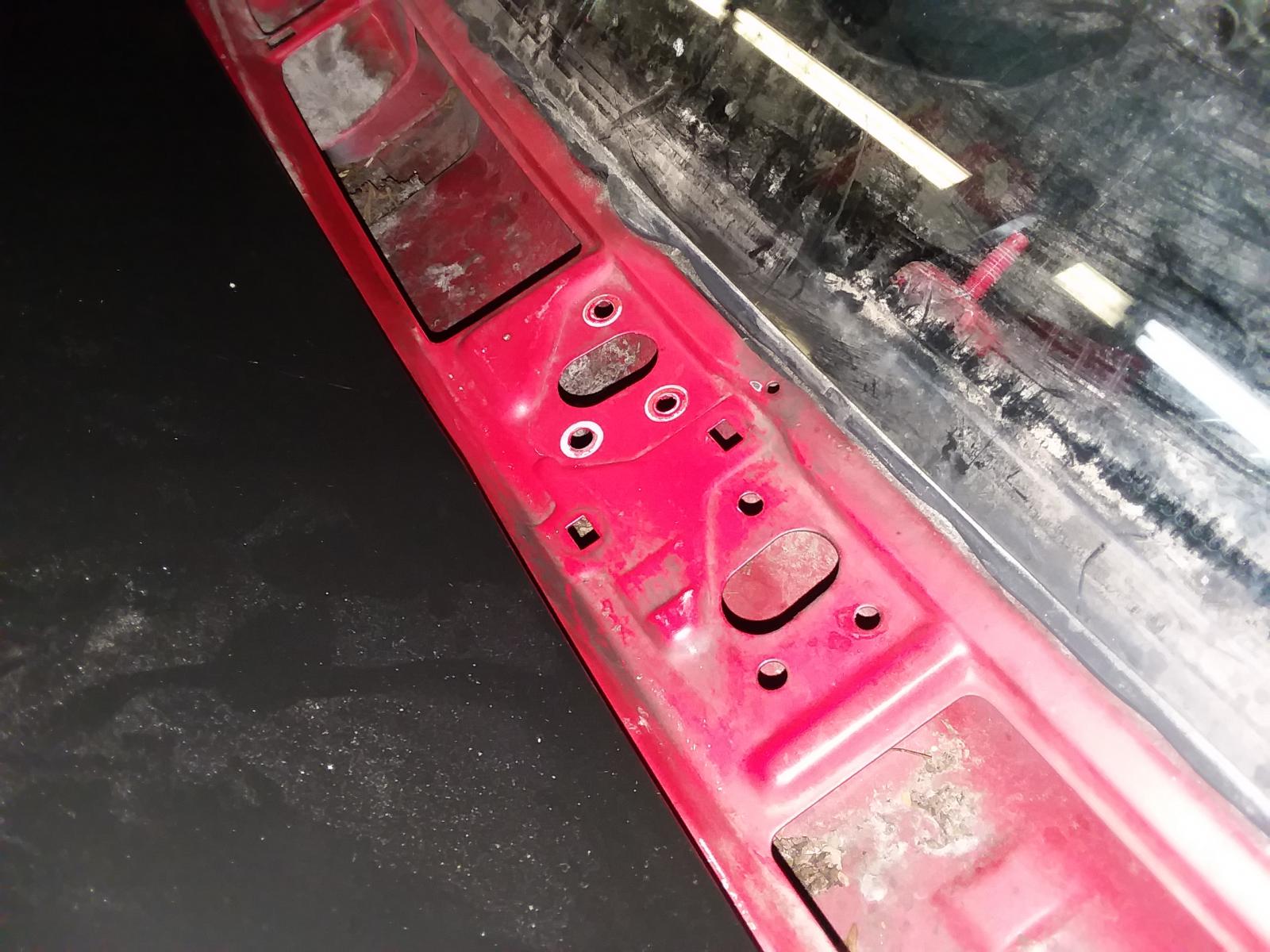

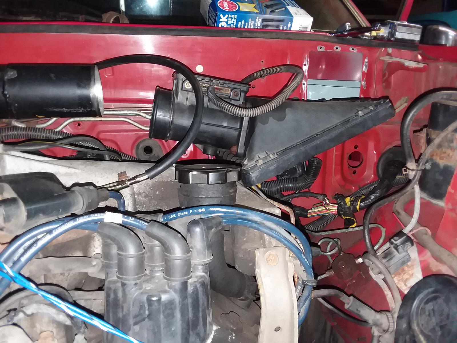

you can see there is this drip shield thing to cover the inlet of the blower motors fresh air intake, ive gotta cut that out
because the wiper linkage doesnt clear it. i was going to tryin drill out the spot welds, u can see them in white paint marks
but then i thought better of possibly blasting holes thru my cowel and firewall, so i think im gonna use a cutoff wheel and
slice iit out flush under the cowel, then weld a flange back on it and transplant it to the left side for the new blower intake.

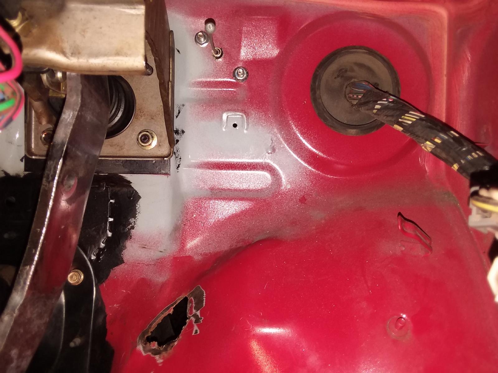

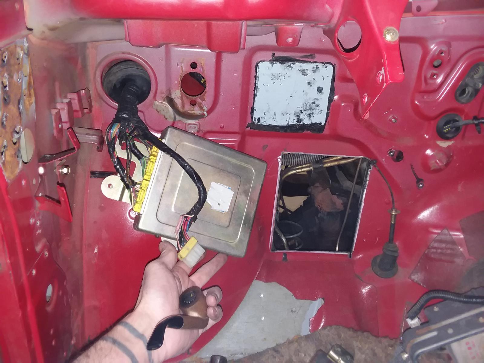

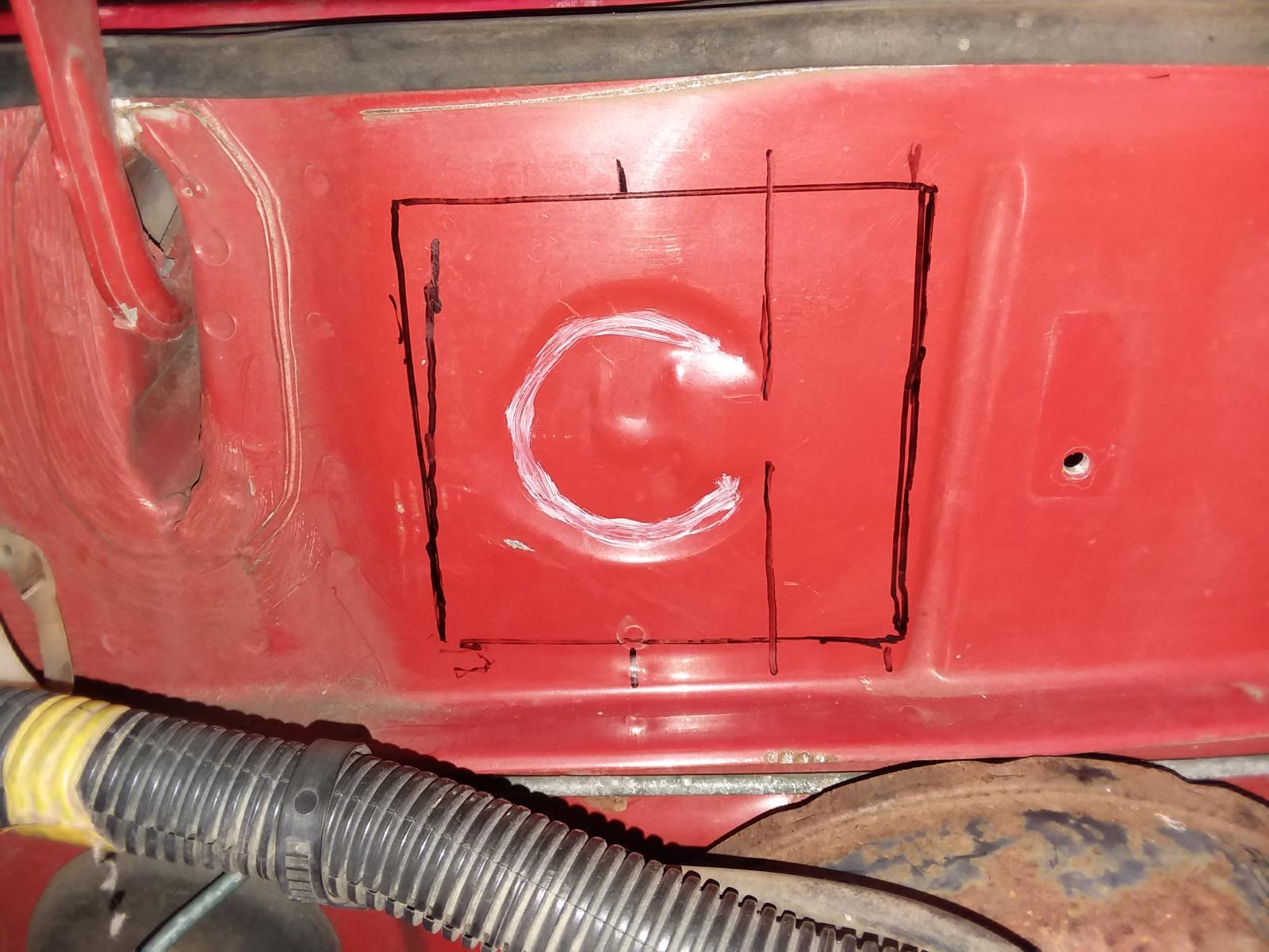

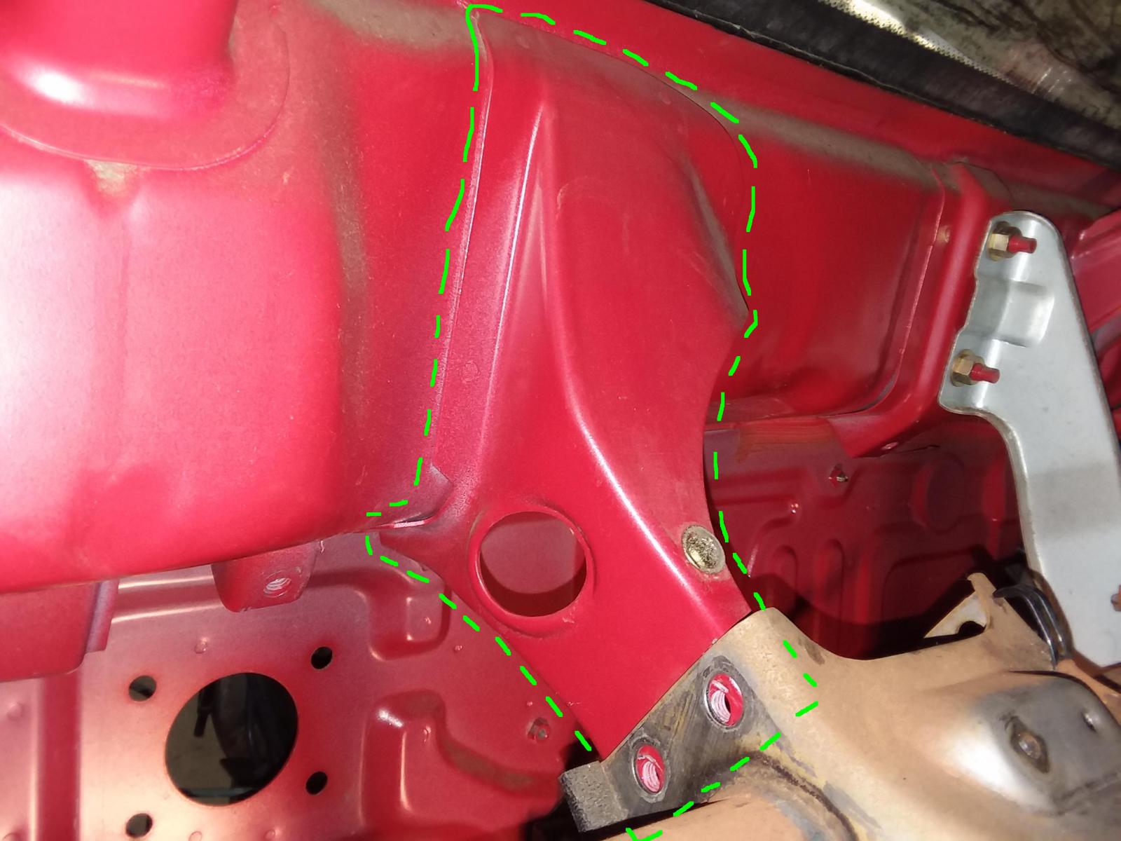

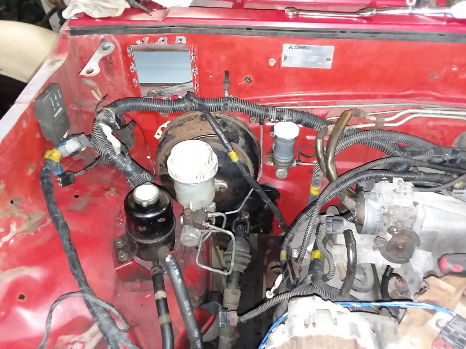

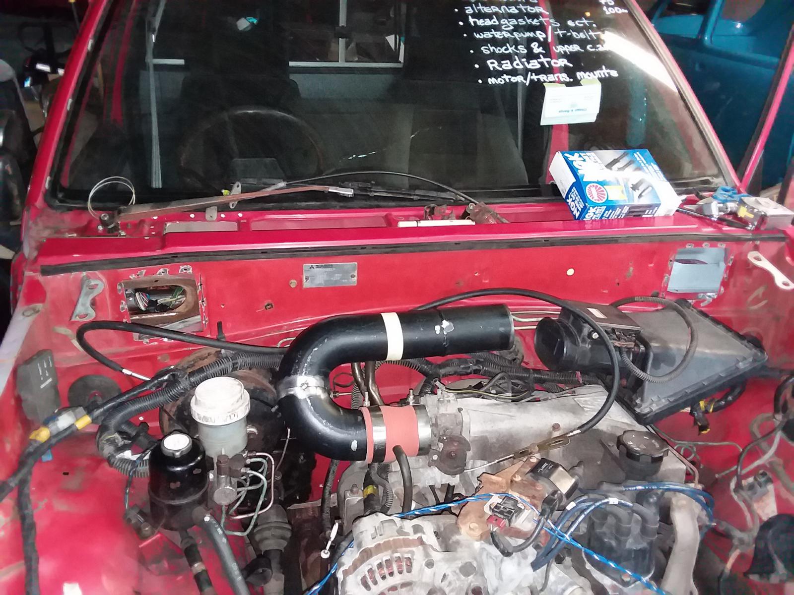

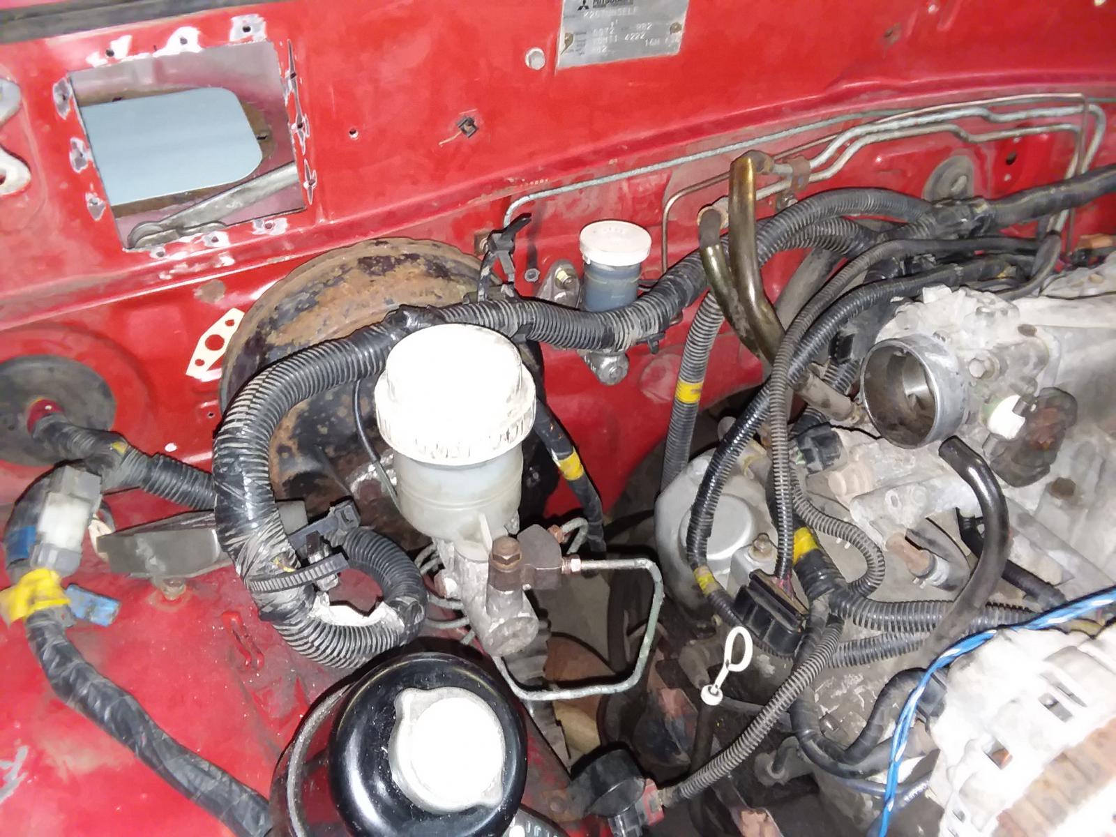

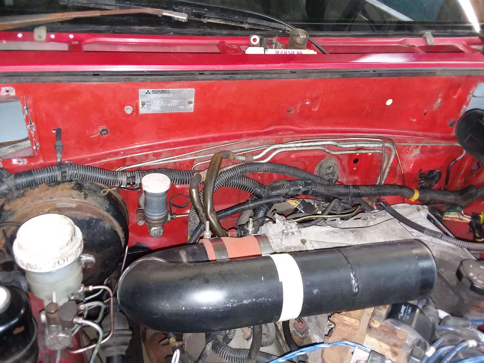

And the wiper motor has to get moved over as well, so i cut out the part of the firewall/raintray wall that the mounting
bosses/weldnuts were on (which i only did when i couldnt reach the 4th of x4 wiper linkage studs w the vicegrips, like a jerk)
so im swapping the pieces of the firewall so the Left side looks how it would OE RHD, theres a funky C-shaped indent where the
motor mounts up to the firewall, see:
Attachment 22011Attachment 22012Attachment 22013Attachment 22014
