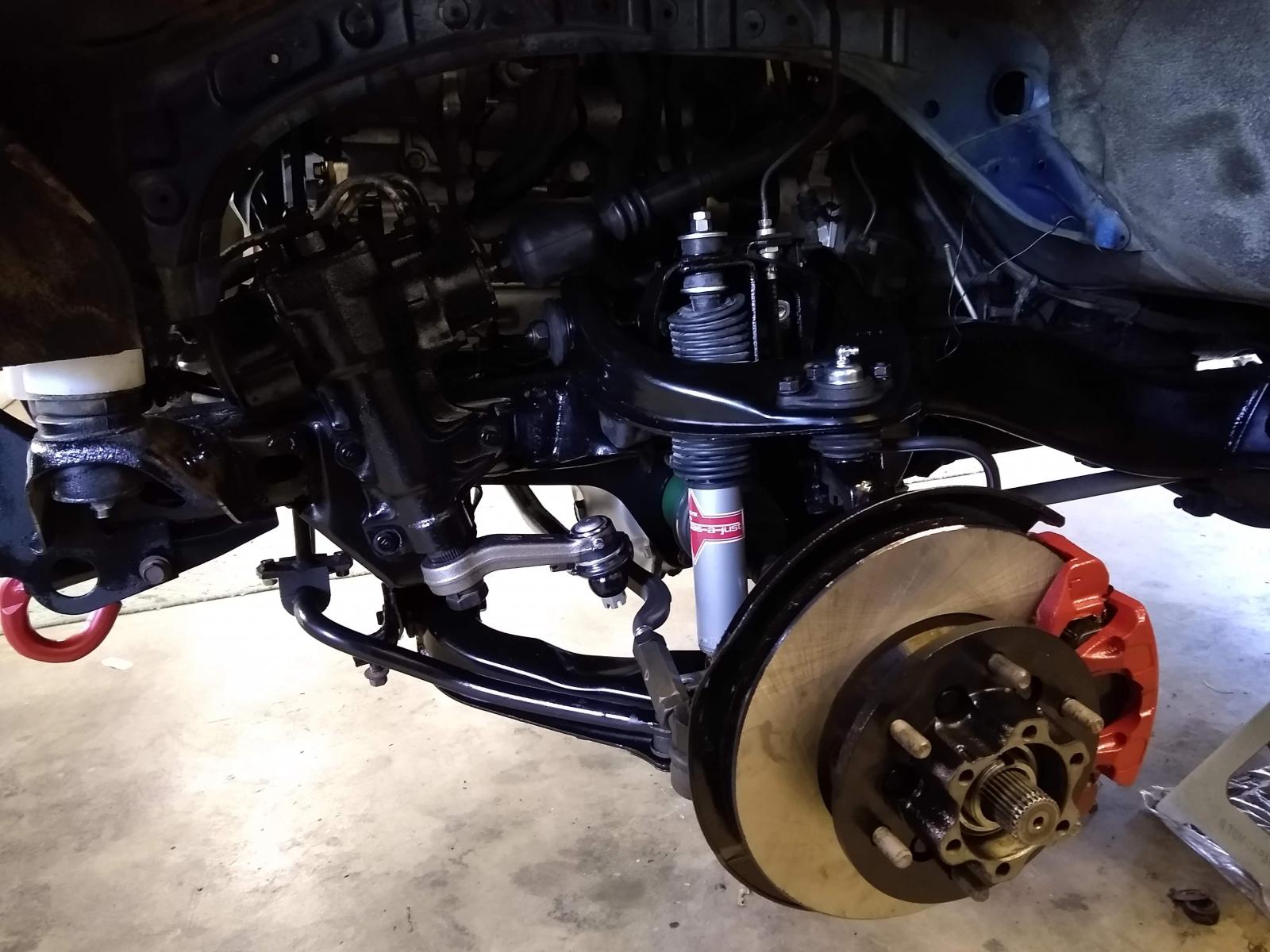

I'm at the point where I can start putting things back on the truck. I did manage to get the truck to bump over on starting fluid, but the fuel pump still needs more priming to get the fuel into the carb. My goal is to get the truck back on its tires and everything connected so I can wheel it out of the garage to play with the engine.
The lower and upper arms installed, along with the steering and sway bar. Nothing is "bolted in place" as I want to make sure everything fits before tightening to spec.
http://www.mightyram50.net/vbulletin...id=23561&stc=1
Renovated hub
http://www.mightyram50.net/vbulletin...id=23563&stc=1http://www.mightyram50.net/vbulletin...id=23566&stc=1
Brakes rebuilt. (yes, they are "ricer red" I wanted some color poking through the wheels)
http://www.mightyram50.net/vbulletin...id=23568&stc=1http://www.mightyram50.net/vbulletin...id=23564&stc=1http://www.mightyram50.net/vbulletin...1&d=1571148147
Somewhat finished test fit. I was send the wrong lower arm ball joint (they had the zerk fitting on the top instead of the side) so I am waiting for replacements.
http://www.mightyram50.net/vbulletin...id=23565&stc=1
Part #'s for the steering stop bolts & lock/jam nuts.

This is where I stopped for the day.
http://www.mightyram50.net/vbulletin...id=23569&stc=1
Thanks again !
Were any of the steering parts worn & need replacement (?) pitman arm, idler arm, tie rod ends..?

:merryxmas: You made yourself a new truck steve and it looks better than factory new :thumbup: Nice work & thanks for the answers..!
Excellent project and attention to detail. You have outdone yourself. That front end looks better than new.
If you want to take it a step further and upgrade to Stainless Steel Brake Lines let me know.
Very nice work. All the pics and telling the story are a great resource. Thank you!
