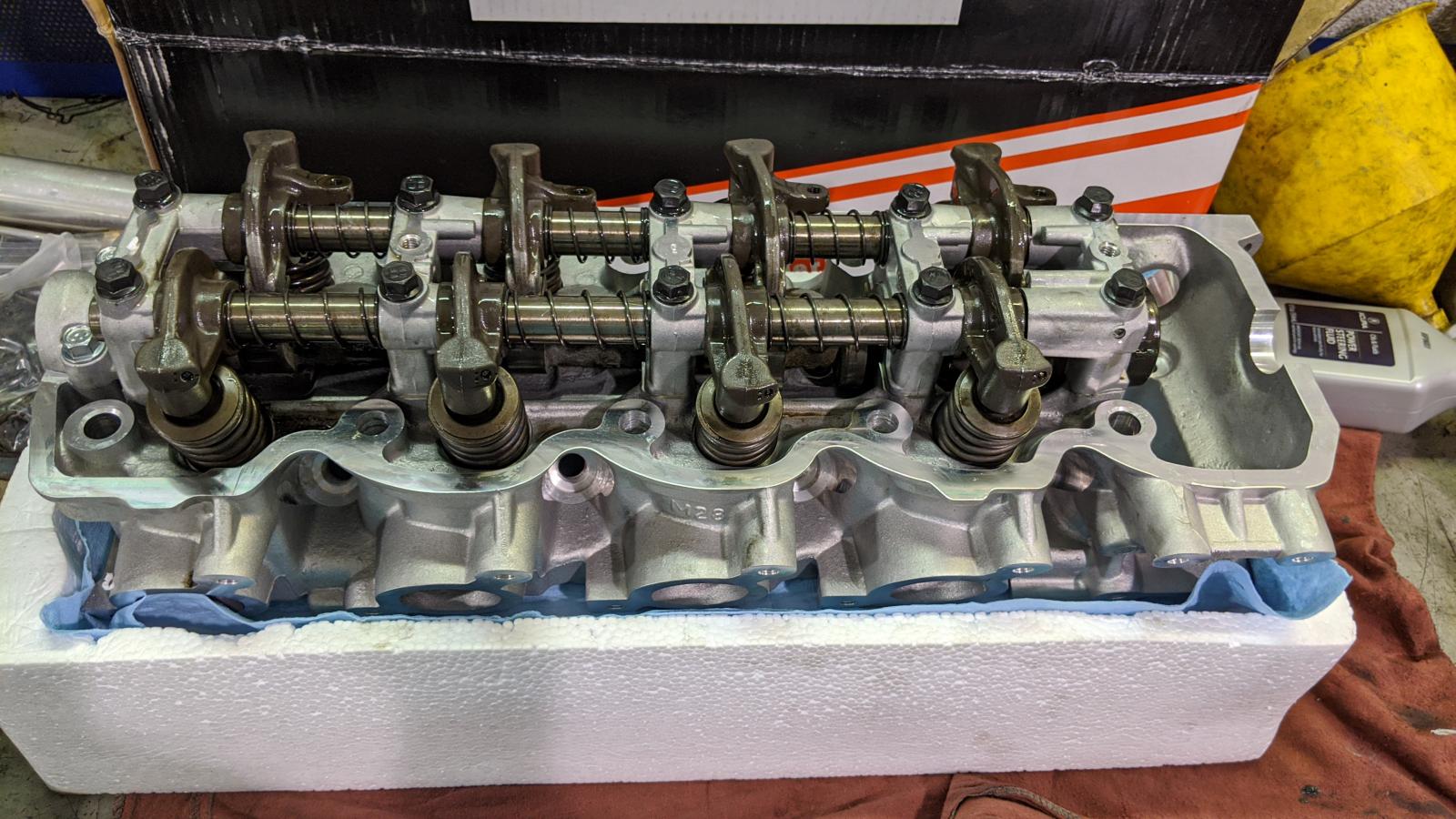

Happy New Year! So far mine sucks... Days before Christmas my Montero developed a misfire and started consuming coolant. Yup it's a cracked cylinder head. Just got the time tonight to pull the head and its confirmed. Suggestions? I've found a new bare head on rockauto and I know a machine shop that might be able to fit ( still waiting on a text back ). Other than that I'll be looking here for help. I'm open to modifications like head without the weird little jet valves.

Definitely get a non-jet valve head. They’re not as likely to crack if over heated and no more expensive than the 3-valve head plus a jet valve delete kit.

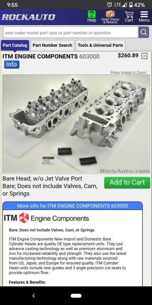

Would you go with this? Attachment 24086 Will my hydraulic lifter work on with this head?
That head will work and the cost is reasonable although be sure to factor in shipping costs. Since it’s a bare head you will need to use the cam and valve train (rockers, lifters, rails, valves, etc.) from your old head, but don’t use the old cam towers. Use the new ones that come with the bare head. Also not a bad idea to get at least new exhaust valves. If you don’t have the tools to set up the new head, check with a machine shop. It’s a very straight forward procedure to move the valve train to the new head.
Another option is to get a new head that includes a cam and valve train. May cost 100-150 more, but that extra might be what you pay a machine shop to set up the bare head.
Whichever way you go, be sure to get a good quality head gasket and new head bolts. Do not use the old bolts. If you can afford the extra cost, get ARP head studs. They’re bullet proof and reusable.
Awesome thanks for the input. I've already got a head gasket set and head bolts. I also have all the tools to setup the new head. Shipped and tax I'm looking at $282 which like you said isn't bad. I like your idea of new exhaust valves. May main concern was that all the non jet heads I found had manual lash adjusters and I wasn't sure if that would work with my hydraulic lifters.
The valve stem lengths differ for the two head types so that’s why the two rocker assemblies aren’t interchangeable. Also, if you’re contemplating reusing the intake valves, carefully inspect the seating surface, the stem and rocker head for wear. If you have any doubt, replace them too. Otherwise it looks like you’re set. Have fun.

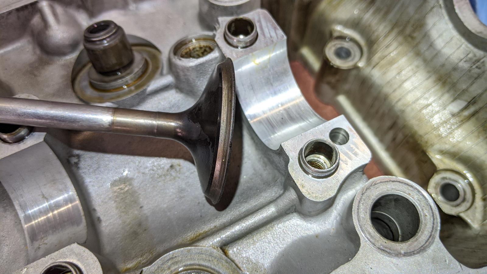

Complete set of valves ordered. Of course I was hoping to reuse them but the intakes have a significant amount of wear on the seating surface.
Attachment 24112
Yikes! That valve is incredibly worn. The main seating surface is so dished, I'm not sure there's enough there for a machine shop to re-cut the seating surfaces if you tried to go that route. The stem is showing its age, too. Replacement was definitely the smart move.

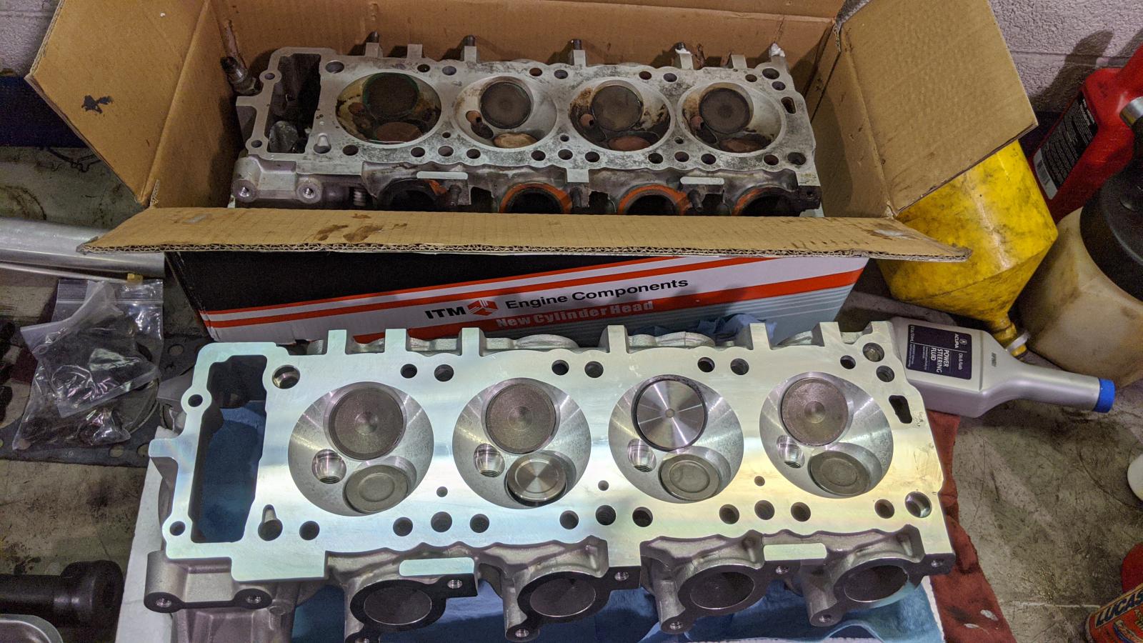

Currently I'm committed to trying this ITM head. Likely going to slap it on Thursday. If I have time I'll measure the combustion chambers and compare volume to find out if compression ratio will change. I'll report my results.
ITM has been distributing engine parts for several decades, plus most reviews I could find were quite positive. It'll probably be fine, but it's still good to closely inspect it just to be sure. If you're satisfied with it, blow out all the passages and the tapped holes before you start installing the new parts and the parts from your old head. On my new, bare head, I found a lot of filings at the bottom of the cam tower bolt holes.

Head and valves came in so I took some time between jobs to lap in the valves and assemble the head. I did do a non-scientific measuring of the combustion chamber and my conclusion is that the old head has slightly more volume. So maybe I'll get the slightest bump up in compression ratio. Attachment 24132Attachment 24133
