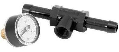

If you have a regulator on an electrical pump for your weber, you should have a mini gauge installed on the regulator to assure it is pumping the correct amount of fuel to the carb. 3-4psi is good for the weber. They have little mini-gauges you can install which I have used for years. hey are simple, plastic, and do the job well for what you need.
I use one of these Spectre Performance Fuel Pressure Gauge 59013, from walmart. The face is like inch and a half and screws right into the gauge oulet of a regulator.
Attachment 20327

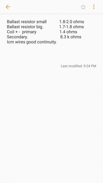

So I swapped some parts around this evening found the one of the icm's I have is for sure bad. Put the ballast resistor back inline. I got a new volt meter and checked the resistance of the coil and of the ballast. It ran for 15 mins before dying. Let it sit for 30 mins started right up no problem. I did pay attention to the pump and it did change tone and seemed to sound like it was cavitating so I'll be changing that for sure. I did have a few readings that weren't quite right. The farthest out was across the secondary coil. Attachment 20341Attachment 20341

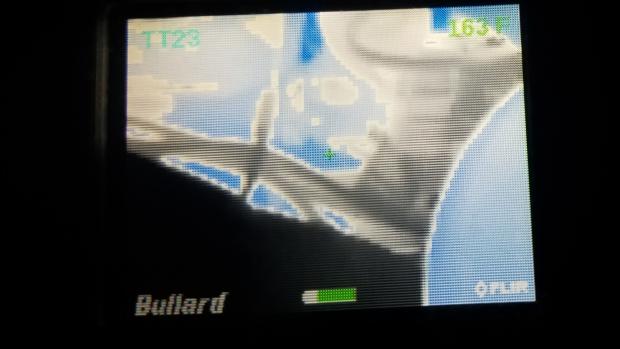

So after it cooled down I put the icm back in and ran it till it got hot again. Once the distributor housing got to about 150* it started missing and cutting out. On average the intake side is about 150-190 degrees.its hard to see but the pic is the distributor body. Attachment 20343
