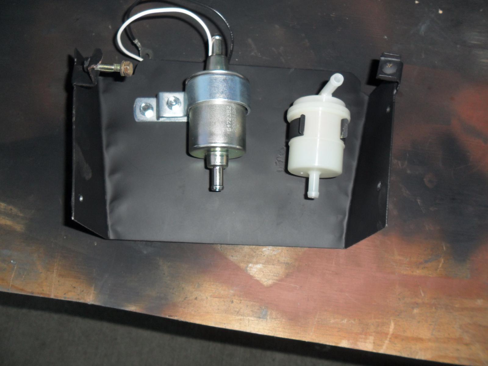

1 Attachment(s)
Long day. I got the mount built anyway. I won;t have to even undo any part of the vent line. I cut off those mounts and welded them to the new pump mount. It goes in there fine. I'll have to search that oil pressure switch. I think all I need now is to work out which is the supply and which the return in the engine bay I'm pretty sure I can do that :) Then get some wire connectors and run a wire. I'll take suggestions on the path to run the wire please. Here is a picture of the mount.

I then removed the fuel pump and capped the return line up front. I ran from the main supply line to the Weber. I had to move the inlet nipple to the other side to make it easier for me. I made a cover for the hole in the head with the same sheet metal I used on the pump mount. I have the plastic spacer and a new gasket. I used red gasket maker too. I had to get shorter bolts, at autozone they are M8 x 1.25x 25mm I think.
(Zoinks do you know to remove the skirt? You need to get access to the bolts on top which are inside the interior panel of the bed. I had to drill out the screw in the panels and the bolts.)
You can see my mount allows all the original equipment to stay in use. I cut off the connectors and welded two to my mount the other one for the filter I cut the steel off the nut and just used it behind the mount plate. I started with that style mount plate becuase the one that inspired me to try was designed in that shape. Then I started cutting it to suit my needs.
