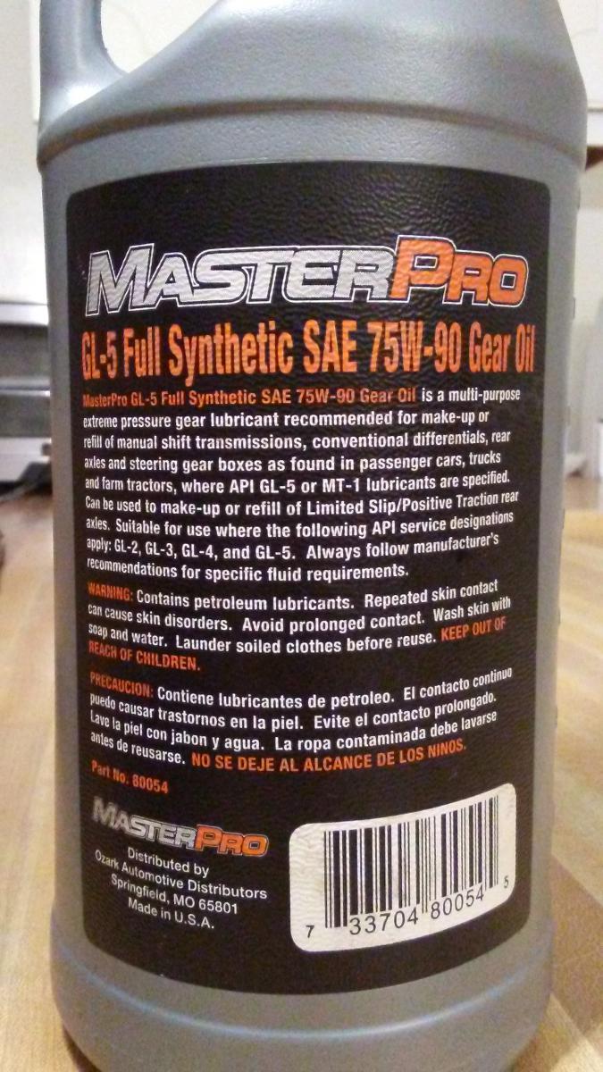

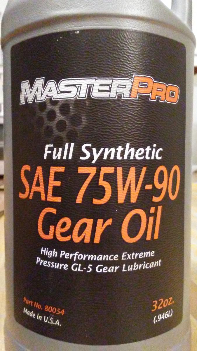

I got this from O'Reilly:
Attachment 19422Attachment 19421
I am starting to regret my purchase after researching Gl-5 rated oil. GL-5 is one hell of a confusing oil! Some people love it, some hate it. A lot of people on various forums say that GL-5 corrodes "yellow metal". The KM-145 Transmission definitely has "yellow metal" in it. I just opened the transmission and can confirm it does. You can even Google KM145 transmission rebuild kit, an amazon link should pop up. Click on it and look at the picture, you can see what appears to be brass gears. Now what confuses me is people on various oil forums saying the newer versions of GL-5 wont corrode "yellow metal". Others say it does. WHICH IS IT!!! To fortify my confusion, the masterpro oil I bought from O'Reilys says it is compatible with manual transmissions and I quote, "Suitable for use where the following API service designations apply: GL-2, GL-3, GL-4, and GL-5." I'm going to have to find a number to call the people that make the stuff for O'Reilys and get an answer from them...
Update: Just called the manufacturer that makes this oil and they said it is not compatible with yellow metal.

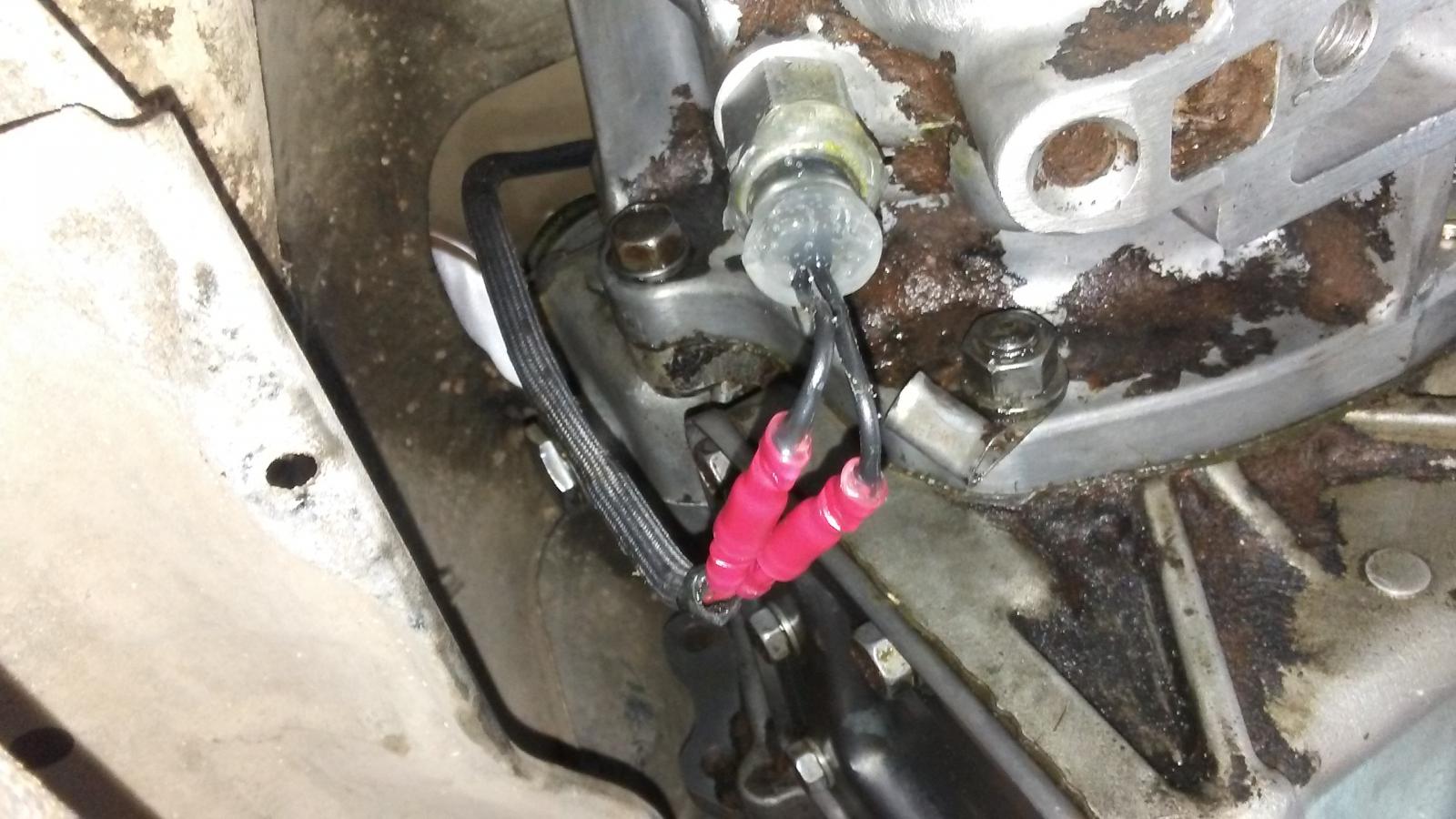

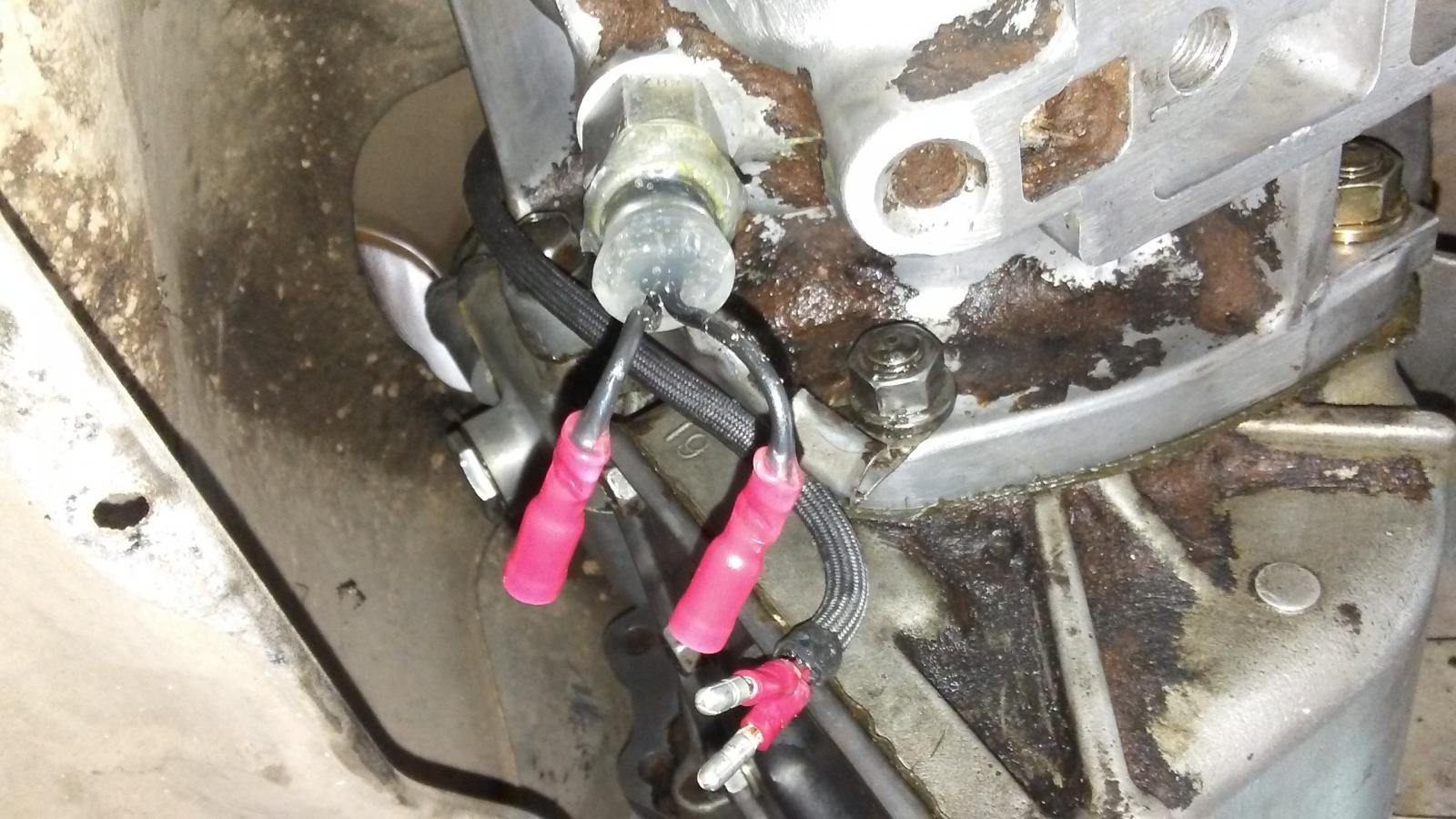

Some other stuff related to the backup light switch: To make removing and installing the backup light switch easier, I modified it. Soldered on some new wires to the back up light switch with crimped on female insulated bullet connectors on the other end. For the other wire, I crimped on male insulated bullet connectors. This little modification makes working on the truck much better. I had ripped the wire so many times while removing and installing it that it just got on my nerves! Mitsubishi, you knew you could have done better!
Disconnected:
Attachment 19437
Connected:
Attachment 19438

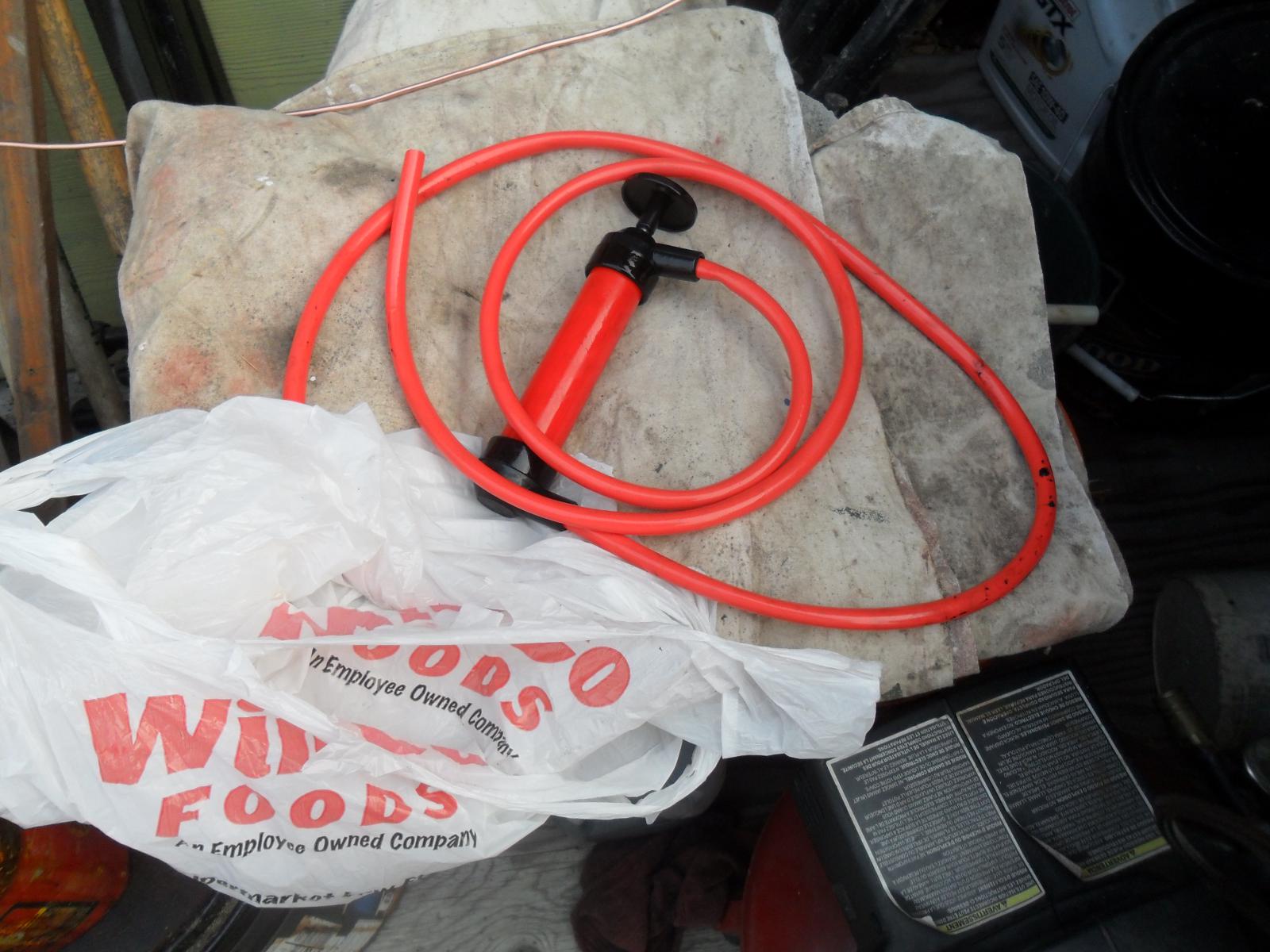

EDIT- I got the trans filled. The hole is on the driver side 17mm Here is a picture of the pump I found for $7.99 I put the hose in the hole and did the job standing alongside the truck with the bottle sitting on the air cleaner cover. It drives a lot better. I may have put the wrong kind of juice in the last time I drained it. The top hole sucks the bottom blows. I primed the top hole with a drop of oil and a few pumps before sticking the hoses onto it. It works perfectly until the bottle gets low then you need two more hands. Oh yea the pan may be square but the holes aren't aligned as if it were. There is a front to the pan and the gasket. I soaked the gasket in oil like the Weber carb kit suggests and as long as you can keep the pan flat it works a treat :)
Attachment 19459
