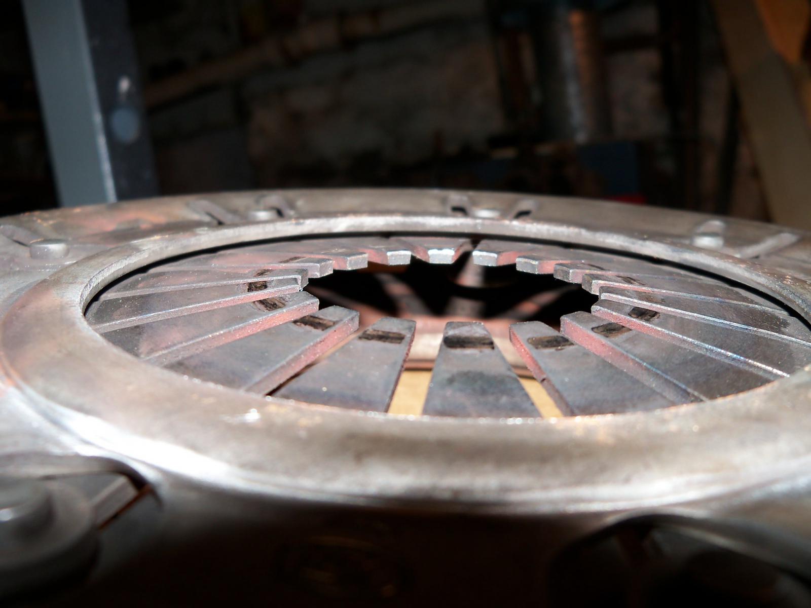

I pulled it for inspection and found no defects except when I compared the pressure plate to a new one the original one looked more collapsed and had metal heating discoloration where the TOB connects. I have a pictures:
Attachment 18783Attachment 18784
The first pix shows the bad, somewhat collapsed pressure plate as compared to a new and more flexed up pressure plate.

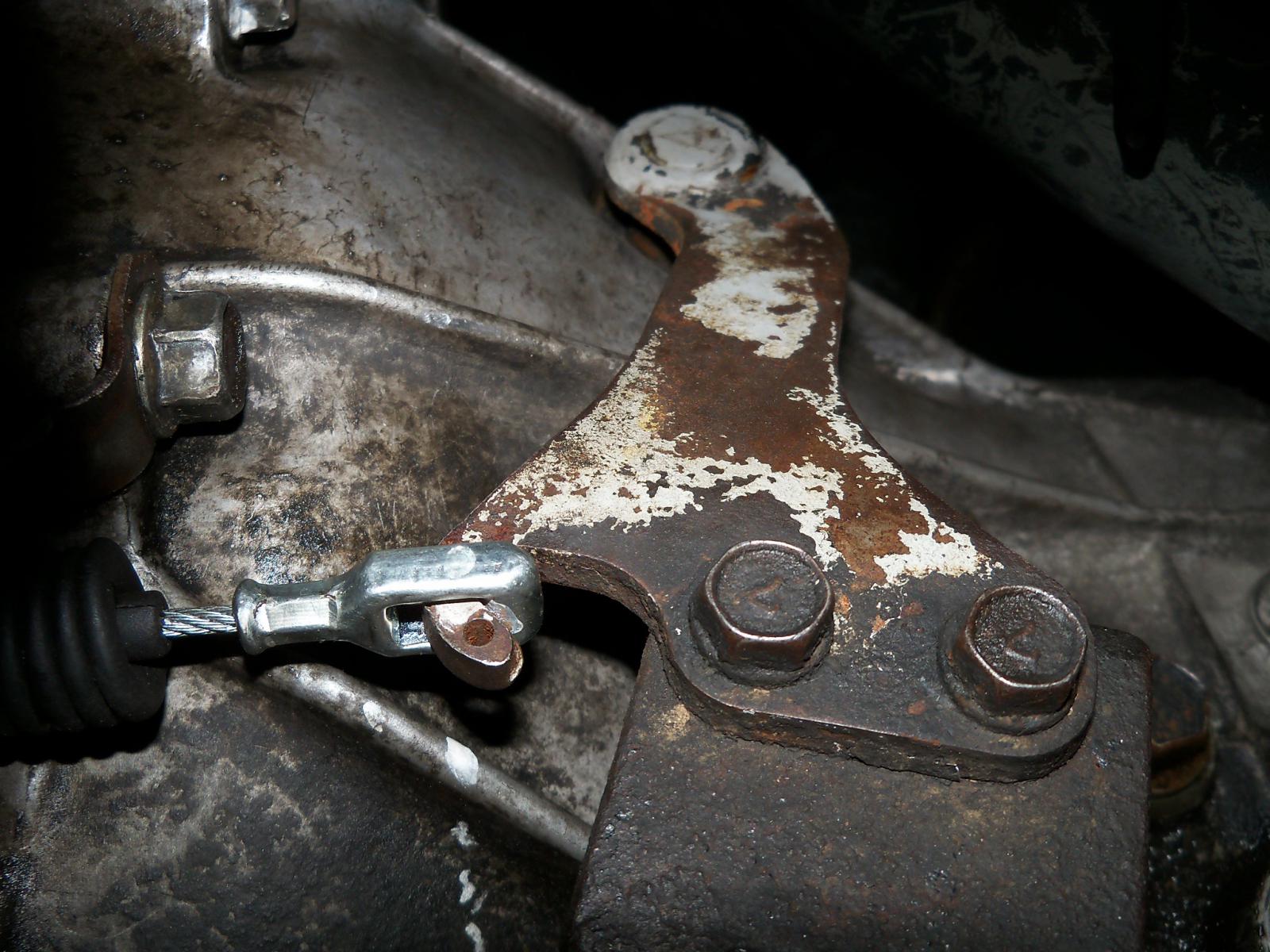

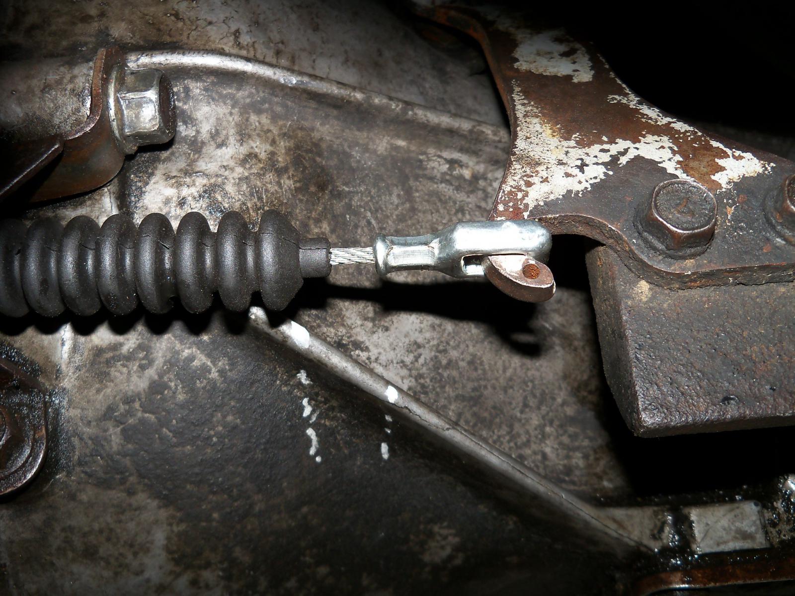

Look at the clutch control shaft position on the side to the transmission. See pix:
Attachment 18785Attachment 18786
(for a diagram, see:
http://vintage.mitchell1.com/PClubDa.../V2I817009.pdf )
So anyhow look at the clutch control shaft lever pictured. This is how much cable pull range that it takes to operate a 2nd gen clutch. the first pix shows a relaxed pedal with the clutch engaged and the second pix shows a depressed pedal with the clutch disengaged. Notice how the clutch control lever in the second picture needs to be pulled so far that it actually contacts the side of the bell housing ?

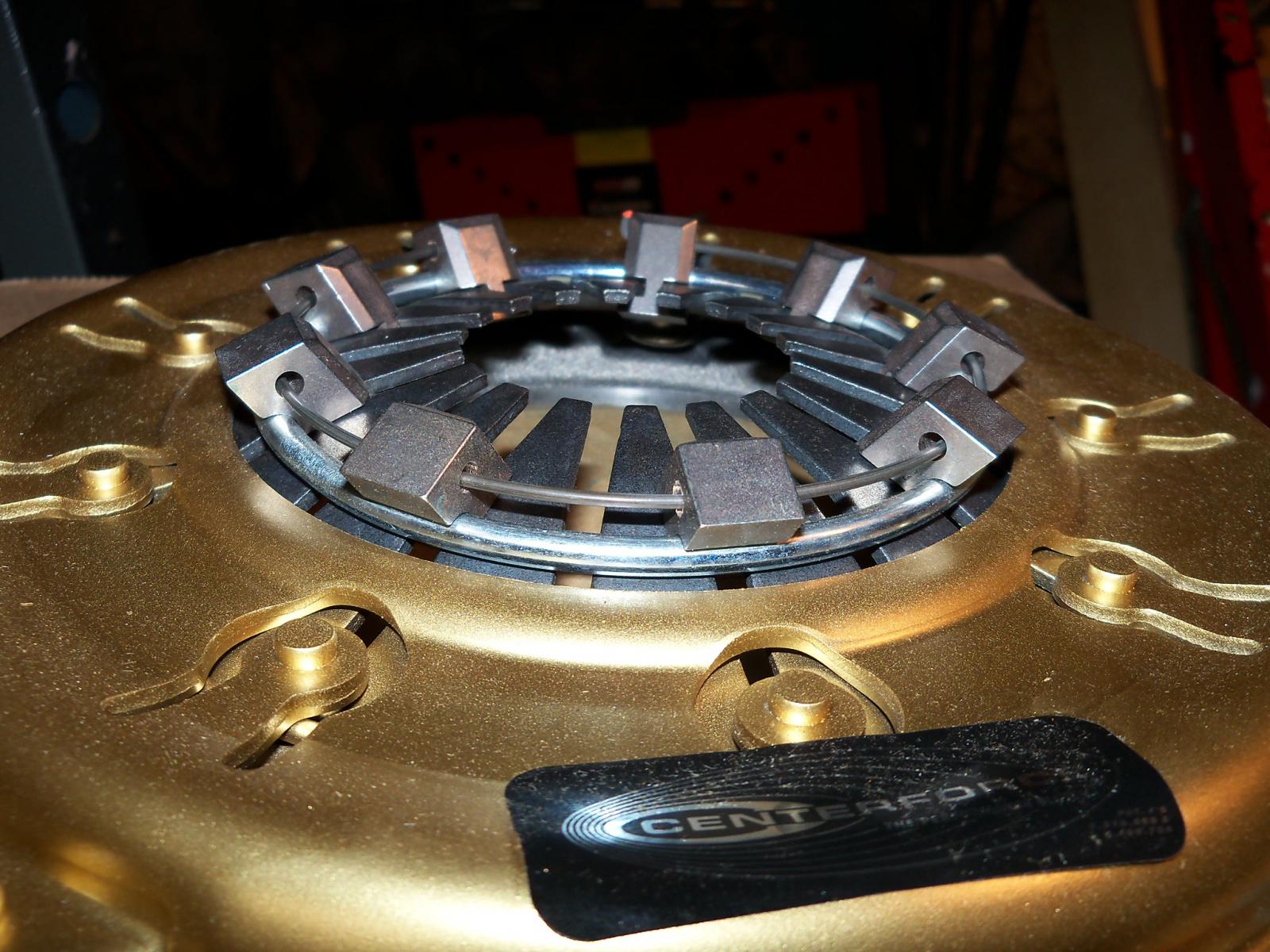

A centreforce pressure plate - that should bite down hard on the clutch disc. You'll probably find the old clutch cable inner sleeve was worn down badly and was the reason why the clutch was so heavy.
When I removed the cable I tested it and it moved freely and had no signs of wear, unless maybe the inner sleeve was not visible or it needed to be stressed in order to move "heavy". I don't know.
I replaced the cable, clutch, fly, pilot and TOB and still had the same problem ! Heavy clutch and grinding into gear because not enough pedal travel in order to fully release the clutch.

Attachment 18810Attachment 18811Here are pictures of the clutch control shaft on the transmission bell housing. I can explain what you are seeing. the first picture shows the clutch cable relaxed with the clutch fully engaged. the two painted vertical lines represent how much the cable travels when the clutch pedal is depressed to the floor. About an inch.
I need more pedal travel. I need to clutch control shaft to be pulled so far that it contacts the side of the bell housing like pictured in the second image.
