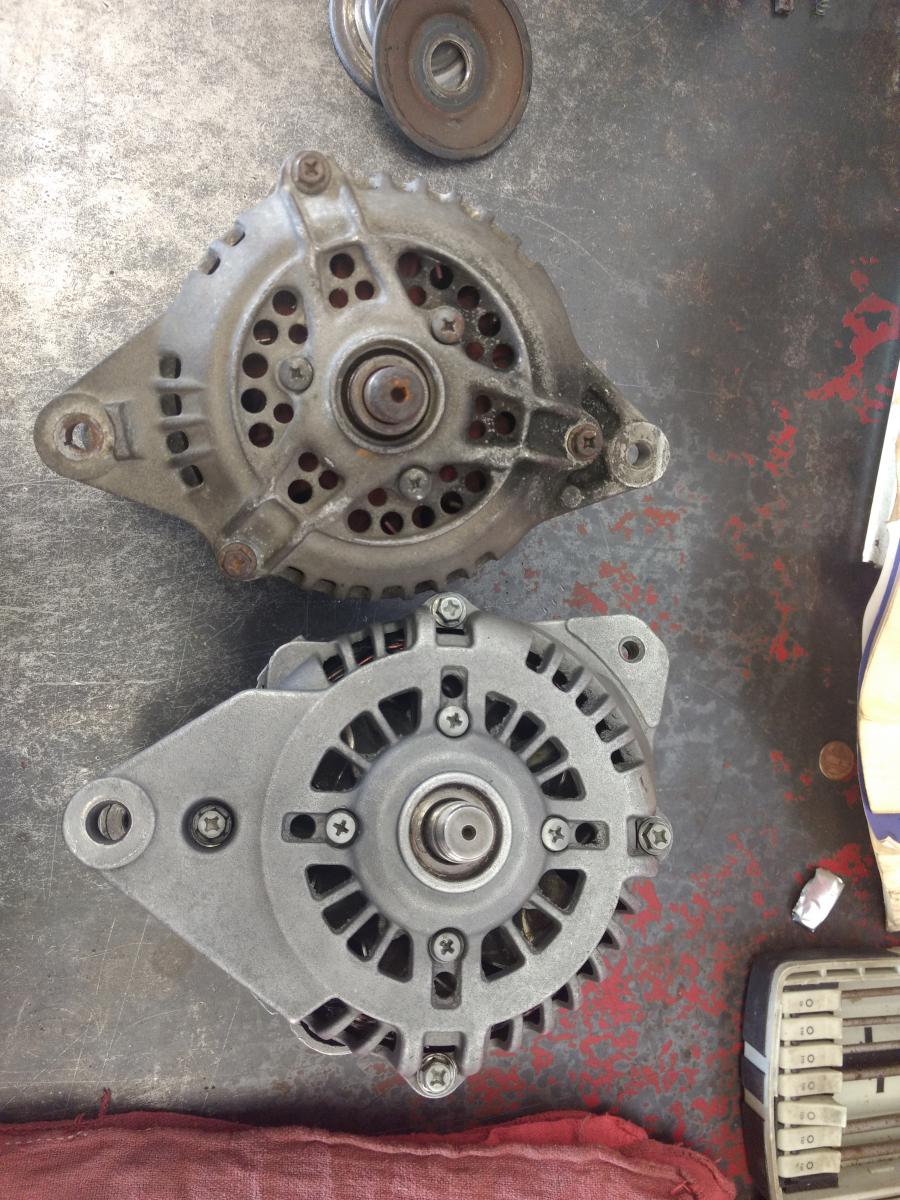

The Montero alternator does NOT work. I tried putting it on last night. It doesn't fit. Now I've spent $75 that I didn't have on an alternator that I can't use. somewhere in these forums, someone said they did work. And they don't. So don't waste your time with one. I've screwed myself with it. And won't be able to drive my truck for a couple months now because of it.
In what way does it not fit out of curiosity?
Attachment 21049Attachment 21049 also where the positive terminal comes out, you cannot get the oil dipstick into the dipstick tube.
Is it an alternator out of a V6 Monty? That is a bad blow dude, sorry to hear it's set you back like that. I still think a Hyundai alternator will work so I'm gonna hit the far, far away land of U-Pull-It to verify one from a J series engine will work on a 4 cylinder Mitsu engine. They're easy to get.

Yeah it's one out of a 3.5 liter. The ones older than 98 have a different top bracket. That one, I think will work. It also has a different positive terminal location.

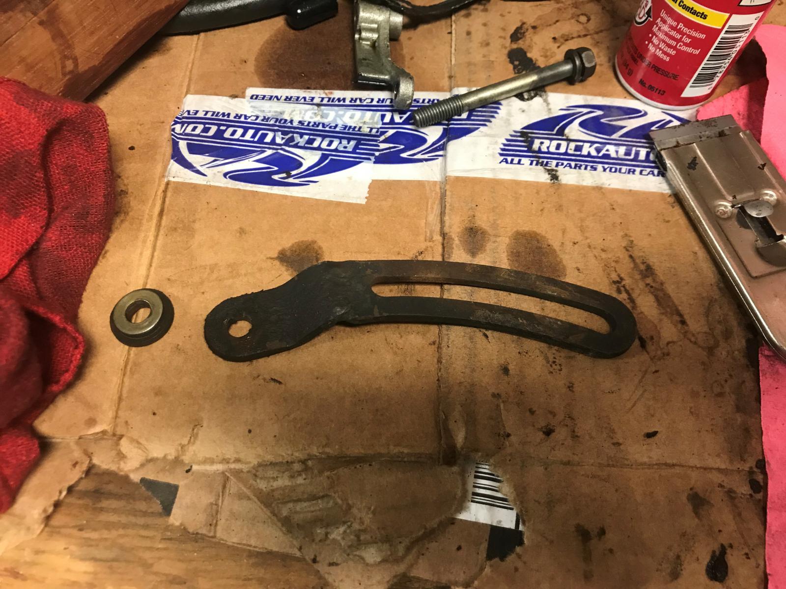

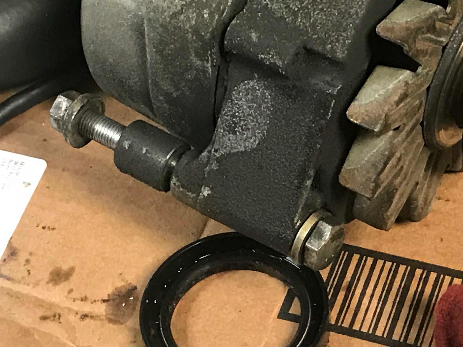

I took a few photos when I did my timing chain a couple of months ago. The brackets are very simple. The only thing you would need is a drill, a hack saw, and some files. I had to cut and weld the top bracket, but I'm betting you could find one to fit from another car or truck.
I didn't take a photo of it installed, I can do that later today. The wiring, i just cut the pigtail off of the 2 wires on the factory harness, and crimped on 2 spade terminals. You can buy 10/12si pigtails for just a few bucks to make it look a little nicer.
I was able to retain the stock size fan belt also.
Attachment 21102Attachment 21103Attachment 21104
Ideally the lower bracket could have a connecting link so that the front and back are always clocked the same in relation to the timing cover. I was in a rush to get it back on the road so its 2 pieces plus 2 spacers. Crude, but It's been on there for over 50K miles with no problem

My top bracket is plenty long. So I don't think I'll have to modify that. But after raising it higher and putting brackets on the bottom, does it still adjust good, so you have a nice and tight belt? The brackets look really simple tho.
my bottom pivot moved up about an inch. It's been raining pretty good the last few days, i'll get a picture soon of it installed. Belt is plenty tight. I stuff a prybar between the front engine cover (with a rag on the end) and alternator and just gently pull it it a bit to get it tight. I may have had to offset the upper bracket forward a bit.

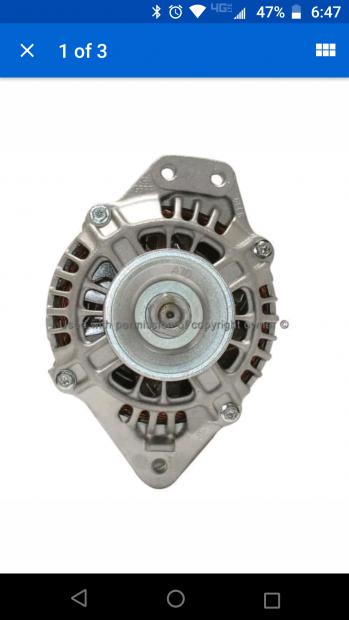

I ended up going the starion route. It was a direct bolt on for the 4g64. (for anyone else having the same problem I had trying to find one that works.) I just need to get a new belt. Since the top bracket is in a different position, it makes the pulley closer to the engine. I put the old one I had on it for now to see how well it worked. My old alternator was putting out 12.6 volts. This one is putting out 14.6. So I won't have to worry about it not charging the battery well enough.
