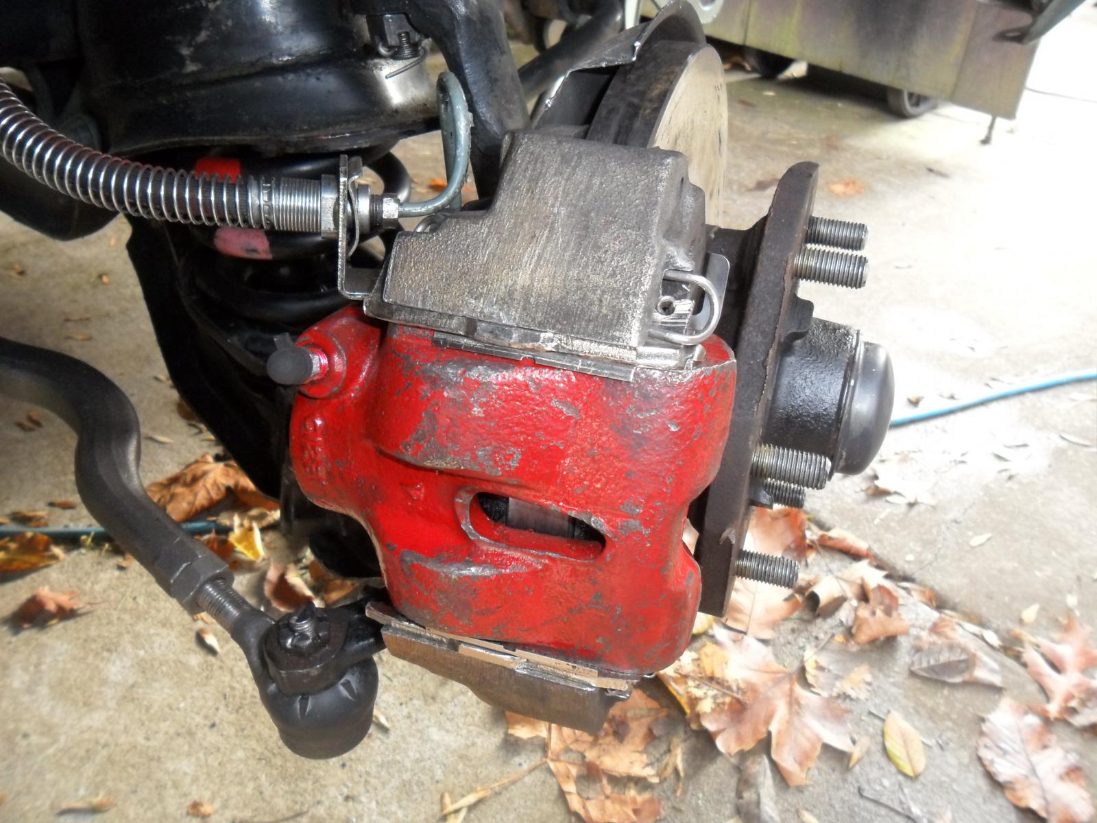

Originally Posted by

the pins on the plate are there just to locate the plate and keep it from sliding out - they can be the one side flat pins if they don't bind with the caliper. The confusing thing with the 1st gen front ends is the fact that only one side of the tie rods is adjustable, which makes it harder to get the front end lined up. It also requires you to pull the steering wheel to center the wheel when the wheels are pointing straight. Most alignment places do not know that, or will charge you crazy money to pull the wheel to center it.
