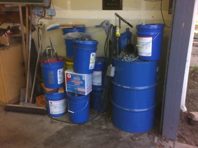

So Camoit, do you use the Delo 400 15w40 all the time or just as a cleaner? I am not familiar with it and googled it but am still not clear.
2 Attachment(s)
I use it all the time, in pretty much everything. You can say I use a lot of oil. Engine, Hydraulic, ATF, Gear, Grease, water soluble, light machine,chain / cable lube. Then I wash the concrete trucks with a solution of Muriatic Acid and water. Just enough to make them smoke when applied. I don't suggest washing a D50 with Muriatic Acid, but it will make a driveway nice and white again. About 1 quart to 3 gallon of water. Then rinse the hell out of it. When you think your done then rinse one more time.
