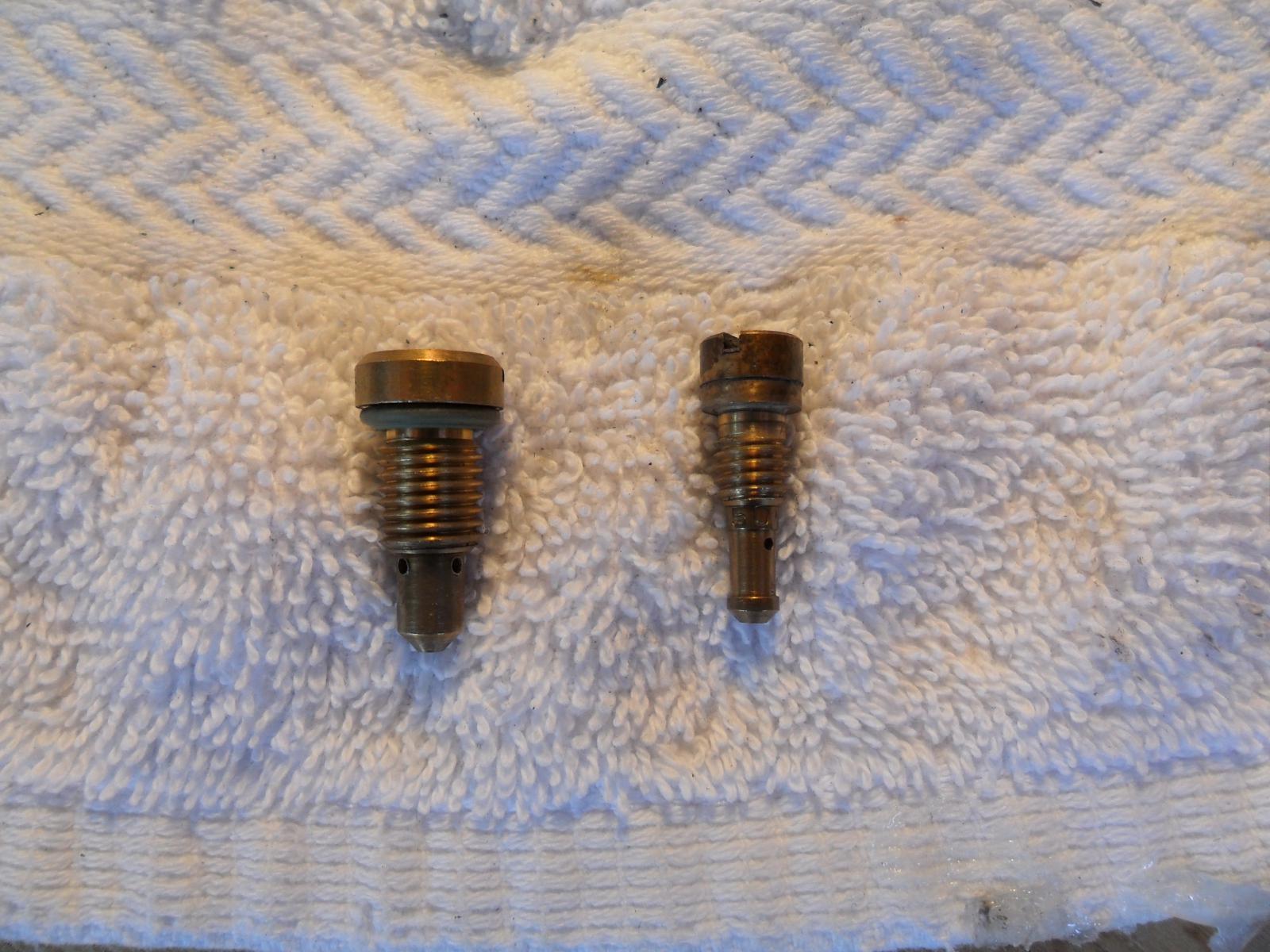

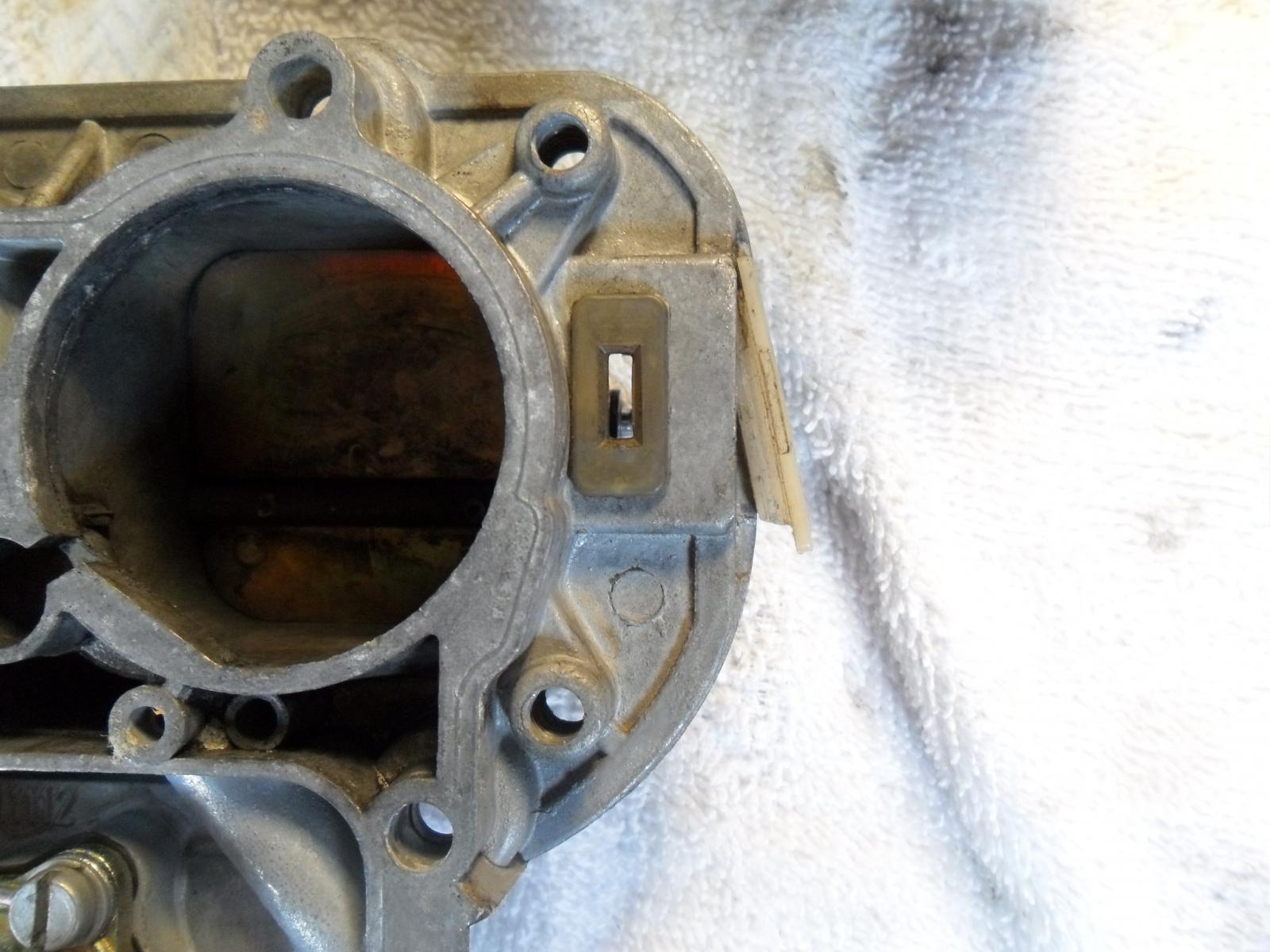

I looked at the picture above the specs and the two in the pics would be the idle jets according to that picture. They have no size numbers on them. As for the rest of the sizes the ones I list are what it had when I bought it and until I rebuilt it it worked fine. As I mentioned I had no idea the parts that were so similar had differences.
So the main jets must be at the bottom of the bowl, the air correction jets must be the ones on top of the emulsion tubes.
I just noticed the 50 on the secondary idle jet on the right in the pic. I'll look closer at the primary idle jet for a mark. Let me know if I worked out the part names correctly.
