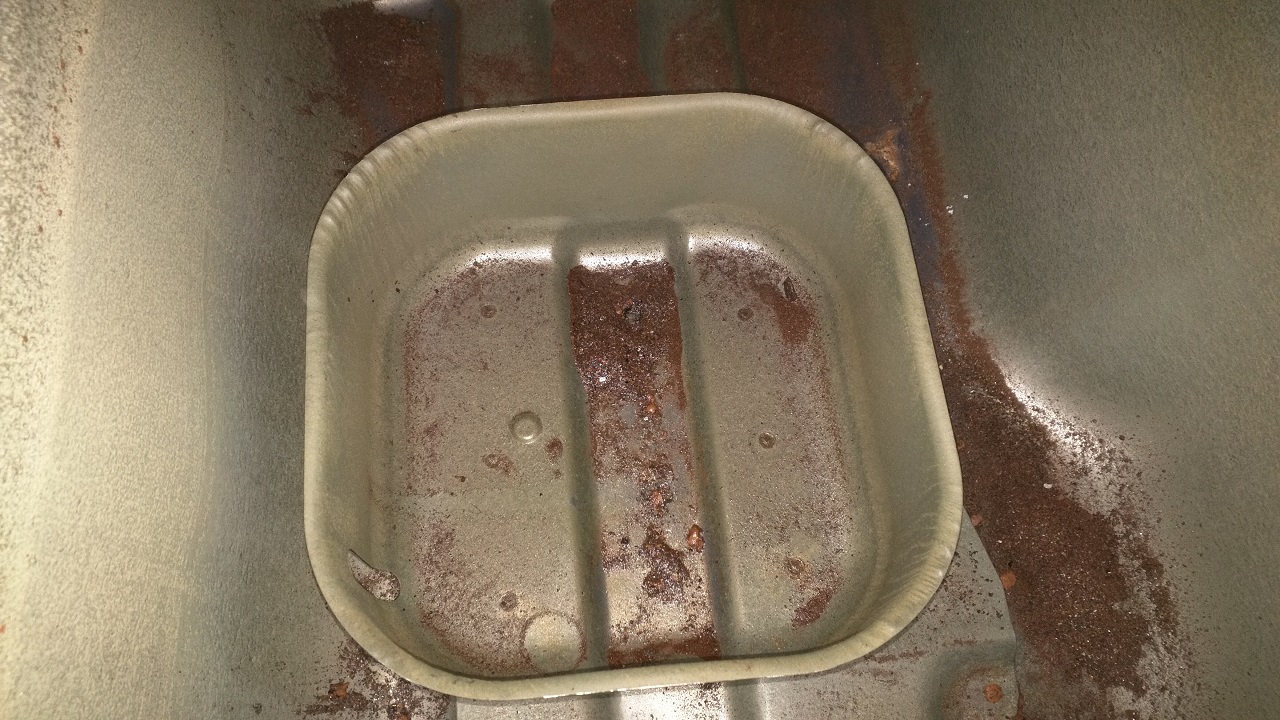

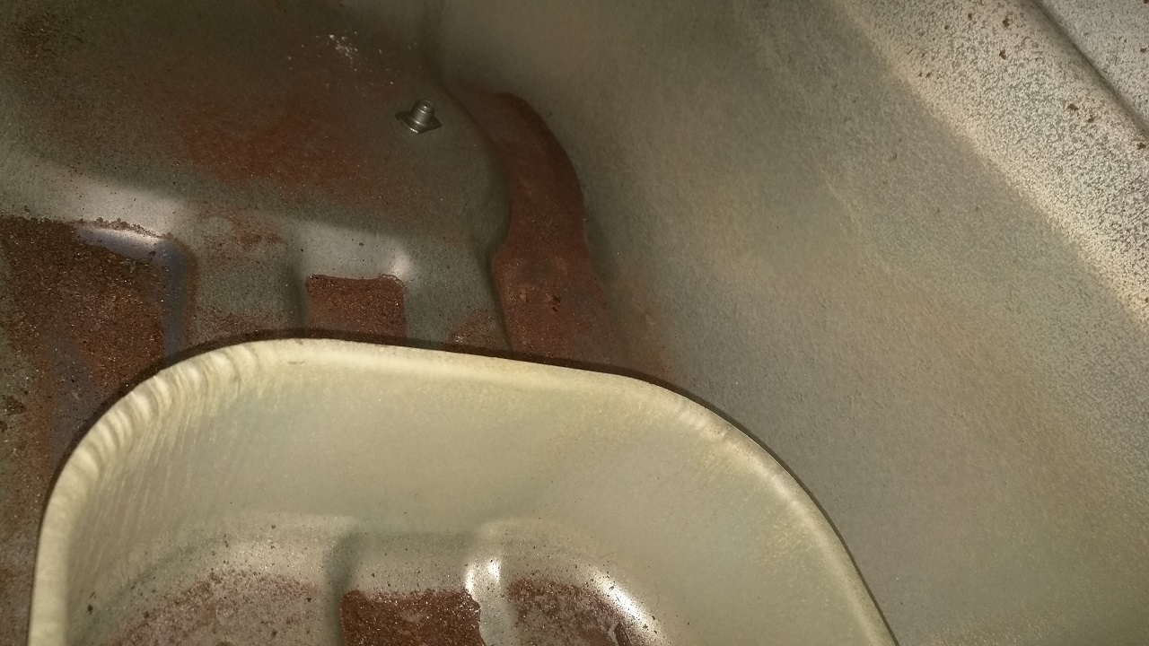

I'm posting these in the hopes they'll help someone in the future, and also to serve as 'before' pics while I'm waiting for my POR 15 kit. The little silver stud in the first pic is the drain bolt closer to the rear of the truck.
Attachment 16028Attachment 16029Attachment 16030Attachment 16031

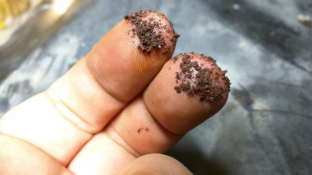

The little piles of rust are just that...loose crud. I dragged my fingers through them and the stuff came loose with no effort at all. Some moderately high pressure water would knock most of it out. It looks like the rust holes in my tank are underneath the square tray where the fuel pump sits. I'll have to make sure to blow the crud out from there, and spend some extra time circulating sealant in that area.
Interesting how clean your tank looks. Even better than mine. I can't see how the lower submerged area could rust out being that there is no way for it to oxidize. I determined that virtually all my rust came from the upper 1/3 of my tank where air was present.
