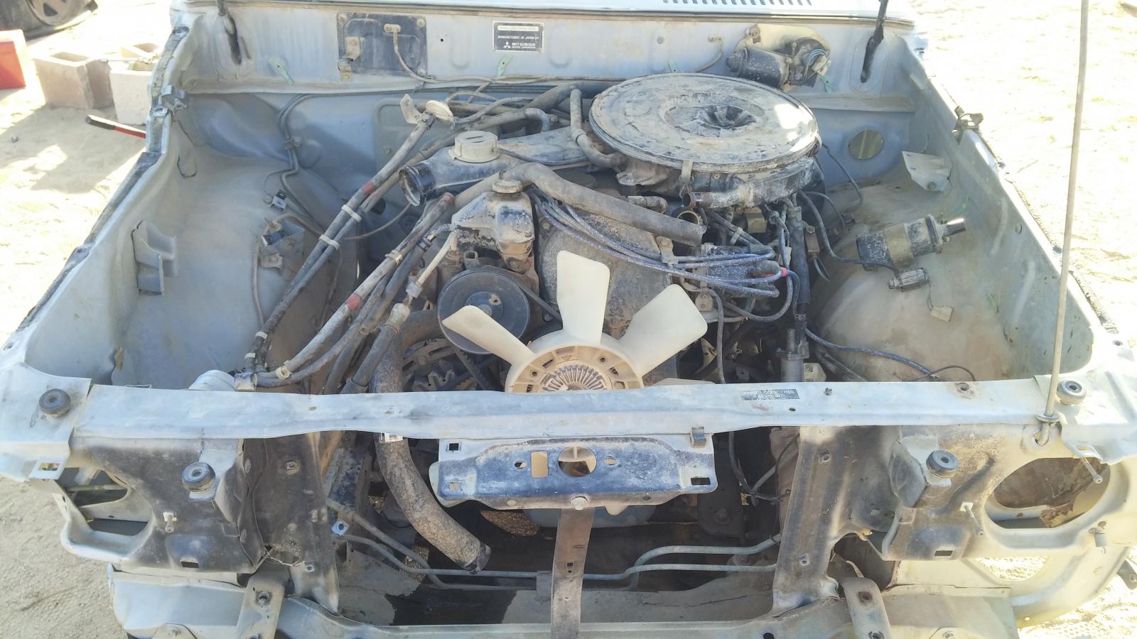

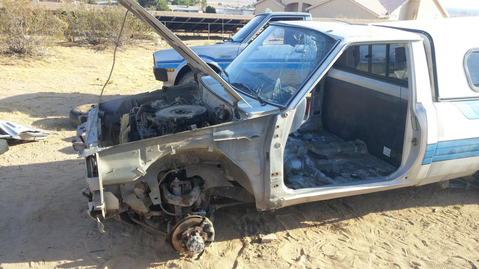

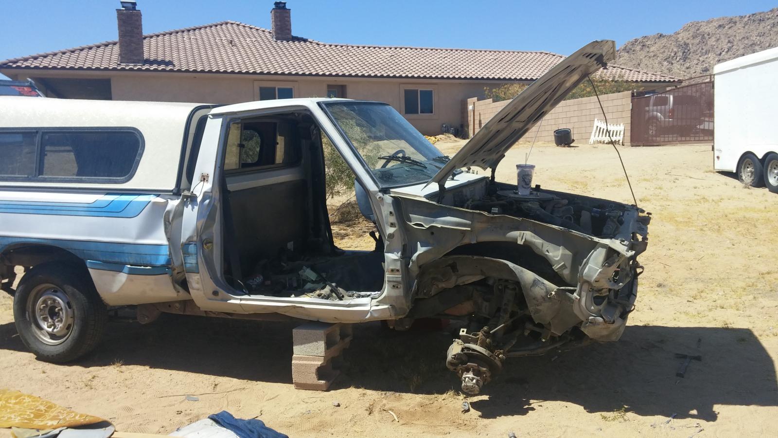

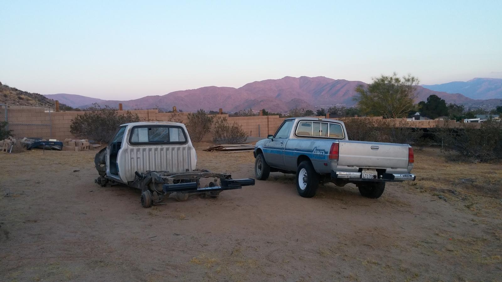

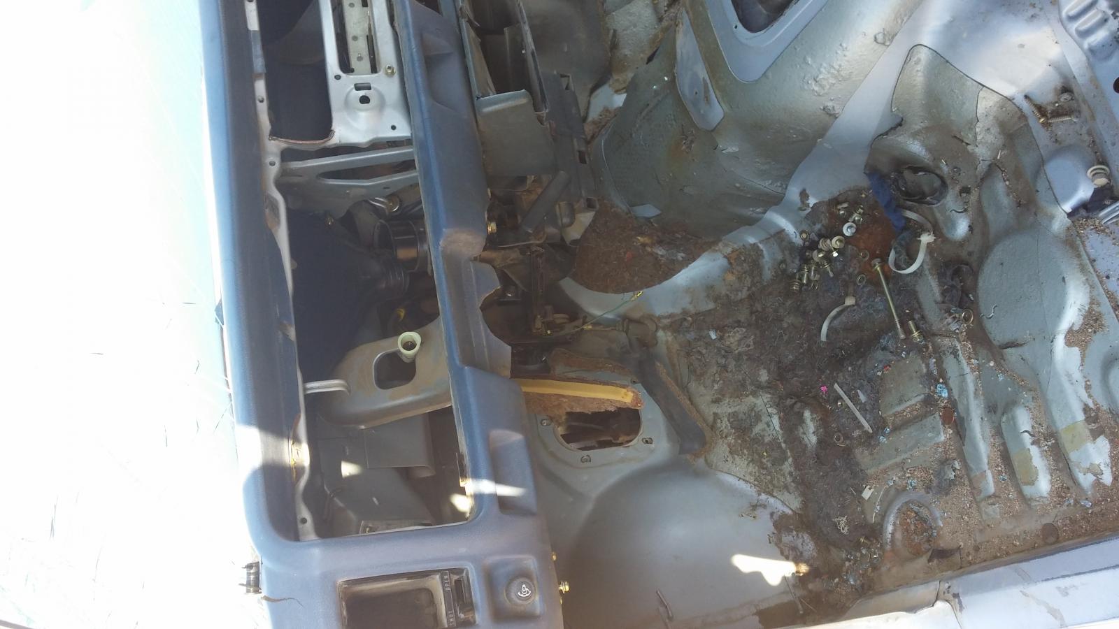

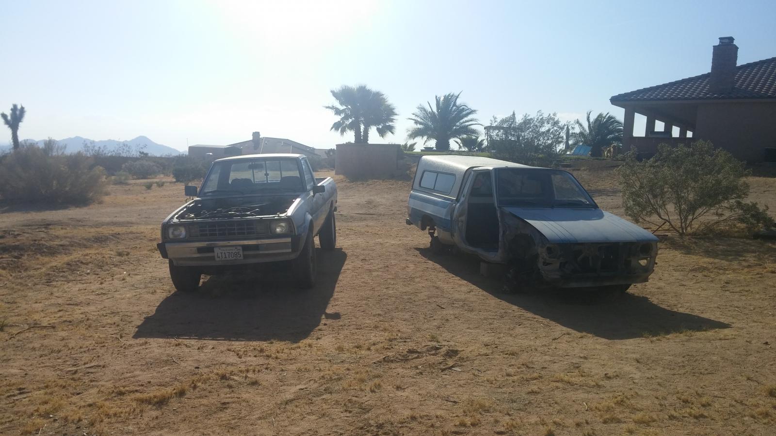

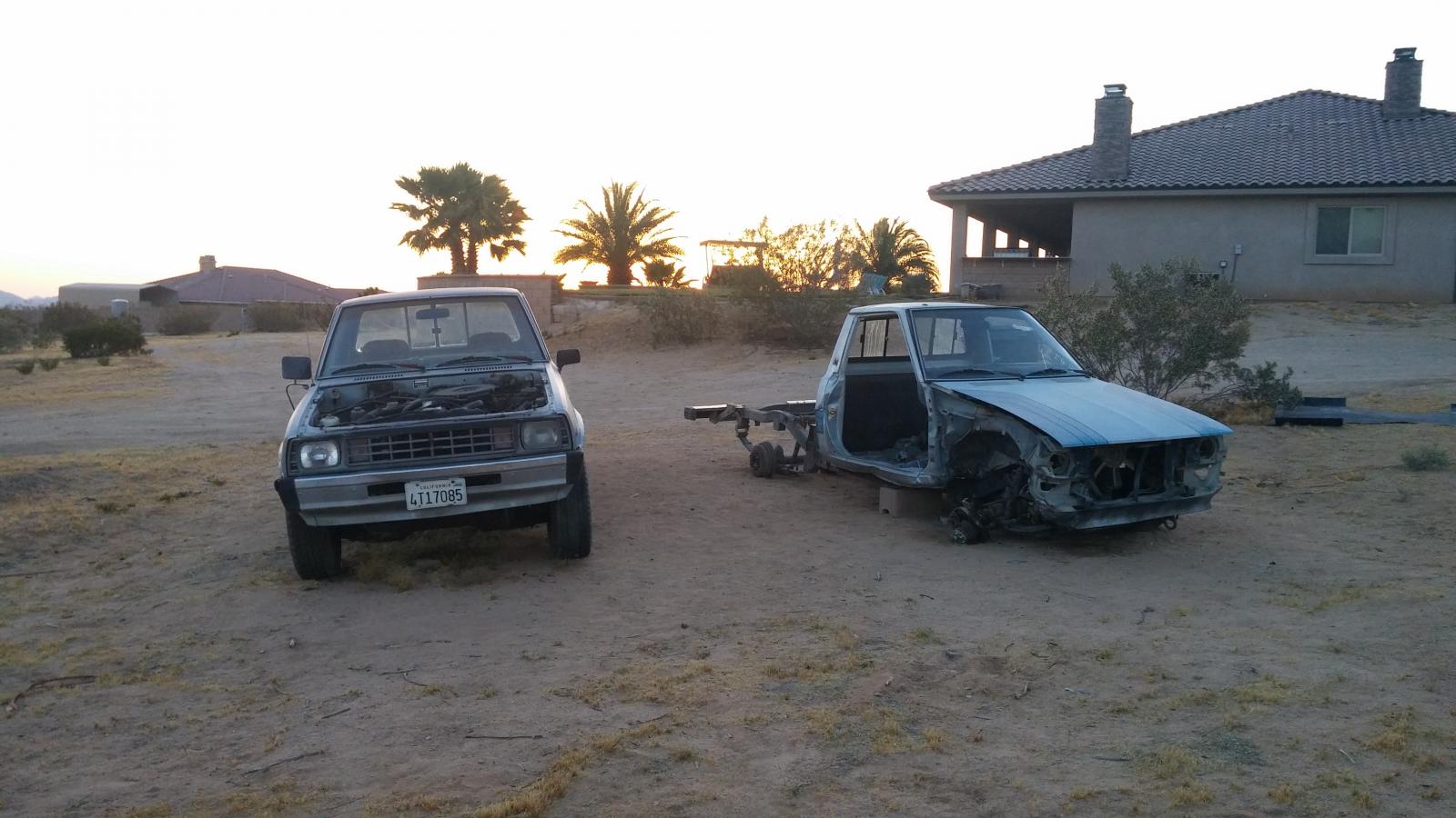

Alright here are some pictures from the teardown. If anybody needs any parts just let me know!
Attachment 14080Attachment 14081Attachment 14082Attachment 14083Attachment 14084Attachment 14085Attachment 14086Attachment 14087Attachment 14088

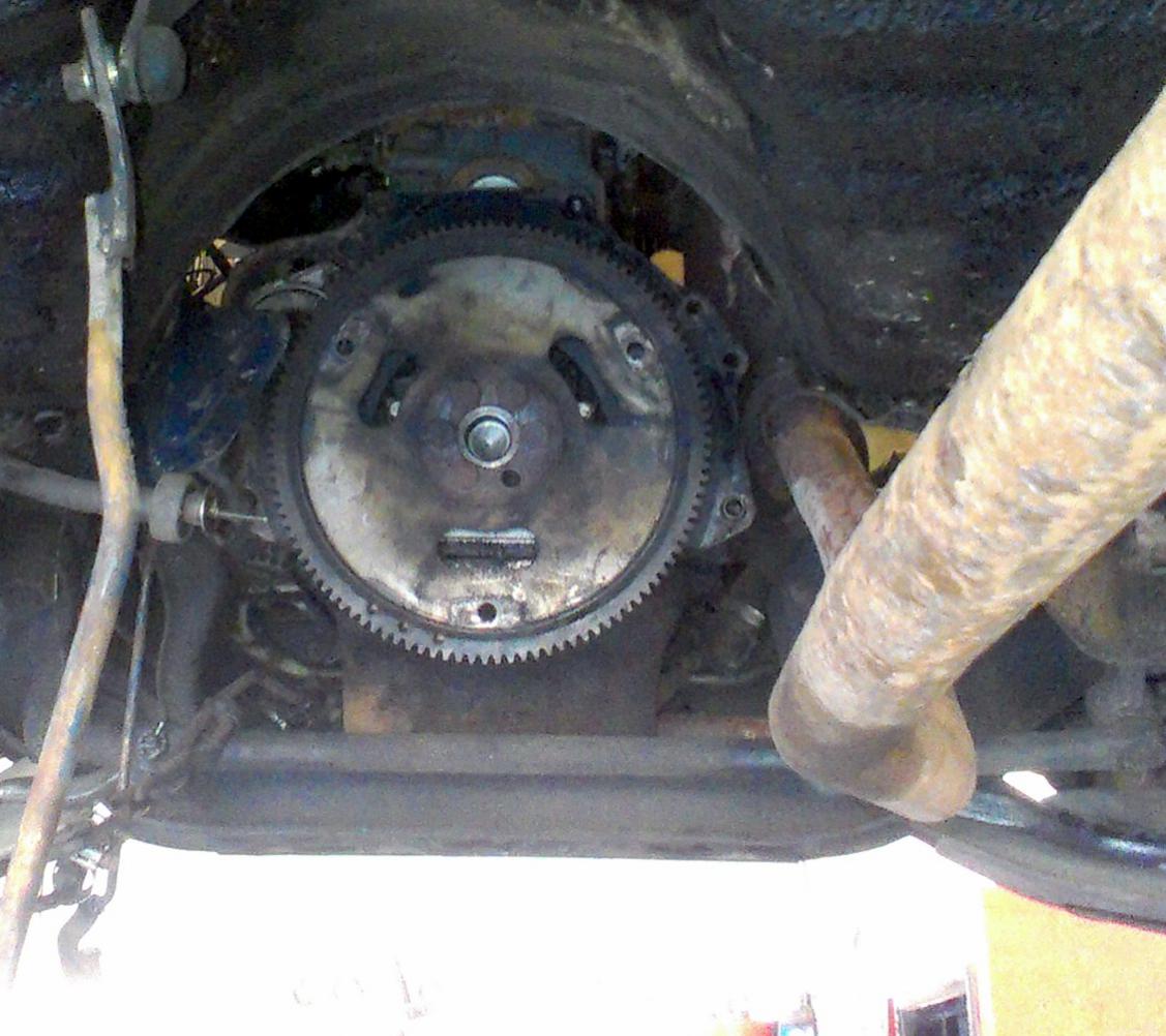

Well, like I said before, I'd be willing to buy an automatic flexplate if you got it.
Here it is, sorry for the crappy cell phone pic:

I have to see what flex plate is on my truck. It's the 2.6 engine so I'm not sure how many bolts it has.
All of the 4G52 (2.0) and 4G54 (2.6) are 6 bolt centers, the difference in bolt patterns is the torque converter, the image you showed is the three bolt torque converter, which i have here in mesa, i also have a spare auto trans and a spare 2.6 engine.
I have a good running 2.6 narrow block here in mesa and I'll buy that grill and tail gate off you if you're willing to part with it. PM me your number if you want.
I went out this morning to grab it and count the teeth when i realized it's from my 4G32 engine, which is the 1.6 liter, which means it uses only 5 mounting bolts at the crank, so it wont work for anyone here. I'll label it and tuck it away with my other Colt parts. Sorry about that Haruman :(
