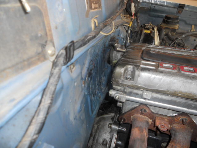

Here's my first 1st gen swapped truck. You just need room for the CAS to clear. Also the brake booster will have to be moved back an inch to clear the intake manifold.
Attachment 18717
Attachment 18717
