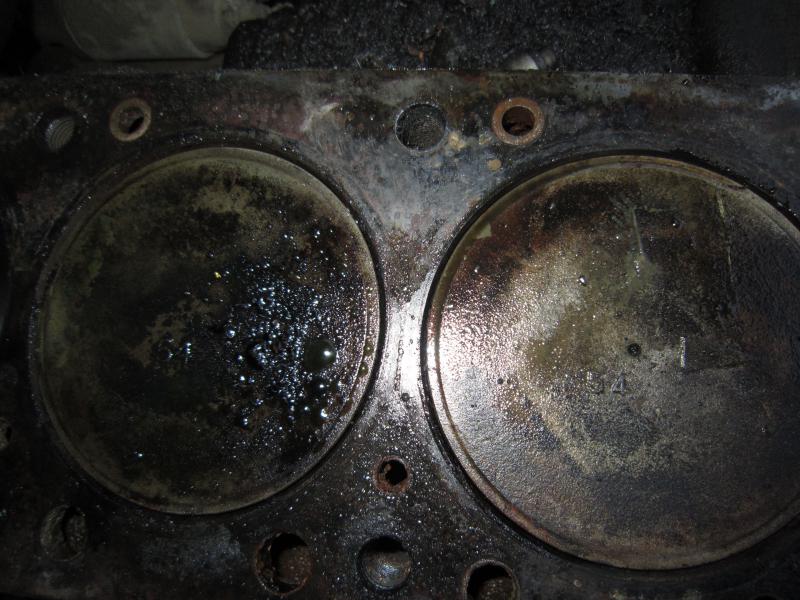

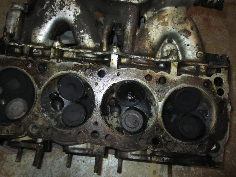

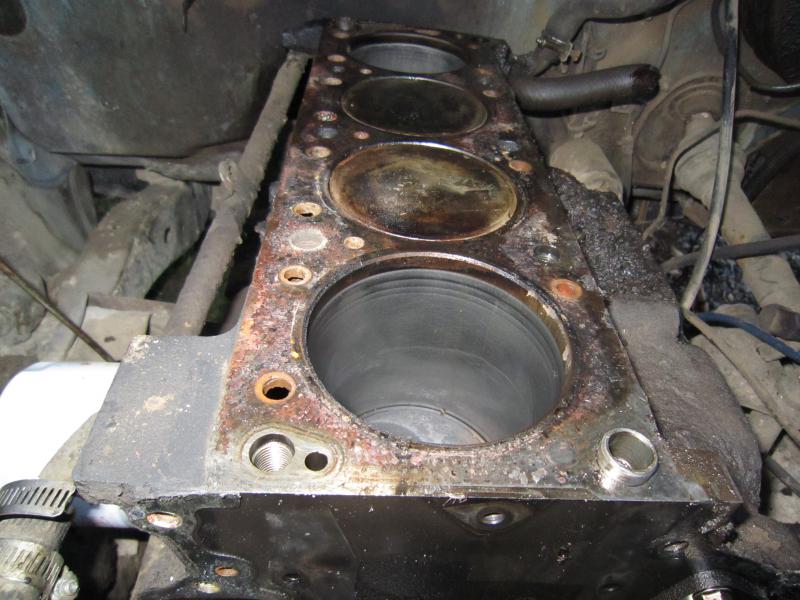

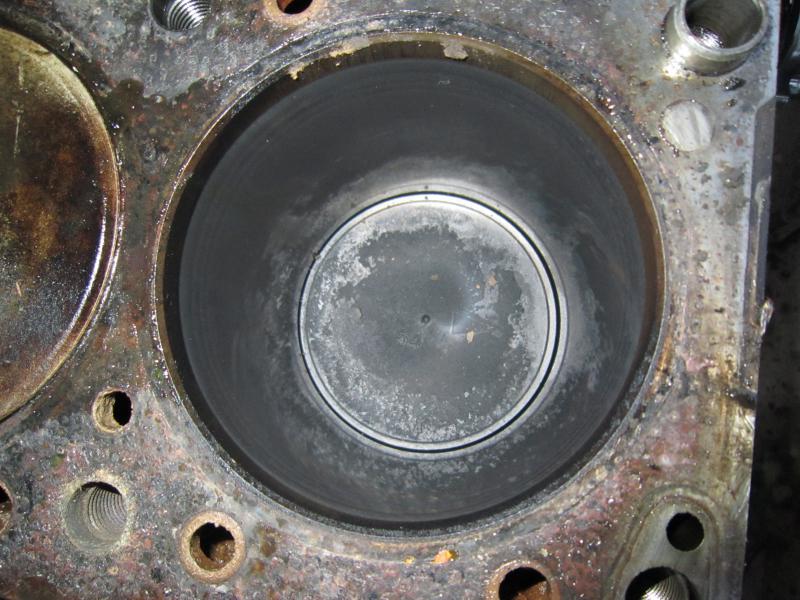

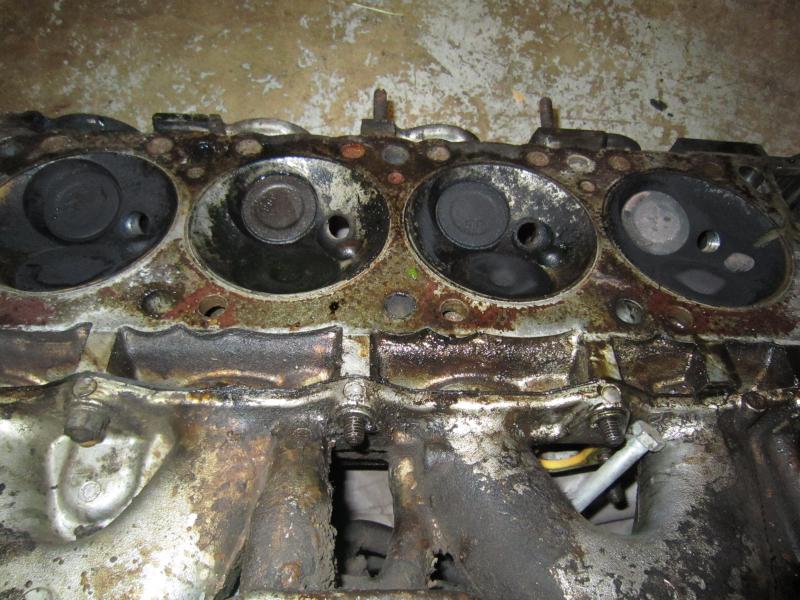

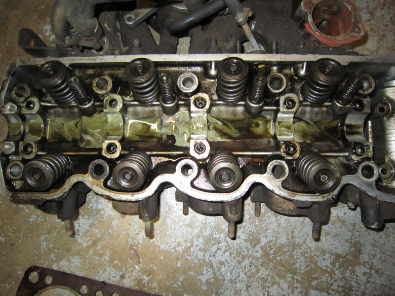

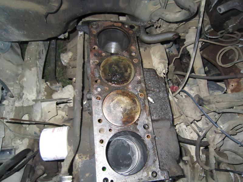

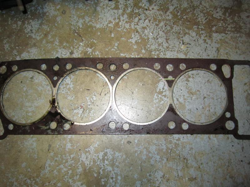

Here are some pictures of the head and pistons. I included head gasket but I havent cleaned everything up yet or got the rest of the block out. Beware it is pretty nasty.
Attachment 13511Attachment 13512Attachment 13513Attachment 13514Attachment 13515Attachment 13516Attachment 13517Attachment 13518
Well, strangely your head gasket looks nice. Examining the head, It looks like the issue beginning to clean the #2 & #3 cylinder valves. Decarbonizing them. Were you getting water loss as well as water in the oil? Did you happen to do a compression test before the build? It does not look like it has been doing this very long at all and doesn't look real serious either. Most the time with our engines , after over heating they acquire hairline cracks between the valves or if installed...MCA jet valves. Might be also a good time to install the MCA jet valve removal kit. For about $20 it can take that problem out of the picture for a possible later return of trouble.

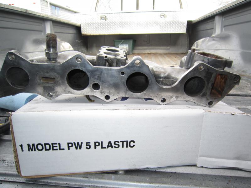

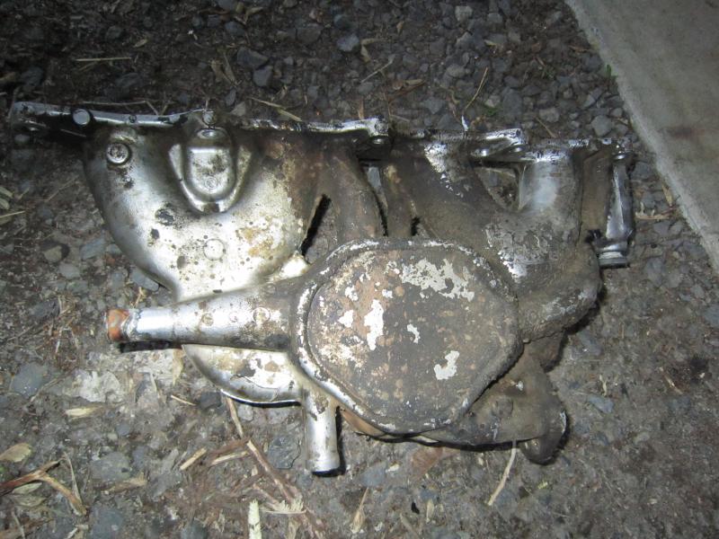

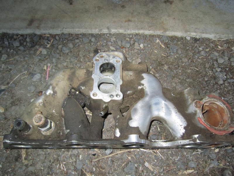

Here are some pics of the intake manifold so far. A little more time and should look close to new.
Attachment 13649Attachment 13650Attachment 13651Attachment 13652
Thanks for the advice on the WD40 and the softer brush. There are only a few scratches on one cylinder so I once all clean i will then sand them out. WD40 is working wonders and I switched to a brass bristle brush so I wont scratch. Will post pics here soon. Lots of deposit's and just plain old gunk.
This is of the cylinder that I scratched. Looks like it should all come out and that they arent too deep. Let me know what you think. I only had a tiny bit of WD40 so I will get more tomorrow and finish up the head. The scratches are in the upper left so if you click on the pic to make it bigger you can see some that dont follow the normal swirl.
Attachment 13687
Here are the other cylinders. Ran out of WD so I didn't get that far but they appear to be cleaning well.
