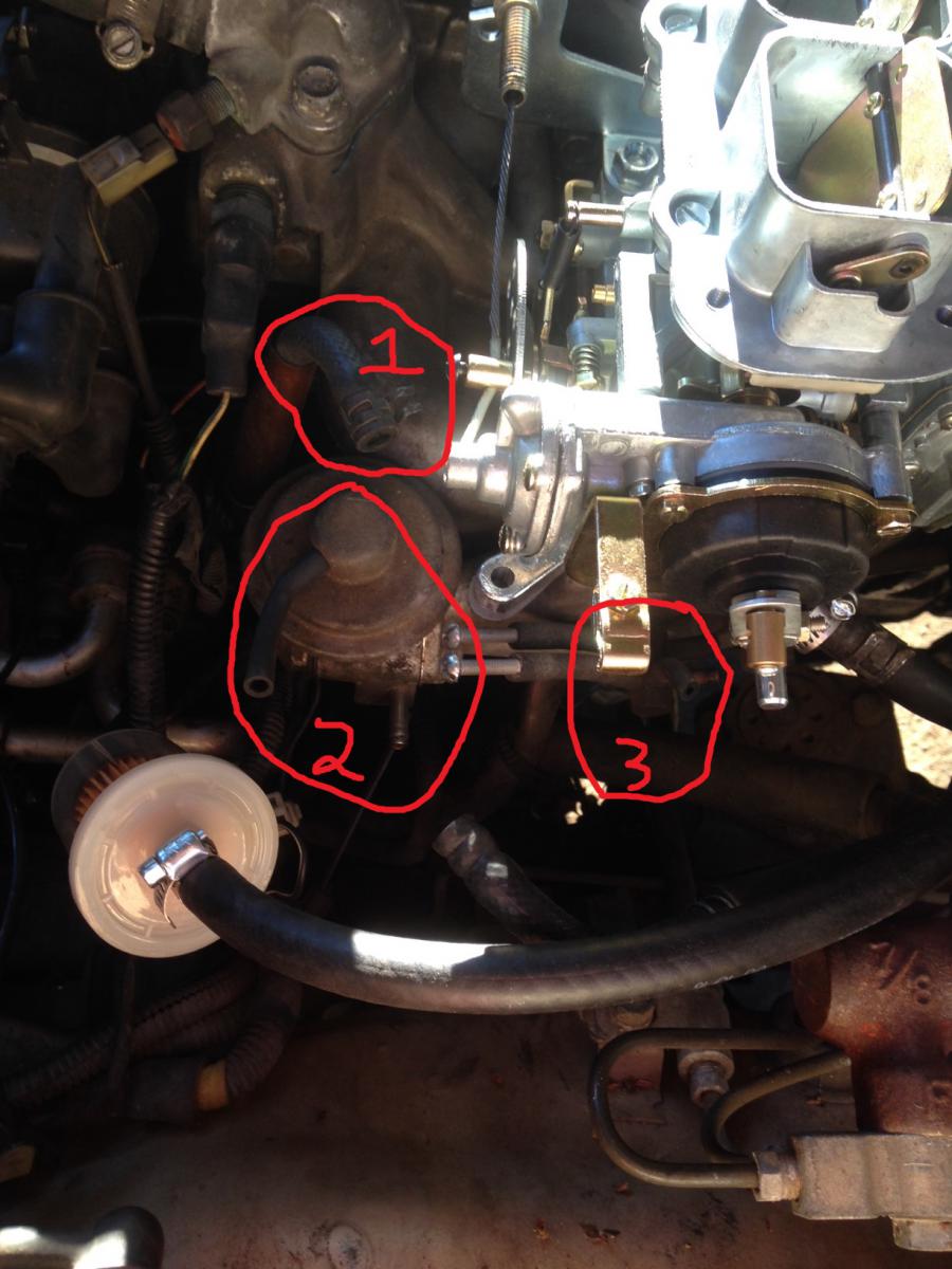

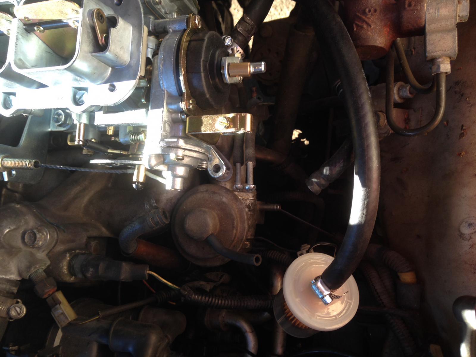

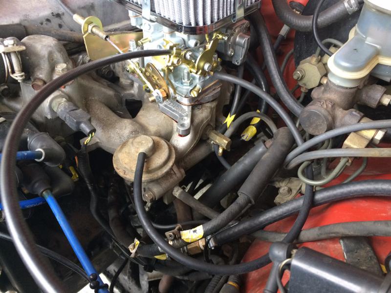

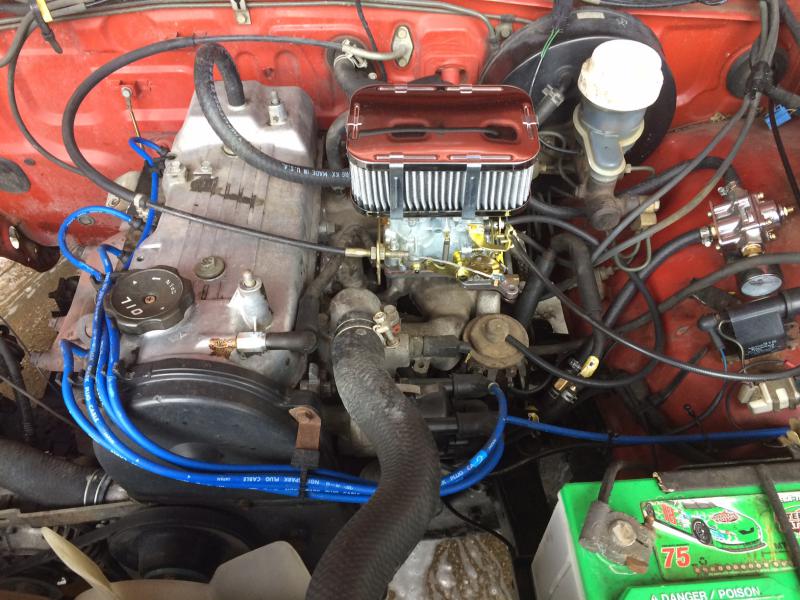

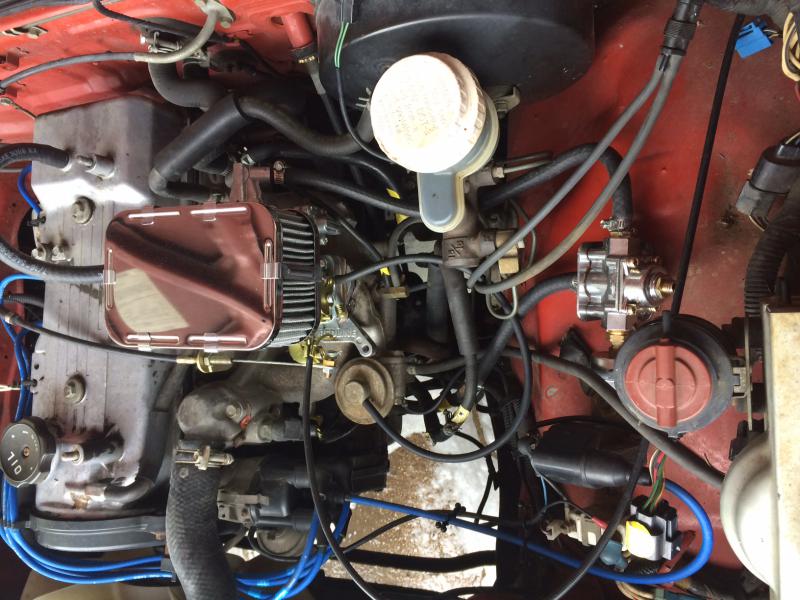

As I mentioned, I'm still trying to decide where I want to register this truck and that will determine how much 'extra baggage' I can trim from under the hood for emissions testing. For this reason, you will notice a few parts still on the truck that many of you may have removed. I still have some clean up to do, but everything is running great!

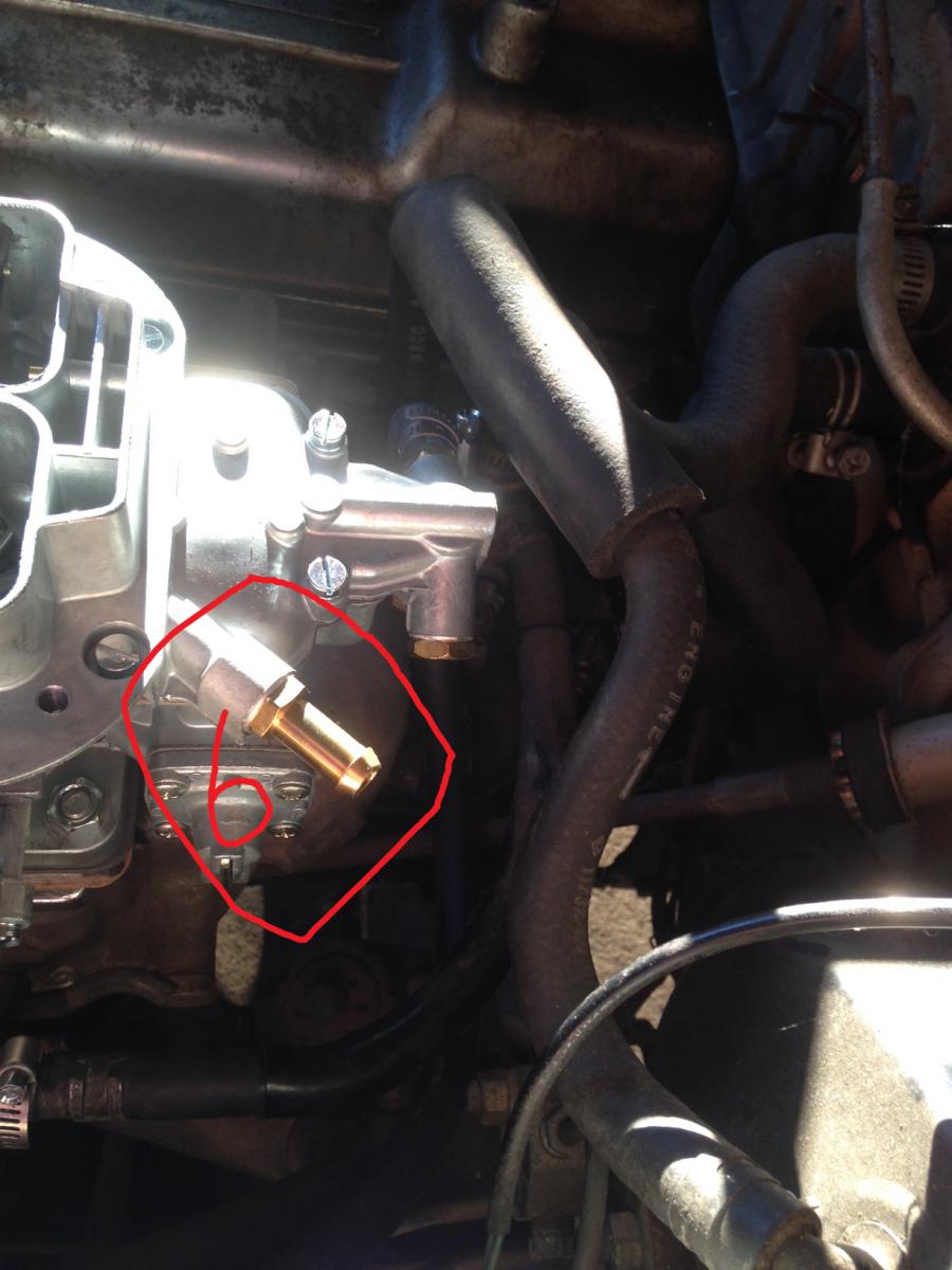

Attachment 13302

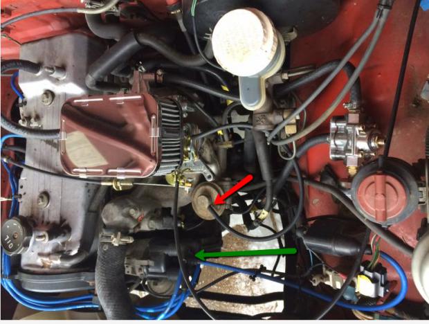

Attachment 13303
Oddly enough when we plugged that little tree (with vacuum ports), it killed the truck. So we plugged a few of the factory vacuum lines back up (where applicable) and it actually helped the idle settle right down where it should without any adjustments to the carb! When we plugged the remaining two ports, it wanted to stall out. So we left those open.

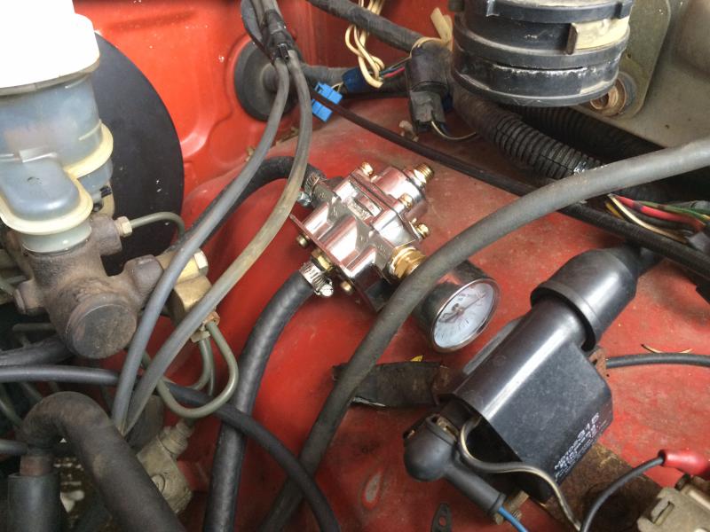

Attachment 13304

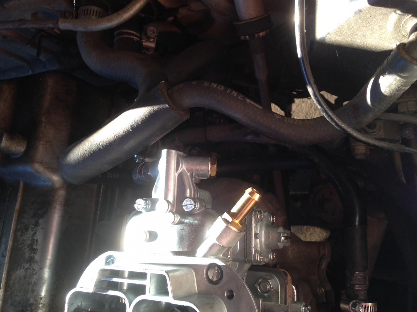

Staying steady just under 3 psi. But, the fittings for this suck! I had to wrap each thread about 3-4 times with thread tape so it wouldn't leak :(

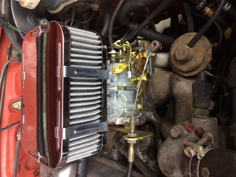

Attachment 13305

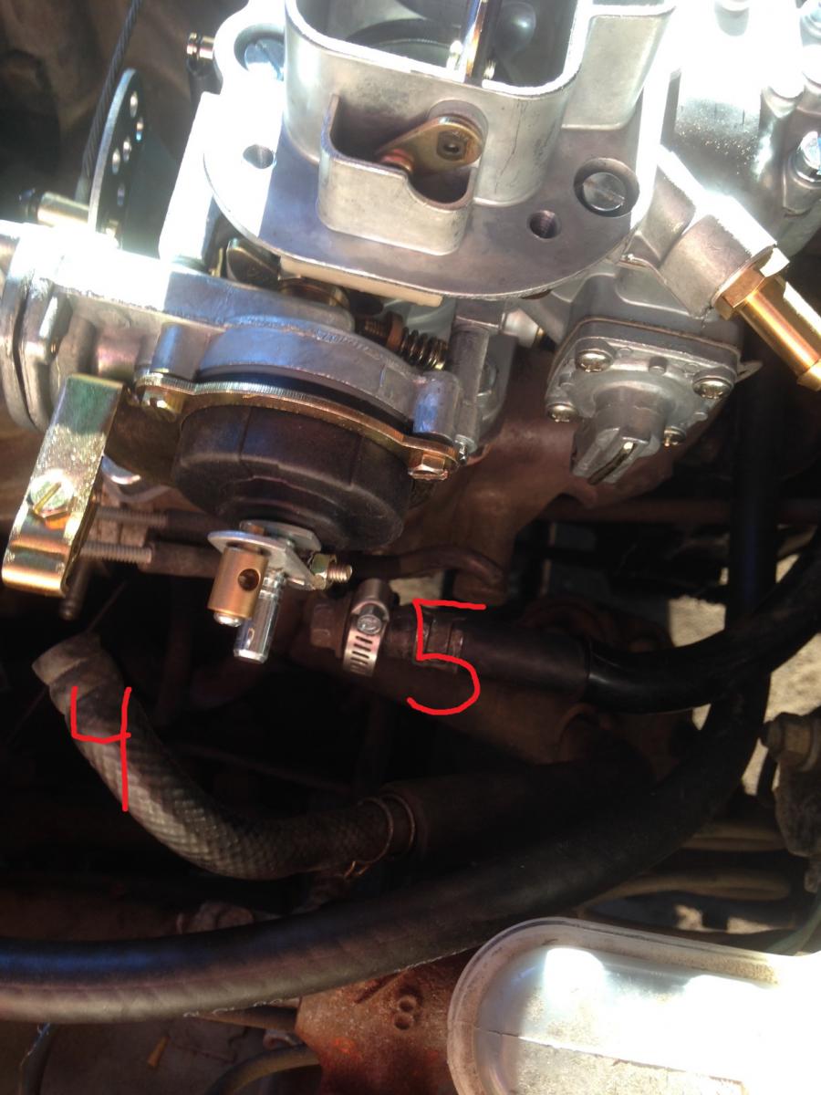

My only regret is not going with the electric choke. I'm going to have to order a heavy 'wire' style cable for the manual choke. The one Redline provides will open the choke, but doesn't have the strength to close it back up (when the cable has to push).
