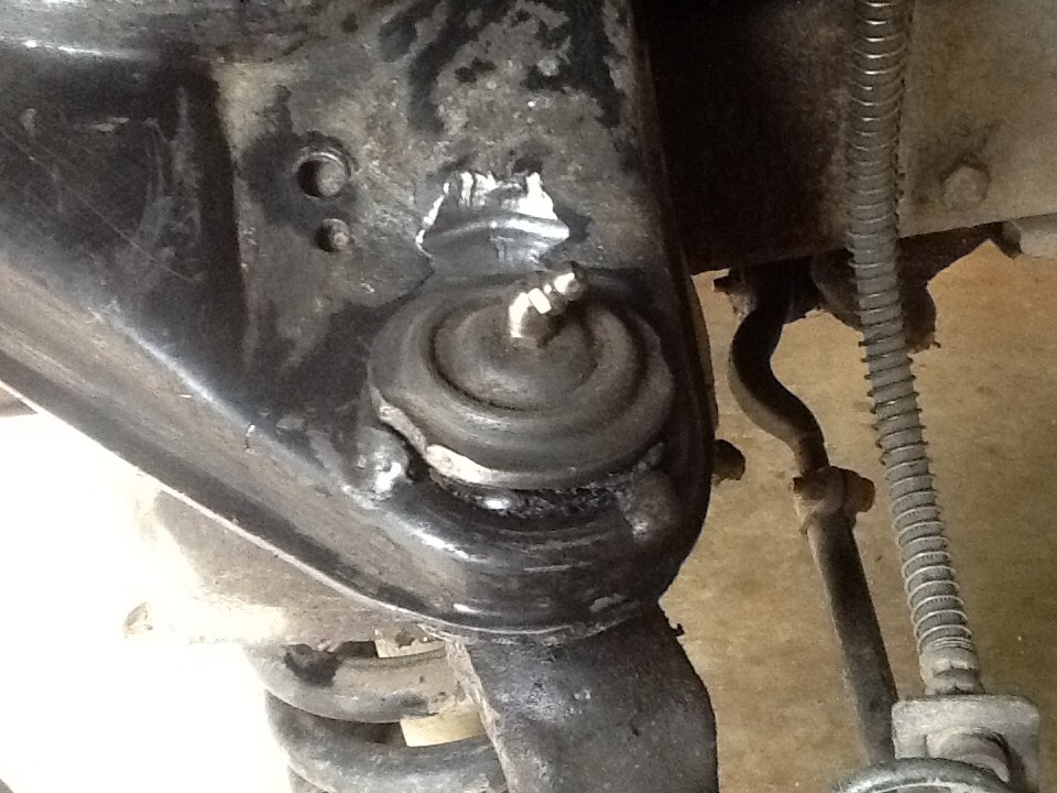

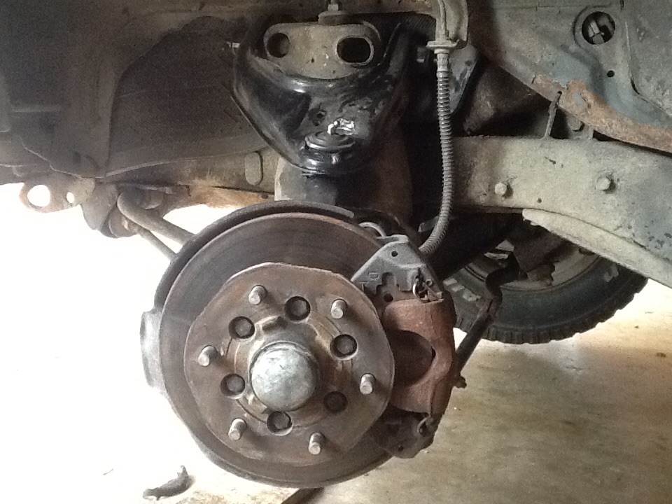

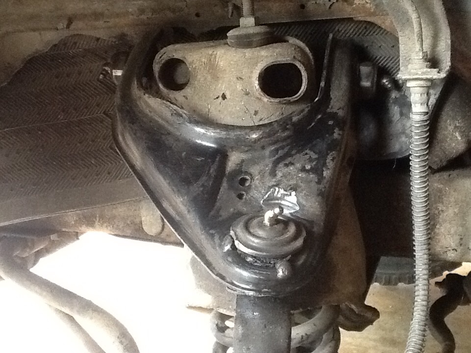

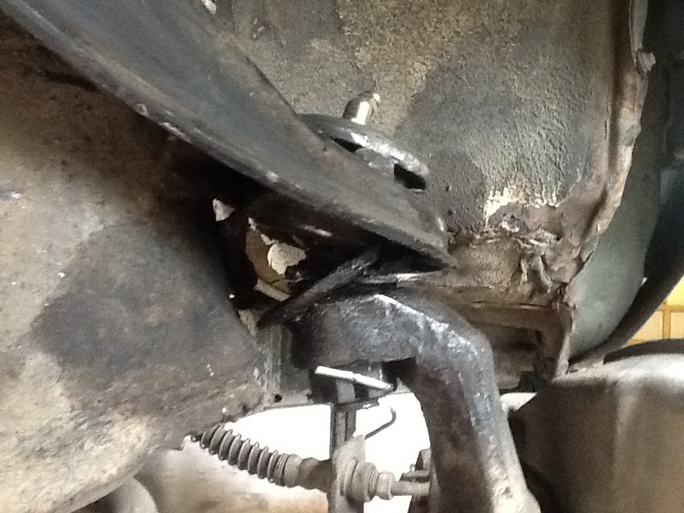

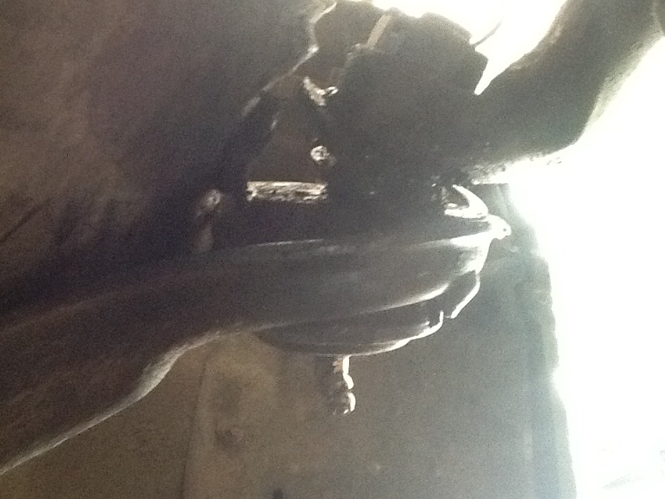

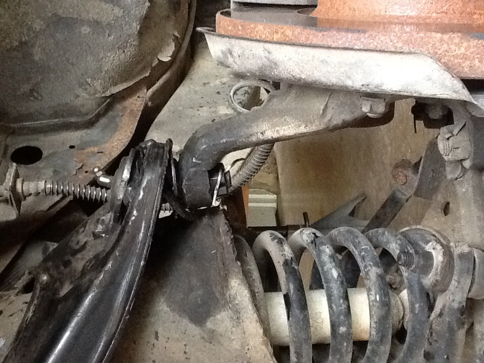

Attachment 14012Attachment 14011Attachment 14013Attachment 14014Attachment 14015Attachment 14016Attachment 14017
A few "before" pics
ball joint was shot. Previous owner even had a couple of welds on it that broke, tells me this has probly been a trouble maker long before I took over. Ball joint is popped out of control arm and made a pretty gnarly score in it

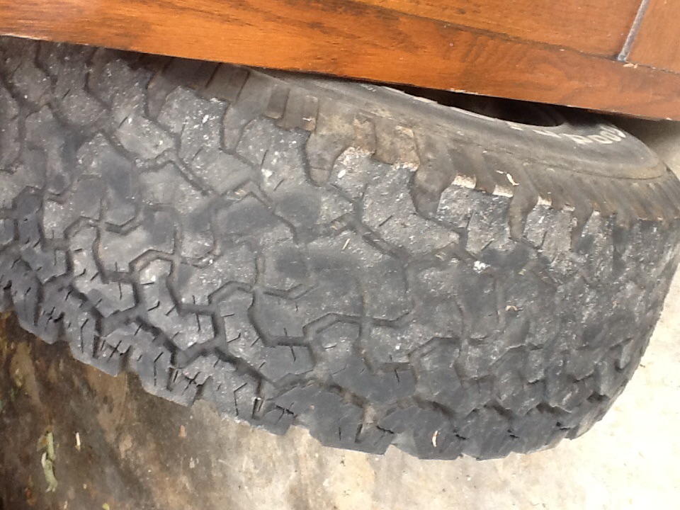

it ate through my tires
also on the upper control shaft on my drivers side, I am able to move the inner nut with my finger. I tried to move the same nut on my passenger side and couldn't. Is this something that needs to be tightened or is it just a dust seal or something. To clarify its the inner nut not the huge ones on the sides. If you look at the first picture, if I put my finger into those holes to access the control shaft bolt I can move the nut on the left inside of that hole
