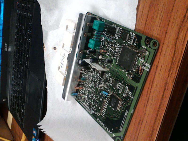

For best results get as close as you can on the uF rating - voltage can be higher. The uF rating tunes the circuit, so that needs to be close and preferably exact.

Are these the one you need.
http://www.radioshack.com/nte-nev47m...s#.VLns4TDogg8
http://www.radioshack.com/nte-nev100...l#.VLntGDDogg8
I hope it helps?
You can check Fry's electronics also

Put the truck back together (timing, timing cover, fan, belts, etc) and I picked up/ installed the new capacitors that I got from micro center right down the road from my work and shop! same exact specs to. Now im just letting the ECU dry before I hummi-seal it. Also the de-soldering tool I got from radio shack is awesome, has a heated tip that melts the solder and sucks it up! made the job very easy. More updates coming later today!

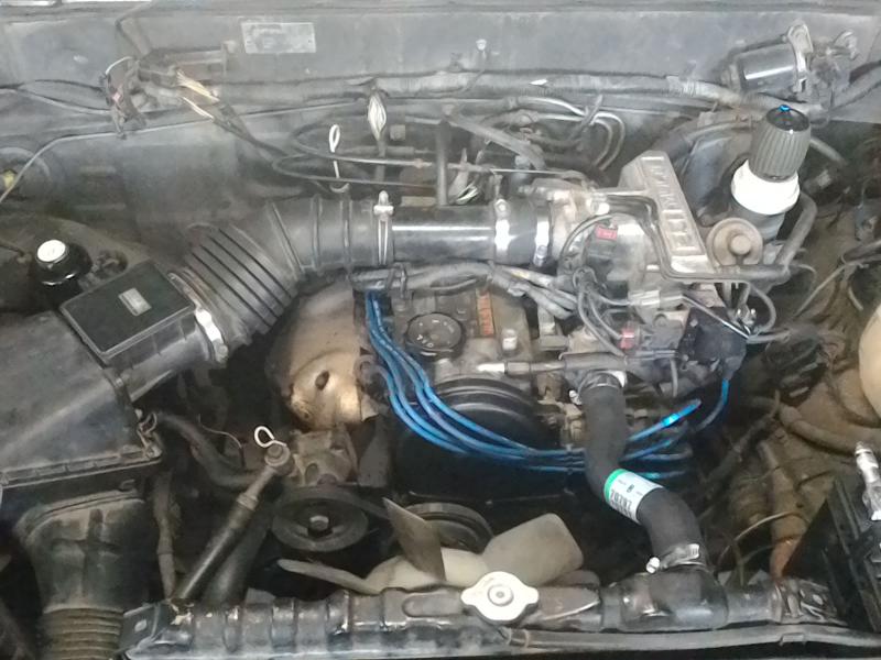

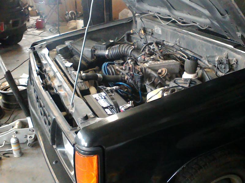

Update: Ecu is now back in and it works!! The truck now runs way smoother and has no misfires any more but its hard to start and once started the idle shoots way up and stays high. Sounds like its getting to much air or something is out of wack sensor wise. Any idea on what It could be that is causing that? any common known issues that cause that? I went ahead a bought a new pcv and coolant temp sensor, will install and see what happens today or tomorrow. Any other info is greatly appreciated!!
P.S. Truck looks good outside and it drives well minus the issue stated above.
Attachment 12720Attachment 12721Attachment 12722
Great!
There are two coolant temp sensors, the 2 prong one that goes to the ECU and the single prong one that goes to the gauge. If that doesn't work, check for vacuum leaks and test the MAF and TPS with a multimeter. I don't remember the resistances but they're in the Manuals forum somewhere. The pdf of the Haynes manual has them I think.
Two things to remember, 1. After disconnection, your ecu needs to run at idle for a while so it can run its tests and make its adjustments, especially if maintenance has been done. 2. There is an idle control that should be adjusted after maintenance. Easiest to set if you know someone with the old obd1 scan tools.
You can use a voltmeter or DroppedMitsu's Radio Shack buzzer. It's in the wiki. OBD1 is crude, you count pulses the ECU sends out and then look up the numbers in a table.
Update: Found my idle issue...adjustment screw was all the way in (hur-dur!!) Also replaced the the 2 prong coolant temp sensor, replaced fuel filter, Checked tps (5.4k ohms), maf is good, no vacuum leaks, and put 5 gal of fresh gas in it. Here comes the not so good news, truck is still hard to start when cold but once warm. It runs fine like it was new, Kinda stumped on this, going to check plug gaps tomorrow or later in the week. Kinda learning towards o2 sensor but what else could cause this issue? any insight would be tremendous!
