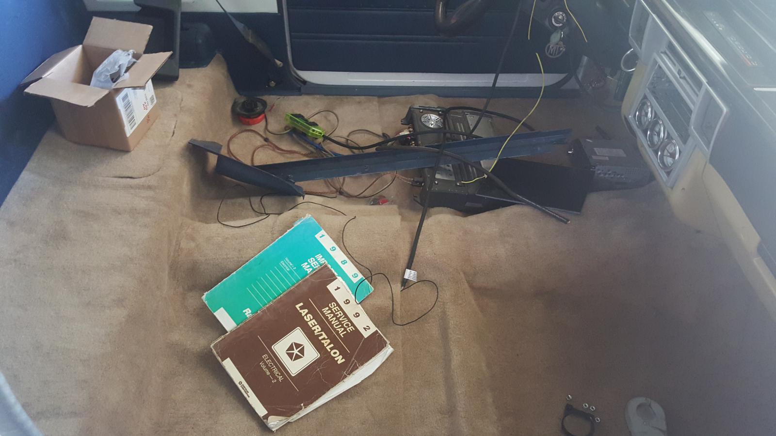

Just got a new carpet kit from ACC for my extended cab. It fit just as well as I remember my single cab carpet from them fitting. It came with plenty of extra so I could trim and fit it as I wanted.
Here's a pic:
Attachment 14520

that does look good. It looks like 2 pieces. I assume the holes for the storage compartments and the seatbelts are not pre-cut.
It is 2 piece, and it fits very well. As with all ACC carpets there are no holes or anything cut out, they let you do that so you can customize/fit it like you want. And I am assuming ACC has molds for both manual tranny and automatic floorplans(and yes they can be MUCH bigger depending on which model year auto tranny, 90+ are HUGE even compared to 89 2.6 auto) as they tell you to specify the version of cab(std or ext) and also which transmission you have. And they come with A LOT of extra material(which I like), so you can trim and tailor it to your needs. I've been very happy every time I've bought from ACC.
