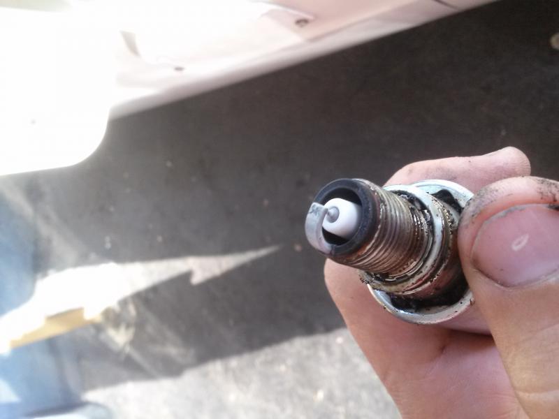

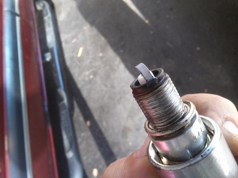

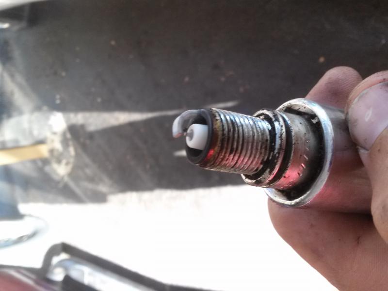

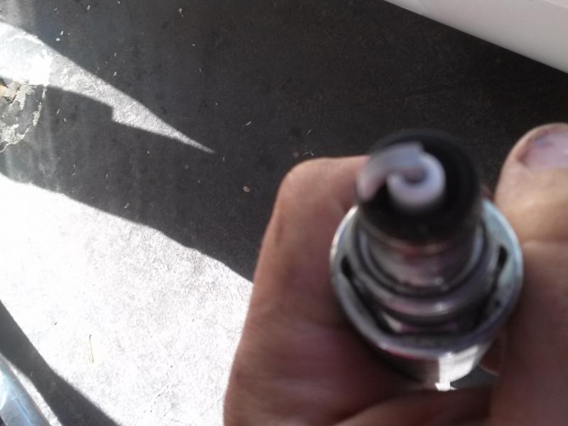

Here is the delayed pics of the plugs: All look same to me and look ok.Attachment 11384Attachment 11385Attachment 11386Attachment 11387Attachment 11388
On a side note, after driving for awhile I smell raw gas. don't see any leaks and truck still runs good and mpg still 20+. What do you think???
tiny fuel leaks may not drip..definitely crawl under & check for dampness around tank (usually leaks near rear bolt-up), feed lines along inner side of frame, etc...
