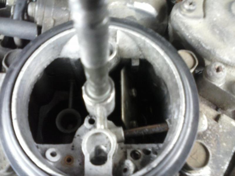

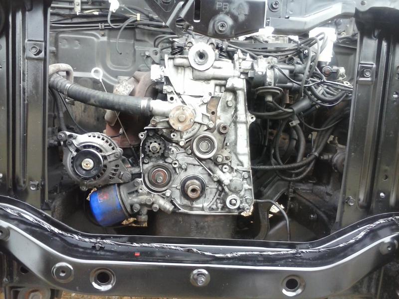

PB Blast a couple or three times, a half hour apart, give it the best chance to penetrate. Could be you'll get that stubborn one off without any more concerns, particularly if the others are tight before you try to loosen it.

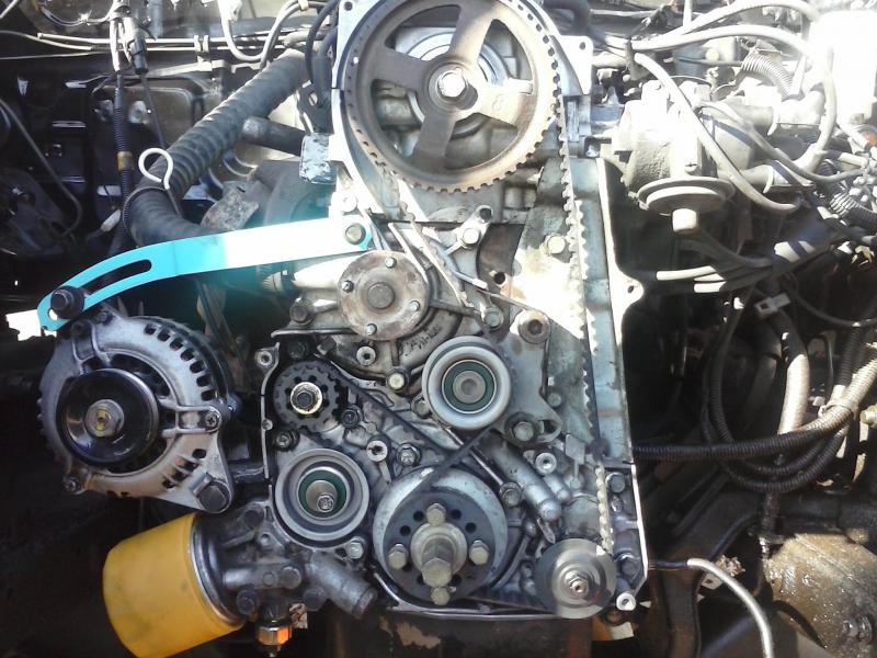

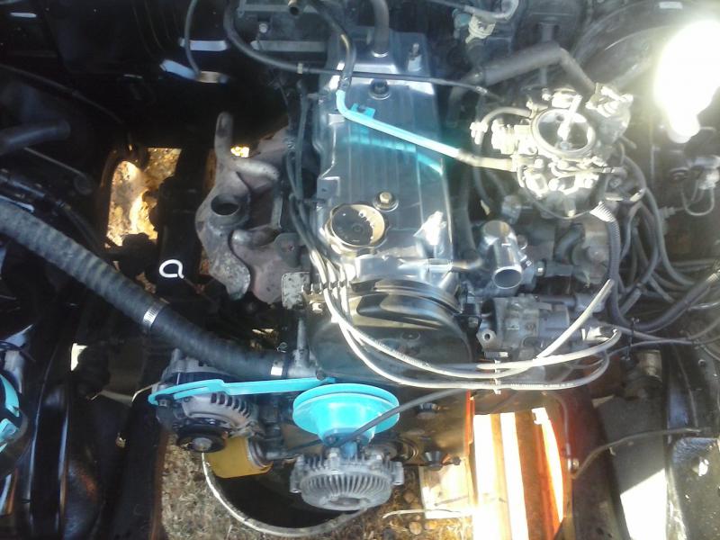

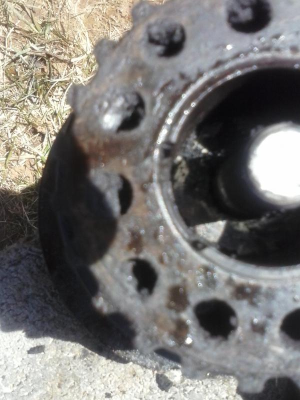

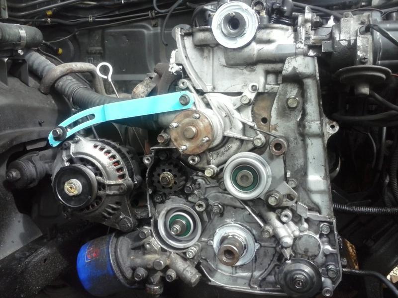

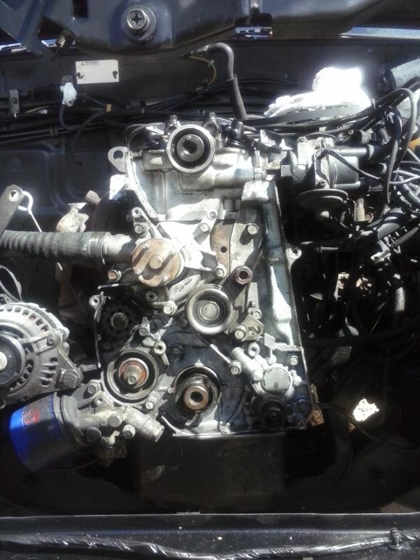

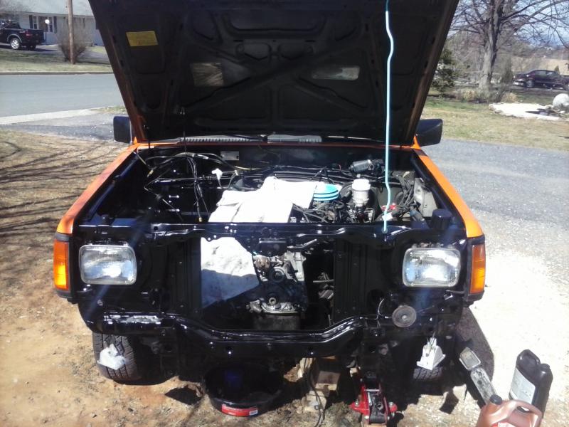

I'll hope a member or two will chime in with a verification for suspicion: since your crank gear pully is wobbling, I suspect the key is worn and has allowed progressive wiggling and loosening. Hopefully the crank itself is not getting stripped out by that process.

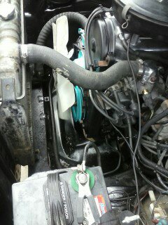

My other suspicion is that whoever installed the timing belt didn't replace the secondary belt...in my infancy of these trucks, I would have talked myself into doing the same (skipping the belt replacement). So tell us if that B belt is in fact old or as new as the timing belt. It takes a lot to tear up one of those belts. The good news is: other than affecting your timing, the B belt breaking likely didn't hurt anything, though I have to suspect the engine had extra vibration.

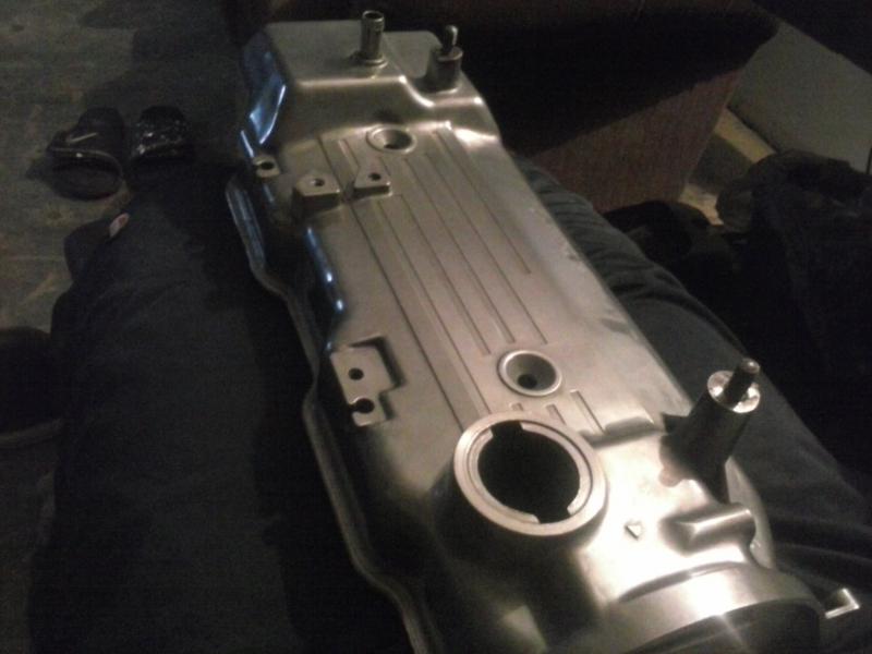

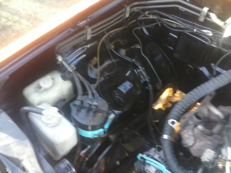

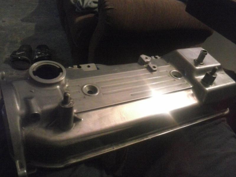

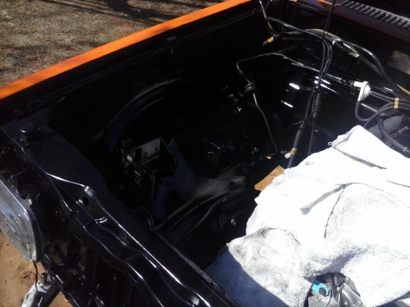

From the photos, it seems like normal oil leakage for the mileage, likely from the valve cover, but you'll know better once you get everything stripped down and clean.
As you reported a worn groove in the timing cover from the water pump pulley, I'd say there was a LOT of un-alligned wobbly crap going on. Take heart and know I have stuff to replace that as you need. This is an unconditional kindness, and I have every confidence you'll pass along just as much kindness through your life. I'm okay with it all.
