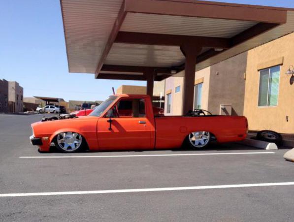

Pic update
Attachment 9843
Never seen a stance like that.
Looking good. I think it looks great laying hard. Do you still wanna undo the body drop?
I noticed your profile shows that you own an 87 truck, but this is a 1st gen in the photo. That must be weird to get out of and the ground is so close. You have any problems using the drive up ATM or bank teller window? :lmao:
Thanks bradmph for turning photo. Lol
