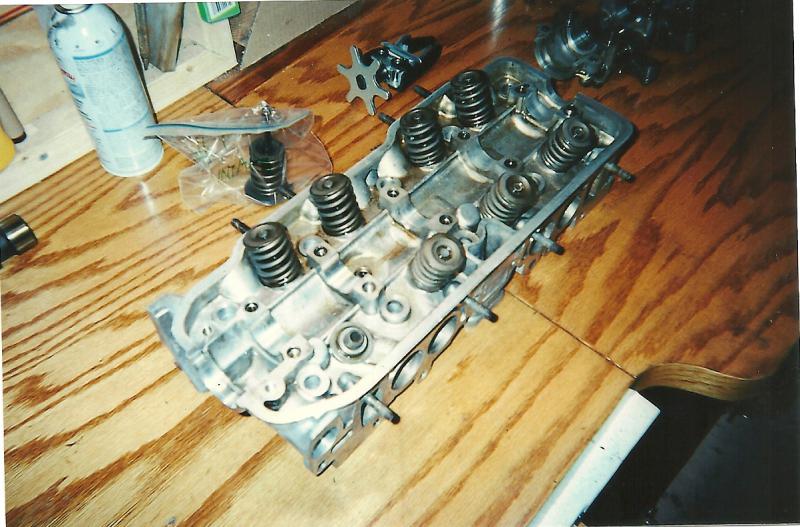

What I found is you need to cork-screw the tool onto the spirng and turn until it's tight. Then turn the "spiggot" handle until the spring is compressed as much as the tool will allow. I found that by pressing down further, the keepers were easily accessed by needle-nosed pliers. (I placed the cylinder head on the work bench with a spray can cap under the valve. Thank God I didn't have to do this while the head was still on the engine). The illustration below shows the tool I bought, as did millions of cheap bastards across the globe. They DO work, but you need to work with them: they don't do the job FOR you, as the illustration deceptively suggests.
Attachment 7647
BECAUSE this tool is such a pain, I suggest doing one valve at a time for the complete job of valve seal replacement: this allows you to leave the spring compressed instead of having to compress it later...plus, you won't scatter and mix up parts.

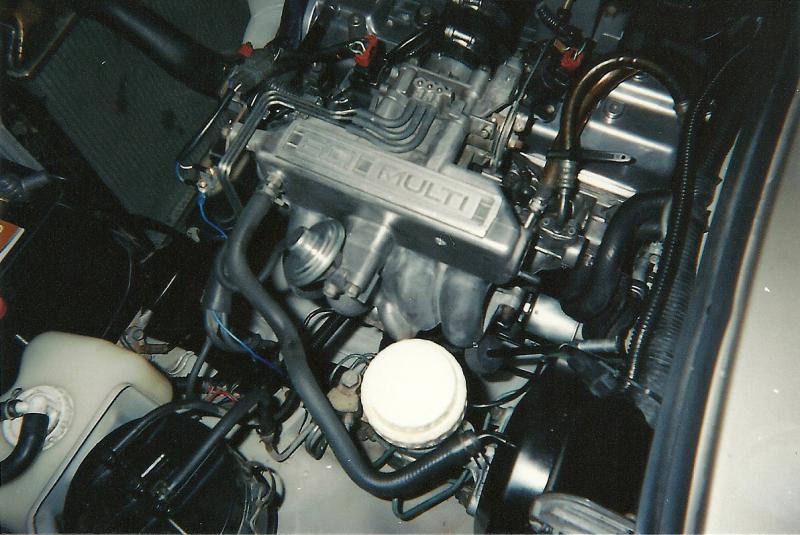

While the valve was free, I did a number of tests on it to assure it's bent. I removed carbon deposits and put the valve back in it's guide, rotated it and observed any variations and resistances. The variations are very subtle, but there.
A bent valve is going to play havoc with the vacuum system just as a burned valve would. The "leak test" was enough to convince me to replace the valve: that leak test was on a work bench: in service, the pressure of compression is a helluva lot more than Liquid Wrench seeping through. The "hole" (opportunistic crack) reminds me of my first wife: it both sucks and blows, very rapidly.
By the way, I DID leave the fuel injecter rail on the manifold when I removed the intake manifold. I disconnected the electrical input at the harness on the firewall, carefully rolled it up and secured it to the unit. After a careful cleaning, I set the manifold in a safe place so as not to accidentally knock it over or have visitors use it as a bong. The clips to remove the connectors at the fuel injectors are a "square horse shoe" that is difficult to get to. I'm sure there's a tool for them, too...sigh.
