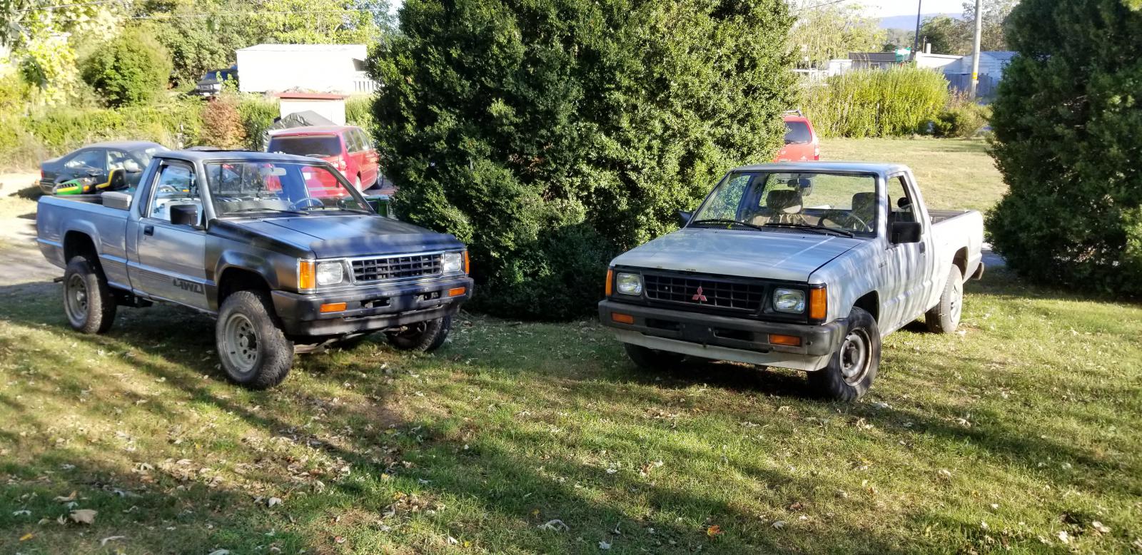

I'll share some pictures later, but Ol' Blue just got a sibling. 91 Mitsu MM 2.4L. Body is in better shape, frame has more rust. Been working on the sale for 2 months, seller had some title challenges to resolve before he could sell.
Don't run the fan continuously - it'll cause grief. The engine will never get up to operating temps and the battery will take a beating. I wanted an electric fan on my truck and seeming I'd run into problems trying to get a decent replacement unit, I opted to modify a van radiator (copper core, brass tanks) and had a single wire sender bung soldered into the bottom tank. One headache with trying to do this with an alloy core radiator is there isn't an easy (well, easier...) way of installing a sender at the optimal location. Congrats on adding to your collection! They are an addiction :grin:
Here they are, such a happy pair.

The truck on the left looks meaner ;) Newb thanks for sharing the electric fan info...

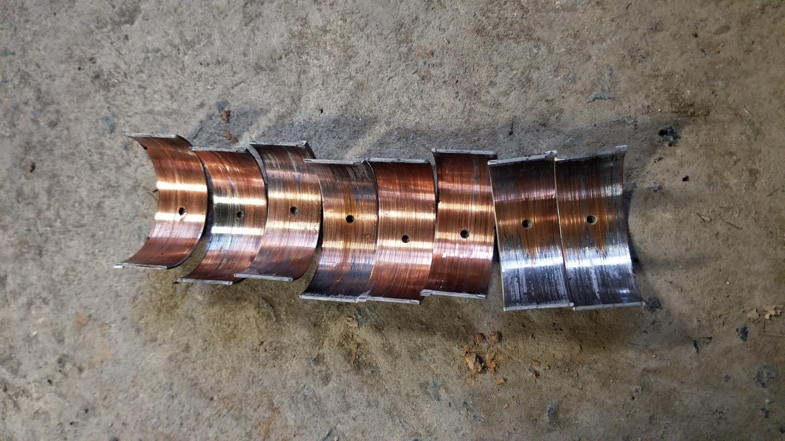

Now that we had a nice day here in PA, I took Ol Blue for a joy ride. The engine sounded good until she warmed up. Then I could hear a knocking going up hills, drove it home and could hear the same knocking at idle. Climbed under the truck and seems it was coming from the bottom end. So pulled the truck in the garage and dropped the oil pan. Seems the connecting at least 2 had some free play. Checked the torque on the ARP bolts still snug at 40 ft lbs of torque. Decided to check the bearings, see pictures below. Seems excessive for the small amount of mileage since I redid the bottom end several years ago. Posting for others thoughts.

Don't know what to make of that. No real discolouration. I'm leaning towards oil pressure - did you do the balance shaft bearings and what is the oil pump like? Those bearings should've lasted a lot longer than a few years. OOC what oil and filter did you last use (or have been using)?
Looks like the bearings were to tight. when you did the rebuild did you have the rods resized? A good machine shop will torque the caps with the new bolts then resize them. Also you should have used plastigauge when you put the bearings in and checked the clearance between the bearing and crank.
^I thought the same but the bearings didn't look like they had suffered from deformation from being squeezed in there. That and the noisy timing chain seemed to be connected by the oil pressure issue :shrug:
