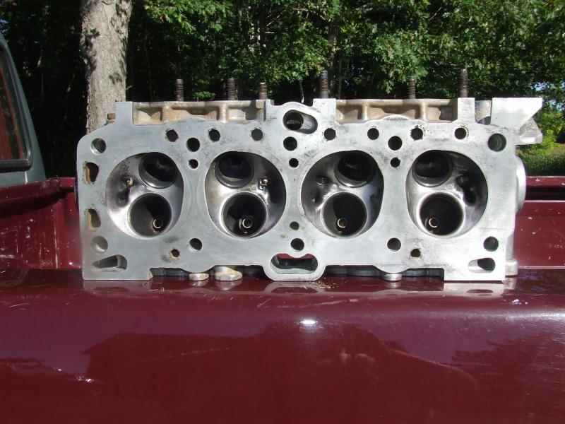

Head off, warped a bit, gasket looks pretty good. More than a skim of oil sitting on top of piston next to #1.
Green anti freeze in places, back piston has the most on it.

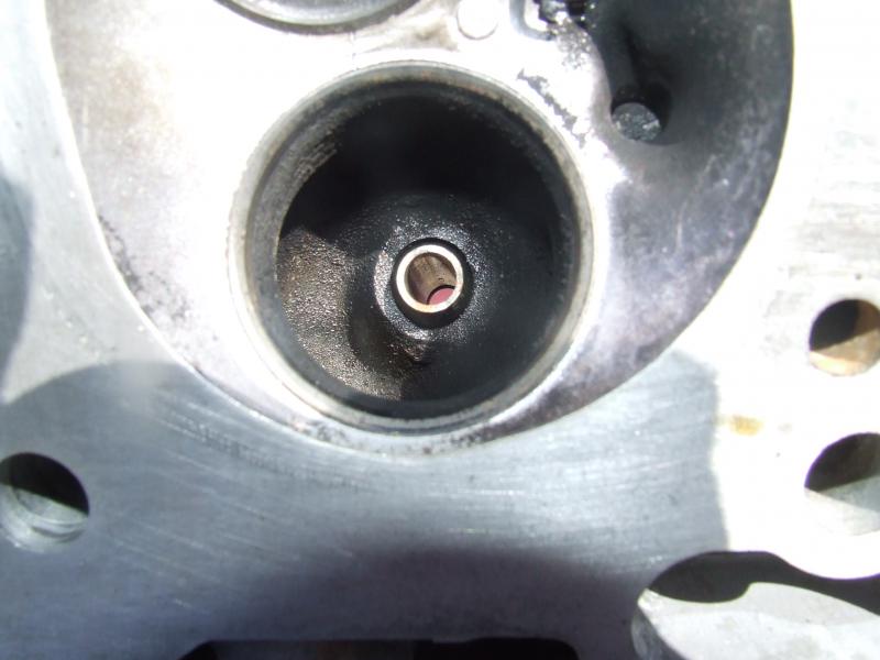

Bought a head gasket set, now I am considering not, possibly returning. That amount of oil sitting in the #3 cylinder well has me worried. Not sure about the valve seals, shape of valves and other unknowns. Not sure if the heads worth taking apart.
By-gone days a fella would just re-shoe the horse to get under way.
the antifreeze on the piston after pulling off the head is normal. But just replacing the valve seals will fix the oil problem. You can have the head checked out at a machine shop for a couple of bucks. Might be worth it.
Yippur, expected to see a ''hot mess, honey boo-boo" antifreeze mess, the oil? ... not so much.
But as you say camoit, the seals might just be worth it, so onwards and upwards.

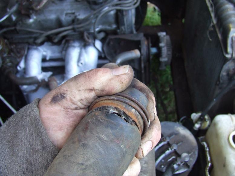

Attachment 6584 Here is the lower hose that split during a three hour summer hot drive which now has me stuck 300 kilos from my home. After waiting for back ordered parts, money then more parts... do dads, getting on 5 weeks.

Now with the latest. The head is in such poor shape, so says the engine rebuild boys, that it needs a VALVE JOB, hmmmm, let's see, BJ vs. VJ? VJ vs. BJ? Well I know what'd I would prefer... S.O.B.!
Another 250 bucks with tax... so far, unless they phone with more cheery news.

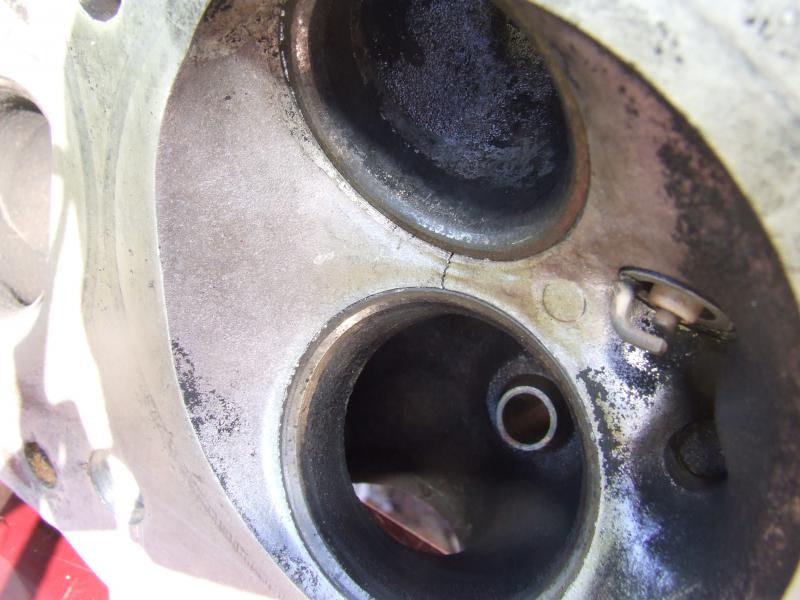

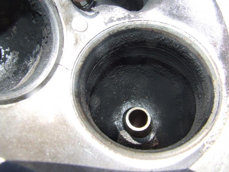

UPDATE! UPDATE! THEY JUST PHONED ME AS I TYPED THIS... THE EFF'N HEAD IS CRACKED, FRIDAY THE 13TH, oh sweet muther' of god. I am sunk.

Gave Doug the nonrefundable head gasket set, the parts he needed. He phoned me three days later, on Friday the 13th actually, with a sad voice said, '' the heads ruined'', found a crack and it went internally, no way to use it.
