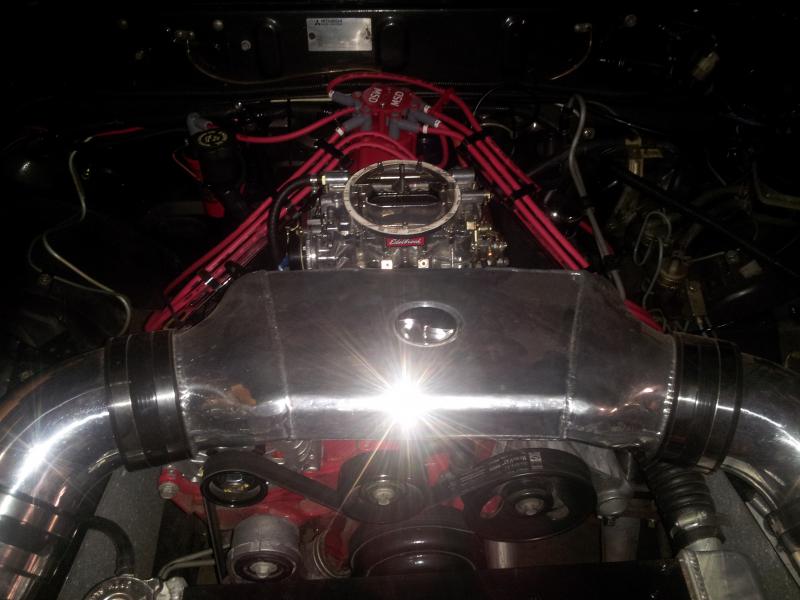

More things that i've done

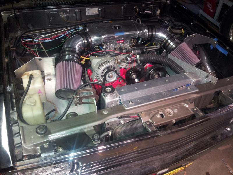

It's the small edelbrock, I think it's a 550 or 600 (The plenum is definitely over kill).

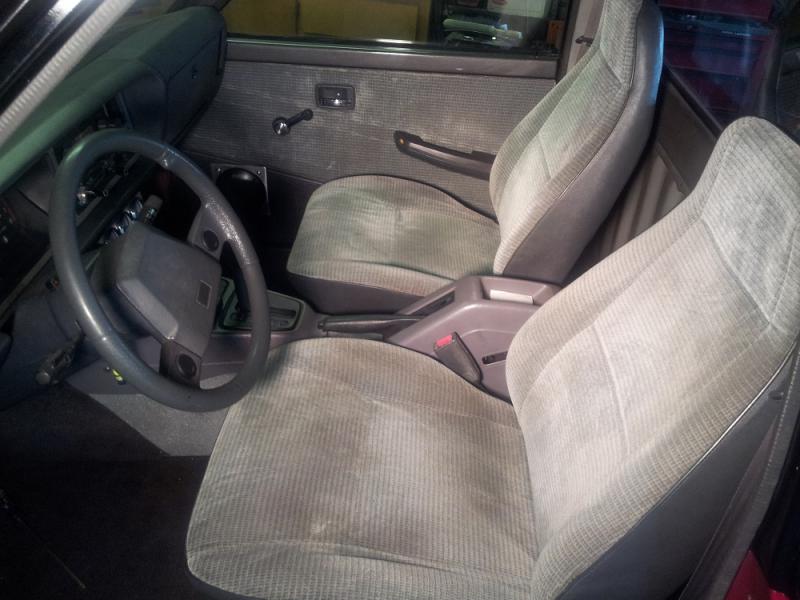

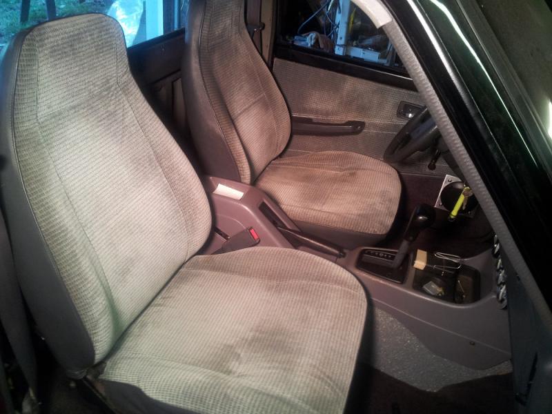

My friend is the original owner and loves his beer, I spent at least 10 hours shampooing the seats and door panels. I guess spilt beer is a preservative, not bad at all for 27 years old. I also removed the mirror from the wood slat I had stuffed where the head liner should be.

I have a set of Ricaro seats I’m thinking about using they set lower about 2” and the rail are the same length and 2 holes need to be relocated and with the same leg room. Thinking black and red.

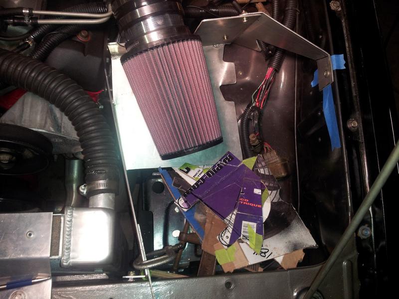

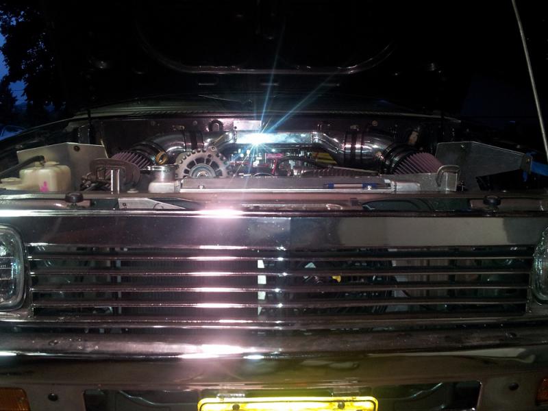

I'm Trying to get to the cool air and stay out of the hot, I’ve heard K&N filters don’t take the heat very well.
Just kicking ideas around while waiting for parts.

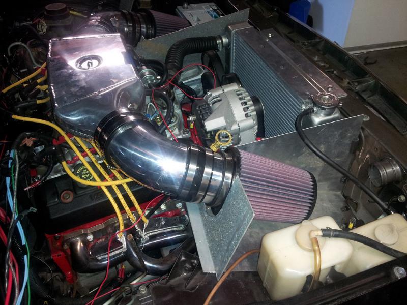

3 Attachment(s)
Still tinkering on air boxes, kind of.

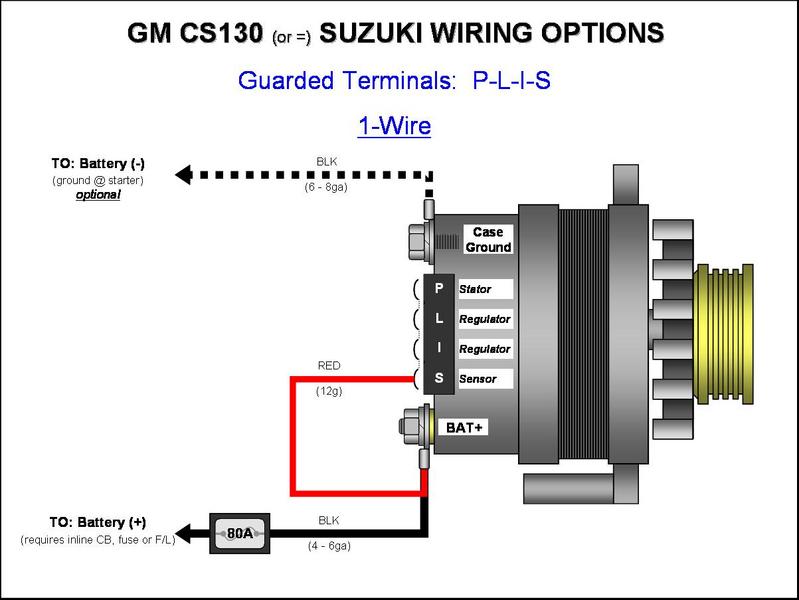

Still tinkering, the other night I watched the battery drain for hours with zero fuses in the panel and the breaker off. I unplugged the small wire on the alternator. At 11 pm 12.85volts, an hour later 12.76v, then at 6am 12.69v,
9am 12.67 and 4:30 pm 12.67. Notice from 9am to 4:30 pm ZERO voltage drop. Good news but, why?

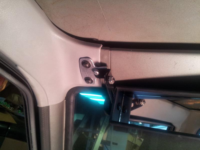

I'm liking it so far, but I'm still tinkering. Always use cardboard to build stuff FIRST if you can, it's easier to tape something you cut off then it is to weld something back together.

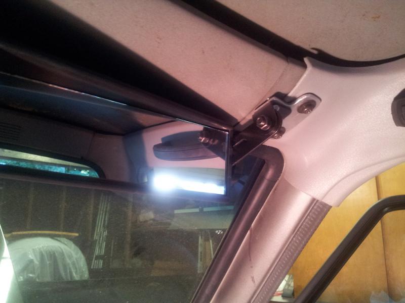

My wink never shuttered on the 1/4 x 1-1/2" wood slat slid between the gap where the headliner goes. I injured my neck and shoulder 9 years ago. I like my winky, no blind spots and I don't really want to turn my head.

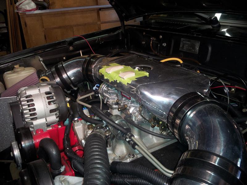

2 Attachment(s)
know what you're looking at?

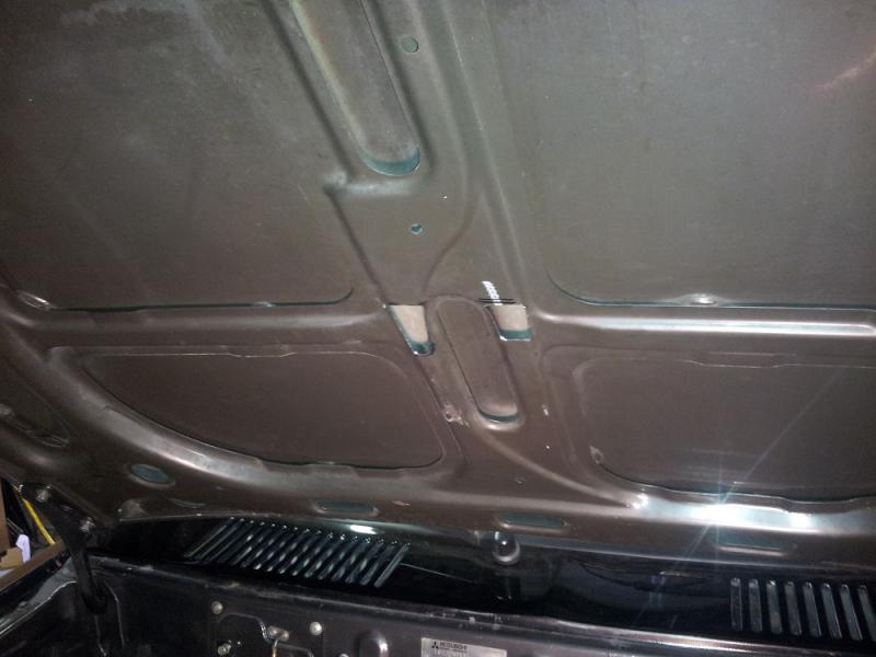

I did some more trimming under the hood to get clearance, the plenum is thin material.
As I said I'm using plumber putty to see where to it needs to ground.
