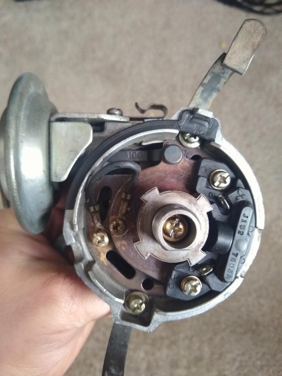

Working on getting the truck running right, it's not firing on cylinders 1 and 2. Decide to pull the distributor out and clean it, find all sorts of crap inside it. Get it back together, go to put the new cap on and the black plastic spacer/ring/gasket falls apart.
Turns out half of it was missing, causing the cap to tilt slightly and keeping the rotor from contacting number 1 and 2.
Tried spinning the distributor without any spacer, the rotor hits the posts inside. Now I need to figure out where the hell to find that spacer.

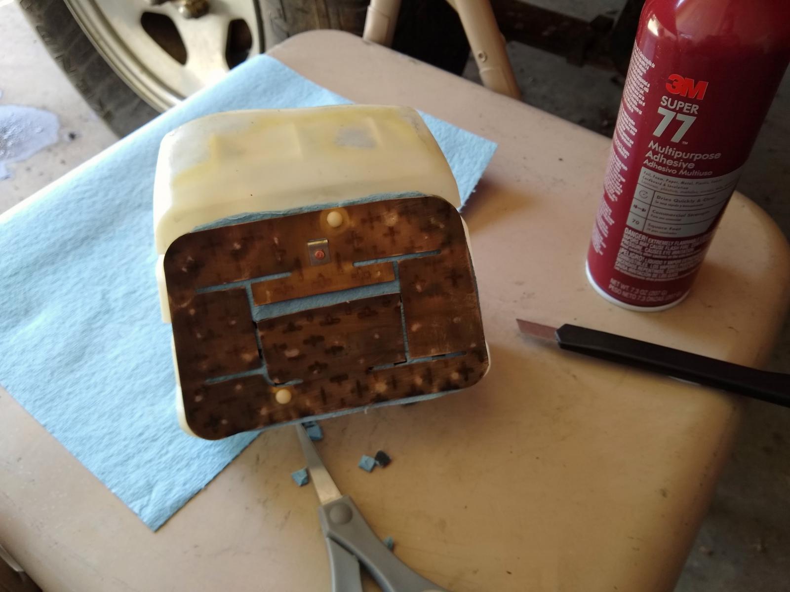

Horn button was full of corrosion and the foam isolator pad thing was gone, so I made a new one. lol
Attachment 22414
After fixing the button and cleaning off the contact points for it, I sounded the horn and was very disappointed. So I gave the truck some more bark to match it's bite.

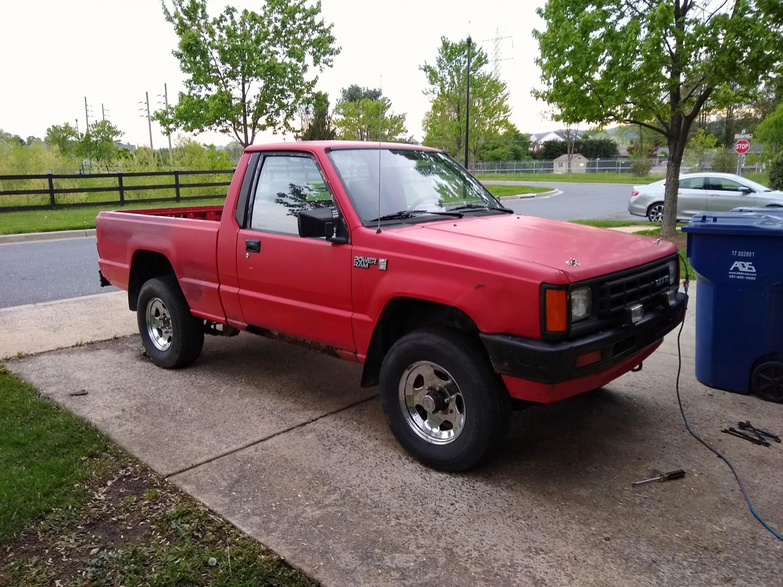

Speaking of work, put in some more today...

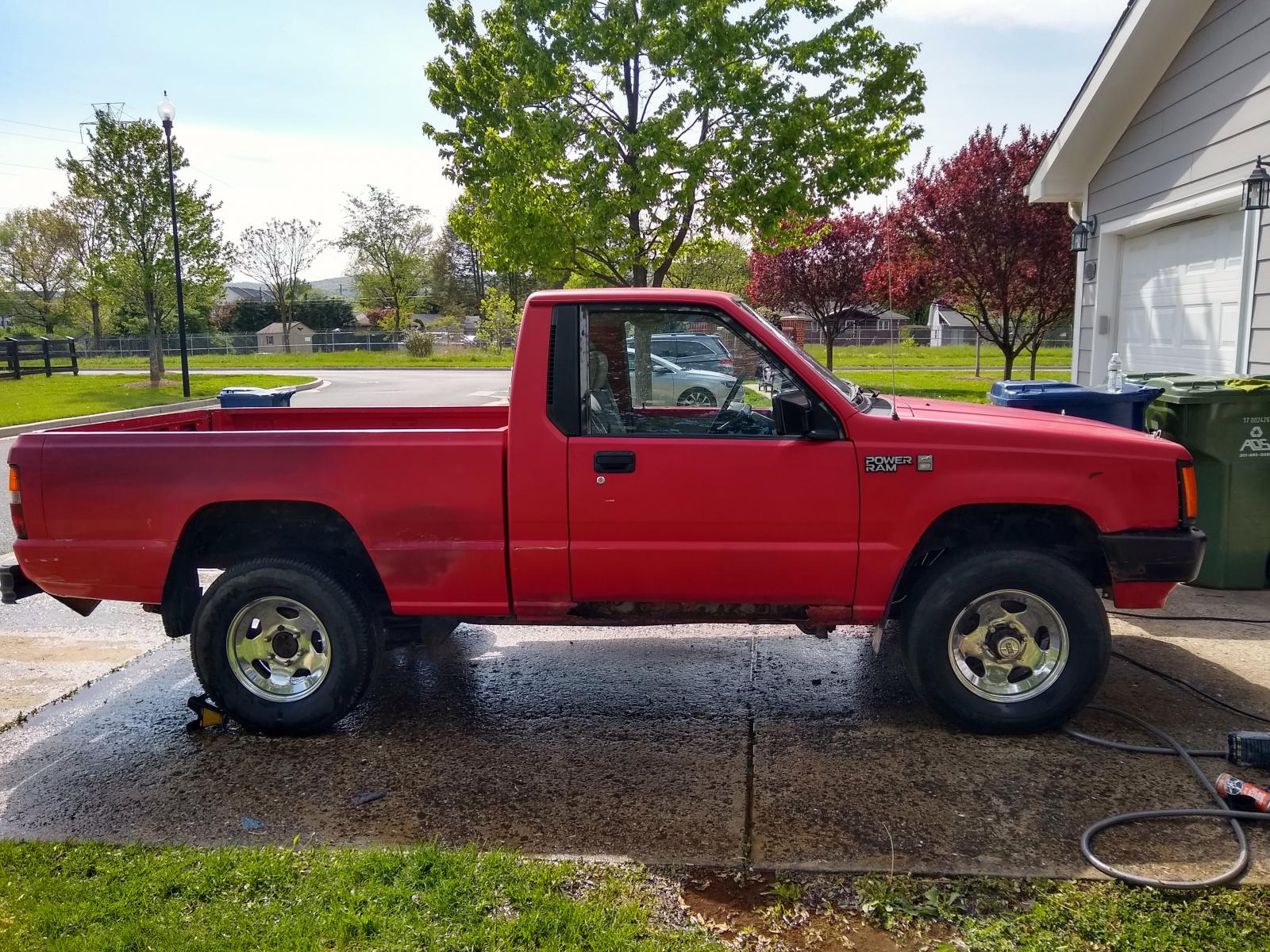

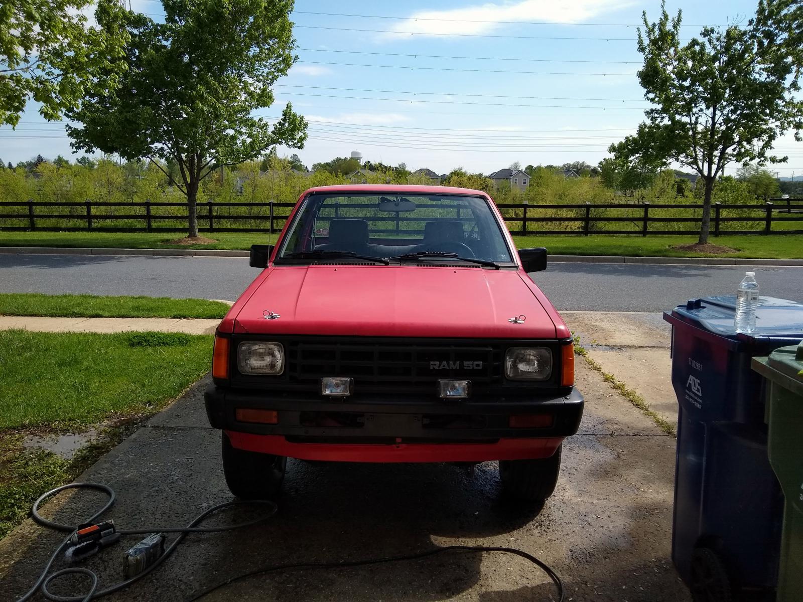

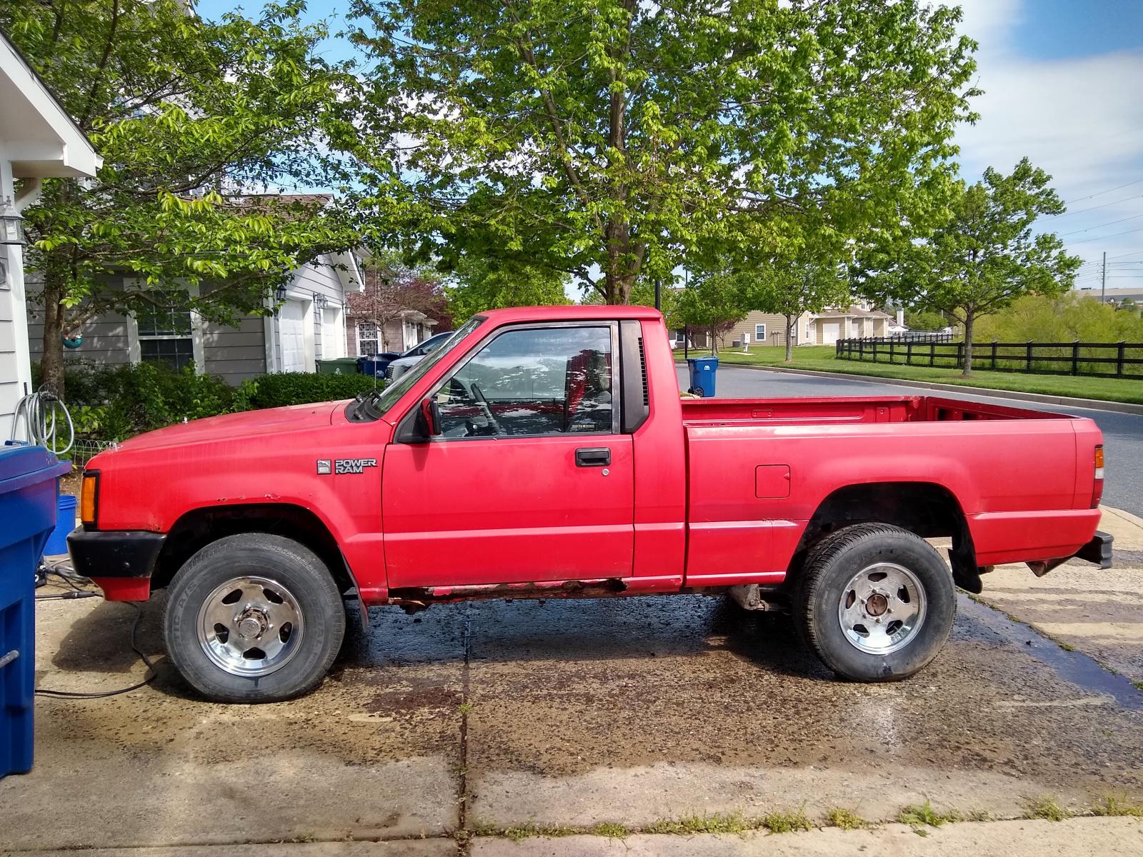

Rolled the truck out into the driveway, hooked up the little electric pressure washer and went at it. As expected, it was woefully underpowered, but it did remove the dirt from the wheel wells and started peeling up some of the paint from the last paint job...
I ended up scrubbing the hood and roof to get them clean, and I had to use some very fine steel wool to get the chrome wheels cleaned up... I'll have to take them off and legitimately polish them at some point, but right now they're the nicest thing on the truck.
Attachment 22424
Attachment 22425
Attachment 22426
Attachment 22427
And I did paint the front skid plate... It doesn't match at all, but it's that extra little touch. lol

Looking good. This thing has come a long way in a short time! Nice work.
Keep it up. Like those wheels. Now you need to get the chrome marker lights front and back to match.
I do like the chrome marker lights, but I would want to get the chrome grille to match as well. That would make me want to make the rest of the truck look good to match, and there's too much rust and body filler in the body of this truck for it to be worth the work.
I would collect all of the chrome trim for a rust free truck that I plan on finding later, but not for this one... and I'll most likely put these wheels on that truck if it doesn't already have them.
Other than the wheels (optional), and the bumper on the Custom trim, there was no chrome on the '87 Ram 50.
I say keep the black trim :thumbup:
Actually, the Custom did have chrome marker lights and grille in '87...

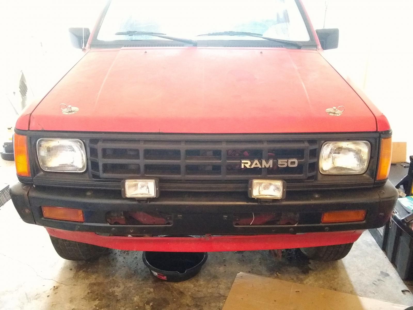

I'm gonna keep it the way it is now, and worry about dressing up the next truck.

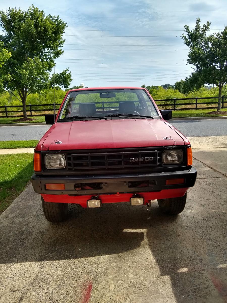

In the meantime though, I've gotten the bulbs for the off road lights swapped out for 100w bulbs, wired them up to a relay with a switch... They're so much brighter than the stock headlight bulbs it's comical, but they're aimed at the same height as the high beams so they should do pretty well with lighting up what the headlights can't.
I have 2 100 watt kc spot lots on the front of my crown victoria. Amazing how many eyes you see looking at you driving down the back roads at night with them on!

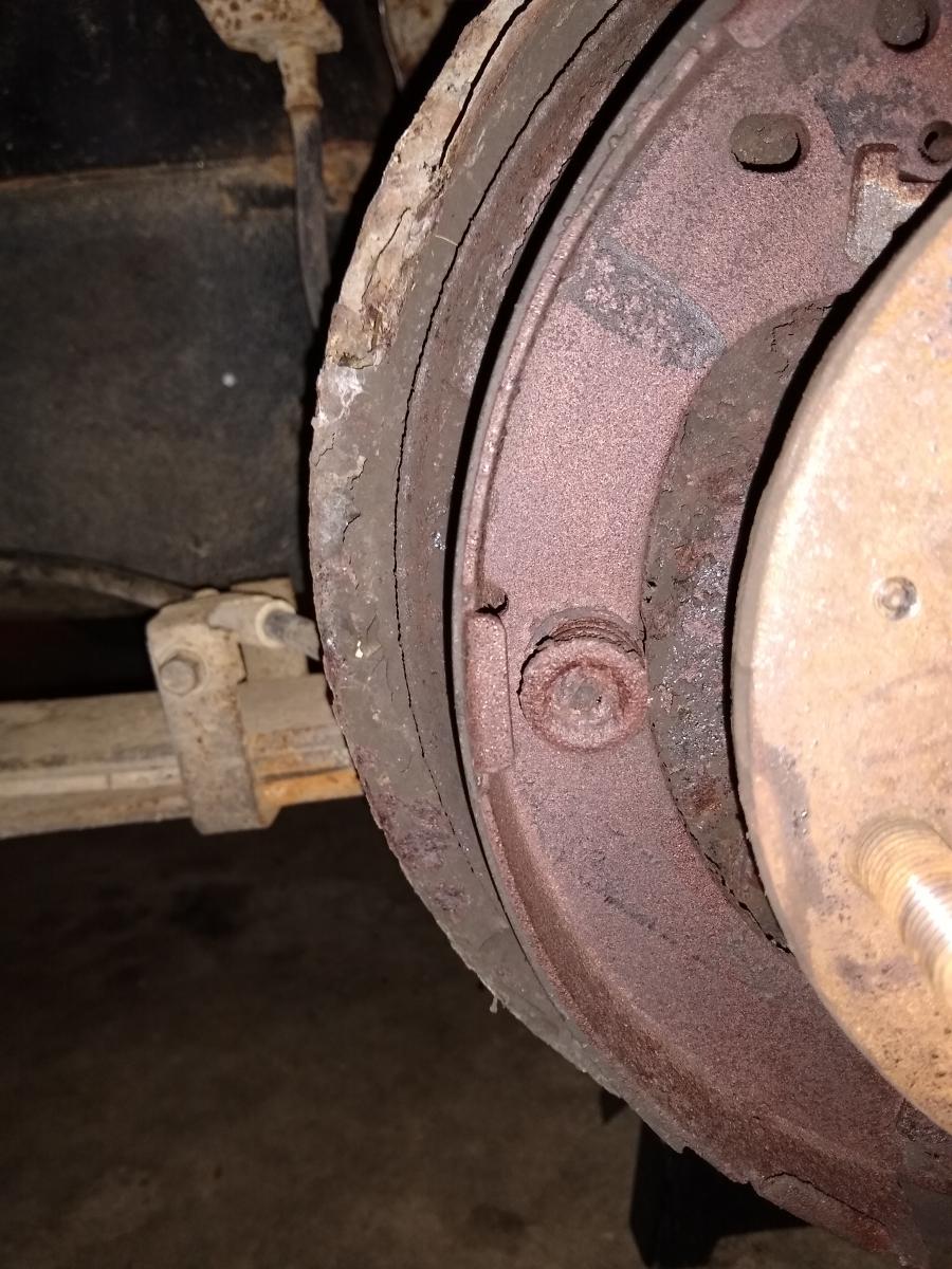

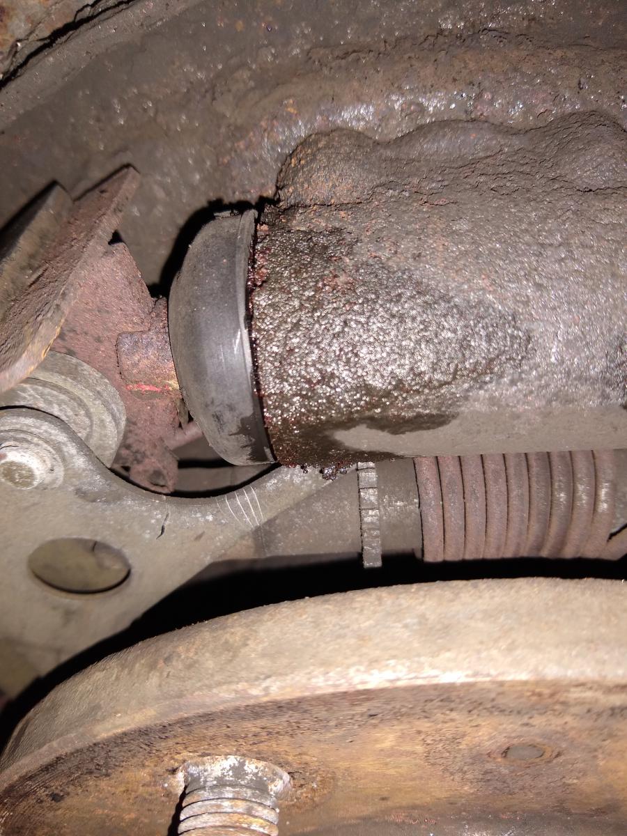

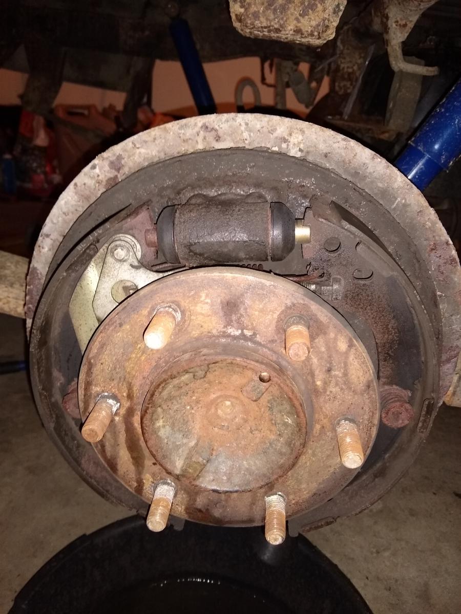

They were not functional, so I decided to open up Schrodinger's drum brakes...
After a liberal spray-down of brake clean, the story told is sickening.
Driver's side
Attachment 22536
Driver's side front shoe
Attachment 22537
Driver's side wheel cylinder
Attachment 22538
Passenger side
Attachment 22539
Passenger side front shoe
Attachment 22540
Passenger side wheel cylinder
Attachment 22541
Note the adjuster lever, and it's position...
I'm reasonably convinced that these are the original factory brakes, simply due to the amount of rust and apparent age of everything. I had to use the threaded holes in the drums to get them off the axles, but from the look of everything It doesn't appear to have bad axle seals, and the wheel cylinders only leak when you pull back the rubber. I would love to find some intact backing plates for cheap, but I might have to go pull them myself from a junkyard/parts truck.
After this weekend (I work the next two days) I'm considering pulling the front calipers off and seeing if there are any major problems up front... I know the front brake hoses will need to be replaced, but they don't leak right now and I'd like to keep it that way. The rust on the rotors did start to wear off, so the pads are making contact with some measure of force.
The front brakes will (eventually) stop the truck, but it's a 3-4 pumper and laying into the pedal to do so. That might be because all of the pressure is going to the drums since they are practically non-existent.

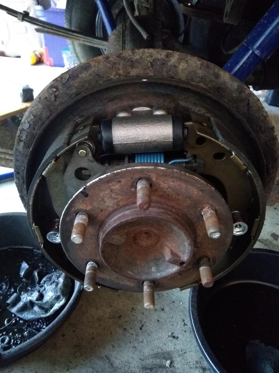

After looking and pricing stuff out, I'm just gonna replace the shoes, wheel cylinders, and hardware. There's no need to go all out when I'm planning on swapping out axles eventually anyways...
The drums are just barely oversized, and the adjuster didn't break when I bent it back into shape, so I'm just gonna slap it back together and call it good. I'll buy new ones after they break.
chances are whatever axle you get is going to have crusty adjusters. Unless they are expensive or hard to get, I'd just swap them out while you have it apart. You can always put them on the new axle. If you mean the piece of sheet metal that pushes on the adjuster screw, that will probably bend back ok. But if you mean the adjustment screw itself, it doesn't take a whole lot of binding force to have the sheet metal pawl jump over the tooth and render it useless
It was the pawl that ratchets against the adjuster screw, it had somehow bent back past the teeth in the adjuster screw. I bent it back, cleaned everything and shoved it all back in there.

I rolled the truck back out of the garage on Monday, tried to get it started again and it ran really rough for a few seconds the first couple times. I pulled the coil wire off the cap and cranked it over, spark was kinda thin and yellow. I took each spark plug out, held each one against the block and each cylinder had spark. I tried swinging the distributor between fully advanced and fully retarded, I pulled it out and moved it a tooth at a time both ways, I even moved the firing order again. That's when it started spitting, sputtering, and backfiring without actually running. It progressively got worse until it wouldn't even kick, just crank. That's when I decided to give up for the night and pushed it back into the garage.
That's when I decided to test all of the components with a multi-meter and rule out all the possibilities... The electronic pickup inside the distributor had zero continuity. It's dead.
So now I have to decide whether to mod the distributor or not. I can buy the MSD magnetic pickup and grind/file it to fit, for the possibly distant future when I can get an MSD 6A box and all I would have to do is drop it in and go.

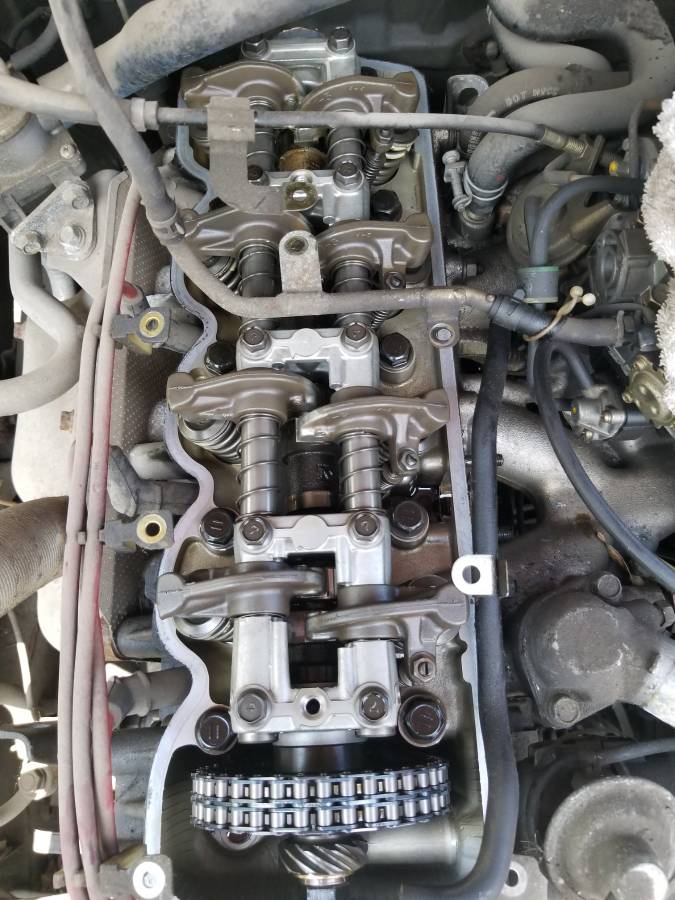

I don't know what this means, but here's a picture of my 2.6 with the cap off (if I'm guessing correctly which cap you're referring to), in case it helps...
Attachment 22643
^Warstryker meant #1 in the distributor cap.
That's a clean engine though, looks much better than the sludgebox I've got. lol

Third time pulling the parking brake lever, I heard two pops and parts fell out. Both rear parking brake cables snapped at the lever, I tried pulling them out when I first got the truck but I couldn't get the nuts to budge and left it until I had new cables... guess I'm getting new cables sooner than I expected. I will be using a chock block until I fix it, I know what happens if you don't have a parking brake. lol

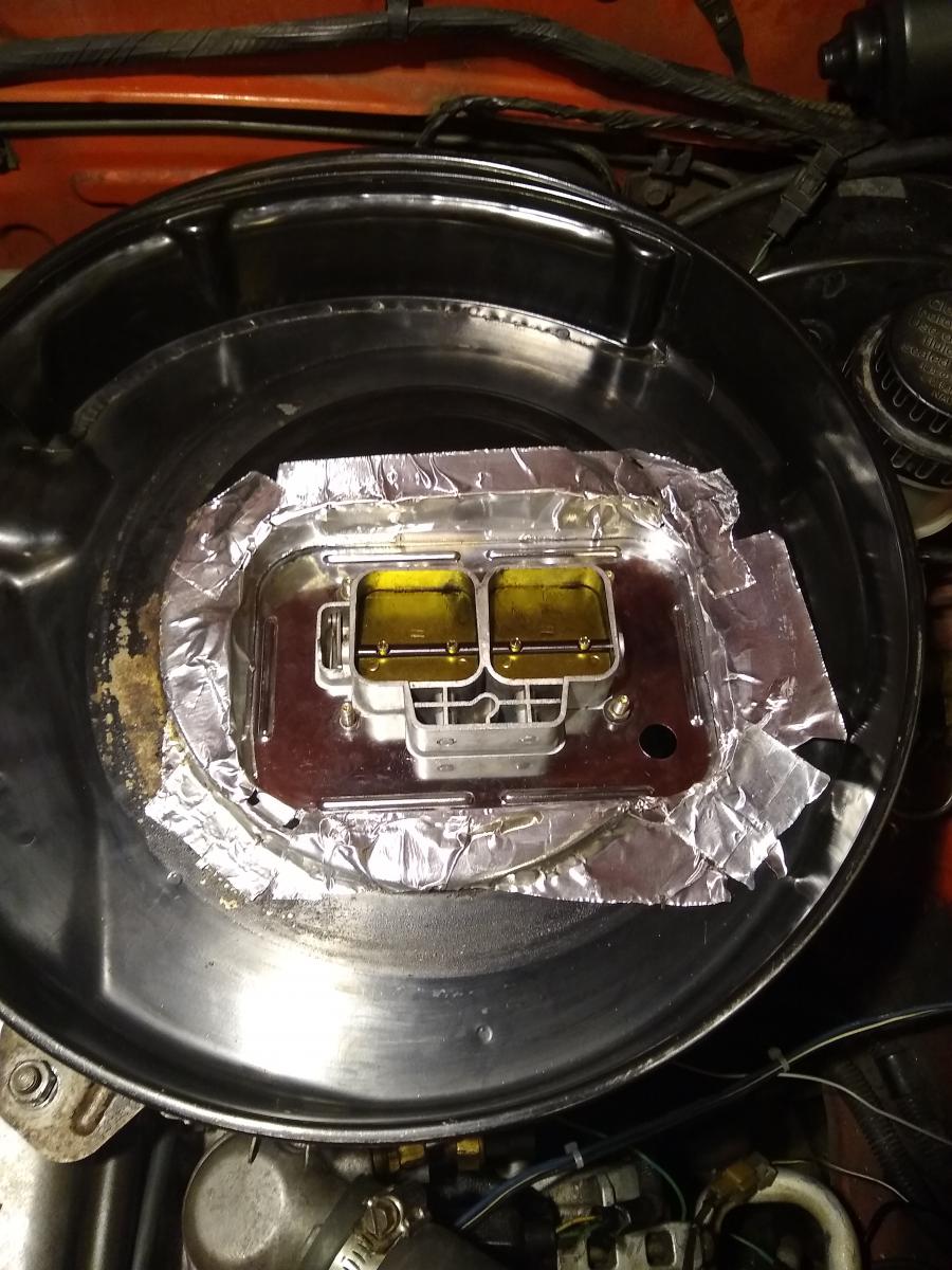

I've been playing around with modifying the stock air cleaner for the Weber carb, and right now my progress is ugly and kinda hacked together... Lol
Attachment 22791
Attachment 22792
I figured it would be easier to use the existing Weber bottom plate as a template, and it's spaced away from the carb like that because I'm using the mounting points on the valve cover, the four studs on the Weber itself, and I'm thinking of making a bracket to hold a center stud for the lid.
Yes, that filter is extremely dirty and well worn, but it works as a placeholder.
And yes, I know that it's not the most efficient airflow design, but it'll work for getting somewhat cooler air to the carb. Maybe. If I actually follow through with it.
If you plug the mounting hole in the top of the air cleaner box you might not even need the centre bolt. It's primary purpose is to clamp the whole air cleaner assembly down to the carb but if the base of it is secured rock solid, you won't need to factor it in. Hmm, the Weber sits higher than the stock carb with the adapter under it - I didn't know that...
This will work better than the open element filter and maybe with some heat shielding in it (or even around the main intake duct as it's hanging over the exhaust manifold), it might aid intake temperatures further :think:
IT LIVES!!!!!!!!
I took it on its first true maiden voyage, and it did much better than expected. The brakes are terrible, the throttle is extremely sensitive, and it's loud as hell...
But it runs like hell and even chirped the tires in second gear. I'm happy with it.

And obligatory pic:
Attachment 22852

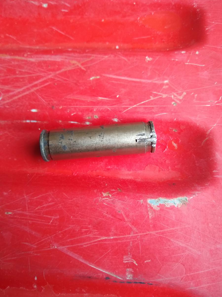

I finally got another look and realized that the slider pins that I'm having issues with are in the caliper body, and the pin that bolts to the bracket is totally fine.
I guess the new question is do I try and get the slider out of the caliper, or is it a lost cause?
I got the caliper slide pins out (with a pair of vise grips and a hammer) and ordered new ones, along with new rubber boots.

Attachment 22902
I'm gonna need new pins... Lol
The caliper itself seems to be fine, just the sliders were stuck. The rotors and pads seem to be totally fine as well, barely any wear on the rotors...
Now it's just a matter of cleaning everything and waiting on parts.
...err, yeah. I can see how that may slightly impact on braking performance. That slider is FUBAR
Well if it hadn't been stuck in the first place, I wouldn't have had to fubar it out....:shrug:
after all the years of neglect before you got the truck, its a wonder you were able to get it out at all...
Chunks of the rubber boot are still stuck to the slider pin... lol
Thankfully the passenger side was less stuck and didn't require vise grips to remove. The pistons do move inside the calipers, so they will work once I get everything back together.

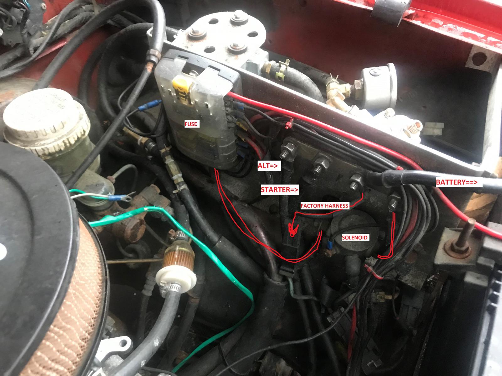

I'm wanting to isolate the ignition wiring from the rest of the electrical wiring, and I'm wondering if there is another keyed +12v source I can use that is easily accessible and will potentially handle the possibility of up to 10 amps...
I'm going to do one power distribution block for battery +12v and the other for keyed ignition +12v. The battery +12v will power the fuel pump relay, the off-road lights relay, the 12v triple socket box I've got mounted under the dash and the tiny 100w sub behind the seat. The keyed +12v distribution block will run the electric choke on the carb, the signal wires for the two relays and possibly some additional accessories and/or relay signals.
The power distribution blocks I'm getting have a fuse for each output, and I will be running a 30a fuse maximum on the battery +12v block, and the keyed +12v will only have signal wires connected, nothing that will actually put any real amperage draw on the keyed +12v source.
I've got a buddy that has a seal installation kit, big ass torque wrenches, and a couple other tools that I'm likely to borrow. This upcoming weekend I've got 3 days off and I'm going to do my damnedest to have the truck back on the road by Monday.
What I did on my truck, was get a marine grade tinned copper junction block. There are 4 lugs on it. One to battery, one to alternator, one to the factory harness, and one that feeds into a 12v 100amp (or maybe 200) continuous duty solenoid. That solenoid is triggered by my original coil wire. The solenoid feeds a marine grade fuse panel. The fuse panel feeds my electric fuel pump, fog lights, ignition system, carb choke, auxiliary gauges, and power feed for my trailer lights.
It's a little bit hokey, but it keeps the load of all the new accessories off of the factory wiring. All of the wires between the junction block, battery, alternator, solenoid, and fuse block are 2 gauge. Almost no voltage drop. It's been going for about 60k miles/2 years with no trouble. I'll try and snap a picture today.
That random green wire is hooked up to the starter solenoid. My neutral safety ate shit this week, just been popping the hood and hitting something hot with it to start it. Once i fix the car I'll remedy the truck. Broken shifter cableAttachment 22946
