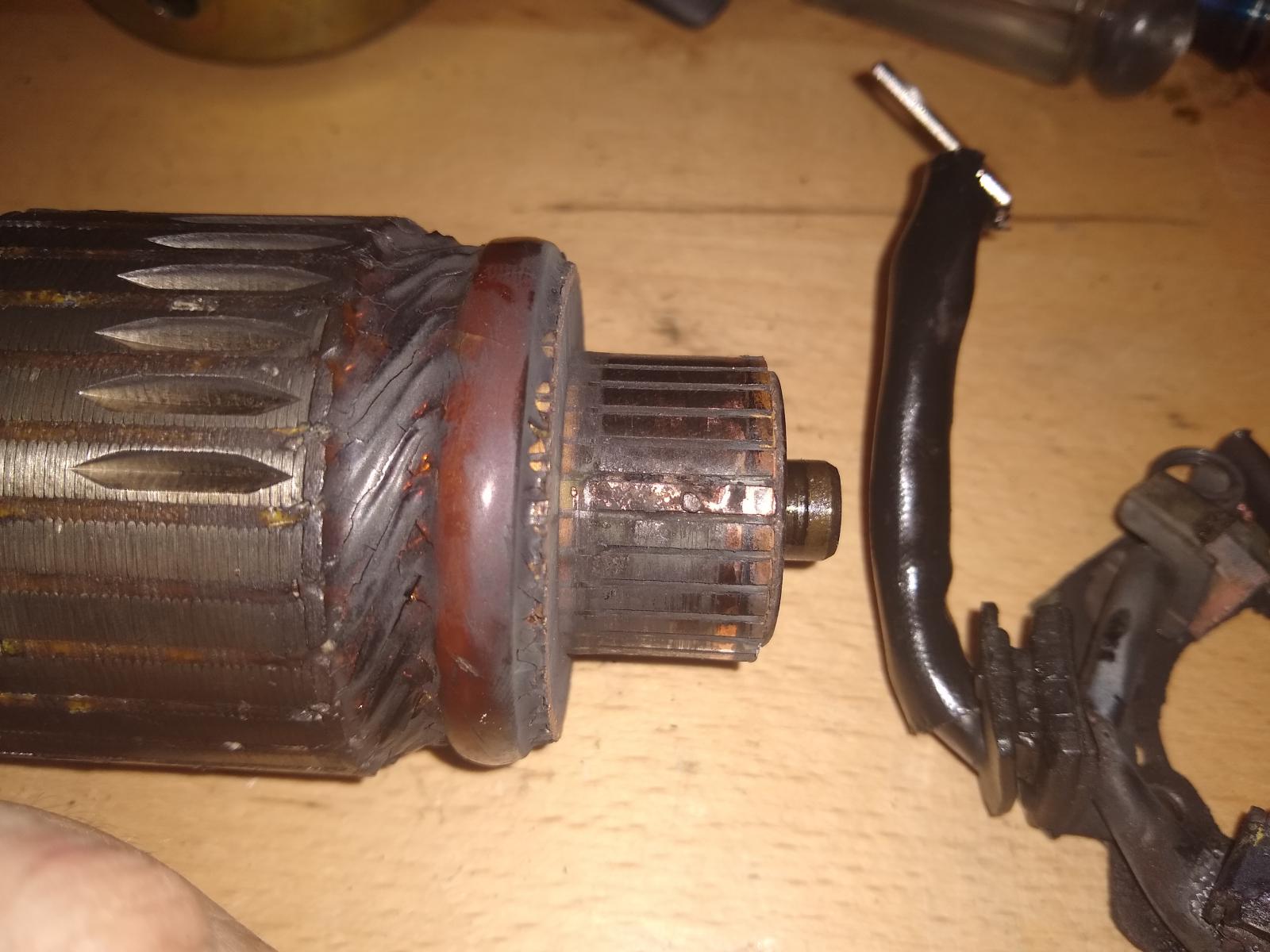

I charged the battery outside of the truck, hooked it back up and tried to start it. The starter isn't doing jack, not even when jumping the solenoid with a pair of (insulated) pliers. I'm going to have to pull the starter back apart and see what went wrong.

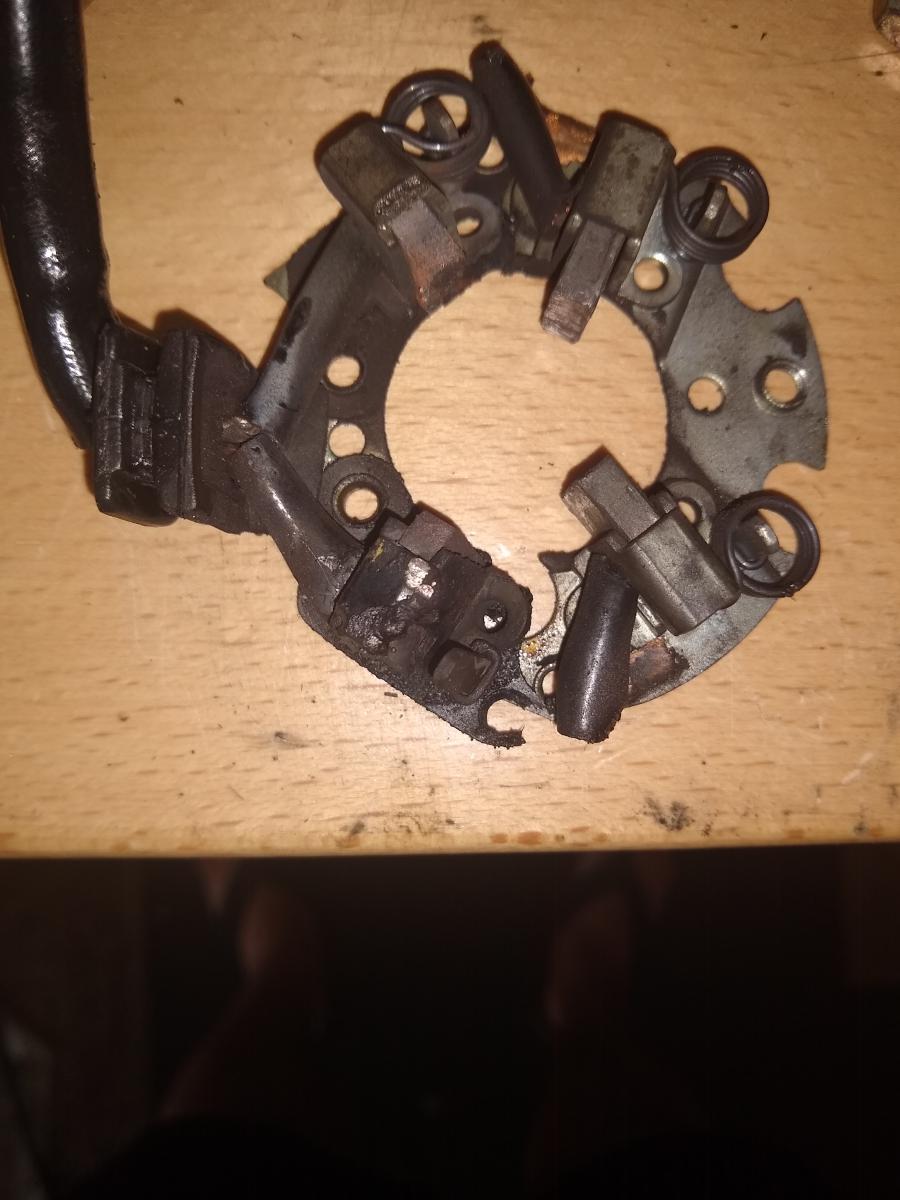

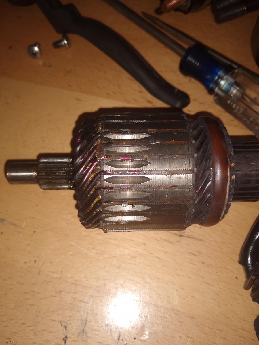

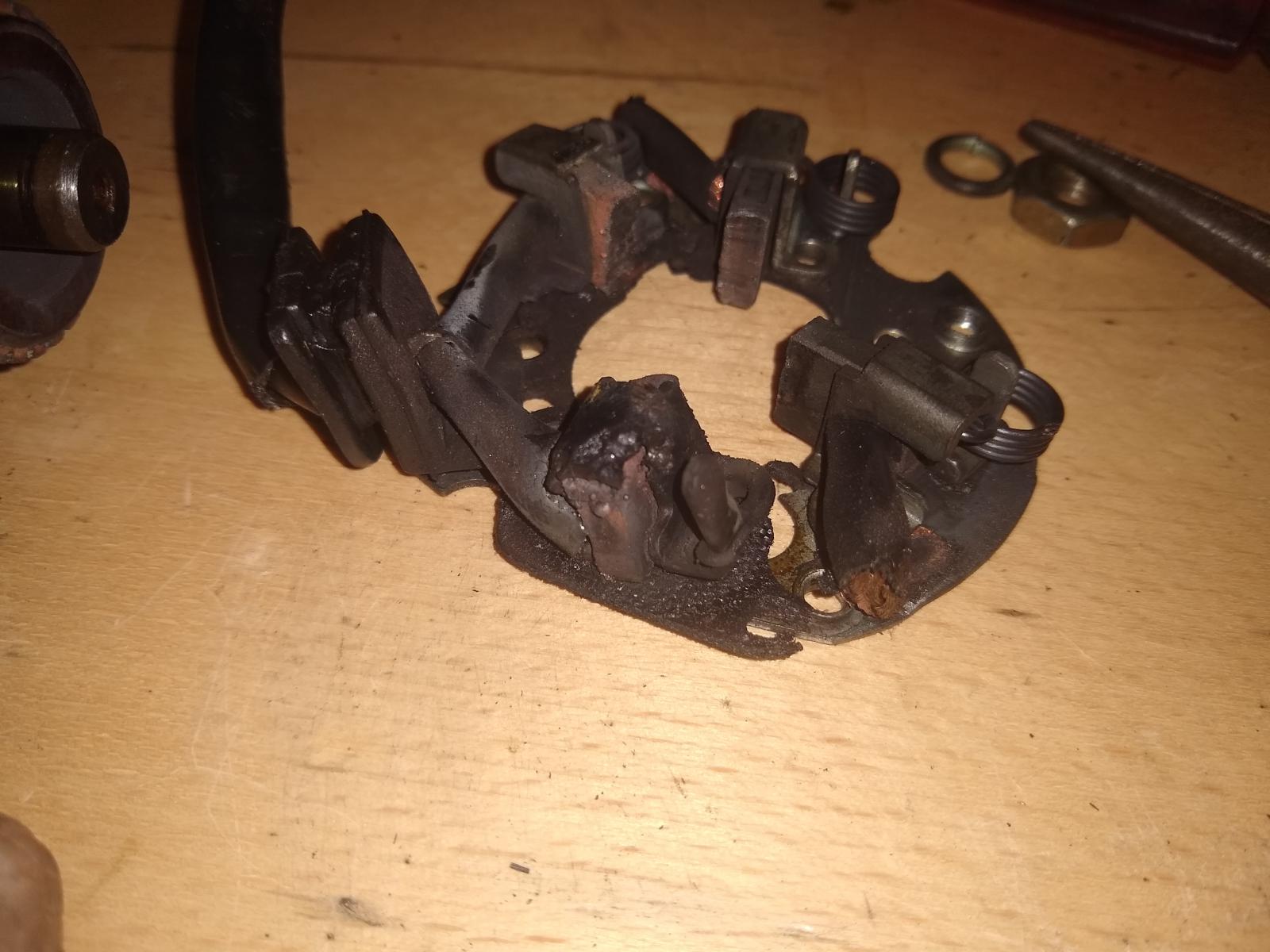

Starter melted.
Attachment 25337
Attachment 25338
Attachment 25339
Attachment 25340
I have another armature and set of brushes, but I'm gonna have to re-solder the brush holder in order to make it work.
I looked online, but none of the local parts stores have starter brushes in stock.
It seems that, for whatever reason, I am particularly rough on starters. I don't know if it's something I'm doing wrong, or I just have terrible luck.
At least I know how to fix the things I break. :shrug:

eek! That starter let the smoke out for sure. Long periods of cranking drastically shorten the life of starters. They can't dissipate the heat fast enough. I'd spring for a new one if you can. The insulation on the windings of the armature might not be much longer for this world.
Giovanni (2 n's :) ) has the starter issue 100% covered.

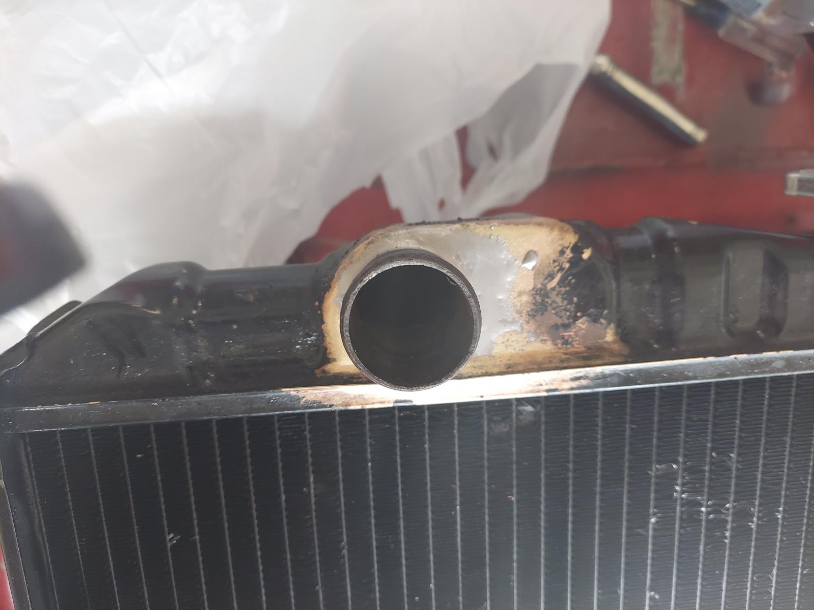

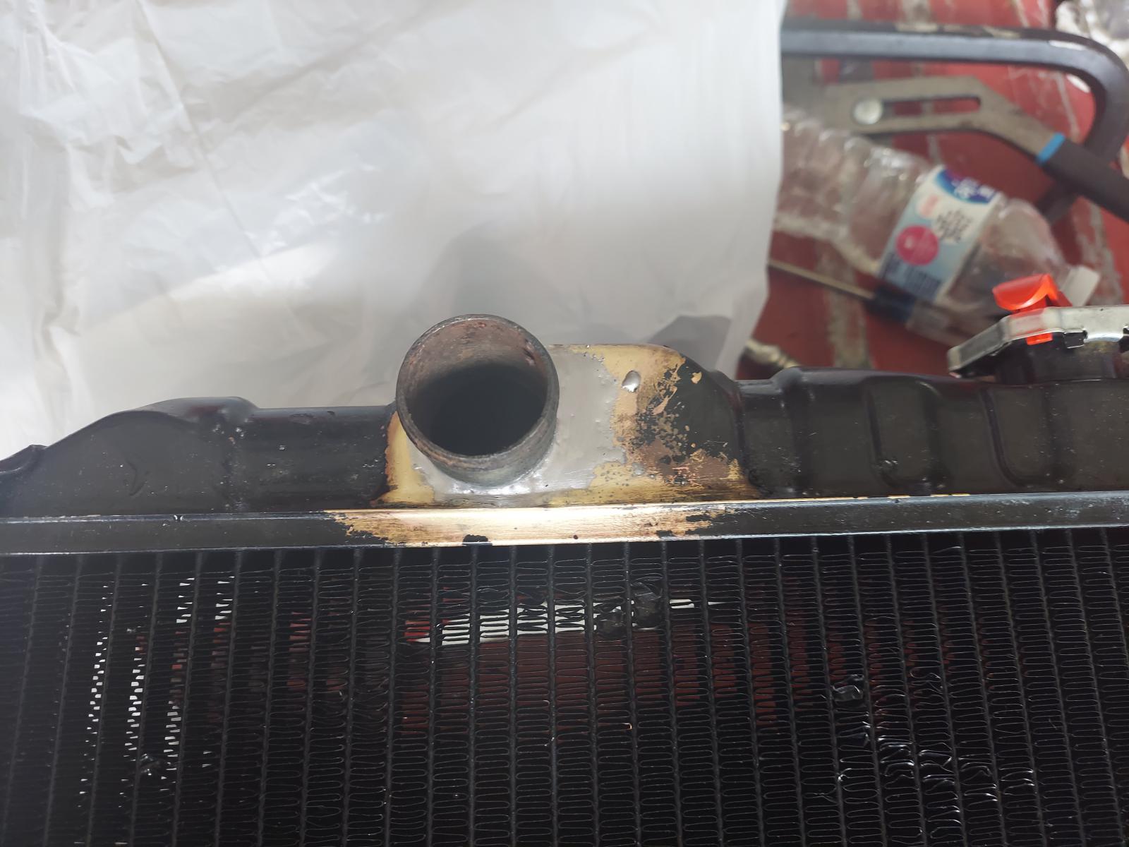

Well the upper radiator outlet is now leaking, pretty sure it's cracked right at the joint...
As for the starter armature, I swapped the burnt one out for a spare I had. Eventually I'll be able to afford a new starter...
The A/C ports still have the 30 year old discolored plastic caps, so I have a feeling it's still running R12. That's gonna be fun trying to find...
Take the radiator to a shop and they'll solder it back up - no problem. If you are going to do that, I would also consider having a temperature sender bung soldered into the bottom tank so you can add an electric thermofan (install the sender, but leave it disconnected until you are ready to tackle the fan install)

I finally found a guy, didn't even charge me because it's a dead service and he was just happy to have the opportunity to practice again.
Attachment 25454
Attachment 25455
I'm not gonna complain about a free repair, especially since he went ahead and pressure tested it to 30 psi. Hopefully tomorrow I'll actually have time to install it.
Nice find. You need to keep this guy for later reference. The thermofan sender bung would be an easy job for him. A shot o' paint at it'll be ready to go! :thumbup:
