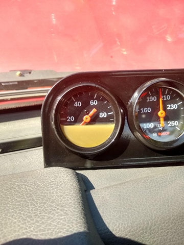

I forgot to mention this earlier, but the oil pressure gauge failed... I don't think it liked 120+ psi. :lmao:
Attachment 25115
I've replaced the gauge since this picture, and before anyone else freaks out (like I did at first) the color is from the CeraTec additive. It looked like a melted orange creamsicle while pouring it in, but the color is already starting to go back to looking like regular oil instead of a blown head gasket.
