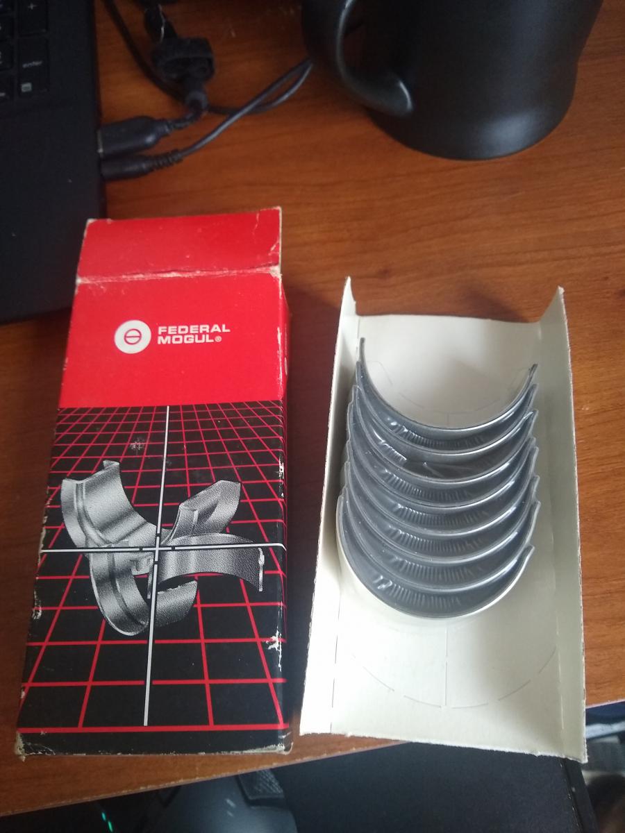

I'm still getting wear marks on the bearings, which leads me to believe that at least two out of the four connecting rod bearings were the wrong size. So, I'm going to order a full new set and hope that they actually are the right size. I did use plastiguage to check the oil clearance, but obviously it wasn't totally accurate.

Got the bearings, the box looks like it's been on a shelf since the 80's but the package is still sealed perfectly and looks correct.

Fingers crossed for you. This engine has been through hell hasn't it. I still don't know how a company can manage to screw up packing critical parts. This causes a congo line of pissed off people especially it the parts are being bought by a workshop...
To be fair, I did buy the cheapest I could find... And it probably doesn't help that the new set of bearings only cost $2.19, but they're a decent brand that just happened to be on wholesaler closeout. :thumbup:

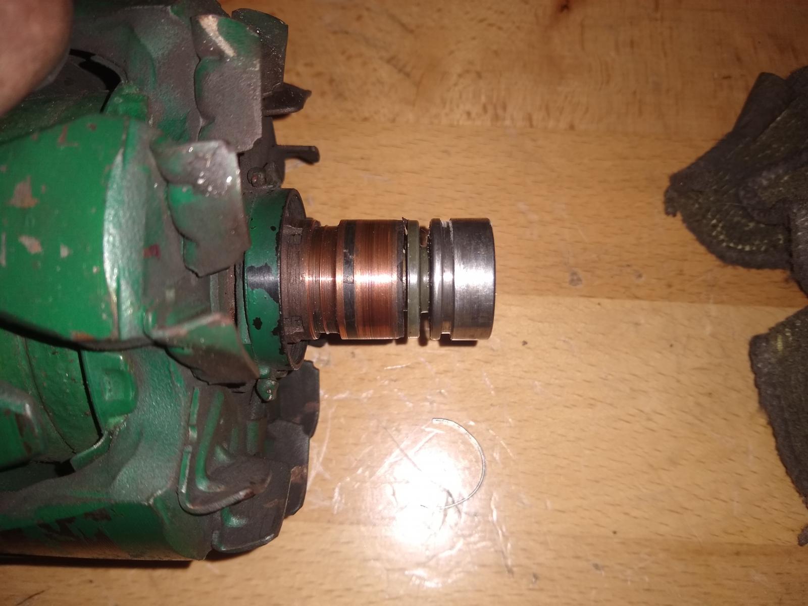

I think this stator is done for.
Attachment 24716
Somehow this alternator still put out a full 14 volts, and I'm 99% sure it's the original alternator. I wonder how hard it'll be to find a new stator...

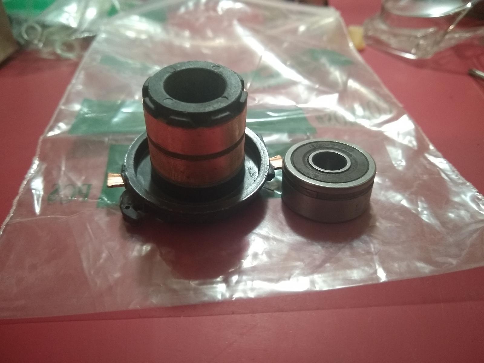

Rotor, not stator... And I found a listing on eBay for a new slip ring that should fit this alternator, so I shouldn't need a completely new rotor...
I'm going to keep this alternator and just rebuild it, I haven't had much luck with remanufactured stuff.

I'm going to go ahead and replace the bearings while I've got it apart, they're both a little stiff and the drive end bearing felt a little crunchy at first.

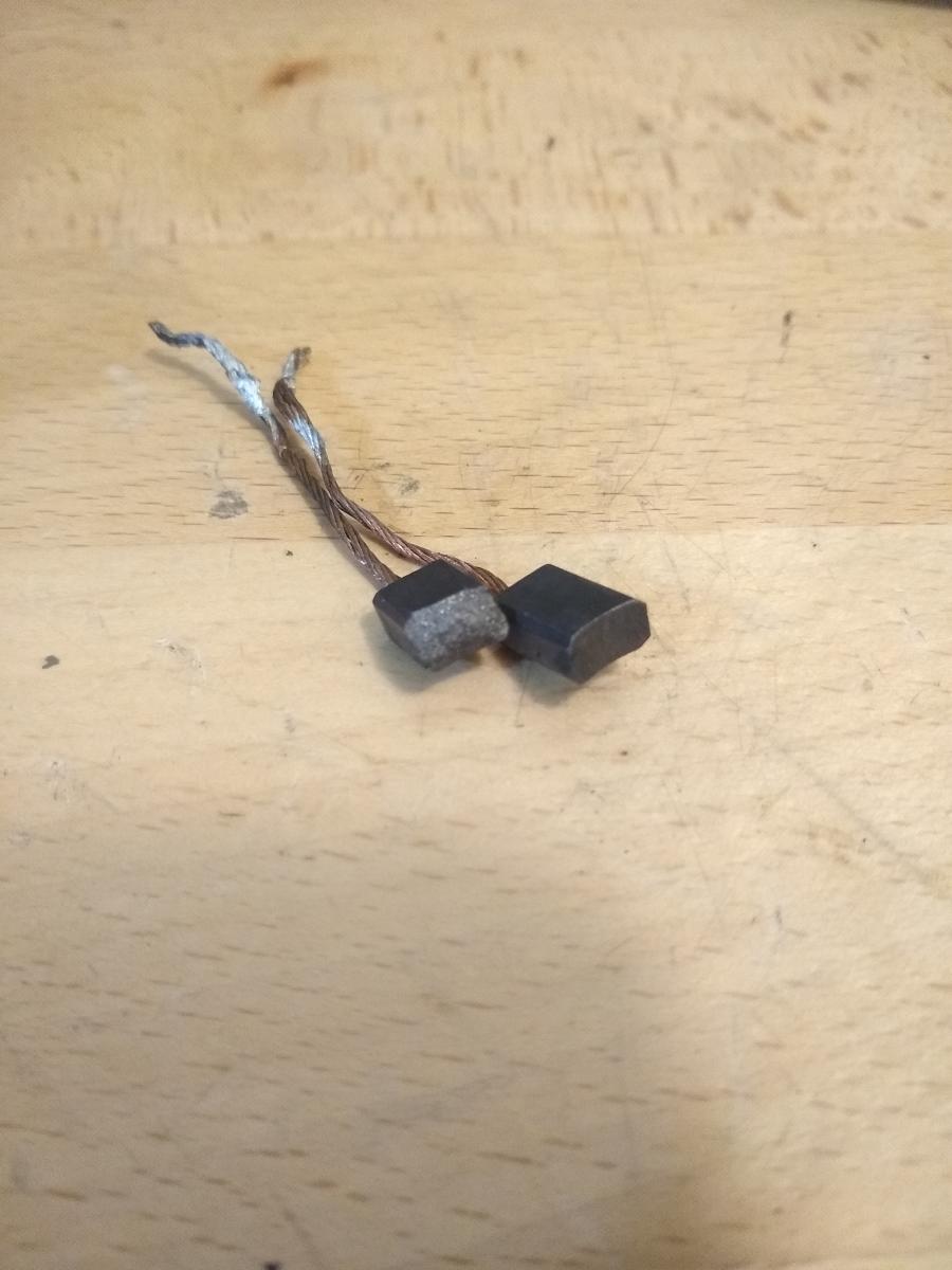

I bought new brushes, new bearings, and a new slip ring for the alternator... I have yet to decide if I'm going to repaint the stator and rotor, the factory green is still there but very faded and worn.

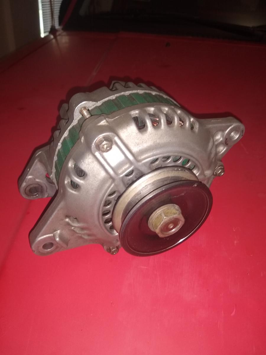

I replaced the slip ring, bearings, and brushes in the alternator, soldered everything and re-assembled it.

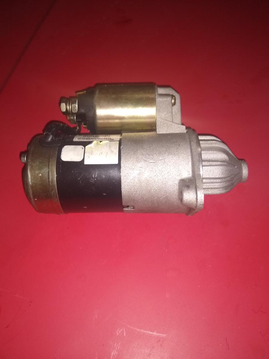

I cannibalized the junkyard starter and used it to rebuild my old starter, the gear in the junkyard one was some kind of heavy composite instead of the white plastic that got eaten in the old one, so it should fare better.

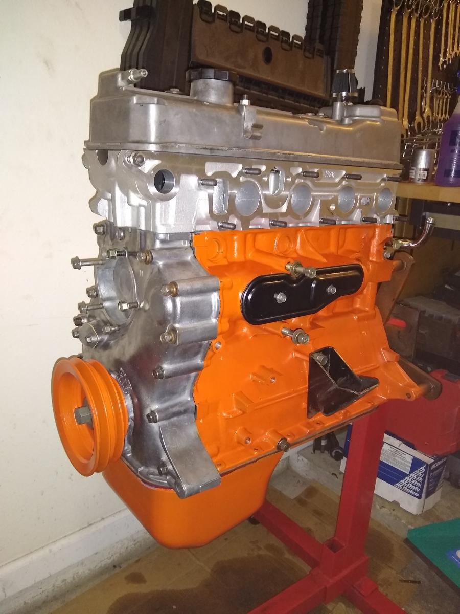

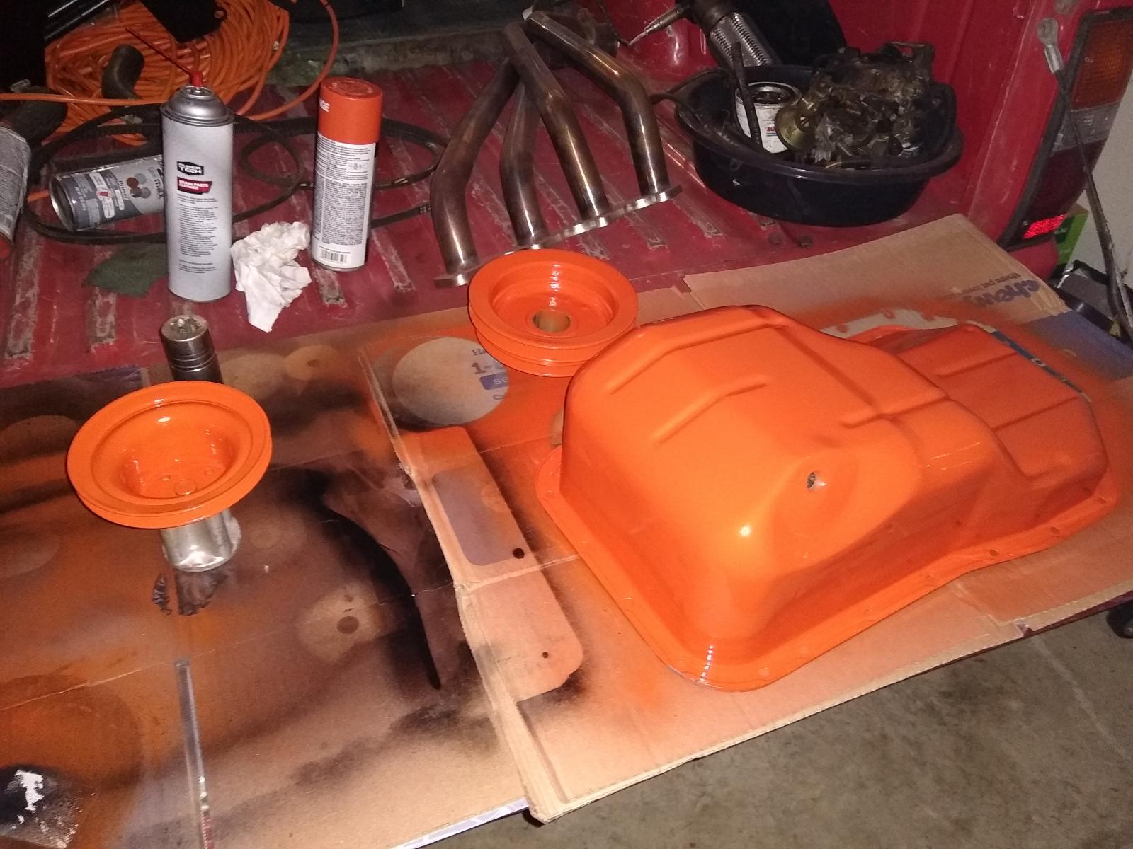

I got the oil pan, water pump pulley, and crank pulley painted, everything else is going to be black.
Attachment 24908
And the finished product. I've got most of the bolts cleaned up and threaded into their respective homes. I still need to make a new water pump gasket and thermostat housing gasket, but the only thing keeping the engine from going in is time off and the need to go get an engine hoist.

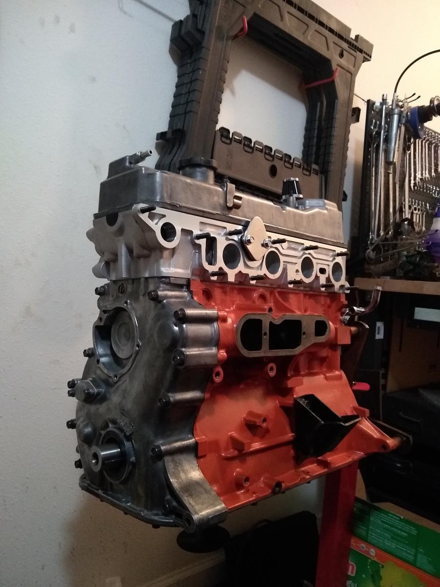

I'm not going to lie, before I had the oil pan and crank pulley on I was starting to doubt my decision to keep the timing cover plain... I'm still not 100% that I shouldn't just go ahead and spray it orange as well, but I'm more comfortable with it after seeing it mostly together.

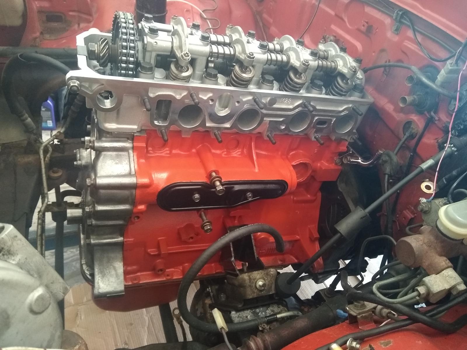

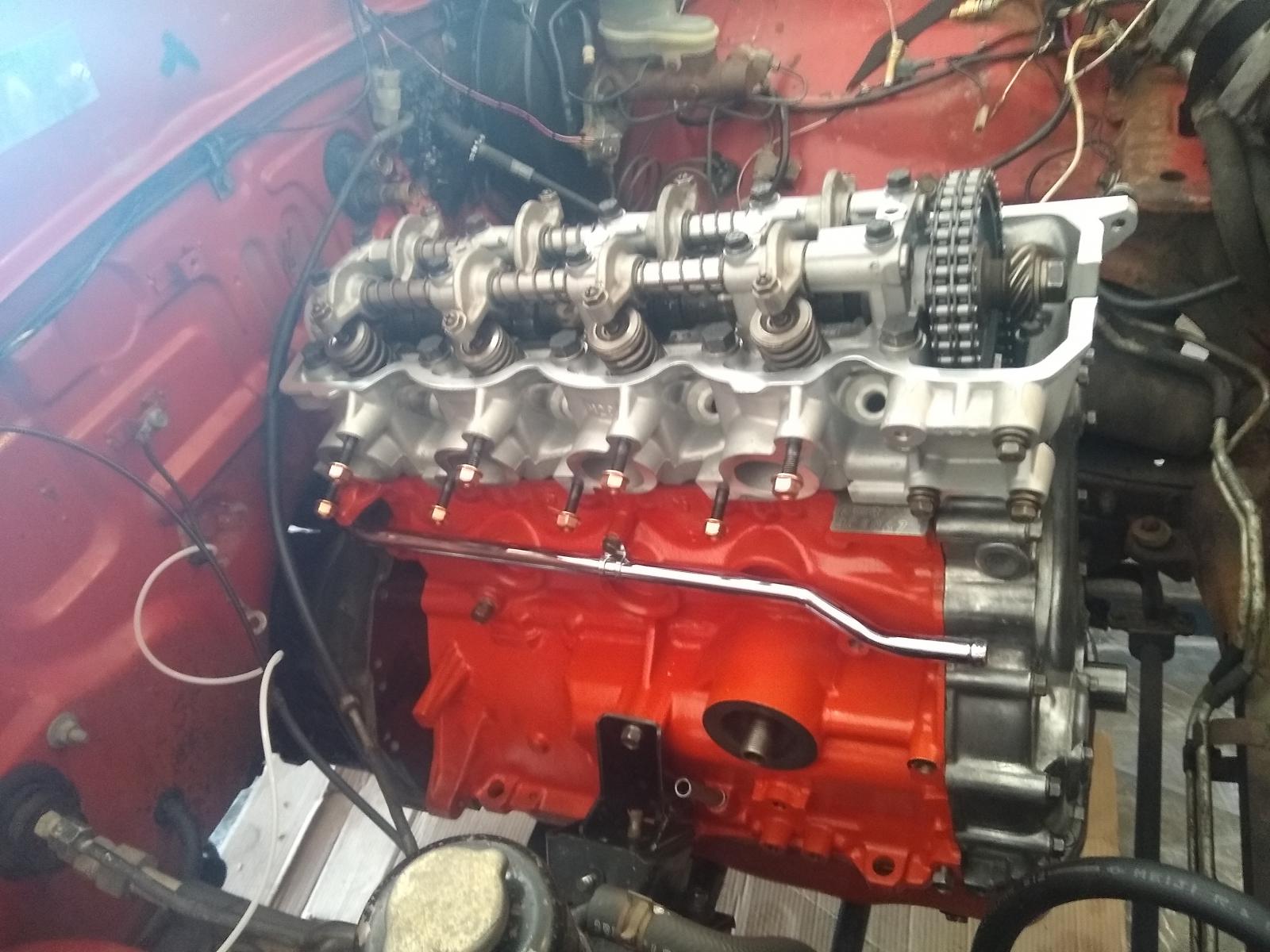

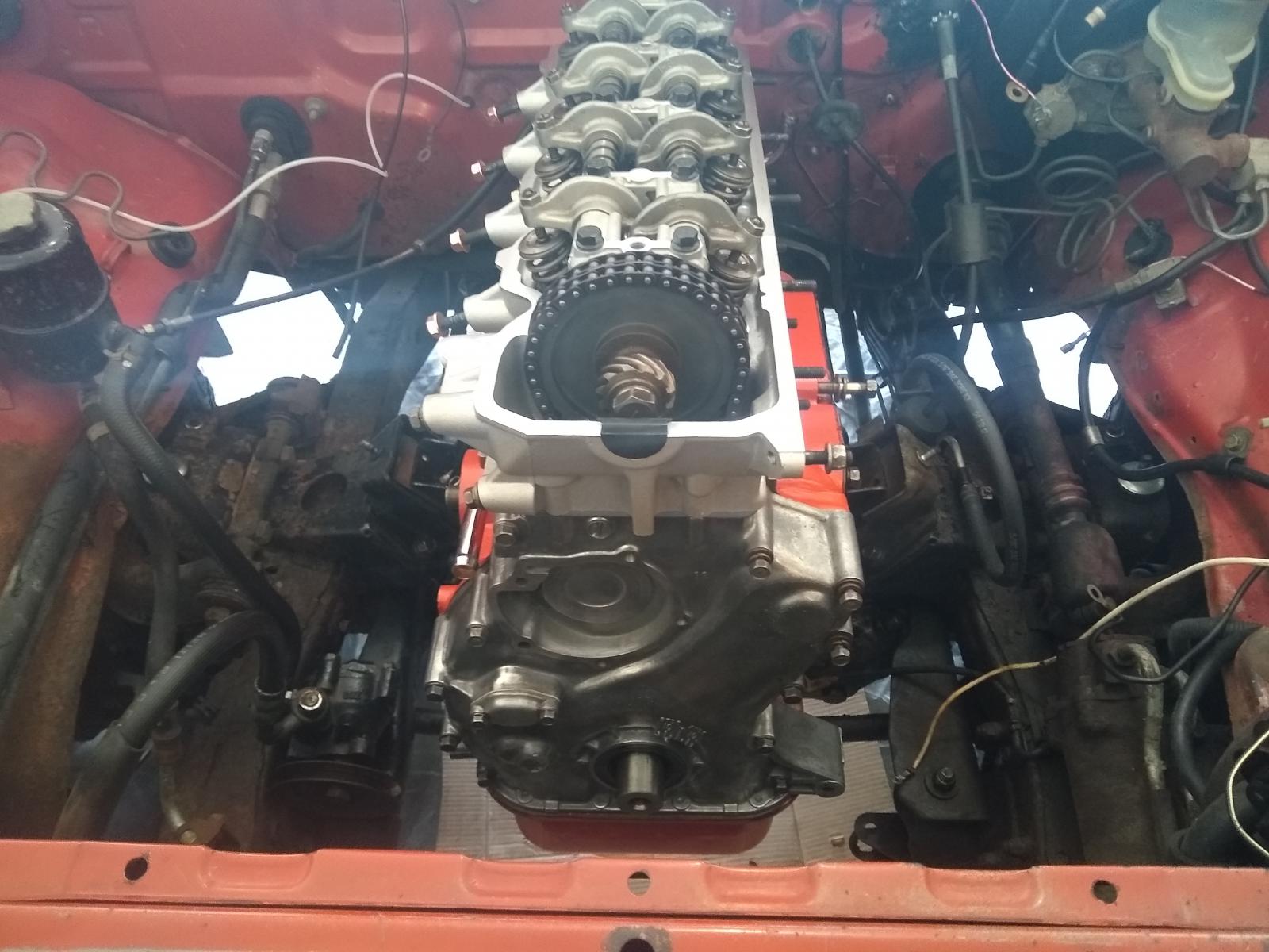

Engine is in. :rock:
Attachment 24974
Attachment 24975
Attachment 24976
Still a lot of work left to do, but I don't care. It's officially bolted in.
I'm not gonna lie, it took a little bit of finagling to get the input shaft to cooperate, and to get the motor mount bolts lined up, but it only took maybe two hours from lifting the engine off the stand until it was on the mounts.
The rest should (hopefully) go together pretty quickly.

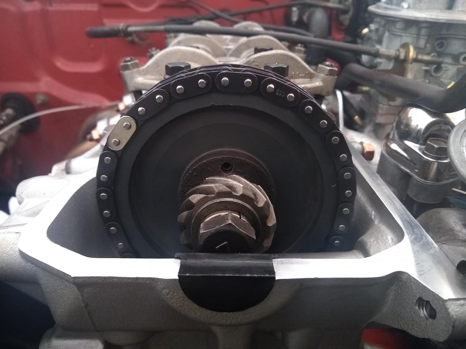

Attachment 24990
I noticed this while putting the distributor in, I freaked out for about a minute until I realized I had rotated the engine over a few times to set the valve lash... I was trying to figure out why the link had moved, but the cam and crank were both still at TDC on cylinder #1.

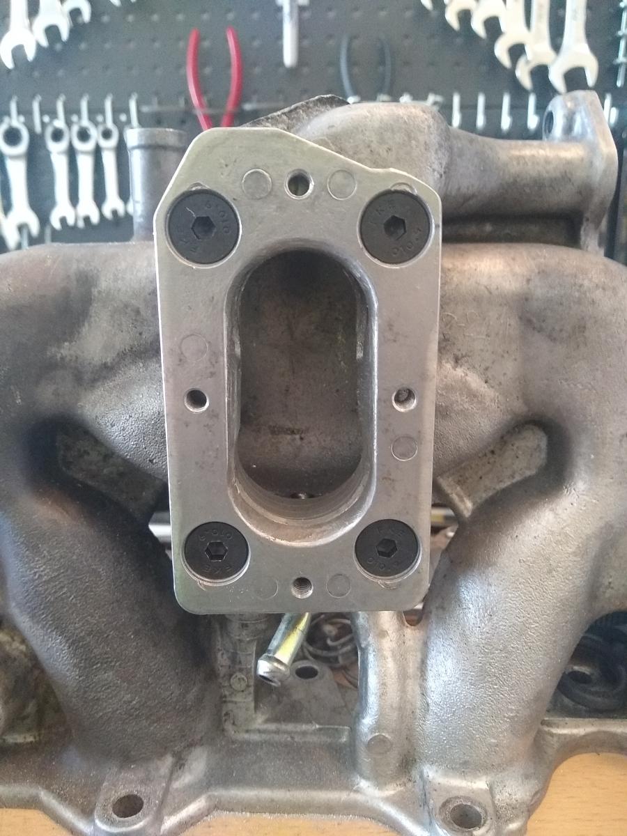

I went ahead and cut out the center bridge in the intake manifold, I didn't get it 100% perfect but all of the transitions are smooth and it should help a little with inlet turbulence.

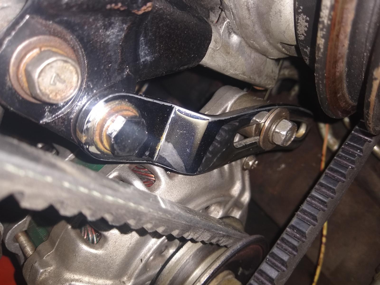

There's the shiny chrome alternator bracket, hiding under the A/C compressor.

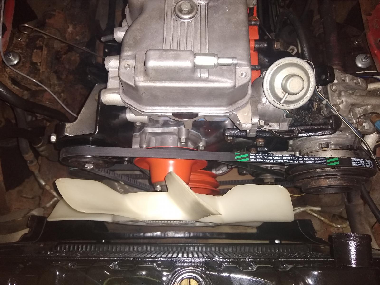

Attachment 24993

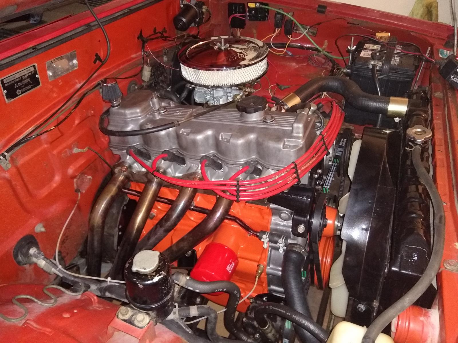

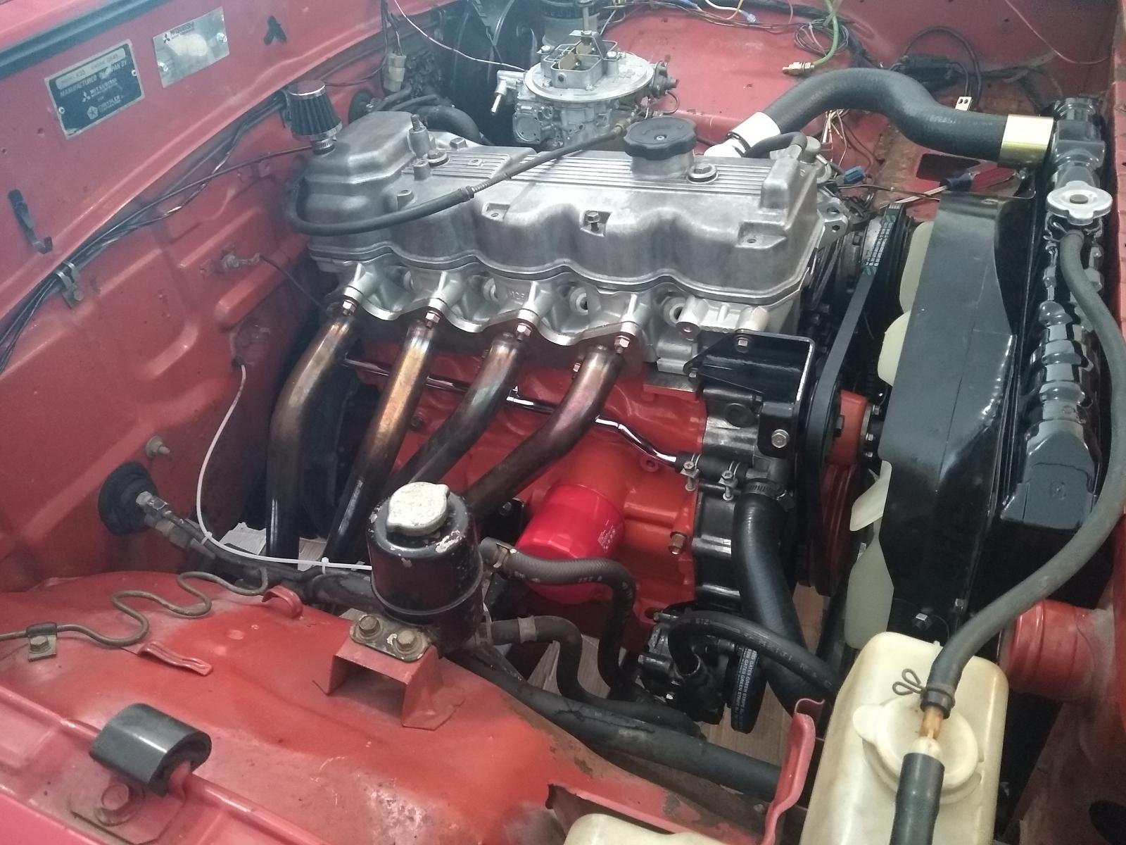

And the front accessories all mounted. I cleaned up the fan shroud and fan, painted everything, and installed everything. I had to make a gasket for the water pump and thermostat housing, really glad I picked up that gasket material a few weeks ago.
Attachment 24994
Attachment 24995
I primed the oil system with a $5 garden sprayer from ALDI's and some hose clamps, and poured the rest of the oil into the pan. I filled up the radiator with plain water and only had one connection start leaking, I had forgotten to tighten the clamp on the lower hose going to the heater core.
I've got to run the fuel lines, install the spark plugs and wires, wire up the distributor and ignition coil, and it'll be ready to fire. Oil pressure line went in without any issues, water temp sensor is threaded in right beneath the thermostat, and I just need to add a wire for the voltage gauge... And decide where to splice into to connect the gauge lights to the illumination circuit.
All that's left after that is to finish installing the seat cover, put the hood and grill back on, and clean up.
I should (tentatively) be driving this damn turd by next week.

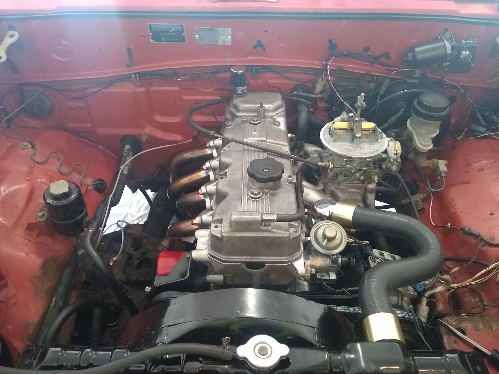

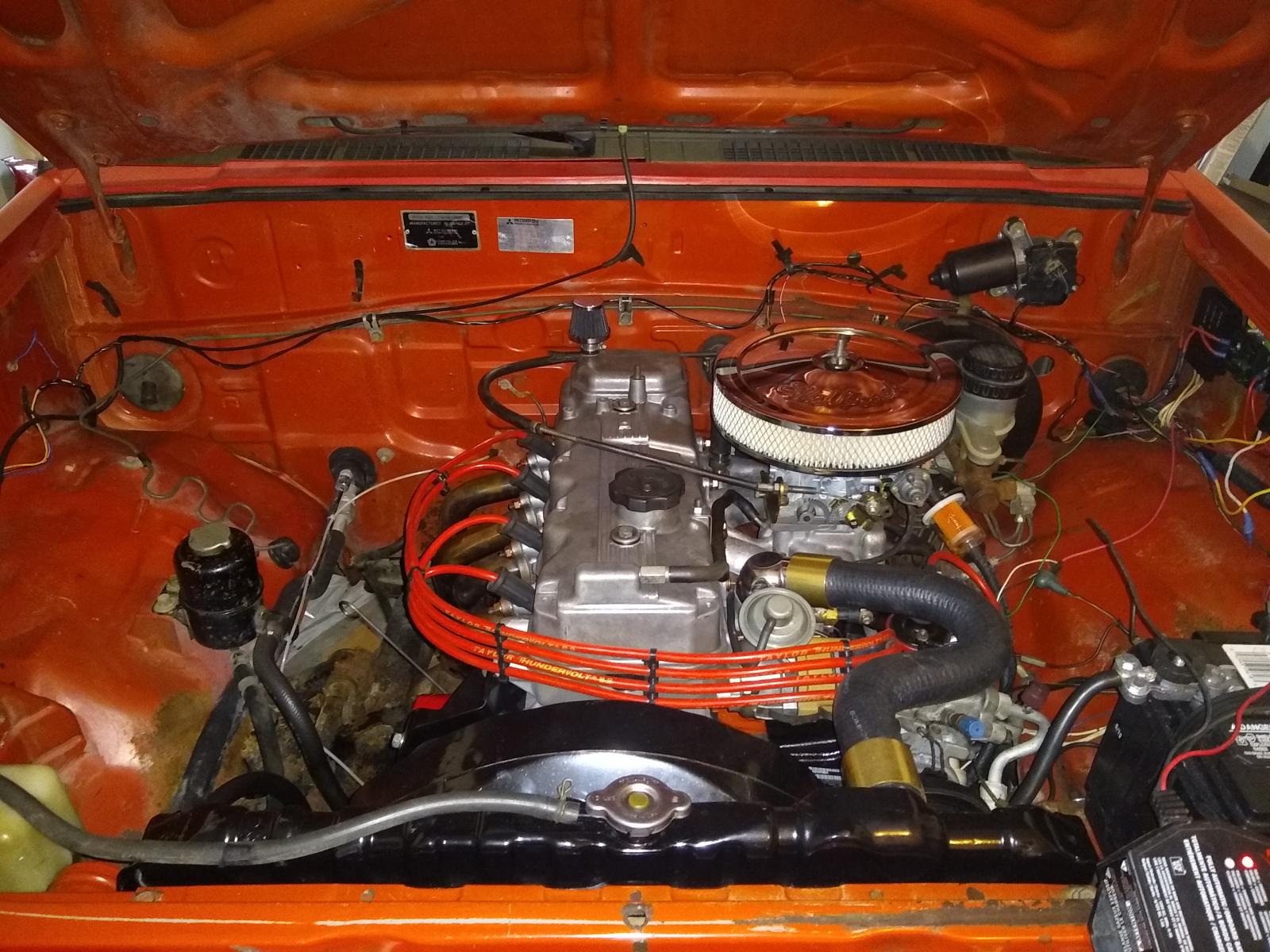

The plan was to start the truck today, but I forgot about one tiny detail... The battery was half dead.
I did get all the rest of the little stuff done, but I'm going to have to try again tomorrow.
I did take a couple pictures...
Attachment 25013
Attachment 25014
I've got a trickle charger hooked up to the battery, by tomorrow morning it should be ready to go.
