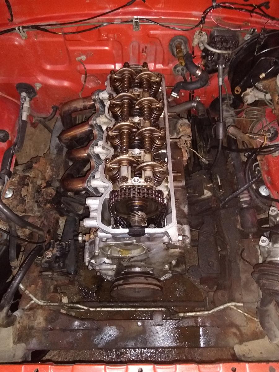

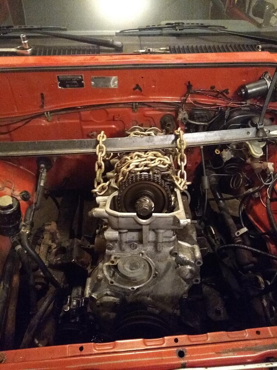

All that's left is unbolting the engine from the mounts and bellhousing and yanking...
I still need to figure out how I'm going to lift it out, I don't have a hoist available and I don't exactly have the time or money to buy one right now.
Anywhere you can hire one out? If you have all of the prep work done and it's just a matter of yeeting it out, you could book one for a day and get it swapped.

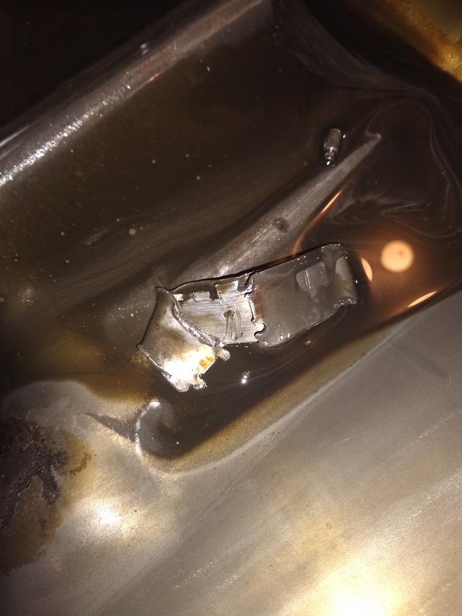

Got the oil pan off, and found out what went wrong...
Attachment 23617
Floppy chain.
Attachment 23618
I'm going to say that chunk of metal looks like a bearing that fell out and got caught in the chain... and destruction ensued.

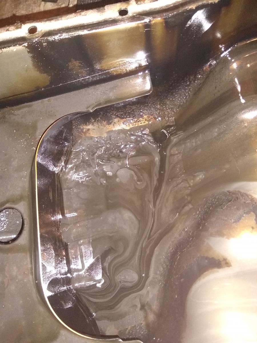

More shiny bits...
Attachment 23620

It would take catastrophic damage to the engine for a bearing to make it's way out of a journal. Could be from a balance shaft? :shrug:When they fail you get a huge drop in oil pressure which sort of follows what you experienced.
That's what I'm thinking, that it's a balance shaft bearing. Above that bearing there's a piece of the chain sitting in the pan...
...and all of the shiny mud in the sump are bits of cast aluminium from the timing cover as it got ground off by the chain. The question will be - delete or not delete the shafts? There's a good chance that at least one of the balance shafts is chewed up as a result of the bearing failure (my money is on the exhaust side)
Definitely delete. I'm not going to chance this happening again.

I'm on my way to pick up an engine stand, and either later today or tomorrow I'll be renting an engine crane.
By the end of this weekend I should have the engine torn down and have an idea of what all it will need.
