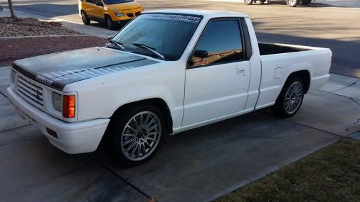

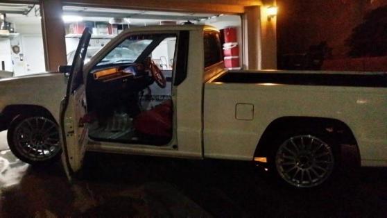

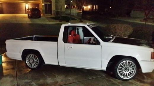

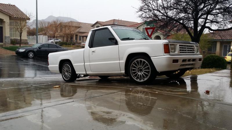

Since my RHD swap was finished, I havent washed the truck. There has been little to no time to do it. Since I was tired of looking at all the dirt and grease buildup, I decided washing it even at night would net a result that looked better even if I missed a few spots.
Attachment 12620Attachment 12621
The next morning revealed a damn good job for washing at night. I couldn't even find one spot I needed to go back over....
Attachment 12622
But the next day... It rained. Now my truck is all dirty again...

Haha that's how it always works. Wash it and in comes the rain. I'm glad you updated some current pictures though. I've loved reading this thread, and keep bringing myself back for ideas and I start mock up on my 1st gen.

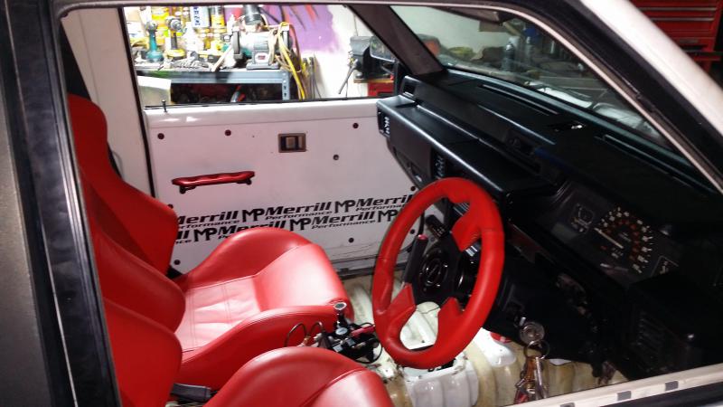

Hey Merrill. I noticed you didn't cut speaker holes in your door skins. I'm wondering if you relocated the front speakers or eliminated them?
I intend to machine some quick release door hinges in the future. I can't have any electrical going to the doors.
I haven't decided if I will install a sound system or not yet, but if I do, front speakers will probably go into the kick panels and rears into the rear pillars.
Our doors take in so much water and door speakers tend to rust or get all crusty, so the kick panels are a good idea, I think under dash in corners would be better maybe though. Can't kick them, no water to ruin them and they are close to the ears, but this is 1st for dash, not sure if 2nd gen dash supports them to good.
I like his idea about the quick release door handles, no electric for them means you never get locked outside of truck when you have a dead battery, lol.
My factory dash speakers will remain out because I am routing the roll cage through the dash at the speaker location. Since I'm 6'2, and the truck is small, I decided not to bend around the dash but rather go through it. Since the RHD dash is not common here in the states, the only way to preserve it is to go through the speaker holes to avoid lots of cutting.
Quick release doors are there to make life easy at the track, or loading the truck into a trailer. With the door off, I can get in and out of the truck in a tight space. It's also easier to work on the truck with no doors attached when you are back and forth between working under the hood and in the cab. It's also "totally race car" to take your doors off :lol:

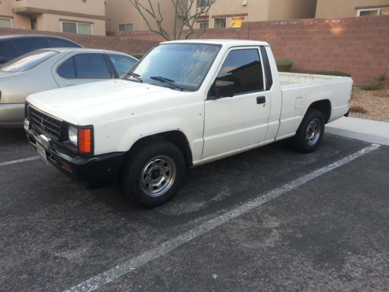

Despite having some dings and dents, it wasn't really that bad at all for being 23 years old. I later found out I am the 3rd owner, and the first owner was a local bread company. This was a dealer maintained delivery truck! I totally scored.
Even though it was clean, it wasn't good enough. First I gave it some better looking mirrors (F1 style) and face lifted the front end with the '93 plus bumper and grille and a set of projector headlights. It didn't take long for me to realize that that wasn't enough. After attacking the chassis mods (314mm 4 pot big brakes, narrowed Ford 8.8 LSD, and suspension drop), I finished it off with a set of 17" Enkei wheels that are similar to Evo X factory wheels.
This was was where the exterior started to go down hill. Some full readers of my thread recall "The Crackhead" that banged out and painted my truck back in June or '14.... Long story short, the dude was literally a crackhead and turned my simple Flat White paint job into drywall texture that is impossible to clean.

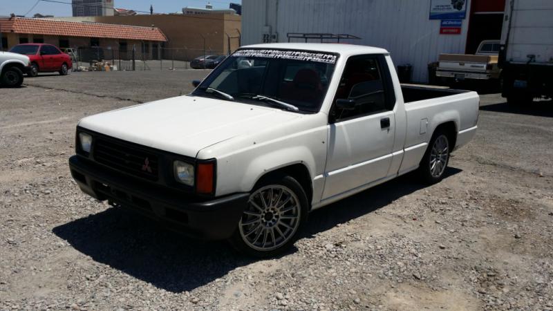

I started with a very decent truck. Even though it was beat up and very stock, it was a solid 5.
1 - - - - - - - - 10
XXX XXXX XXX

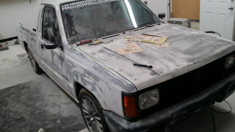

Just before paint, I really feel I brought this up to a clean and very respectable look. It wasn't dead on my vision, but I can confidently give it an 8.

I'll be honest... I don't typically take pics that show off the shit paint :lol: That honesty translates to my current exterior rating. It's terrible. However, if you look past the texture, you will still see a nice truck with a few complimenting accents and style, so I'm dropping back down to a 5.
Once I get the new mods done and a fresh coat of paint on it, I know I can score a 10 in my brain and vision.

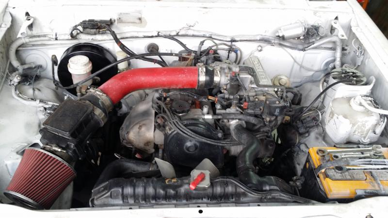

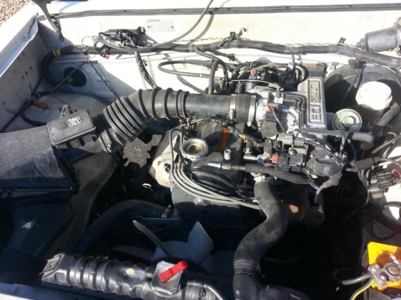

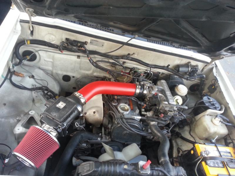

The Engine & BaySuch a beauty!! I was completely shocked the day I popped the hood for the first time. Incredibly clean - smooth running - and what a maintenance record it had! It showed.
It has been my intention from the get go to swap this over to a much more modern platform. The Evo variant 4G64 DOHC was being started before I even bought the truck, so I have left the mod list alone for this engine except for one item - a custom air intake.
This was such a simple mod and really unlocked quite a bit of fin in this little 8 valve. Even the sound was brought out a little. It sounded just a little bit more serious under a full throttle pull. All I wanted to do was keep the engine pretty until I swapped it. This engine bay was perfect until the attack of the crackhead..... Everything ended up getting painted after he got ahold of it. My prestine wiring harnesses were now white and flaking. My overflow bottle was color matched. My engine was speckle painted in white..... This bay looked like total shit. To add insult to injury, the crackhead went back and rattle canned over my radiator hoses, charco can, brake booster, wiper motor, and a dozen other parts of the bay to try and hide all the over spray.... a real class act douche.
Here is the current look of my engine bay One Year Later

I started with a damn near PERFECT stock engine and bay. Dealer maintained, extremely clean, un-molested, decent power. This was an easy 8 as far as stock 8 valves are concerned.
XXX XXXX XXX
The intake really polished it off. I'm not going to duplicate my first score after an upgrade, so 9 it is.

One year later, everything is over sprayed, and the engine I wanted to have in is still not in. It looks like shit and it's still in the truck... its a 2.
We'll see what happens in the coming months, but I know what I need to do to bring this rating back up.

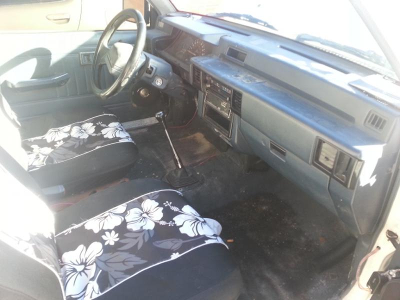

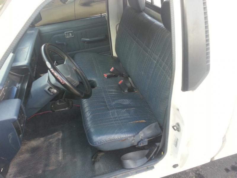

I bought this with some random bucket seats wrapped in Hawaiian seat covers... It was laughable at best. I'm not sure if the "Ford Racing" steering wheel cover was to be funny or if it was just something the previous owner had laying around. I barely fit in the truck with those seats, but the owner did still have the bench which I installed very quickly after purchasing the truck.

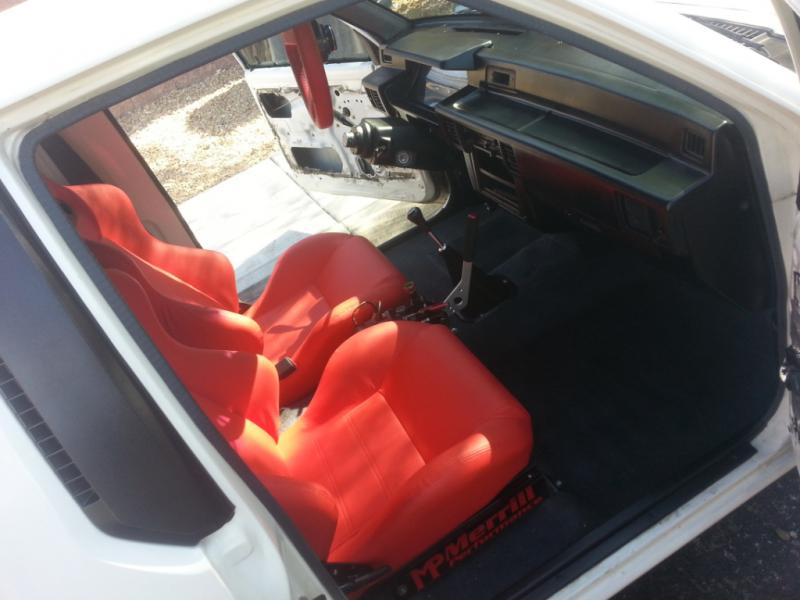

The bench is much more tolerable for a guy my height. It didn't take long for the interior to get done. It was a short list, but a lot of work. I was chasing something clean and "as comfortable" as a truck intended for racing could be. I chose a nice set of red leather racing seats, dyed a second dash black, dyed the trim plastics black, added a red leather steeering wheel with quick release, and made a rear brake for some drifting fun. To top it off, I built a custom set of arms rests and made a color matched set of door cards out of 6061 aluminum. Id say the "mid point" of my interior was right where I wanted it. Hard to keep clean, but I love it!
It's pretty amazing how lucky you can get sometimes. I toyed with the idea of a right hand drive swap at the beginning of this build, but soon dropped the plan due to unnecessary "bling expense"... It just wasnt practical. Well, fate landed in my lap one day after a close friend was scouting the yards in San Diego. I got the call saying he had found an old highway truck that had been converted to RHD. Long story short, he bought it all, I went to pick it up a week later. After repairing the cracked dash and dying it black, I performed the complete swap in 36 hours (my personal best).

This interior kinda sucked to start with. I'm not counting the first bucket seats with the flowers, but the bench was pretty torn up. The steering wheel was trashed and the cover simply didn't match. The dash was hacked beyond repair because the idiot previous owner tried to install speakers that were way too big, and the whole interior was riddled with wood screws and household wiring. Pure shit. With everything needing to be replaced, this interior was a 2.

I nailed it! Exactly what I was looking for as far as comfort and appearance. The only thing that was NOT changed before the swap was the carpet. Surprisingly enough, it was hard to tell it was still blue. So I will bump this to a 9.

Tough to score this one since it's still the same interior minus the carpet. However - that totally kills the look. It has no feel without the carpet, so down one point it goes to an 8.
If I could just toss some carpet in and my roll cage, I'd give it a 10 after my window crank and handles get dyed. Not having carpet REALLY kills it though, so that is first lol.

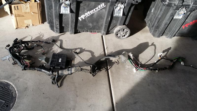

I managed to get my harness pinout complete for the 3g Eclipse ECU. One of the reasons I like to go back and do it all myself is because information tends to suck sometimes. The 3G and Evo ECU's are very similar since the same pin serves pretty much the same function, but they are not identical on the pinouts. The EVO ECU uses pins that the Eclipse unit does not, and the Evo pinouts seem to be missing 3G info. They also do not share the same wire colors (except the ground lol). I snagged up a FSM for the 3g and now I have a complete 3g pinout correctly written to the ECU and color codes.
Judging by the looks of the schematics I have been digging through, running the 8V 4g64 off of the 3G/Evo ECU would be very possible as long as you add the missing components like IFS, Transistor(s) for DIS, ignition coils, and swap the IACV over to DSM/Evo/Eclipse type. You also have to add the OBD2 plugs and you will lose your mechanical speedometer because the ECU needs to use a VSS. You can absolutely find a substitute speedometer easily once you convert to OBD2.
I do have some extra time over the next couple days. I will probably dig into some other FSM's and write some pinout/wiring info for DSM to 8V conversions for those who may be interested. This would be so much easier than building stuff like Megasqirt and tapping in piggy-back ECU's.
I'm still undecided if I will actually run my 8V on the 3G ECU or not. I really don't want to make a harness for it and then have to make it again for the next swap. Maybe I'll make an adapter harness or something.... I don't know yet.... Stay tuned!
So here is a little info after half a days worth of pinouts with 1G DSM and Mighty Max harnesses:
-60% of the wires/circuits are plug and play/same pin and function but different color on most(extremely easy).
-20% of the wires don't exist on the MM so they need to be added (semi-easy).
- the remaining 20% just need to be re-pinned (easy).
-A throttle body swap will need to happen/required (easy).
-DIS can be wired in (easy) OR you can leave the distributor in place and use it (better to have DIS though).
I'm trying to dig up the MAF pins to verify the wiring. There are also a couple circuits that I have zero info in. A wire is on my ECU, but there is nothing on the diagram listed for it. This is why it sucks not having a FSM lol. I'll figure it out soon though. If anyone has a known working 1G DSM ECU I can borrow to verify my pinout/swap function, I'd appreciate it. I'll return it when I am finished and replace it if I break it. I'm just not going to do a permanent swap is all. I'd rather have the work listed for others to use for their rides in the future.
