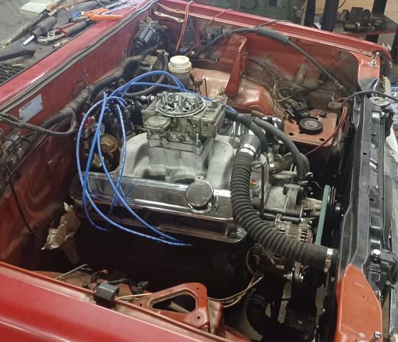

Its been a while since I have been on here so I wanted to let everyone know that I am almost complete my V8 Swap.
I will have lots of pictures soon.
Here is how it sits right now.
http://www.mightyram50.net/vbulletin...id=28450&stc=1
http://www.mightyram50.net/vbulletin...id=28451&stc=1
http://www.mightyram50.net/vbulletin...id=28452&stc=1
I tucked an aluminum rad under the rad support and made a customer lower mount to try and keep a somewhat stock look.
Completely stock 318 except for the intake. I do have headers for later. I installed an A500 from a V6 (non computerized) on the 318 and used the factory tranny mount.
