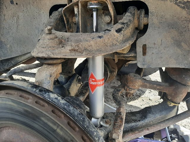

Installed the kyb on the front. Wow what a huge difference. Way better rude. Quite a job to get them compressed so they fit through the back of the control arm. Used bailing twine to hold them shut and cut it loose after getting the top pin in place.Attachment 27783 fyi
